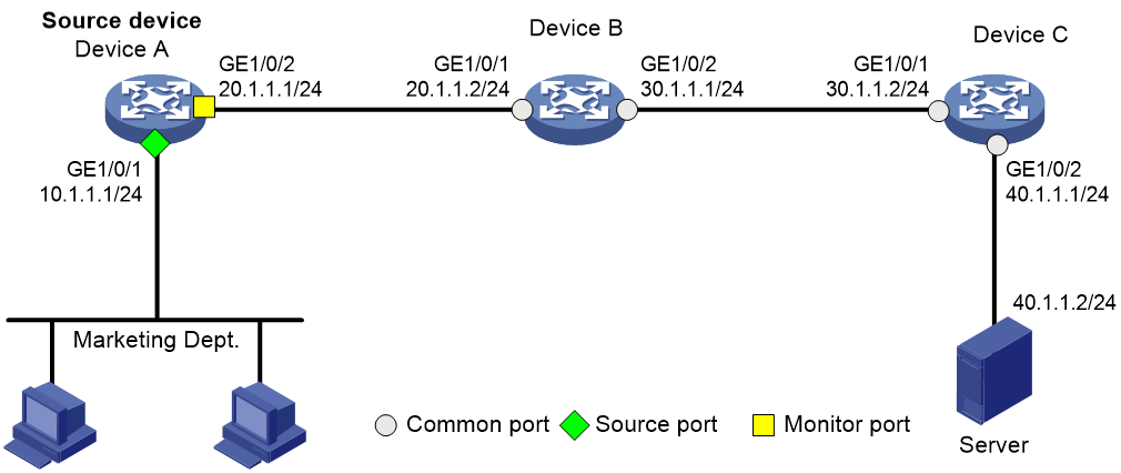

As shown in Figure 4, Layer 3 remote port mirroring in encapsulation parameter mode works as follows:
1.     The source device copies a packet passing through a source port.
2.     The source device encapsulates the copied packet with the specified encapsulation parameters, monitoring device IP as destination IP and monitor port IP as source IP.
3.     The encapsulated packet is routed to the monitoring device through the IP network.
4.     The monitoring device decapsulates the packet and analyzes the packet contents.
The packet sent to the monitoring device through Layer 3 remote port mirroring in encapsulation parameter mode is encapsulated. In this mode, make sure the monitoring device supports decapsulating packets.
Figure 4 Layer 3 remote port mirroring in encapsulation parameter mode

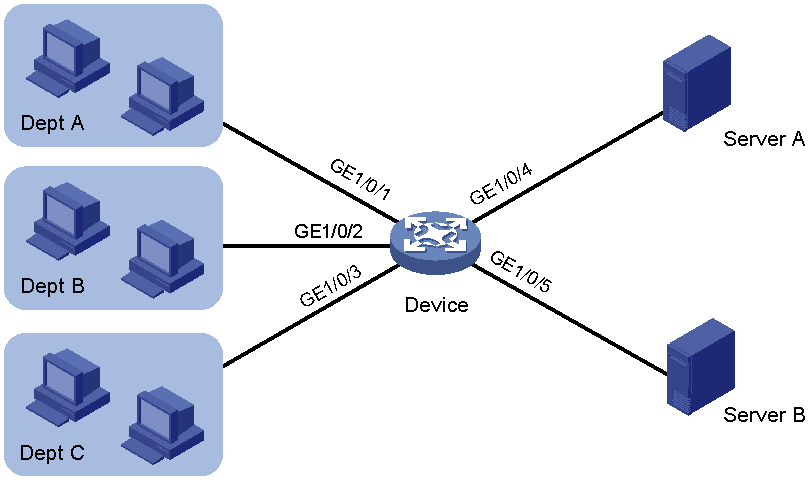

Example: Configuring local port mirroring with multiple monitoring devices
As shown in Figure 6, Dept. A, Dept. B, and Dept. C are connected to the device through GigabitEthernet 1/0/1, GigabitEthernet 1/0/2, and GigabitEthernet 1/0/3, respectively.
Configure port mirroring to enable data monitoring devices Server A and Server B to monitor both the incoming and outgoing traffic of departments A, B, and C.
Figure 6 Network diagram
# Create remote source group 1.
<Device> system-view
[Device] mirroring-group 1 remote-source
# Configure GigabitEthernet 1/0/1 through GigabitEthernet 1/0/3 as source ports of remote source group 1.
[Device] mirroring-group 1 mirroring-port GigabitEthernet1/0/1 to GigabitEthernet1/0/3 both
# Configure an unused port (GigabitEthernet 1/0/6 in this example) as the reflector port of remote source group 1.
[Device] mirroring-group 1 reflector-port GigabitEthernet1/0/6
This operation may delete all settings made on the interface. Continue? [Y/N]:y
# Create VLAN 10 and assign the ports connecting the data monitoring devices to the VLAN.
[Device] vlan 10
[Device-vlan10] port GigabitEthernet1/0/4 to GigabitEthernet1/0/5
[Device-vlan10] quit
# Configure VLAN 10 as the remote probe VLAN of remote source group 1.
[Device] mirroring-group 1 remote-probe vlan 10
Example: Configuring Layer 2 remote port mirroring (RSPAN with reflector port)
As shown in Figure 7, configure Layer 2 remote port mirroring to enable the server to monitor the bidirectional traffic of the Marketing Department.
Figure 7 Network diagram
1.     Configure Device C (the destination device):
# Configure GigabitEthernet 1/0/1 as a trunk port, and assign the port to VLAN 2.
<DeviceC> system-view

Flow mirroring ERSPAN
On all devices from source to destination, configure a unicast routing protocol to ensure Layer 3 reachability between the devices.
As shown in Figure 11, flow mirroring ERSPAN in encapsulation parameter mode works as follows:
1.     Configure a QoS policy on the source device as follows:
a.     Configure a traffic class to match packets.
b.     Configure a traffic behavior to flow-mirror traffic to an interface.
c.     Associate the traffic class with the traffic behavior.
2.     The source device copies a matching packet.
3.     The source device encapsulates the packet with the specified ERSPAN encapsulation parameters.
4.     The source device forwards the packet in either of the following methods:
¡     Forwards the mirrored packets out of the specified outgoing interface.
¡     Looks up a route for the encapsulated mirrored packet based on the source IP address and destination IP address of the encapsulated packet.
5.     The encapsulated packet is routed to the monitoring device.
6.     The monitoring device decapsulates the packet and analyzes the packet contents.
The packet sent to the monitoring device through flow mirroring in encapsulation parameter mode is encapsulated. In this mode, make sure the monitoring device supports decapsulating packets.
Figure 11 ERSPAN in encapsulation parameter mode

Flow mirroring configuration examples
Example: Configuring flow mirroring
As shown in Figure 12, configure flow mirroring so that the server can monitor the following traffic:
·     All traffic that the Technical Department sends to access the Internet.
·     IP traffic that the Technical Department sends to the Marketing Department during working hours (8:00 to 18:00) on weekdays.
Figure 12 Network diagram
# Create working hour range work, in which working hours are from 8:00 to 18:00 on weekdays.
[Device] time-range work 8:00 to 18:00 working-day
# Create IPv4 advanced ACL 3000 to allow packets from the Technical Department to access the Internet and the Marketing Department during working hours.
[Device] acl advanced 3000
[Device-acl-ipv4-adv-3000] rule permit tcp source 192.168.2.0 0.0.0.255 destination-port eq www
[Device-acl-ipv4-adv-3000] rule permit ip source 192.168.2.0 0.0.0.255 destination 192.168.1.0 0.0.0.255 time-range work
[Device-acl-ipv4-adv-3000] quit
# Create traffic class tech_c, and configure the match criterion as ACL 3000.
[Device] traffic classifier tech_c
[Device-classifier-tech_c] if-match acl 3000
[Device-classifier-tech_c] quit
# Create traffic behavior tech_b, configure the action of mirroring traffic to GigabitEthernet 1/0/3.
[Device] traffic behavior tech_b
[Device-behavior-tech_b] mirror-to interface gigabitethernet 1/0/3
[Device-behavior-tech_b] quit
# Create QoS policy tech_p, and associate traffic class tech_c with traffic behavior tech_b in the QoS policy.
[Device] qos policy tech_p
[Device-qospolicy-tech_p] classifier tech_c behavior tech_b
[Device-qospolicy-tech_p] quit
# Apply QoS policy tech_p to the incoming packets of GigabitEthernet 1/0/4.
[Device] interface gigabitethernet 1/0/4
[Device-GigabitEthernet1/0/4] qos apply policy tech_p inbound
[Device-GigabitEthernet1/0/4] quit
# Verify that the server can monitor the following traffic:
·     All traffic sent by the Technical Department to access the Internet.
·     IP traffic that the Technical Department sends to the Marketing Department during working hours on weekdays.
(Details not shown.)
