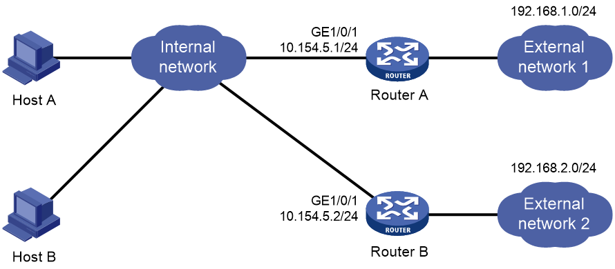

Example: Configuring IRDP
As shown in Figure 1, Host A and Host B that run the Linux support IRDP, and they are in the internal network. Router A and Router B act as the egress routers and connect to external networks 192.168.1.0/24 and 192.168.2.0/24, respectively.
Configure Router A as the default gateway for the hosts. Make sure Router A has routes to reach both External network 1 and External network 2, so that packets to these external networks can be correctly routed.
1. Configure Router A:
# Configure a route for Router A to reach External network 2. (Details not shown.)
# Specify an IP address for GigabitEthernet 1/0/1.
<RouterA> system-view
[RouterA] interface gigabitethernet 1/0/1
[RouterA-GigabitEthernet1/0/1] ip address 10.154.5.1 24
# Enable IRDP on GigabitEthernet 1/0/1.
[RouterA-GigabitEthernet1/0/1] ip irdp
# Specify preference 1000 for advertised IP addresses on GigabitEthernet 1/0/1.
[RouterA-GigabitEthernet1/0/1] ip irdp preference 1000
# Specify the multicast address 224.0.0.1 as the destination IP address for RAs sent by GigabitEthernet 1/0/1.
[RouterA-GigabitEthernet1/0/1] ip irdp multicast
# Specify the IP address 192.168.1.0 and preference 400 for GigabitEthernet 1/0/1 to proxy-advertise.
[RouterA-GigabitEthernet1/0/1] ip irdp address 192.168.1.0 400
2. Configure Router B:
<RouterB> system-view
[RouterB-GigabitEthernet1/0/1] ip address 10.154.5.2 24
[RouterB-GigabitEthernet1/0/1] ip irdp
# Specify preference 500 for advertised IP addresses on GigabitEthernet 1/0/1.
[RouterB-GigabitEthernet1/0/1] ip irdp preference 500
[RouterB-GigabitEthernet1/0/1] ip irdp multicast
# Specify the IP address 192.168.2.0 and preference 400 for GigabitEthernet 1/0/1 to proxy-advertise.
[RouterB-GigabitEthernet1/0/1] ip irdp address 192.168.2.0 400
# Display the routing table for Host A.
[HostA@localhost ~]$ netstat -rne
Kernel IP routing table
Destination Gateway Genmask Flags Metric Ref Use Iface
10.154.5.0 0.0.0.0 255.255.255.0 U 0 0 0 eth1
192.168.1.0 0.0.0.0 255.255.255.0 U 0 0 0 eth1
192.168.2.0 0.0.0.0 255.255.255.0 U 0 0 0 eth1
0.0.0.0 10.154.5.1 0.0.0.0 UG 0 0 0 eth1
The output shows that the default route on Host A points to IP address 10.154.5.1, and Host A has routes to 192.168.1.0/24 and 192.168.2.0/24.
# Display the routing table for Host B.
[HostB@localhost ~]$ netstat -rne
The output shows that the default route on Host B points to IP address 10.154.5.1, and Host B has routes to 192.168.1.0/24 and 192.168.2.0/24.
