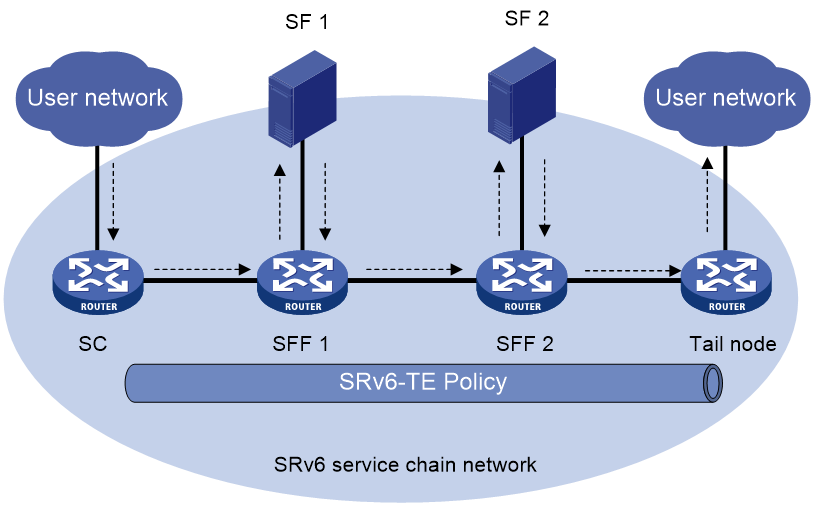

As shown in Figure 1, specific service packets from the user network are steered into the application service nodes in the SRv6 service chain network. After the service nodes process the packets, the packets are forwarded to the destination.
Figure 1 SRv6 service chain network diagram
An SRv6 service chain network contains the following components:
·     Service classifier (SC)—Source node of the SRv6 service chain, which is located at the edge of the SRv6 service chain network. The SC can use multiple methods to steer service data to an SRv6 TE policy tunnel.
·     Service function (SF)—Node that provides specific application services for data traffic. An application service node that cannot recognize SRv6 packets is called an SRv6-unaware SF. An application service node that can recognize SRv6 packets is called an SRv6-aware SF.
·     Service function forwarder (SFF)—Node that acts as a service chain proxy for SFs. Based on the SRv6 decapsulation information of received packets, the SFF forwards the packets to the SFs associated with the SFF. The SFs process the packets, and then return the packets back to the SFF. The SFF determines whether to continue forwarding the packets.

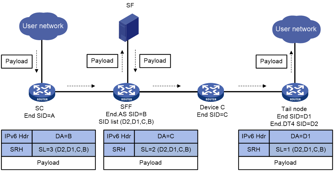

As shown in Figure 2, packets pass through an SRv6 service chain in static proxy mode as follows in an IPv4 L3VPN over SRv6-TE network:
1.     After the SC (source node) receives IPv4 packets from the user network, it steers the packets to an SRv6 TE policy. Then, the SC adds an SRH and outer IPv6 header to the packets according to the SRv6 TE policy. The destination address of the SRv6 packets is the End.AS SID of the SFF. The SRH includes path information in the SRv6 TE policy and the End.DT4 SID of the tail node.
2.     When the SFF receives the SRv6 packets, it looks up the local SID forwarding table and finds that the destination address of the packets is the local End.AS SID. Then, the SFF records the SL value in the packets and performs the following operations:
a.     Removes the outer IPv6 header and SRH from the packets.
b.     Forwards the original packets to the SF through the specified output interface.
3.     After the SF processes the packets, it forwards the packets back to the SFF.
4.     The SFF searches for SID list configuration based on the input interface of the packets or the input interface and inbound VLANs of the packets. Then, the SFF performs the following operations:
a.     Reencapsulates the packets as SRv6 packets according to the configured SID list. The SID list in the SRH must be the same as the path in the SRv6 TE policy on the source node (SC). In addition, the SL value in the SRH decreases by 1 based on the SL value recorded in step 2. The destination address of the SRv6 packets is the SID next to the local End.AS SID, which is the End SID of Device C.
b.     Looks up the IPv6 routing table for a route that can reach the destination IPv6 address in the packets and forwards the packets.
5.     When Device C receives the packets, it looks up the local SID forwarding table and finds that the destination address is the local End SID. Then, Device C processes the packets as follows:
a.     Replaces the destination address with D1 (End SID of the tail node).
b.     Decreases the SL value by 1.
c.     Looks up the IPv6 routing table to forward the packets.
6.     After the tail node receives the packets, it looks up the local SID forwarding table and finds that the destination address is D1 (the local End SID). Then, the tail node performs the following operations:
a.     Replaces the destination address with D2 (End.DT4 SID of the tail node) and decreases the SL value by 1. The SL value changes to 0.
b.     Executes the function of the End.DT4 SID, which is decapsulating the SRv6 packets and forwards the original packets to the public network or the destination VPN instance.

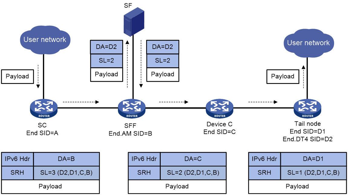

As shown in Figure 3, packets pass through an SRv6 service chain in masquerading mode as follows in an IPv4 L3VPN over SRv6-TE network:
1.     After the SC (source node) receives IPv4 packets from the user network, it steers the packets to an SRv6 TE policy. Then, the SC adds an SRH and outer IPv6 header to the packets according to the SRv6 TE policy. The destination address of the SRv6 packets is the End.AM SID of the SFF. The SRH includes path information in the SRv6 TE policy and the End.DT4 SID of the tail node.
2.     When the SFF receives the SRv6 packets, it looks up the local SID forwarding table and finds that the destination address of the packets is the local End.AM SID. Then, the SFF performs the following operations:
a.     Replaces the destination IP address of the SRv6 packets with the last SID in the SID list of the SRH. The last SID is the End.DT4 SID of the tail node.
c.     Forwards the packets from the output interface bound to the End.AM SID to the SF.
3.     The SF processes the packets without modifying the SRv6 packet headers and forwards the packets back to the SFF.
4.     The packets return back to the SFF. If an End.AM SID is bound to the input interface or both the input interface and VLAN of the packets, the SFF replaces the destination address of the SRv6 packets according to the SL value in the SRH. The SL value is 2, so the SFF replaces the destination address of the SRv6 packets with C (the next SID of the local End.AM SID, which is the End SID of Device C). The SFF looks up the IPv6 routing table to forward the packets according to the destination IPv6 address.
5.     When Device C receives the packets, it looks up the local SID forwarding table and finds that the packet destination address is the local End SID. Then, Device C forwards the packets according to the standard SRv6 traffic forwarding process as follows:
a.     Replaces the packet destination address with D1 (the End SID of the tail node).
6.     When the tail node receives the packets, it looks up the local SID forwarding table and finds that packet destination address D1 is the local End SID. Then, the tail node replaces the destination address with D2 (the End.DT4 SID of the tail node) and decreases the SL value by 1. The SL value changes to 0. Finally, the tail node executes the function of the End.DT4 SID as follows:
a.     Decapsulates the SRv6 packets.
b.     Forwards the original packets to the matching VPN instance or to the public network.

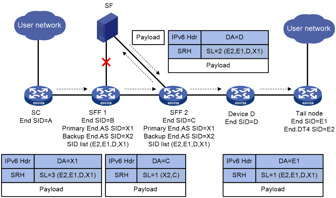

High availability for SRv6 service chains in static proxy mode
IMPORTANT
IMPORTANT:
This feature is not supported by SRv6 service chains in masquerading mode.
About this feature

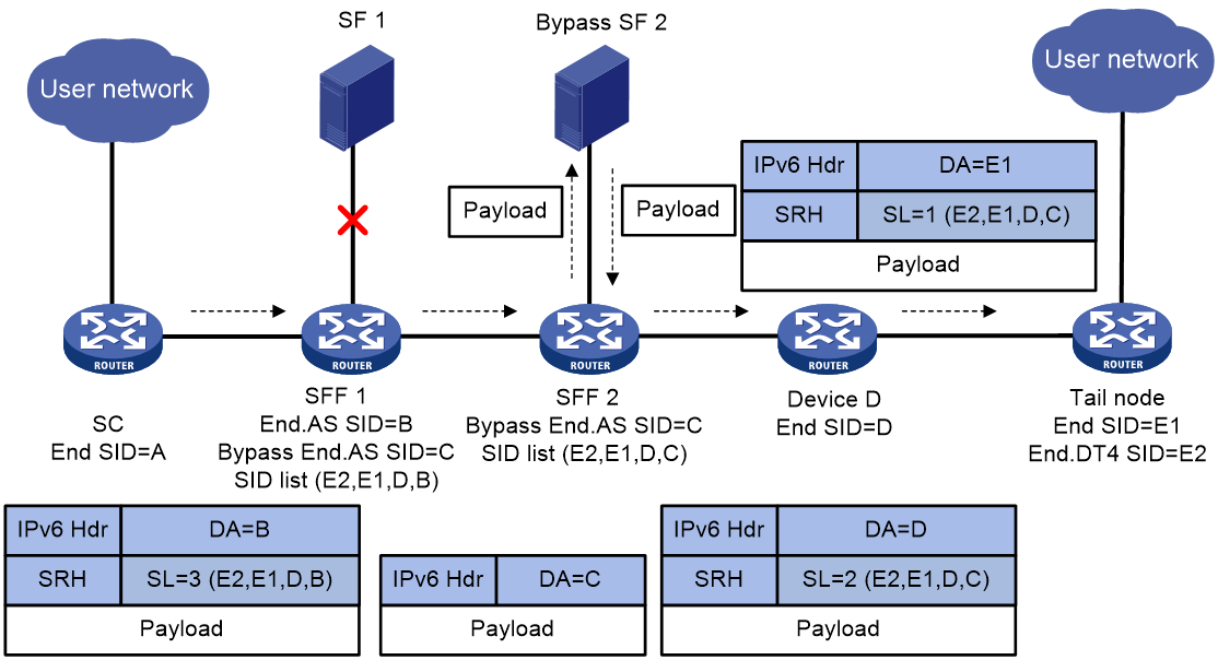

As shown in Figure 4, when the SF is unreachable, the SFF discards the packets that should be forwarded to the SF. These packets cannot bypass the SF to reach Device C.
For high availability, the SFF supports dualhoming protection and bypass protection.
·     Dualhoming protection—An SF is dualhomed to two SFFs, one SFF is the primary SFF and the other is the backup SFF. When the primary SFF cannot reach the SF, it forwards service traffic to the backup SFF.
·     Bypass protection—When an SF fails, packets can bypass the SF to reach the next hop.
Figure 4 Packet forwarding failure caused by unreachable SF

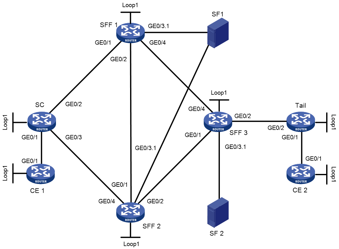

SRv6 service chain traffic forwarding with dualhoming protection

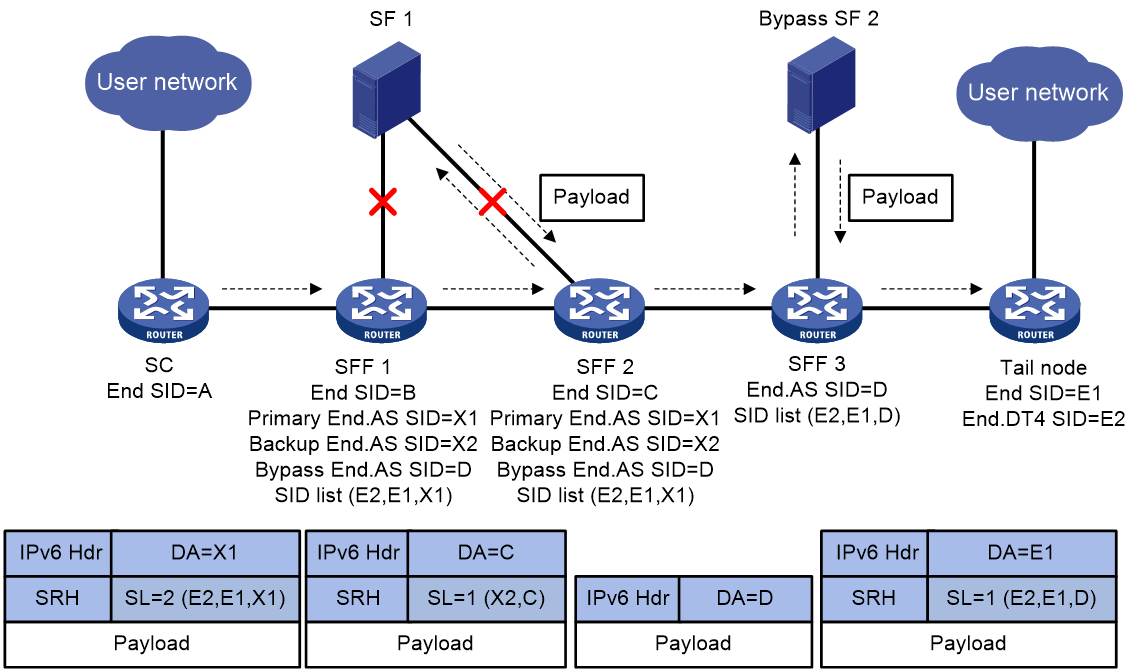

As shown in Figure 5, the SF is dualhomed to SFF 1 and SFF 2. Bypass protection is not configured.
For high availability, perform the following tasks on both SFF 1 and SFF 2:
·     Specify the End SID of one SFF as the backup peer SID of the other SFF.
·     Use the same locator to allocate the primary and backup End.AS SIDs.
·     Configure the same primary and backup End.AS SIDs.
As shown in Figure 5, dualhoming protection acts as follows in packet forwarding:
1.     When SFF 1 detects that it cannot reach the SF, it removes the outer IPv6 header and SRH from packets.
2.     SFF 1 searches the local configuration and reencapsulates an SRH and IPv6 header to the packets. In the SRH, the SID list includes the backup End.AS SID (X2) and the End SID of SFF 2 (C). In the IPv6 header, the destination address is C.
3.     SFF 1 looks up the routing table to forward the packets to the backup SFF SFF 2.
4.     When the packets reach SFF 2, SFF 2 detects whether it can reach the SF.
¡     If SFF 2 can reach the SF, it forwards the packets to the SF as in a standard SRv6 service chain traffic forwarding process in static proxy mode.
¡     If SFF 2 cannot reach the SF, it discards the packets.
Figure 5 SRv6 service chain traffic forwarding with dualhoming protection in static proxy mode

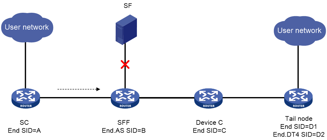

SRv6 service chain traffic forwarding with bypass protection
As shown in Figure 6, in the SRv6 service chain network, SF 1 has a bypass protection node, which is SF 2. SF 1 is single-homed to SFF 1 and the bypass protection node SF 2 is single-homed to SFF 2.
To implement bypass protection, enable bypass protection and specify a bypass End.AS SID on SFF 1.
With a bypass End.AS SID specified, bypass protection acts as follows in packet forwarding:
1.     When SFF 1 detects that it cannot reach SF 1, it removes the outer IPv6 header and SRH from packets.
2.     SFF 1 searches the local configuration and reencapsulates an IPv6 header to the packets. In the IPv6 header, the destination address is C.
3.     SFF 1 looks up the routing table to forward the packets to SFF 2.
4.     After SFF 2 receives the packets, it forwards the packets as in a standard SRv6 service chain traffic forwarding process in static proxy mode.
Without a bypass End.AS SID specified, SFF 1 skips the End.AS SID of SF 1 when it cannot reach SF 1. The SFF uses the End SID of Device D as the next hop destination address. The packets are forwarded to the tail node according to the SRH.
Figure 6 SRv6 service chain traffic forwarding with bypass protection in static proxy mode

¡     If SFF 1 can reach SF 1, it processes the packets as in a standard SRv6 service chain traffic forwarding process in static proxy mode.
¡     If SFF 1 cannot reach SF 1, it removes the outer IPv6 header and SRH from the packets. Then, SFF 1 reencapsulates an SRH and IPv6 header to the packets according to the local configuration. In the SRH, the SID list contains the backup End.AS SID (X2) and the End SID of SFF 2 (C). In the IPv6 header, the destination address is C. Finally, SFF 1 looks up the routing table to forward the packets to SFF 2.
2.     When SFF 2 receives the packets, it processes the packets according to whether it can reach SF 1.
¡     If SFF 2 can reach SF 1, it forwards the packets as in a standard SRv6 service chain traffic forwarding process in static proxy mode.
¡     If SFF 2 cannot reach SF 1, it starts the bypass protection forwarding process. SFF 2 removes the outer IPv6 header and SRH from the packets. According to the local configuration, SFF 2 reencapsulates an SRH and IPv6 header to the packets. In the SRH, the SID list only contains the bypass End.AS SID (D). In the IPv6 header, the destination address is D. Then, SFF 2 looks up the routing table to forward the packets to SFF 3.
3.     When SFF 3 receives the packets, it processes the packets according to whether it can reach the bypass protection node SF 2.
¡     If SFF 3 can reach SF 2, it processes the packets as in a standard SRv6 service chain traffic forwarding process in static proxy mode.
¡     If SFF 3 cannot reach SF 2, it discards the packets.
Figure 7 SRv6 service chain traffic forwarding with dualhoming and bypass protection in static proxy mode

backup-opcode { func-opcode | hex hex-func-opcode }
By default, no backup End.AS SID opcode is specified for SRv6 service chain dualhoming protection in static proxy mode.
The primary and backup End.AS SIDs on both SFFs must belong to the same locator. Use different opcodes to distinguish the primary and backup End.AS SIDs on the SFFs.
Configuring bypass protection for an SRv6 service chain in static proxy mode
Dualhoming protection takes precedence over bypass protection. If dualhoming protection is not available or fails, bypass protection applies.
2.     Enter SRv6 view.
segment-routing ipv6
3.     Enter SRv6 locator view.
locator locator-name [ ipv6-prefix ipv6-address prefix-length [ args args-length | static static-length ] * ]
4.     Enter SRv6 service chain static proxy view.
opcode { opcode | hex hex-opcode } end-as
5.     Enable bypass and specify a bypass End.AS SID.
bypass [ sid ipv6-address ]
By default, bypass is disabled.
To ensure correct packet forwarding when the SF associated with the SFF is unreachable and the network does not have a bypass SF, enable bypass without specifying a bypass End.AS SID. In this case, the SFF skips the End.AS SID of the current SF and uses the next SID in the SRH as the next hop destination address. The data traffic is forwarded to the tail node according to the SRH.

Example: Configuring an SRv6 service chain in static proxy mode with Layer 3 encapsulation
As shown in Figure 10, CE 1 and CE 2 belong to one VPN instance. In the network, deploy an SRv6 service chain in static proxy mode to orchestrate the service traffic from CE 1 to pass through SF 1 to reach CE 2. For high availability, SF 1 is dualhomed to SFF 1 and SFF 2 and SF 2 is the bypass protection node of SF 1.
The SFFs are connected to SFs through Layer 3 Ethernet interfaces. Layer 3 encapsulation is used for packets forwarded between a pair of SFF and SF.
To meet the requirements, perform the following tasks:
·     On the SC and tail node, configure the VPN instance settings and steer service traffic to an SRv6 TE policy. The forwarding path in the policy is SC—> SFF 1 —> SF 1 —> Tail.
·     On SFF 1, SFF 2, and SFF 3, configure an SRv6 service chain in static proxy mode with Layer 3 encapsulation.
·     On SFF 1 and SFF 2, configure dualhoming protection settings. Make sure service chain traffic can be forwarded to SFF 2 when SFF 1 cannot reach SF 1.
·     On SFF 1 and SFF 2, configure bypass protection settings. Make sure SF 2 can provide bypass protection when SF 1 is not reachable.
Figure 10 Network diagram
Device
Interface
IP address
Device
Interface
IP address
SC
Loop1
1::1/128
SFF 1
Loop1
2::2/128
2.2.2.2/32
GE1/0
16.0.0.2/30
GE1/0
100::2/96
GE2/0
100::1/96
GE2/0
300::1/96
GE3/0
200::1/96
GE3/0
10.1.1.2/24
SFF 2
Loop1
3::3/128
3.3.3.3/32
GE4/0
400::1/96
GE1/0
300::2/96
SFF 3
Loop1
4::4/128
4.4.4.4/32
GE2/0
500::1/96
GE1/0
500::2/96
GE3/0
10.1.1.3/24
GE2/0
600::1/96
GE4/0
200::2/96
GE3/0
10.2.1.2/24
SF 1
10.1.1.1/24
GE4/0
400::2/96
SF 2
10.2.1.1/24
CE 1
Loop1
6.6.6.6/32
Tail
Loop1
5::5/128
GE1/0
16.0.0.1/30
GE1/0
57.0.0.1/30
CE 2
Loop1
7.7.7.7/32
GE2/0
600::2/96
GE1/0
57.0.0.2/30
·     Plan SRv6 SIDs on each device.
¡     On the SC, the network of locator a is 1000::/64, the End SID is 1000::1, and the End.DT4 SID is 1000::2.
¡     On SFF 1, the network of locator b is 2000::/64, the End SID is 2000::1, the network of locator as1 is 2001::/64, and the End.AS SID is 2001::1.
¡     On SFF 2, the network of locator c is 3000::/64, the End SID is 3000::1, the network of locator as1 is 2001::/64, and the End.AS SID is 2001::1.
¡     On SFF 3, the network of locator d is 4000::/64, the End SID is 4000::1, the network of locator as2 is 4001::/64, and the End.AS SID is 4001::1.
¡     On the tail node, the network of locator e is 5000::/64, the End SID is 5000::1, and the End.DT4 SID is 5000::2.
·     Plan the traffic forwarding tunnel and the explicit path of the tunnel. In this example, traffic on the SC is forwarded to the tail node through the explicit path of an SRv6 TE policy. In the forwarding path, SFF 1 forwards the traffic to SF 1. SF 1 processes the traffic and forwards the traffic back to SFF 1. When the tail node sends traffic back to the SC, the traffic passes through SFF 2 to reach the SC in the explicit path of the SRv6 TE policy. The traffic is not forwarded to any SF.

[SFF1-GigabitEthernet4/0] quit
# Configure SFF 2.
<SFF2> system-view
[SFF2] isis
[SFF2-isis-1] is-level level-2
[SFF2-isis-1] cost-style wide
[SFF2-isis-1] network-entity 10.3333.3333.3333.00
[SFF2-isis-1] address-family ipv6 unicast
[SFF2-isis-1-ipv6] quit
[SFF2-isis-1] quit
[SFF2] interface loopback 1
[SFF2-LoopBack1] ipv6 address 3::3 128
[SFF2-LoopBack1] isis ipv6 enable
[SFF2-LoopBack1] quit
[SFF2] interface gigabitethernet 1/0
[SFF2-GigabitEthernet1/0] ipv6 address 300::2 96
[SFF2-GigabitEthernet1/0] isis ipv6 enable
[SFF2-GigabitEthernet1/0] quit
[SFF2] interface gigabitethernet 2/0
[SFF2-GigabitEthernet2/0] ipv6 address 500::1 96
[SFF2-GigabitEthernet2/0] isis ipv6 enable
[SFF2-GigabitEthernet2/0] quit
[SFF2] interface gigabitethernet 4/0
[SFF2-GigabitEthernet4/0] ipv6 address 200::2 96
[SFF2-GigabitEthernet4/0] isis ipv6 enable
[SFF2-GigabitEthernet4/0] quit
# Configure SFF 3.
<SFF3> system-view
[SFF3] isis
[SFF3-isis-1] is-level level-2
[SFF3-isis-1] cost-style wide
[SFF3-isis-1] network-entity 10.4444.4444.4444.00
[SFF3-isis-1] address-family ipv6 unicast
[SFF3-isis-1-ipv6] quit
[SFF3-isis-1] quit
[SFF3] interface loopback 1
[SFF3-LoopBack1] ipv6 address 4::4 128
[SFF3-LoopBack1] isis ipv6 enable
[SFF3-LoopBack1] quit
[SFF3] interface gigabitethernet 1/0
[SFF3-GigabitEthernet1/0] ipv6 address 500::2 96
[SFF3-GigabitEthernet1/0] isis ipv6 enable
[SFF3-GigabitEthernet1/0] quit
[SFF3] interface gigabitethernet 2/0
[SFF3-GigabitEthernet2/0] ipv6 address 600::1 96
[SFF3-GigabitEthernet2/0] isis ipv6 enable
[SFF3-GigabitEthernet2/0] quit
[SFF3] interface gigabitethernet 4/0
[SFF3-GigabitEthernet4/0] ipv6 address 400::2 96
[SFF3-GigabitEthernet4/0] isis ipv6 enable
[SFF3-GigabitEthernet4/0] quit
# Configure the tail node.
<Tail> system-view
[Tail] isis
[Tail-isis-1] is-level level-2
[Tail-isis-1] cost-style wide
[Tail-isis-1] network-entity 10.5555.5555.5555.00
[Tail-isis-1] address-family ipv6 unicast
[Tail-isis-1-ipv6] quit
[Tail-isis-1] quit
[Tail] interface loopback 1
[Tail-LoopBack1] ipv6 address 5::5 128
[Tail-LoopBack1] isis ipv6 enable
[Tail-LoopBack1] quit
[Tail] interface gigabitethernet 2/0
[Tail-GigabitEthernet2/0] ipv6 address 600::2 96
[Tail-GigabitEthernet2/0] isis ipv6 enable
[Tail-GigabitEthernet2/0] quit
# Verify that the SC, SFF 1, SFF 2, SFF 3, and the tail node can establish IPv6 IS-IS neighbor relationship with each other. Execute the display isis peer command on each device to verify that the neighbors are in up state. (Details not shown.)
# Execute the display isis route ipv6 command on the SC and tail node to verify that they have learned the routes of loopback interfaces to reach each other. (Details not shown.)
2.     On the SC and tail node, configure VPN instance settings to allow CE 1 and CE 2 to access the SC and tail node, respectively, in a VPN instance:
# Configure the SC.
[SC] ip vpn-instance vpn1
[SC-vpn-instance-vpn1] route-distinguisher 100:1
[SC-vpn-instance-vpn1] vpn-target 111:1
[SC-vpn-instance-vpn1] quit
[SC] interface gigabitethernet 1/0
[SC-GigabitEthernet1/0] ip binding vpn-instance vpn1
[SC-GigabitEthernet1/0] ip address 16.0.0.2 30
[SC-GigabitEthernet1/0] quit
[Tail] ip vpn-instance vpn1
[Tail-vpn-instance-vpn1] route-distinguisher 100:1
[Tail-vpn-instance-vpn1] vpn-target 111:1
[Tail-vpn-instance-vpn1] quit
[Tail] interface gigabitethernet 1/0
[Tail-GigabitEthernet1/0] ip binding vpn-instance vpn1
[Tail-GigabitEthernet1/0] ip address 57.0.0.1 24
[Tail-GigabitEthernet1/0] quit
# Configure IP addresses for interfaces on the CEs. (Details not shown.)
# On the SC and tail node (PEs), display VPN instance configuration to verify that the configuration is correct. Verify that the SC and tail node can ping their CEs.
This step uses the SC and CE 1 as an example.
[SC] display ip vpn-instance
  Total VPN-Instances configured : 1
  Total IPv4 VPN-Instances configured : 1
  Total IPv6 VPN-Instances configured : 1
  VPN-Instance Name     RD              Address family      Create time
  vpn1                  100:1           IPv4/IPv6           2020/10/29 13:59:39
[SC] ping -vpn-instance vpn1 16.0.0.1
Ping 16.0.0.1 (16.0.0.1): 56 data bytes, press CTRL+C to break
56 bytes from 16.0.0.1: icmp_seq=0 ttl=255 time=2.000 ms
56 bytes from 16.0.0.1: icmp_seq=1 ttl=255 time=0.000 ms
56 bytes from 16.0.0.1: icmp_seq=2 ttl=255 time=1.000 ms
56 bytes from 16.0.0.1: icmp_seq=3 ttl=255 time=0.000 ms
56 bytes from 16.0.0.1: icmp_seq=4 ttl=255 time=0.000 ms
--- Ping statistics for 16.0.0.1 in VPN instance vpn1 ---
round-trip min/avg/max/std-dev = 0.000/0.600/2.000/0.800 ms
3.     Configure the SC and tail node to establish EBGP peer relationship with their connected CEs and redistribute VPN routes:
# Configure CE 1.
<CE1> system-view
[CE1] bgp 65410
[CE1-bgp-default] peer 16.0.0.2 as-number 100
[CE1-bgp-default] address-family ipv4 unicast
[CE1-bgp-default-ipv4] peer 16.0.0.2 enable
[CE1-bgp-default-ipv4] import-route direct
[CE1-bgp-default-ipv4] quit
[CE1-bgp-default] quit
# Configure CE 2 in the same way as CE 1 is configured. (Details not shown.)
# Configure the SC.
[SC] bgp 100
[SC-bgp-default] router-id 1.1.1.1
[SC-bgp-default] ip vpn-instance vpn1
[SC-bgp-default-vpn1] peer 16.0.0.1 as-number 65410
[SC-bgp-default-vpn1] address-family ipv4 unicast
[SC-bgp-default-ipv4-vpn1] peer 16.0.0.1 enable
[SC-bgp-default-ipv4-vpn1] quit
[SC-bgp-default-vpn1] quit
# Configure the tail node in the same way as the SC is configured. (Details not shown.)
# On the SC and tail node, execute the display bgp peer ipv4 vpn-instance command to verify that they have established BGP peer relationship with their connected CEs. The peer relationship is in Established state. (Details not shown.)
4.     Establish VPNv4 peer relationship between the SC and tail node:
# Configure the SC.
[SC] bgp 100
[SC-bgp-default] peer 5::5 as-number 100
[SC-bgp-default] peer 5::5 connect-interface loopback 1
[SC-bgp-default] address-family vpnv4
[SC-bgp-default-vpnv4] peer 5::5 enable
[SC-bgp-default-vpnv4] quit
[SC-bgp-default] quit
[Tail] bgp 100
[Tail-bgp-default] peer 1::1 as-number 100
[Tail-bgp-default] peer 1::1 connect-interface loopback 1
[Tail-bgp-default] address-family vpnv4
[Tail-bgp-default-vpnv4] peer 1::1 enable
[Tail-bgp-default-vpnv4] quit
[Tail-bgp-default] quit
# On the SC and tail node, execute the display bgp peer vpnv4 command to verify that they have established VPNv4 peer relationship with each other. The peer relationship is in Established state. (Details not shown.)
5.     Configure End SIDs and End.DT4 SIDs, and advertise the locators of the SIDs by using an IGP:
# Configure the SC.
[SC] segment-routing ipv6
[SC-segment-routing-ipv6] encapsulation source-address 11::11
[SC-segment-routing-ipv6] locator a ipv6-prefix 1000::1 64 static 32
[SC-segment-routing-ipv6-locator-a] opcode 1 end
[SC-segment-routing-ipv6-locator-a] opcode 2 end-dt4 vpn-instance vpn1
[SC-segment-routing-ipv6-locator-a] quit
[SC-segment-routing-ipv6] quit
[SC] isis 1
[SC-isis-1] address-family ipv6 unicast
[SC-isis-1-ipv6] segment-routing ipv6 locator a
[SC-isis-1-ipv6] quit
[SC-isis-1] quit
# Configure SFF 1.
[SFF1] segment-routing ipv6
[SFF1-segment-routing-ipv6] encapsulation source-address 22::22
[SFF1-segment-routing-ipv6] locator b ipv6-prefix 2000::1 64 static 32
[SFF1-segment-routing-ipv6-locator-b] opcode 1 end
[SFF1-segment-routing-ipv6-locator-b] quit
[SFF1-segment-routing-ipv6] quit
[SFF1] isis 1
[SFF1-isis-1] address-family ipv6 unicast
[SFF1-isis-1-ipv6] segment-routing ipv6 locator b
[SFF1-isis-1-ipv6] quit
[SFF1-isis-1] quit
# Configure SFF 2.
[SFF2] segment-routing ipv6
[SFF2-segment-routing-ipv6] encapsulation source-address 33::33
[SFF2-segment-routing-ipv6] locator c ipv6-prefix 3000::1 64 static 32
[SFF2-segment-routing-ipv6-locator-c] opcode 1 end
[SFF2-segment-routing-ipv6-locator-c] quit
[SFF2-segment-routing-ipv6] quit
[SFF2] isis 1
[SFF2-isis-1-ipv6] segment-routing ipv6 locator c
[SFF2-isis-1] quit
# Configure SFF 3.
[SFF3] segment-routing ipv6
[SFF3-segment-routing-ipv6] encapsulation source-address 44::44
[SFF3-segment-routing-ipv6] locator d ipv6-prefix 4000::1 64 static 32
[SFF3-segment-routing-ipv6-locator-d] opcode 1 end
[SFF3-segment-routing-ipv6-locator-d] quit
[SFF3-segment-routing-ipv6] quit
[SFF3] isis 1
[SFF3-isis-1-ipv6] segment-routing ipv6 locator d
[SFF3-isis-1] quit
[Tail] segment-routing ipv6
[Tail-segment-routing-ipv6] encapsulation source-address 55::55
[Tail-segment-routing-ipv6] locator e ipv6-prefix 5000::1 64 static 32
[Tail-segment-routing-ipv6-locator-e] opcode 1 end
[Tail-segment-routing-ipv6-locator-e] opcode 2 end-dt4 vpn-instance vpn1
[Tail-segment-routing-ipv6-locator-e] quit
[Tail-segment-routing-ipv6] quit
[Tail] isis 1
[Tail-isis-1-ipv6] segment-routing ipv6 locator e
[Tail-isis-1] quit
# On the SC and tail node, verify that the End.DT4 SIDs have been redistributed to the routing table and SRv6 routes have been generated. This example only displays the routing table information on the SC.
[SC] display ipv6 routing-table protocol srv6
Summary count : 8
SRv6 Routing table status : <Active>
Summary count : 8
Destination: 1000::2/128                                Protocol  : SRv6
NextHop    : ::1                                         Preference: 4
Interface  : InLoop0                                     Cost      : 0
SRv6 Routing table status : <Inactive>
Summary count : 0
6.     On the SC and tail node, add End.DT4 SIDs to private network routes, exchange End.DT4 SIDs between peers, and allow the devices to recurse private network routes to End.DT4 SID routes:
# Configure the SC.
[SC] bgp 100
[SC-bgp-default-vpnv4] peer 5::5 prefix-sid
[SC-bgp-default-ipv4-vpn1] segment-routing ipv6 locator a
[SC-bgp-default-ipv4-vpn1] segment-routing ipv6 traffic-engineering best-effort
[Tail] bgp 100
[Tail-bgp-default-vpnv4] peer 1::1 prefix-sid
[Tail-bgp-default] ip vpn-instance vpn1
[Tail-bgp-default-vpn1] address-family ipv4 unicast
[Tail-bgp-default-ipv4-vpn1] segment-routing ipv6 locator e
[Tail-bgp-default-ipv4-vpn1] segment-routing ipv6 traffic-engineering best-effort
[Tail-bgp-default-ipv4-vpn1] quit
[Tail-bgp-default-vpn1] quit
# On the SC, display detailed information about the VPNv4 route advertised by the tail node to verify that the route has SRv6 SID attribute data. On the tail node, display detailed information about the VPNv4 route advertised by the SC to verify that the route has SRv6 SID attribute data. If the SC and tail node have received the VPNv4 routes that carry SRv6 SID attribute data from each other, they have established an SRv6-BE tunnel.
This example only displays information on the SC.
[SC] display bgp routing-table vpnv4 7.7.7.7
 BGP local router ID: 1.1.1.1
 Local AS number: 100
 Route distinguisher: 100:1(vpn1)
 Total number of routes: 1
 Paths:   1 available, 1 best
 BGP routing table information of 7.7.7.7/32:
 From            : 5::5 (5.5.5.5)
 Rely nexthop    : FE80::2A96:34FF:FE9D:216
 Original nexthop: 5::5
 Out interface   : GigabitEthernet2/0
 Route age       : 00h14m23s
 OutLabel        : 3
 Ext-Community   : <RT: 111:1>
 RxPathID        : 0x0
 TxPathID        : 0x0
 PrefixSID       : End.DT4 SID <5000::2>
 AS-path         : 65420
 Origin          : incomplete
 Attribute value : MED 0, localpref 100, pref-val 0
 State           : valid, internal, best
 IP precedence   : N/A
 QoS local ID    : N/A
 Traffic index   : N/A
 Tunnel policy   : NULL
 Rely tunnel IDs : N/A
7.     On the SC and tail node, configure an SRv6 TE policy tunnel:
IMPORTANT
IMPORTANT:
Traffic from the SC to the tail node is forwarded to an SF for processing. Traffic from the tail node to the SC is not forwarded to any SF.
# Configure the SC.
[SC-segment-routing-ipv6] traffic-engineering
[SC-srv6-te] srv6-policy locator a
[SC-srv6-te] segment-list s1
[SC-srv6-te-sl-s1] index 10 ipv6 2001::1
[SC-srv6-te-sl-s1] index 20 ipv6 5000::1
[SC-srv6-te-sl-s1] quit
[SC-srv6-te] policy p1
[SC-srv6-te-policy-p1] color 10 end-point ipv6 5::5
[SC-srv6-te-policy-p1] candidate-paths
[SC-srv6-te-policy-p1-path] preference 10
[SC-srv6-te-policy-p1-path-pref-10] explicit segment-list s1
[SC-srv6-te-policy-p1-path-pref-10] quit
[SC-srv6-te-policy-p1-path] quit
[SC-srv6-te-policy-p1] quit
[SC-srv6-te] quit
[Tail-segment-routing-ipv6] traffic-engineering
[Tail-srv6-te] srv6-policy locator e
[Tail-srv6-te] segment-list s2
[Tail-srv6-te-sl-s2] index 10 ipv6 3000::1
[Tail-srv6-te-sl-s2] index 20 ipv6 1000::1
[Tail-srv6-te-sl-s2] quit
[Tail-srv6-te] policy p1
[Tail-srv6-te-policy-p1] color 10 end-point ipv6 1::1
[Tail-srv6-te-policy-p1] candidate-paths
[Tail-srv6-te-policy-p1-path] preference 10
[Tail-srv6-te-policy-p1-path-pref-10] explicit segment-list s2
[Tail-srv6-te-policy-p1-path-pref-10] quit
[Tail-srv6-te-policy-p1-path] quit
[Tail-srv6-te-policy-p1] quit
[Tail-srv6-te] quit
# On the SC and tail node, display detailed information about the SRv6 TE policy tunnel.
[SC] display segment-routing ipv6 te policy
