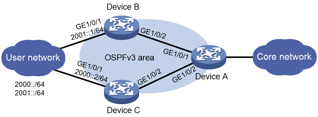

Benefits
As shown in Figure 1, asymmetric routing might occur in an IPv6 multiple-access network. The outgoing interface for a return packet might be different from the incoming interface of the original packet. You can enable strict uRPF check on interface 1 of Device B to prevent attacks with spoofed source IPv6 addresses. However, strict uRPF check might determine that a valid packet from the LAN as an attack packet based on local routing information, which causes unexpected packet drop.
Compared with uRPF, SAVA can not only prevent source IPv6 address spoofing attacks but also avoid mistaken packet drop caused by asymmetric routing. When SAVA is enabled on interface 1 of both Device A and Device B, the devices can create SAVA entries based on local routes and remote routes synchronized from other routing protocols. In this way, both the devices have consistent SAVA entries. This ensures that packets of valid users will not be mistakenly dropped on either a asymmetric network or a symmetric network with asymmetric routing.
Figure 1 SAVA-enabled network

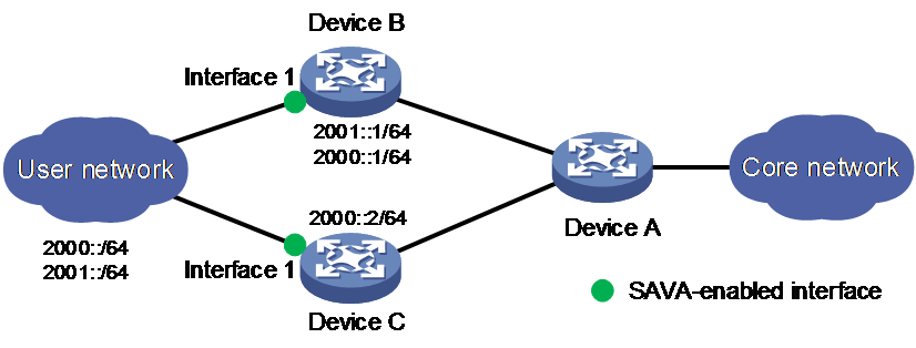

Application scenarios
Deployed on intra-AS border devices directedly connected to the LAN
As shown in Figure 2, users in the LAN connect to the backbone network through Device B and Device C. Device B is configured with two gateways addresses (2000::1/64 and 2001::1/64). Device C is configured with the gateway address (2000::2/64).
You can configure SAVA on interface 1 of both Device B and Device C. When Device C receives an IPv6 route with prefix 2001::/64 from Device B, it creates an SAVA entry with this prefix. Then, upon receiving an IPv6 packet from a user at 2001::/64, Device C will permit the packet because a matching SAVA entry exists.
Figure 2 SAVA deployed on border devices directly connected to the LAN

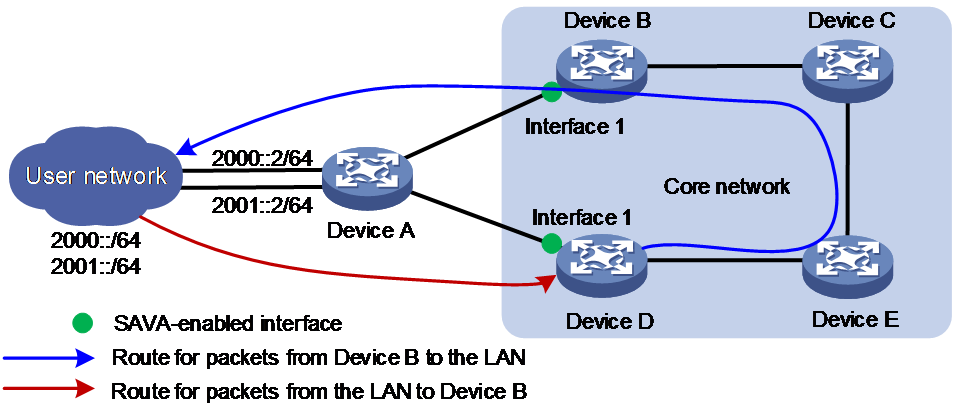

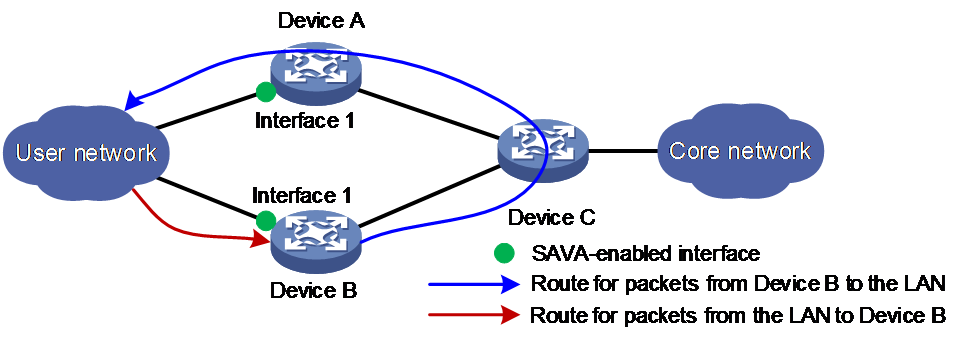

Deployed on intra-AS border devices indirectedly connected to the LAN
As shown in Figure 3, asymmetric traffic exists between Device D and the LAN after route convergence. Traffic from Device D to the LAN will traverse Device E, Device C, Device B, and Device A. Traffic from the LAN to Device D will traverse only Device A.
You can configure SAVA on interface 1 of both Device B and Device D. Device B and Device D synchronize routes with each other, obtain prefix information of the LAN based on the synchronized remote routes, and then create SAVA entries. Upon receiving a packet from a user in the LAN, Device C will permit the packet because a matching SAVA entry exists.
Figure 3 SAVA deployed on intra-AS border devices indirectly connected to the LAN

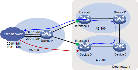

Deployed on inter-AS border devices indirectedly connected to the LAN
As shown in Figure 4, asymmetric traffic exists between Device D and the LAN after route convergence. Traffic from Device D to the LAN will traverse Device E, Device C, Device B, and Device A. Traffic from the LAN to Device D will traverse only Device A.
You can configure SAVA on interface 1 of both Device B and Device D. Device B and Device C in AS 100 as well as Device D and Device E in AS 200 synchronize local routes with each other through an IGP protocol (OSPFv3, for example). Then, Device C in AS 100 and Device E in AS 200 synchronize routes with each other through BGP. Upon receiving a packet from a user in the LAN, Device C will permit the packet because a matching SAVA entry exists.
Figure 4 SAVA deployed on inter-AS border devices indirectly connected to the LAN

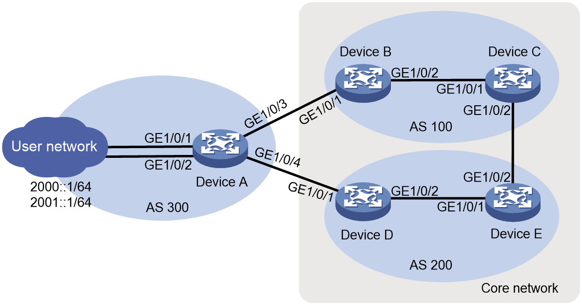

Example: Configuring SAVA on border devices indirectly connected the LAN (OSPFv3)
As shown in Figure 6, OSPFv3 runs on the core network. Configure the devices to meet the following requirements:
Enable SAVA on GigabitEthernet1/0/1 of Device B and Device D to filter packets based on SAVA entries.
On Device C, configure a static route to the LAN with next-hop device Device A. Enable OSPFv3 link tag inheritance to statically tag routes to the LAN.
Configure OSPFv3 on Device B and Device A to synchronize routes to the LAN. Enable OSPFv3 link tag inheritance and set the OSPFv3 link tag to dynamically tag routes to the LAN.
Figure 6 Network diagram

Example: Configuring SAVA on border devices indirectly connected the LAN (IPv6 IS-IS)
As shown in Figure 7, IPv6 IS-IS runs on the core network. Configure the devices to meet the following requirements:
On Device C, configure a static route to the LAN with next-hop device Device A. Enable IPv6 IS-IS link tag inheritance to statically tag routes to the LAN.
Configure IPv6 IS-IS on Device B and Device A to synchronize routes to the LAN. Enable IPv6 IS-IS link tag inheritance and set the IPv6 IS-IS link tag to dynamically tag routes to the LAN.
Figure 7 Network diagram
Table 3 Interface and IP address assignment
Device
Interface
IP address
Device
Interface
IP address
Device A
GE1/0/1
2001::2/64
Device B
GE1/0/1
192:168::12:2/120
Device A
GE1/0/2
2000::2/64
Device B
GE1/0/2
192:168::34:3/120
Device A
GE1/0/3
192:168::12:1/120
Device A
GE1/0/4
192:168::22:1/120
Device C
GE1/0/1
192:168::34:4/120
Device D
GE1/0/1
192:168::22:2/120
Device C
GE1/0/2
192:168::46:4/120
Device D
GE1/0/2
192:168::56:5/120
Device E
GE1/0/1
192:168::56:6/120
Device E
GE1/0/2
192:168::46:6/120
Assign IPv6 addresses to interfaces on the devices.

Example: Configuring SAVA on inter-AS border devices indirectly connected the LAN
As shown in Figure 8, configure the devices to meet the following requirements:
Configure SAVA on GigabitEthernet1/0/1 of Device B and Device D to filter packets based on SAVA entries.
Configure remote route tagging. Device B and Device C in AS 100 and Device D and Device E in AS 200 exchange routes through IGP (for example, OSPFv3). Device C and Device E in different ASs exchange routes through BGP. The devices create SAVA entries based on the synchronized remote routes.
Figure 8 Network diagram
Table 4 Interface and IP address assignment
Device
Interface
IP address
Device
Interface
IP address
Device A
GE1/0/1
2001::2/64
Device B
GE1/0/1
192:168::12:2/120
Device A
GE1/0/2
2000::2/64
Device B
GE1/0/2
192:168::23:2/120
Device A
GE1/0/3
192:168::12:1/120
Device A
GE1/0/4
192:168::22:1/120
Device C
GE1/0/1
192:168::23:3/120
Device D
GE1/0/1
192:168::22:2/120
Device C
GE1/0/2
192:168::34:3/120
Device D
GE1/0/2
192:168::45:4/120
Device E
GE1/0/1
192:168::45:5/120
Device E
GE1/0/2
192:168::34:4/120

[DeviceD-GigabitEthernet1/0/2] ospfv3 1 area 0.0.0.0
[DeviceD-GigabitEthernet1/0/2] quit
# Configure OSPFv3 process 1 to redistribute remote routes permitted by routing policy sava.
[DeviceD] ospfv3 1
[DeviceD-ospfv3-1] import-route static route-policy sava
[DeviceD-ospfv3-1] quit
# Enable SAVA on GigabitEthernet1/0/1.
[DeviceD] interface gigabitethernet 1/0/1
[DeviceD-GigabitEthernet1/0/1] ipv6 sava enable
# Configure GigabitEthernet1/0/1 to redistribute remote routes with route tag 100.
[DeviceD-GigabitEthernet1/0/1] ipv6 sava import remote-route-tag 100
[DeviceD-GigabitEthernet1/0/1] quit
3.     Configure Device C:
# Configure routing policy named sava-exp, configure node 0 in permit mode to permit routes with tag 100 and to set the 10:10 community attribute for BGP.
[DeviceC] route-policy sava-exp permit node 0
[DeviceC-route-policy-sava-exp-0] if-match tag 100
[DeviceC-route-policy-sava-exp-0] apply community 10:10
[DeviceC-route-policy-sava-exp-0] quit
# Enable BGP to exchange routing information for IPv6 address family with peer 192:168::34:4 in AS 200.
[DeviceC] bgp 100
[DeviceC-bgp-default] router-id 3.3.3.3
[DeviceC-bgp-default] peer 192:168::34:4 as 200
[DeviceC-bgp-default] address-family ipv6
[DeviceC-bgp-default-ipv6] peer 192:168::34:4 enable
[DeviceC-bgp-default-ipv6] peer 192:168::34:4 advertise-community
# Configure BGP to redistribute routes from OSPFv3 process 1, and apply routing policy sava-exp to routes outgoing to peer 192:168::34:4.
[DeviceC-bgp-default-ipv6] import-route ospfv3 1
[DeviceC-bgp-default-ipv6] peer 192:168::34:4 route-policy sava-exp export
[DeviceC-bgp-default-ipv6] quit
[DeviceC-bgp-default] quit
# Configure basic community list 1 to permit routes with the 10:10 community attribute.
[DeviceC] ip community-list 1 permit 10:10
# Configure a routing policy named sava-imp, and configure node 10 in permit mode for the routing policy to use community list 1 to match BGP routes and to set the tag to 100.
[DeviceC] route-policy sava-imp permit node 0
[DeviceC-route-policy-sava-imp-0] if-match community 1
[DeviceC-route-policy-sava-imp-0] apply tag 100
[DeviceC-route-policy-sava-imp-0] quit
# Apply routing policy sava-imp to routes incoming from peer 192:168::34:4.
[DeviceC] bgp 100
[DeviceC-bgp-default-ipv6] peer 192:168::34:4 route-policy sava-imp import
# Configure OSPFv3.
[DeviceC] ospfv3 1
[DeviceC-ospfv3-1] router-id 3.3.3.3
[DeviceC-ospfv3-1] quit
[DeviceC] interface gigabitethernet 1/0/1
[DeviceC-GigabitEthernet1/0/1] ospfv3 1 area 0.0.0.0
[DeviceC-GigabitEthernet1/0/1] quit
# Configure OSPFv3 process 1 to redistribute routes from IPv6 BGP.
[DeviceC] ospfv3 1
[DeviceC-ospfv3-1] import-route bgp4+
4.     Configure Device E:
[DeviceE] route-policy sava-exp permit node 0
[DeviceE-route-policy-sava-exp-0] if-match tag 100
[DeviceE-route-policy-sava-exp-0] apply community 10:10
[DeviceE-route-policy-sava-exp-0] quit
# Enable BGP to exchange routing information for IPv6 address family with peer 192:168::34:3 in AS 100.
[DeviceE] bgp 200
[DeviceE-bgp-default] router-id 5.5.5.5
[DeviceE-bgp-default] peer 192:168::34:3 as 100
[DeviceE-bgp-default] address-family ipv6
[DeviceE-bgp-default-ipv6] peer 192:168::34:3 enable
[DeviceE-bgp-default-ipv6] peer 192:168::34:3 advertise-community
# Configure BGP to redistribute routes from OSPFv3 process 1, and apply routing policy sava-exp to routes outgoing to peer 192:168::34:3.
[DeviceE-bgp-default-ipv6] import-route ospfv3
[DeviceE-bgp-default-ipv6] peer 192:168::34:3 route-policy sava-exp export
[DeviceE-bgp-default-ipv6] quit
[DeviceE-bgp-default] quit
[DeviceE] ip community-list 1 permit 10:10
[DeviceE] route-policy sava-imp permit node 0
[DeviceE-route-policy-sava-imp-0] if-match community 1
[DeviceE-route-policy-sava-imp-0] apply tag 100
[DeviceE-route-policy-sava-imp-0] quit
[DeviceE] bgp 200
[DeviceE-bgp-default-ipv6] peer 192:168::34:3 route-policy sava-imp import
# Configure OSPFv3.
[DeviceE] ospfv3 1
[DeviceE-ospfv3-1] router-id 5.5.5.5
[DeviceE-ospfv3-1] quit
[DeviceE] interface gigabitethernet 1/0/1
[DeviceE-GigabitEthernet1/0/1] ospfv3 1 area 0.0.0.0
[DeviceE-GigabitEthernet1/0/1] quit
[DeviceE] ospfv3 1
[DeviceE-ospfv3-1] import-route bgp4+
# Display SAVA entries on Device D.
[DeviceD] display ipv6 sava
IPv6 SAVA entry count: 3
Destination:192:168::22:0                                  Prefix length: 120
Interface: GE1/0/1                                         Flags: L
VPN instance: --
Destination: 2000::                                        Prefix length: 64
VPN instance: --
Destination: 2001::                                        Prefix length: 64
Interface: GE1/0/1                                         Flags: R
VPN instance: --
The output shows that Device D created SAVA entries with prefix 2000:: and 2001::. When Device D receives an IPv6 packet with prefix 2000:: or 2001:: on GigabitEthernet1/0/1, it will forward the packet.
# Display SAVA entries on Device B.
[DeviceB] display ipv6 sava
Destination:192:168::12:0                                  Prefix length: 120
Interface: GE1/0/2                                         Flags: L
VPN instance: --
Interface: GE1/0/2                                         Flags: R
VPN instance: --
VPN instance: --
The output shows that Device B created SAVA entries with prefix 2000:: and 2001::. When Device B receives an IPv6 packet with prefix 2000:: or 2001:: on GigabitEthernet1/0/1, it will forward the packet.
