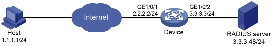

Figure 1 IPsec protection in transport mode

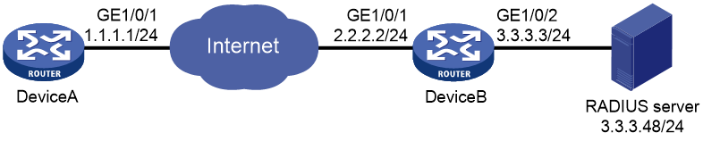

The security protocols protect the entire IP packet. The entire IP packet is used to calculate the security protocol headers. The calculated security protocol headers and the encrypted data (only for ESP encapsulation) are encapsulated in a new IP packet. In this mode, the encapsulated packet has two IP headers. The inner IP header is the original IP header. The outer IP header is added by the network device that provides the IPsec service. You must use the tunnel mode when the secured transmission start and end points are not the actual start and end points of the data packets (for example, when two gateways provide IPsec but the data start and end points are two hosts behind the gateways). The tunnel mode is typically used for protecting gateway-to-gateway communications, as shown in Figure 2.
Figure 2 IPsec protection in tunnel mode

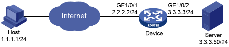

Figure 4 Tunnel interface encapsulation
As shown in Figure 4, a tunnel interface encapsulates an IP packet as follows:
1.     Upon receiving a clear text packet, the input interface sends the packet to the forwarding module for routing.
2.     If the packet requires IPsec protection, the forwarding module sends the packet to the tunnel interface.
3.     The tunnel interface encapsulates the packet into a new IP packet. The source and destination IP addresses in the new IP header are the source and destination IP addresses of the tunnel interface. Then, the tunnel interface sends the packet back to the forwarding module.
4.     The forwarding module looks up the routing table again and sends the packet out of the physical interface of the tunnel interface.

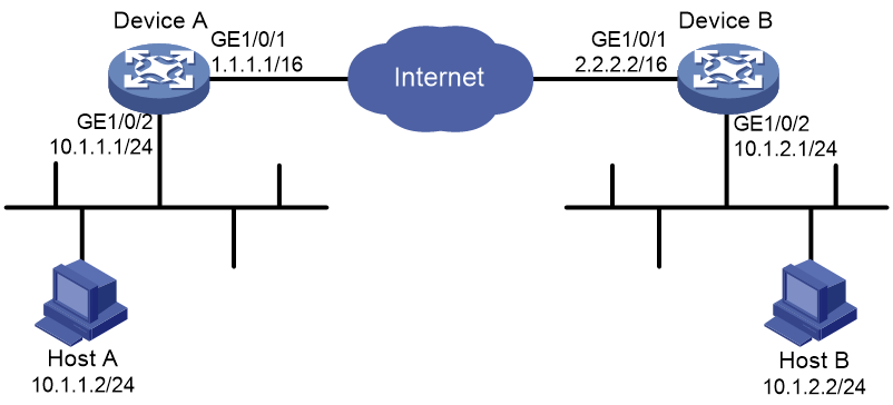

Figure 5 Tunnel interface de-encapsulation
As shown in Figure 5, a tunnel interface de-encapsulates an IP packet as follows:
1.     Upon receiving an encrypted packet, the inbound interface sends the packet to the forwarding module for routing.
2.     Because the packet is destined for the tunnel interface' source address and the payload protocol is AH or ESP, the forwarding module sends the packet to the tunnel interface.
3.     The tunnel interface de-encapsulates the packet (removes the outer IP header) and sends the de-encapsulated packet back to the forwarding module.
4.     The forwarding module looks up the routing table again and sends the packet out of the output interface.

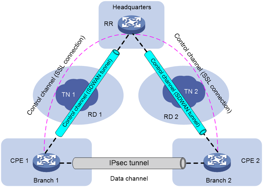

Figure 6 SDWAN network diagram
As shown in Figure 6, an SDWAN network comprises control channels and data channels. Each CPE generates an IPsec SA and advertises the IPsec SA to other CPEs through the RR's control channels. When there is data to be transmitted between CPEs over the data channel, the CPEs use the IPsec SAs to protect the transmitted data.
For example, when CPE 1 sends packets to CPE 2, CPE 1 first encrypts the packets by using the IPsec SA of CPE 2 and then sends the encrypted packets to CPE 2. After CPE 2 receives the packets, it uses its own IPsec SA to decrypt the packets and discards the unencrypted packets. When CPE 2 sends packets to CPE 1, CPE 2 first encrypts the packets by using the IPsec SA of CPE 1 and then sends the encrypted packets to CPE 1. After CPE 1 receives the packets, it uses its own IPsec SA to decrypt the packets and discards the unencrypted packets.
IPsec SAs are unidirectional. Packet encryption and decryption use different IPsec SAs. Typically, the device uses the locally generated IPsec SAs for encryption and the IPsec SAs received from remote devices for decryption.
Hereinafter, the locally generated IPsec SAs are referred to as local IPsec SAs and the IPsec SAs received from remote devices are referred to as remote IPsec SAs.

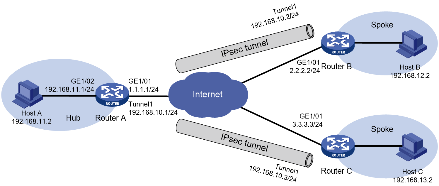

IPsec RRI
IPsec Reverse Route Injection (RRI) enables an IPsec tunnel gateway to automatically add and delete static routes destined for the protected private networks. It automatically adds the static routes when the IPsec SAs are established and deletes the static routes when the IPsec SAs are deleted. This greatly reduces the static route configuration work load on the gateway and increases the scalability of the IPsec VPN.
IPsec RRI is applicable to gateways that must provide many IPsec tunnels (for example, a headquarters gateway).

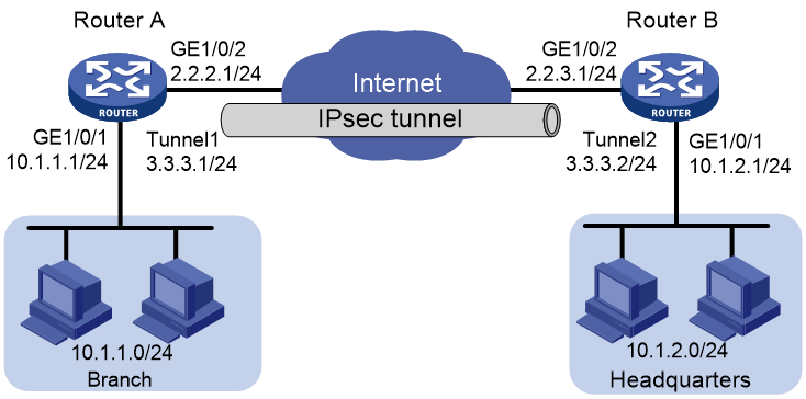

As shown in Figure 7, the traffic between the enterprise center and the branches are protected by IPsec. The gateway at the enterprise center is configured with static routes to route traffic to the IPsec-protected interfaces. It is difficult to add or modify static routes on the gateway at the enterprise center if the IPsec VPN has a large number of branches or if the network structure changes.
Figure 7 IPsec VPN
After you can enable IPsec RRI on the gateway, the gateway automatically adds a static route to the routing table each time an IPsec tunnel is established. The destination IP address is the protected private network. The next hop IP address can be the remote IP address of the IPsec tunnel (default) or a user-defined next hop IP address. Traffic destined for the peer end is routed to the IPsec tunnel interface and thereby protected by IPsec.
You can advertise the static routes created by IPsec RRI in the internal network, and the internal network device can use them to forward traffic in the IPsec VPN.
You can set preferences for the static routes created by IPsec RRI to implement flexible route management. For example, you can set the same preference for multiple routes to the same destination to implement load sharing, or you can set different preferences to implement route backup.
You can also set tags for the static routes created by IPsec RRI to implement flexible route control through routing policies.

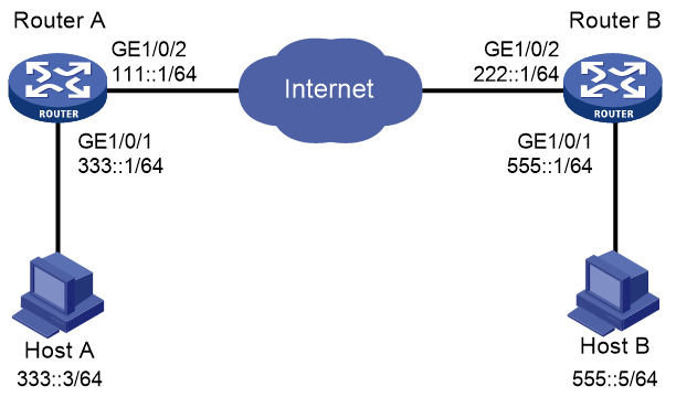

Mirror image ACLs
To make sure SAs can be set up and the traffic protected by IPsec can be processed correctly between two IPsec peers, create mirror image ACLs on the IPsec peers. As shown in Figure 8, ACL rules on Device B are mirror images of the rules on Device A. In this way, SAs can be created successfully for the traffic between Host A and Host C and for the traffic between Network 1 and Network 2.
Figure 8 Mirror image ACLs
If the ACL rules on IPsec peers do not form mirror images of each other, SAs can be set up only when both of the following requirements are met:
·     The range specified by an ACL rule on one peer is covered by its counterpart ACL rule on the other peer. As shown in Figure 9, the range specified by the ACL rule configured on Device A is covered by its counterpart on Device B.
·     The peer with the narrower rule initiates SA negotiation. If a wider ACL rule is used by the SA initiator, the negotiation request might be rejected because the matching traffic is beyond the scope of the responder. As shown in Figure 9, the SA negotiation initiated by Host A to Host C is accepted but the SA negotiations from Host C to Host A, from Host C to Host B, and from Host D to Host A are rejected.
Figure 9 Non-mirror image ACLs

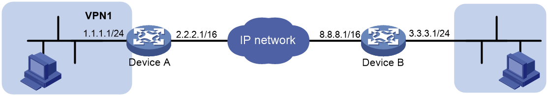

ACL for MPLS L3VPN IPsec protection
To use IPsec to protect the data of an MPLS L3VPN, you must specify the VPN instance for the protected data in the ACL.
As shown in Figure 10, to protect traffic of VPN1 by using IPsec, you must configure the ACL on Device A as follows:
acl advanced 3400
 rule 0 permit ip vpn-instance vpn1 source 1.1.1.0 0.0.0.255 destination 3.3.3.0 0.0.0.255
In addition, you must specify VPN1 as the inside VPN instance in the IKE profile.
ike profile vpn1
 keychain vpn1
 match remote identity address 8.8.8.1 255.255.255.255
 inside-vpn vpn-instance vpn1
Figure 10 IPsec for MPLS L3VPN

Configuring IPsec netmask filtering
On a hub-spoke network, if the IPsec data flow range configured on a spoke is too large, traffic of other spokes might be directed to that spoke incorrectly. To avoid incorrect packet forwarding, you can enable IPsec netmask filtering on the hub device. When negotiating an IPsec SA for a data flow, the device checks the mask lengths of the data flow. The IPsec SA negotiation proceeds only if the mask lengths of the source and destination IP addresses of the data flow are greater than or equal to those configured by IPsec netmask filtering. If the data flow fails to pass the netmask filtering, the IPsec SA negotiation fails and the device generates a netmask filtering failure notification. On receiving such notifications, you must reconfigure the ACL settings for IPsec on the spoke devices.
This feature is supported only on IPv4 networks.
This feature takes effect only IPsec SAs negotiated by using IPsec policy templates.
As a best practice, configure this feature on the hub device of a hub-spoke network.
2.     Configure IPsec netmask filtering.
ipsec netmask-filter { destination-mask mask-length | source-mask mask-length } *
By default, IPsec netmask filtering is not configured.
Enabling IPsec flow overlap check
In a hub-spoke network, the hub typically uses an IPsec policy template to negotiate IPsec SAs with spokes. The data flows to be protected by the IPsec SAs might overlap with each other. To avoid IPsec flow overlapping, you can enable IPsec flow overlap check on the hub device. When negotiating an IPsec SA for a data flow, the device checks whether the data flow overlaps with an existing protected data flow. If yes, the new IPsec SA negotiation fails and the device generates an IPsec flow overlap check failure notification. On receiving such notifications, you must reconfigure the ACL settings for IPsec on the spoke devices.
This feature checks the destination IP address of a data flow to be protected with the destination IP addresses of the existing protected data flows. If an overlap exists, the feature determines that the data flow overlaps.
The following applies to the IPsec flow overlap check feature:
·     As a best practice, enable this feature on the hub device of a hub-spoke network.
·     This feature takes effect only on IPsec SAs negotiated by using IPsec policy templates.
·     This feature takes effect only for new IPsec SA negotiations. It does not take effect on existing IPsec SAs.
·     This feature takes effect only on IPsec SAs negotiated on the same interface and in the same VPN instance.
·     This feature does not take effect on renegotiated IPsec SAs.
·     This feature does not check overlaps for source IP addresses of data flows.
·     This feature impacts device performance, enable this feature only when necessary (for example, for network upgrade or expansion) and disable it in time.
2.     Enable IPsec flow overlap check.
ipsec flow-overlap check enable
By default, IPsec flow overlap check is disabled.

Configuring IPsec for an SDWAN tunnel interface
IPsec protection for SDWAN tunnel interface tasks at a glance
To configure IPsec protection for an SDWAN tunnel interface, perform the following tasks:
1.     Configuring an IPsec transform set
2.     Configuring an SDWAN IPsec profile
3.     Applying an SDWAN IPsec profile to an SDWAN tunnel interface
4.     (Optional.) Setting the time-based anti-replay window size
5.     (Optional.) Configuring IPsec anti-replay redundancy
6.     (Optional.) Configuring the global IPsec SA lifetime and idle timeout
7.     (Optional.) Setting the maximum number of IPsec tunnels
8.     (Optional.) Enabling packet statistics on SDWAN IPsec tunnels
9.     (Optional.) Enabling logging for IPsec negotiation
Abou this task
An SDWAN IPsec profile is used to generate IPsec SAs on SDWAN devices. It is applied to an SDWAN tunnel interface to protect all the traffic routed to the interface. You do not need to specify the remote end address or an ACL.
The IPsec profiles at the two tunnel ends can have IPsec transform sets that use different security protocols, authentication and encryption algorithms.
2.     Create an SDWAN IPsec profile and enter its view.
ipsec profile profile-name sdwan
The sdwan keyword is not needed if you enter the view of an existing IPsec profile.
3.     (Optional.) Configure a description for the IPsec profile.
description text
By default, no description is configured.
4.     Specify IPsec transform sets.
transform-set transform-set-name&
By default, no IPsec transform sets are specified in an IPsec profile.
The specified IPsec transform sets must use the tunnel mode.
5.     (Optional.) Set the IPsec SA lifetime.
sa duration time-based seconds
By default, the global SA lifetime is used.
6.     (Optional.) Configure an alias name for the IPsec profile.
profile alias alias-name
By default, the alias name of an IPsec profile is profile-IPsec profile name.
After an SDWAN IPsec profile is applied to an SDWAN tunnel interface, the SDWAN devices create IPsec SAs to protect data routed to the tunnel interface.
2.     Create a tunnel interface, specify the tunnel mode as SDWAN, and enter tunnel interface view.
interface tunnel number mode sdwan udp
3.     Apply an SDWAN IPsec profile to the tunnel interface.
tunnel protection ipsec profile profile-name
By default, no IPsec profile is applied to a tunnel interface.
4.     Specify a traffic processing slot for the interface.
In standalone mode:
service slot slot-number
In IRF mode:
service chassis chassis-number slot slot-number
By default, no traffic processing slot is specified for an interface. Traffic on an interface is processed on the slot at which the traffic arrives.

Example: Configuring a manual mode IPsec tunnel for IPv4 packets
As shown in Figure 11, establish an IPsec tunnel between Router A and Router B to protect data flows between subnet 10.1.1.0/24 and subnet 10.1.2.0/24. Configure the tunnel as follows:
·     Specify the encapsulation mode as tunnel, the security protocol as ESP, the encryption algorithm as 128-bit AES, and the authentication algorithm as HMAC-SHA1.
·     Manually set up IPsec SAs.
Figure 11 Network diagram
1.     Configure Router A:
# Configure IP addresses for interfaces. (Details not shown.)
# Configure an IPv4 advanced ACL to identify data flows from subnet 10.1.1.0/24 to subnet 10.1.2.0/24.
<RouterA> system-view
[RouterA] acl advanced 3101
[RouterA-acl-ipv4-adv-3101] rule permit ip source 10.1.1.0 0.0.0.255 destination 10.1.2.0 0.0.0.255
[RouterA-acl-ipv4-adv-3101] quit
# Configure a static route to Host B. The command uses the direct next hop address (2.2.2.3) as an example.
[RouterA] ip route-static 10.1.2.0 255.255.255.0 gigabitethernet 1/0/2 2.2.2.3
# Create an IPsec transform set named tran1.
[RouterA] ipsec transform-set tran1
# Specify the tunnel encapsulation mode.
[RouterA-ipsec-transform-set-tran1] encapsulation-mode tunnel
# Specify the ESP security protocol.
[RouterA-ipsec-transform-set-tran1] protocol esp
# Specify the ESP encryption and authentication algorithms.
[RouterA-ipsec-transform-set-tran1] esp encryption-algorithm aes-cbc-128
[RouterA-ipsec-transform-set-tran1] esp authentication-algorithm sha1
[RouterA-ipsec-transform-set-tran1] quit
# Create an IKE-based IPsec policy entry with name map1 and sequence number 10.
[RouterA] ipsec policy map1 10 manual
# Apply ACL 3101.
[RouterA-ipsec-policy-manual-map1-10] security acl 3101
# Apply IPsec transform set tran1.
[RouterA-ipsec-policy-manual-map1-10] transform-set tran1
# Specify 2.2.3.1 as the remote IP address of the IPsec tunnel.
[RouterA-ipsec-policy-manual-map1-10] remote-address 2.2.3.1
# Configure the inbound and outbound SPIs for ESP.
[RouterA-ipsec-policy-manual-map1-10] sa spi outbound esp 12345
[RouterA-ipsec-policy-manual-map1-10] sa spi inbound esp 54321
# Configure the inbound and outbound SA keys for ESP.
[RouterA-ipsec-policy-manual-map1-10] sa string-key outbound esp simple abcdefg
[RouterA-ipsec-policy-manual-map1-10] sa string-key inbound esp simple gfedcba
[RouterA-ipsec-policy-manual-map1-10] quit
# Apply IPsec policy map1 to GigabitEthernet 1/0/2.
[RouterA] interface gigabitethernet 1/0/2
[RouterA-GigabitEthernet1/0/2] ip address 2.2.2.1 255.255.255.0
[RouterA-GigabitEthernet1/0/2] ipsec apply policy map1
[RouterA-GigabitEthernet1/0/2] quit
2.     Configure Router B:
# Configure an IPv4 advanced ACL to identify data flows from subnet 10.1.2.0/24 to subnet 10.1.1.0/24.
<RouterB> system-view
[RouterB] acl advanced 3101
[RouterB-acl-ipv4-adv-3101] rule permit ip source 10.1.2.0 0.0.0.255 destination 10.1.1.0 0.0.0.255
[RouterB-acl-ipv4-adv-3101] quit
# Configure a static route to Host A. The command uses the direct next hop address (2.2.3.3) as an example.
[RouterB] ip route-static 10.1.1.0 255.255.255.0 gigabitethernet 1/0/2 2.2.3.3
[RouterB] ipsec transform-set tran1
[RouterB-ipsec-transform-set-tran1] encapsulation-mode tunnel
[RouterB-ipsec-transform-set-tran1] protocol esp
[RouterB-ipsec-transform-set-tran1] esp encryption-algorithm aes-cbc-128
[RouterB-ipsec-transform-set-tran1] esp authentication-algorithm sha1
[RouterB-ipsec-transform-set-tran1] quit
# Create a manual IPsec policy entry. Specify use1 as the policy name and set the sequence number to 10.
[RouterB] ipsec policy use1 10 manual
# Apply ACL 3101.
[RouterB-ipsec-policy-manual-use1-10] security acl 3101
[RouterB-ipsec-policy-manual-use1-10] transform-set tran1
# Specify 2.2.2.1 as the remote IP address for the IPsec tunnel.
[RouterB-ipsec-policy-manual-use1-10] remote-address 2.2.2.1
[RouterB-ipsec-policy-manual-use1-10] sa spi outbound esp 54321
[RouterB-ipsec-policy-manual-use1-10] sa spi inbound esp 12345
[RouterB-ipsec-policy-manual-use1-10] sa string-key outbound esp simple gfedcba
[RouterB-ipsec-policy-manual-use1-10] sa string-key inbound esp simple abcdefg
[RouterB-ipsec-policy-manual-use1-10] quit
# Apply IPsec policy use1 to GigabitEthernet 1/0/2.
[RouterB] interface gigabitethernet 1/0/2
[RouterB-GigabitEthernet1/0/2] ip address 2.2.3.1 255.255.255.0
[RouterB-GigabitEthernet1/0/2] ipsec policy use1
[RouterB-GigabitEthernet1/0/2] quit
After the configuration is completed, an IPsec tunnel between Router A and Router B is established, and the traffic between subnet 10.1.1.0/24 and subnet 10.1.2.0/24 is IPsec-protected. This example uses Router A to verify the configuration.
# Display IPsec SAs on Router A.
[RouterA] display ipsec sa
Interface: GigabitEthernet1/0/2
  IPsec policy: map1
  Sequence number: 10
  Alias: map1-10
  Mode: Manual
    Tunnel id: 549
    Encapsulation mode: tunnel
    Path MTU: 1443
    Tunnel:
        local  address/port: 2.2.2.1/0
        remote address/port: 2.2.3.1/0
    Flow:
        as defined in ACL 3101
    [Inbound ESP SA]
      SPI: 54321 (0x0000d431)
      Connection ID: 90194313219
      Transform set: ESP-ENCRYPT-AES-CBC-128 ESP-AUTH-SHA1
      No duration limit for this SA
    [Outbound ESP SA]
      SPI: 12345 (0x00003039)
      Connection ID: 64424509441
Example: Configuring an IKE-based IPsec tunnel for IPv4 packets
As shown in Figure 12, establish an IPsec tunnel between Router A and Router B to protect data flows between subnet 10.1.1.0/24 and subnet 10.1.2.0/24. Configure the IPsec tunnel as follows:
·     Set up SAs through IKE negotiation.
Figure 12 Network diagram
# Create an IKE keychain named keychain1.
[RouterA] ike keychain keychain1
# Specify 123456TESTplat&! in plain text as the preshared key to be used with the remote peer at 2.2.3.1.
[RouterA-ike-keychain-keychain1] pre-shared-key address 2.2.3.1 255.255.255.0 key simple 123456TESTplat&!
[RouterA-ike-keychain-keychain1] quit
# Create and configure the IKE profile named profile1.
[RouterA] ike profile profile1
[RouterA-ike-profile-profile1] keychain keychain1
[RouterA-ike-profile-profile1] match remote identity address 2.2.3.1 255.255.255.0
[RouterA-ike-profile-profile1] quit
[RouterA] ipsec policy map1 10 isakmp
# Apply ACL 3101.
[RouterA-ipsec-policy-isakmp-map1-10] security acl 3101
[RouterA-ipsec-policy-isakmp-map1-10] transform-set tran1
# Specify the local and remote IP addresses of the IPsec tunnel as 2.2.2.1 and 2.2.3.1.
[RouterA-ipsec-policy-isakmp-map1-10] local-address 2.2.2.1
[RouterA-ipsec-policy-isakmp-map1-10] remote-address 2.2.3.1
# Apply IKE profile profile1.
[RouterA-ipsec-policy-isakmp-map1-10] ike-profile profile1
[RouterA-ipsec-policy-isakmp-map1-10] quit
[RouterB] ike keychain keychain1
# Specify 123456TESTplat&! in plain text as the preshared key to be used with the remote peer at 2.2.2.1.
[RouterB-ike-keychain-keychain1] pre-shared-key address 2.2.2.1 255.255.255.0 key simple 123456TESTplat&!
[RouterB-ike-keychain-keychain1] quit
[RouterB] ike profile profile1
[RouterB-ike-profile-profile1] keychain keychain1
[RouterB-ike-profile-profile1] match remote identity address 2.2.2.1 255.255.255.0
[RouterB-ike-profile-profile1] quit
# Create an IKE-based IPsec policy entry. Specify use1 as the policy name and set the sequence number to 10.
[RouterB] ipsec policy use1 10 isakmp
# Apply ACL 3101.
[RouterB-ipsec-policy-isakmp-use1-10] security acl 3101
[RouterB-ipsec-policy-isakmp-use1-10] transform-set tran1
# Specify the local and remote IP addresses of the IPsec tunnel as 2.2.3.1 and 2.2.2.1.
[RouterB-ipsec-policy-isakmp-use1-10] local-address 2.2.3.1
[RouterB-ipsec-policy-isakmp-use1-10] remote-address 2.2.2.1
[RouterB-ipsec-policy-isakmp-use1-10] ike-profile profile1
[RouterB-ipsec-policy-isakmp-use1-10] quit
[RouterB-GigabitEthernet1/0/2] ipsec apply policy use1
# Initiate a connection from subnet 10.1.1.0/24 to subnet 10.1.2.0/24 to trigger IKE negotiation. After IPsec SAs are successfully negotiated by IKE, the traffic between the two subnets is IPsec-protected.
# Display IPsec SAs on Router A and Router B. This example uses Router A to verify the configuration.
  IPsec policy: map1
  Sequence number: 10
  Alias: map1-10
  Mode: ISAKMP
    Tunnel id: 0
    Perfect Forward Secrecy:
    Inside VPN:
    Extended Sequence Numbers enable: N
    Traffic Flow Confidentiality enable: N
    Transmitting entity: Initiator
    Path MTU: 1443
    Tunnel:
        local  address/port: 2.2.3.1/500
        remote address/port: 2.2.2.1/500
    Flow:
        sour addr: 10.1.1.0/255.255.255.0  port: 0  protocol: ip
        dest addr: 10.1.2.0/255.255.255.0  port: 0  protocol: ip
    [Inbound ESP SAs]
      SPI: 3769702703 (0xe0b1192f)
      SA duration (kilobytes/sec): 3000/28800
      SA remaining duration (kilobytes/sec): 2300/797
      Max received sequence-number: 1

Example: Configuring an IKE-based IPsec tunnel for IPv6 packets
As shown in Figure 13, establish an IPsec tunnel between Router A and Router B to protect data flows between subnet 333::/64 and subnet 555::/64. Configure the IPsec tunnel as follows:
Figure 13 Network diagram
# Configure IPv6 addresses for interfaces. (Details not shown.)
# Configure an IPv6 advanced ACL to identify data flows from subnet 333::/64 to subnet 555::/64.
[RouterA] acl ipv6 advanced 3101
[RouterA-acl-ipv6-adv-3101] rule permit ipv6 source 333::0 64 destination 555::0 64
[RouterA-acl-ipv6-adv-3101] quit
# Configure a static route to Host B. The command uses the direct next hop address (111::2) as an example.
[RouterA] ipv6 route-static 555::0 64 111::2
# Create and configure an IKE keychain named keychain1.
[RouterA-ike-keychain-keychain1] pre-shared-key address ipv6 222::1 64 key simple 123456TESTplat&!
# Create and configure an IKE profile named profile1.
[RouterA-ike-profile-profile1] match remote identity address ipv6 222::1 64
[RouterA] ipsec ipv6-policy map1 10 isakmp
# Apply IPv6 ACL 3101.
[RouterA-ipsec-ipv6-policy-isakmp-map1-10] security acl ipv6 3101
[RouterA-ipsec-ipv6-policy-isakmp-map1-10] transform-set tran1
# Specify the local and remote IPv6 addresses of the IPsec tunnel as 111::1 and 222::1.
[RouterA-ipsec-ipv6-policy-isakmp-map1-10] local-address ipv6 111::1
[RouterA-ipsec-ipv6-policy-isakmp-map1-10] remote-address ipv6 222::1
[RouterA-ipsec-ipv6-policy-isakmp-map1-10] ike-profile profile1
[RouterA-ipsec-ipv6-policy-isakmp-map1-10] quit
[RouterA-GigabitEthernet1/0/2] ipv6 address 111::1/64
[RouterA-GigabitEthernet1/0/2] ipsec apply ipv6-policy map1
# Configure an IPv6 advanced ACL to identify data flows from subnet 555::/64 to subnet 333::/64.
[RouterB] acl ipv6 advanced 3101
[RouterB-acl-ipv6-adv-3101] rule permit ipv6 source 555::/64 destination 333::/64
[RouterB-acl-ipv6-adv-3101] quit
# Configure a static route to Host A. The command uses the direct next hop address (222::2) as an example.
[RouterB] ipv6 route-static 333::0 64 222::2
[RouterB-ike-keychain-keychain1] pre-shared-key address ipv6 111::1 64 key simple 123456TESTplat&!
[RouterB-ike-profile-profile1] match remote identity address ipv6 111::1 64
[RouterB] ipsec ipv6-policy use1 10 isakmp
# Apply ACL 3101.
[RouterB-ipsec-ipv6-policy-isakmp-use1-10] security acl ipv6 3101
[RouterB-ipsec-ipv6-policy-isakmp-use1-10] transform-set tran1
# Specify the local and remote IPv6 addresses of the IPsec tunnel as 222::1 and 111::1.
[RouterB-ipsec-ipv6-policy-isakmp-use1-10] local-address ipv6 222::1
[RouterB-ipsec-ipv6-policy-isakmp-use1-10] remote-address ipv6 111::1
[RouterB-ipsec-ipv6-policy-isakmp-use1-10] ike-profile profile1
[RouterB-ipsec-ipv6-policy-isakmp-use1-10] quit
[RouterB-GigabitEthernet1/0/2] ipv6 address 222::1/64
[RouterB-GigabitEthernet1/0/2] ipsec apply ipv6-policy use1
# Initiate a connection from subnet 333::/64 to subnet 555::/64 to trigger IKE negotiation. After IPsec SAs are successfully negotiated by IKE, the traffic between the two subnets is IPsec-protected.
Interface: GigabitEthernet 1/0/2
  IPsec policy: map1
  Sequence number: 10
  Alias: map1-10
  Mode: ISAKMP
    Tunnel id: 0
    Inside VPN:
    Path MTU: 1423
    Tunnel:
        local  address/port: 111::1/500
        remote address/port: 222::1/500
    Flow:
    sour addr: 111::1/0      port: 0  protocol: ipv6
    dest addr: 222::1/0      port: 0  protocol: ipv6
    [Inbound ESP SAs]
      Connection ID: 1
      Anti-replay check enable: N
      Anti-replay window size:
      UDP encapsulation used for NAT traversal: N
      Status: Active
    [Outbound ESP SAs]
      SPI: 3840956402 (0xe4f057f2)
      Connection ID: 2
      SA remaining duration (kilobytes/sec): 2312/797
      Max sent sequence-number: 1
      Status: Active
# Display IPsec SAs on Router B. (Details not shown.)

Example: Configuring IPsec RRI
As shown in Figure 15, branches access the enterprise center through an IPsec VPN.
Configure the IPsec VPN as follows:
·     Configure an IPsec tunnel between Router A and each branch gateway (Router B, Router C, and Router D) to protect traffic between subnets 4.4.4.0/24 and 5.5.5.0/24.
·     Configure the tunnels to use security protocol ESP, encryption algorithm DES, and authentication algorithm SHA1-HMAC-96. Use IKE for IPsec SA negotiation.
·     On each router, configure an IKE proposal to use the preshared key authentication method, encryption algorithm 3DES, and authentication algorithm HMAC-SHA1.
·     Configure IPsec RRI on Router A to automatically create static routes to the branches based on the established IPsec SAs.
Figure 15 Network diagram
1.     Assign IPv4 addresses to the interfaces on the routers according to Figure 15. (Details not shown.)
2.     Configure Router A:
# Create an IPsec transform set named tran1, and specify ESP as the security protocol, DES as the encryption algorithm, and HMAC-SHA-1-96 as the authentication algorithm.
[RouterA-ipsec-transform-set-tran1] esp encryption-algorithm des
# Create and configure the IPsec profile named profile1.
[RouterA-ike-profile-profile1] keychain key1
[RouterA-ike-profile-profile1] match remote identity address 2.2.2.2 255.255.255.0
# Create an IPsec policy template named temp1. Specify IPsec transform set tran1 and IKE profile profile1 for the IPsec policy template.
[RouterA] ipsec policy-template temp1 1
[RouterA-ipsec-policy-template-temp1-1] transform-set tran1
[RouterA-ipsec-policy-template-temp1-1] ike-profile profile1
# Enable IPsec RRI, and set the preference to 100 and the tag to 1000 for the static routes created by IPsec RRI.
[RouterA-ipsec-policy-template-temp1-1] reverse-route dynamic
[RouterA-ipsec-policy-template-temp1-1] reverse-route preference 100
[RouterA-ipsec-policy-template-temp1-1] reverse-route tag 1000
[RouterA-ipsec-policy-template-temp1-1] quit
[RouterA] ipsec policy map1 10 isakmp template temp1
# Create an IKE proposal named 1, and specify 3DES as the encryption algorithm, HMAC-SHA1 as the authentication algorithm, and pre-share as the authentication method.
[RouterA] ike proposal 1
[RouterA-ike-proposal-1] encryption-algorithm 3des-cbc
[RouterA-ike-proposal-1] authentication-algorithm sha
[RouterA-ike-proposal-1] authentication-method pre-share
[RouterA-ike-proposal-1] quit
# Create an IKE keychain named key1 and specify 123 in plain text as the preshared key to be used with the remote peer at 2.2.2.2.
[RouterA] ike keychain key1
[RouterA-ike-keychain-key1] pre-shared-key address 2.2.2.2 key simple 123
[RouterA-ike-keychain-key1] quit
# Apply IPsec policy map1 to GigabitEthernet 1/0/1.
[RouterA] interface gigabitethernet 1/0/1
[RouterA-GigabitEthernet1/0/1] ipsec apply policy map1
[RouterA-GigabitEthernet1/0/1] quit
3.     Configure Router B:
[RouterB-ipsec-transform-set-tran1] esp encryption-algorithm des
# Configure IPv4 advanced ACL 3000 to identify traffic from subnet 5.5.5.0/24 to subnet 4.4.4.0/24.
[RouterB] acl advanced 3000
[RouterB-acl-ipv4-adv-3000] rule permit ip source 5.5.5.0 0.0.0.255 destination 4.4.4.0 0.0.0.255
[RouterB-acl-ipv4-adv-3000] quit
[RouterB-ike-profile-profile1] keychain key1
[RouterB-ike-profile-profile1] match remote identity address 1.1.1.1 255.255.255.0
# Create an IKE-based IPsec policy entry named map1 and configure the following settings for the policy entry:
¡     Set the sequence number to 10.
¡     Specify transform set tran1 and ACL 3000.
¡     Specify the remote IP address for the tunnel as 1.1.1.1.
¡     Specify IKE profile profile1.
[RouterB] ipsec policy map1 10 isakmp
[RouterB-ipsec-policy-isakmp-map1-10] transform-set tran1
[RouterB-ipsec-policy-isakmp-map1-10] security acl 3000
[RouterB-ipsec-policy-isakmp-map1-10] remote-address 1.1.1.1
[RouterB-ipsec-policy-isakmp-map1-10] ike-profile profile1
[RouterB-ipsec-policy-isakmp-map1-10] quit
[RouterB] ike proposal 1
[RouterB-ike-proposal-1] encryption-algorithm 3des-cbc
[RouterB-ike-proposal-1] authentication-algorithm sha
[RouterB-ike-proposal-1] authentication-method pre-share
[RouterB-ike-proposal-1] quit
# Create an IKE keychain named key1 and specify 123 in plain text as the preshared key to be used with the remote peer at 1.1.1.1.
[RouterB] ike keychain key1
[RouterB-ike-keychain-key1] pre-shared-key address 1.1.1.1 key simple 123
[RouterB-ike-keychain-key1] quit
[RouterB-GigabitEthernet1/0/1] ipsec apply policy map1
[RouterB-GigabitEthernet1/0/1] quit
Make sure Router B has a route to the peer private network, with the outgoing interface as GigabitEthernet 1/0/1.
4.     Configure Router C and Router D in the same way Router B is configured.
1.     Verify that IPsec RRI can automatically create a static route from Router A to Router B:
# Initiate a connection from subnet 5.5.5.0/24 to subnet 4.4.4.0/24. IKE negotiation is triggered to establish IPsec SAs between Router A and Router B. (Details not shown.)
# Verify that IPsec SAs are established on Router A.

Example: Configuring IPsec tunnel interface-based IPsec for IPv4 packets
As shown in Figure 16, both the branch and the headquarters use fixed IP addresses to access the Internet.
Configure IPsec tunnel interface-based IPsec on Router A and Router B to protect the traffic between the branch (10.1.1.0/24) and the headquarters (10.1.2.0/24). This IPsec implementation ensures that the IPsec configuration of the headquarters remains stable despite of changes of the branch subnet.
Figure 16 Network diagram

Example: Configuring a P2MP IPsec tunnel interface-based IPsec for IPv4 packets
As shown in Figure 17, the branches (spokes) and the headquarters (hub) all use fixed IP addresses to access the Internet.
Configure a P2MP IPsec tunnel interface on Router A to establish IPsec tunnels dynamically with Router B and Router C. In this way, all traffic destined for the peer private networks will be routed to the IPsec tunnel interface for secure transmission.
The branches do not establish IPsec tunnels between each other. Traffic between the private networks of Router B and Router C is first routed to the IPsec tunnel interface of Router A and then forwarded to the peer for secure transmission.
Figure 17 Network diagram
Configure routing to make sure interfaces GE1/0/1 on Router A, Router B, and Router C can reach each other.
If the physical outgoing interface GE1/0/1 on the hub is shut down, the SAs on the hub will be deleted and cannot be recovered unless they are triggered by traffic from spokes. To enable automatic negotiation for the SAs, you can configure IKE DPD on the spokes.
# Configure IKE keychain abc. Specify the preshared key for Router B as 121212 and that for Router C as 131313.
[RouterA] ike keychain abc
[RouterA-ike-keychain-abc] pre-shared-key hostname routerB.example.com key simple 121212
[RouterA-ike-keychain-abc] pre-shared-key hostname routerC.example.com key simple 131313
[RouterA-ike-keychain-abc] quit
# Configure IKE profile abc that uses IKE keychain abc, the default IKE proposal, local ID routerA.example.com, remote ID example.com, and the aggressive IKE exchange mode.
[RouterA] ike profile abc
[RouterA-ike-profile-abc] keychain abc
[RouterA-ike-profile-abc] local-identity fqdn routerA.example.com
[RouterA-ike-profile-abc] match remote identity domain example.com
[RouterA-ike-profile-abc] exchange-mode aggressive
[RouterA-ike-profile-abc] quit
# Configure IPsec transform set abc that uses security protocol ESP, encryption algorithm AES-CBC-128, and authentication algorithm SHA1.
[RouterA] ipsec transform-set abc
[RouterA-ipsec-transform-set-abc] esp encryption-algorithm aes-cbc-128
[RouterA-ipsec-transform-set-abc] esp authentication-algorithm sha1
[RouterA-ipsec-transform-set-abc] quit
# Configure IPsec profile abc that uses IPsec transform set abc and IKE profile abc.
[RouterA] ipsec profile abc isakmp
[RouterA-ipsec-profile-isakmp-abc] transform-set abc
[RouterA-ipsec-profile-isakmp-abc] ike-profile abc
[RouterA-ipsec-profile-isakmp-abc] quit
# Configure P2MP IPsec tunnel interface Tunnel 1. Configure the IP address of the tunnel interface as 192.168.10.1/24 and the tunnel source address as 1.1.1.1. Use IPsec profile abc to protect the traffic on the tunnel interface.
[RouterA] interface tunnel 1 mode ipsec-p2mp
[RouterA-Tunnel1] ip address 192.168.10.1 255.255.255.0
[RouterA-Tunnel1] source 1.1.1.1
[RouterA-Tunnel1] tunnel protection ipsec profile abc
[RouterA-Tunnel1] quit
# Configure static routes destined for the branches through the tunnel interface.
[RouterA] ip route-static 192.168.12.0 255.255.255.0 tunnel 1 192.168.10.2
[RouterA] ip route-static 192.168.13.0 255.255.255.0 tunnel 1 192.168.10.3
# Configure IP address for interfaces. (Details not shown.)
# Configure IKE keychain abc. Specify the preshared key for communication with the peer as 121212.
[RouterB] ike keychain abc
[RouterB-ike-keychain-abc] pre-shared-key address 1.1.1.1 255.255.255.255 key simple 121212
[RouterB-ike-keychain-abc] quit
# Configure IKE profile abc that uses IKE keychain abc, the default IKE proposal, local ID routerB.example.com, and the aggressive IKE exchange mode.
[RouterB] ike profile abc
[RouterB-ike-profile-abc] keychain abc
[RouterB-ike-profile-abc] local-identity fqdn routerB.example.com
[RouterB-ike-profile-abc] exchange-mode aggressive
[RouterB-ike-profile-abc] quit
[RouterB] ipsec transform-set abc
[RouterB-ipsec-transform-set-abc] esp encryption-algorithm aes-cbc-128
[RouterB-ipsec-transform-set-abc] esp authentication-algorithm sha1
[RouterB-ipsec-transform-set-abc] quit
[RouterB] ipsec profile abc isakmp
[RouterB-ipsec-profile-isakmp-abc] transform-set abc
[RouterB-ipsec-profile-isakmp-abc] ike-profile abc
[RouterB-ipsec-profile-isakmp-abc] quit
# Configure IPsec tunnel interface Tunnel 1. Configure the IP address of the tunnel interface as 192.168.10.2/24 and the tunnel source address as 2.2.2.2. Use IPsec profile abc to protect the traffic on the tunnel interface.
[RouterB] interface tunnel 1 mode ipsec
[RouterB-Tunnel1] ip address 192.168.10.2 255.255.255.0
[RouterB-Tunnel1] source 2.2.2.2
[RouterB-Tunnel1] destination 1.1.1.1
[RouterB-Tunnel1] tunnel protection ipsec profile abc
[RouterB-Tunnel1] quit
# Configure static routes destined for the headquarters and the other branch through the tunnel interface.
[RouterB] ip route-static 192.168.11.0 255.255.255.0 tunnel 1
[RouterB] ip route-static 192.168.13.0 255.255.255.0 tunnel 1
3.     Configure Router C:
<RouterC> system-view
[RouterC] ike keychain abc
[RouterC-ike-keychain-abc] pre-shared-key address 1.1.1.1 255.255.255.255 key simple 121212
[RouterC-ike-keychain-abc] quit
[RouterC] ike profile abc
[RouterC-ike-profile-abc] keychain abc
[RouterC-ike-profile-abc] local-identity fqdn routerB.example.com
[RouterC-ike-profile-abc] exchange-mode aggressive
[RouterC-ike-profile-abc] quit
[RouterC] ipsec transform-set abc
[RouterC-ipsec-transform-set-abc] esp encryption-algorithm aes-cbc-128
[RouterC-ipsec-transform-set-abc] esp authentication-algorithm sha1
[RouterC-ipsec-transform-set-abc] quit
[RouterC] ipsec profile abc isakmp
[RouterC-ipsec-profile-isakmp-abc] transform-set abc
[RouterC-ipsec-profile-isakmp-abc] ike-profile abc
[RouterC-ipsec-profile-isakmp-abc] quit
# Configure IPsec tunnel interface Tunnel 1. Configure the IP address of the tunnel interface as 192.168.10.3/24 and the tunnel source address as 3.3.3.3. Use IPsec profile abc to protect the traffic on the tunnel interface.
[RouterC] interface tunnel 1 mode ipsec
[RouterC-Tunnel1] ip address 192.168.10.3 255.255.255.0
[RouterC-Tunnel1] source 3.3.3.3
[RouterC-Tunnel1] destination 1.1.1.1
[RouterC-Tunnel1] tunnel protection ipsec profile abc
[RouterC-Tunnel1] quit
[RouterC] ip route-static 192.168.11.0 255.255.255.0 tunnel 1
[RouterC] ip route-static 192.168.12.0 255.255.255.0 tunnel 1
After the configuration, Router B and Router C automatically negotiate IPsec SAs with Router A through IKE. After the negotiation completes, the IPsec tunnel interface on each router will be up.
# Display interface information on Router A.
[RouterA] display ip interface brief
Interface                Physical Protocol IP Address      Description
GE1/0/1                  up       up       1.1.1.1        --
GE1/0/2                  down     down     192.168.11.1    --
Tun1                     up       up       192.168.10.1    --
# Display tunnel interface information on Router A.
[RouterA] display interface Tunnel 1
Tunnel1
Current state: UP
Line protocol state: UP
Description: Tunnel1 Interface
Bandwidth: 64 kbps
Maximum transmission unit: 1428
Internet address: 192.168.10.1/24 (primary)
Tunnel source 1.1.1.1, destination unknown
Tunnel TTL 255
Tunnel protocol/transport IPSEC-P2MP/IP
Output queue - Urgent queuing: Size/Length/Discards 0/100/0
Output queue - Protocol queuing: Size/Length/Discards 0/500/0
Output queue - FIFO queuing: Size/Length/Discards 0/75/0
Last clearing of counters: Never
Last 300 seconds input rate: 0 bytes/sec, 0 bits/sec, 0 packets/sec
Last 300 seconds output rate: 0 bytes/sec, 0 bits/sec, 0 packets/sec
Input: 0 packets, 0 bytes, 0 drops
Output: 0 packets, 0 bytes, 0 drops
# Display IPsec SA information.
Interface: Tunnel1
  IPsec profile: abc
  Alias: profile-abc
  Mode: ISAKMP
    Tunnel id: 0
    Perfect forward secrecy:
    Path MTU: 1356
    Tunnel:
        local  address/port: 1.1.1.1/500
        remote address/port: 2.2.2.2/500
    Flow:
        sour addr: 0.0.0.0/0.0.0.0  port: 0  protocol: ip
        dest addr: 0.0.0.0/0.0.0.0  port: 0  protocol: ip
    [Inbound ESP SAs]
      SPI: 139862185 (0x085620a9)
      Connection ID: 4294967296
      SA duration (kilobytes/sec): 1843200/3600
      SA remaining duration (kilobytes/sec): 1843200/2629
      Max received sequence-number: 0
      Anti-replay check enable: Y
      Anti-replay window size: 64
      Status: Active
    [Outbound ESP SAs]
      SPI: 948049133 (0x388214ed)
      Connection ID: 4294967297
      Max sent sequence-number: 0
      Status: Active
  IPsec profile: abc
  Alias: profile-abc
  Mode: ISAKMP
    Tunnel id: 1
    Path MTU: 1356
    Tunnel:
        local  address: 1.1.1.1
        remote address: 3.3.3.3
    Flow:
    [Inbound ESP SAs]
      SPI: 3847904492 (0xe55a5cec)
      Connection ID: 4294967298
      SA remaining duration (kilobytes/sec): 1843200/2639
      Status: Active
    [Outbound ESP SAs]
      SPI: 2912706735 (0xad9c60af)
      Connection ID: 4294967299
      Status: Active
# On Router B and Router C, ping the private network connected to Router A. Then, P2MP tunnel entries are generated on Router A.
[RouterB] ping 192.168.11.1
[RouterC] ping 192.168.11.1
[RouterA] display ipsec p2mp tunnel-table interface Tunnel 1
Total number:2
Dest Addr                   Dest port                   Tunnel Dest Addr            Time
2.2.2.2                    500                        192.168.10.2                24
3.3.3.3                    500                        192.168.10.3
# On Router A, use a private address to ping an IP address in the private networks connected to Router B and Router C. The ping operations succeed.
[RouterA] ping -a 192.168.11.1 192.168.12.1
Ping 192.168.12.1 (192.168.12.1) from 192.168.11.1: 56 data bytes, press CTRL_C to break
56 bytes from 192.168.12.1: icmp_seq=0 ttl=255 time=1.000 ms

Example: Configuring main-mode IKE with preshared key authentication
As shown in Figure 21, configure an IKE-based IPsec tunnel between Device A and Device B to secure the communication between subnet 10.1.1.0/24 and subnet 10.1.2.0/24.
·     Configure Device A and Device B to use the default IKE proposal for the IKE negotiation to set up the IPsec SAs.
·     Configure the two devices to use the preshared key authentication method for the IKE negotiation phase 1.
Figure 21 Network diagram
1.     Configure Device A:
# Assign an IP address to each interface. (Details not shown.)
# Configure IPv4 advanced ACL 3101 to identify traffic from subnet 10.1.1.0/24 to subnet 10.1.2.0/24.
<DeviceA> system-view
[DeviceA] acl advanced 3101
[DeviceA-acl-ipv4-adv-3101] rule permit ip source 10.1.1.0 0.0.0.255 destination 10.1.2.0 0.0.0.255

As shown in Figure 22, configure an IKE-based IPsec tunnel between Device A and Device B to secure the communication between subnet 10.1.1.0/24 and subnet 10.1.2.0/24.
Configure Device A and Device B to use aggressive mode for IKE negotiation phase 1 and to use RSA signature authentication. Device A acts as the initiator, and the subnet where Device A resides uses IP addresses dynamically allocated.
Figure 22 Network diagram
[DeviceA-acl-ipv4-adv-3101] quit
[DeviceA] ipsec transform-set tran1
# Set the packet encapsulation mode to tunnel.
[DeviceA-ipsec-transform-set-tran1] encapsulation-mode tunnel
# Use the ESP protocol for the IPsec transform set.
[DeviceA-ipsec-transform-set-tran1] protocol esp
# Specify the encryption and authentication algorithms.
[DeviceA-ipsec-transform-set-tran1] esp encryption-algorithm des-cbc
[DeviceA-ipsec-transform-set-tran1] esp authentication-algorithm sha1
[DeviceA-ipsec-transform-set-tran1] quit
# Create a PKI entity named entity1.
[DeviceA] pki entity entity1
# Set the common name to devicea for the PKI entity.
[DeviceA-pki-entity-entity1] common-name devicea
[DeviceA-pki-entity-entity1] quit
# Create a PKI domain named domain1.
[DeviceA] pki domain domain1
# Set the certificate request mode to auto and set the password to 123 for certificate revocation.
[DeviceA-pki-domain-domain1] certificate request mode auto password simple 123
# Set an MD5 fingerprint for verifying the validity of the CA root certificate.
[DeviceA-pki-domain-domain1] root-certificate fingerprint md5 50c7a2d282ea710a449eede6c56b102e
# Specify the trusted CA 8088.
[DeviceA-pki-domain-domain1] ca identifier 8088
# Specify the URL of the registration server for certificate request through the SCEP protocol. This example uses https://192.168.222.1:446/eadbf9af4f2c4641e685f7a6021e7b298373feb7.
[DeviceA-pki-domain-domain1] certificate request url https://192.168.222.1:446/eadbf9af4f2c4641e685f7a6021e7b298373feb7
# Specify the CA to accept certificate requests.
[DeviceA-pki-domain-domain1] certificate request from ca
# Specify the PKI entity for certificate request as entity1.
[DeviceA-pki-domain-domain1] certificate request entity entity1
# Specify RSA key pair rsa1 with the general purpose for certificate request.
[DeviceA-pki-domain-domain1] public-key rsa general name rsa1
[DeviceA-pki-domain-domain1] quit
# Create an IKE profile named profile1.
[DeviceA] ike profile profile1
# Specify PKI domain domain1 for the IKE profile.
[DeviceA-ike-profile-profile1] certificate domain domain1
# Specify that IKE negotiation operates in aggressive mode.
[DeviceA-ike-profile-profile1] exchange-mode aggressive
# Set the local identity to FQDN name www.example.com.
[DeviceA-ike-profile-profile1] local-identity fqdn www.example.com
# Configure a peer ID with the identity type of FQDN name and the value of www.example2.com.
[DeviceA-ike-profile-profile1] match remote identity fqdn www.example2.com
[DeviceA-ike-profile-profile1] quit
# Create an IKE proposal named 10.
[DeviceA] ike proposal 10
# Specify the authentication algorithm as HMAC-MD5.
[DeviceA-ike-proposal-10] authentication-algorithm md5
# Specify the RSA authentication method.
[DeviceA-ike-proposal-10] authentication-method rsa-signature
[DeviceA-ike-proposal-10] quit
[DeviceA] ipsec policy map1 10 isakmp
# Specify remote IP address 2.2.2.2 for the IPsec tunnel.
[DeviceA-ipsec-policy-isakmp-map1-10] remote-address 2.2.2.2
# Specify IPsec transform set tran1 for the IPsec policy.
[DeviceA-ipsec-policy-isakmp-map1-10] transform-set tran1
# Specify ACL 3101 to identify the traffic to be protected.
[DeviceA-ipsec-policy-isakmp-map1-10] security acl 3101
# Specify IKE profile profile1 for the IPsec policy.
[DeviceA-ipsec-policy-isakmp-map1-10] ike-profile profile1
[DeviceA-ipsec-policy-isakmp-map1-10] quit
[DeviceA-GigabitEthernet1/0/1] ipsec apply policy map1
[DeviceA-GigabitEthernet1/0/1] quit
# Configure a static route to the subnet where Host B resides. This example uses 1.1.1.2 as the next hop IP address.
[DeviceA] ip route-static 10.1.2.0 255.255.255.0 1.1.1.2
2.     Configure Device B:
# Configure IPv4 advanced ACL 3101 to identify traffic from subnet 10.1.2.0/24 to subnet 10.1.1.0/24.
<DeviceB> system-view
[DeviceB] acl advanced 3101
[DeviceB-acl-ipv4-adv-3101] rule permit ip source 10.1.2.0 0.0.0.255 destination 10.1.1.0 0.0.0.255
[DeviceB-acl-ipv4-adv-3101] quit
[DeviceB] ipsec transform-set tran1
[DeviceB-ipsec-transform-set-tran1] encapsulation-mode tunnel
[DeviceB-ipsec-transform-set-tran1] protocol esp
[DeviceB-ipsec-transform-set-tran1] esp encryption-algorithm des-cbc
[DeviceB-ipsec-transform-set-tran1] esp authentication-algorithm sha1
[DeviceB-ipsec-transform-set-tran1] quit
# Create a PKI entity named entity2.
[DeviceB] pki entity entity2
# Set the common name to deviceb for the PKI entity.
[DeviceB-pki-entity-entity2] common-name deviceb
[DeviceB-pki-entity-entity2] quit
# Create a PKI domain named domain2.
[DeviceB] pki domain domain2
[DeviceB-pki-domain-domain2] certificate request mode auto password simple 123

Example: Configuring aggressive-mode IKE with NAT traversal
This configuration example is not available when the device is operating in FIPS mode.
Device A is behind the NAT device. Hosts behind Device A use public IP address 3.3.3.1 to access the external network.
Configure an IKE-based IPsec tunnel between Device A and Device B to secure the communication between subnet 10.1.1.0/24 and subnet 10.1.2.0/24.
·     Configure Device A and Device B to use the default IKE proposal for the aggressive IKE negotiation to set up the IPsec SAs.
Figure 23 Network diagram

# Create an IKE-based IPsec policy entry by using IPsec policy template template1. Specify the policy name as policy1 and set the sequence number to 1.
[DeviceB] ipsec policy policy1 1 isakmp template template1
# Apply IPsec policy policy1 to GigabitEthernet 1/0/1.
[DeviceB-GigabitEthernet1/0/1] ipsec apply policy policy1
[DeviceB-GigabitEthernet1/0/1] quit
# Configure a static route to the subnet where Host A resides. This example uses 2.2.2.1 as the next hop IP address.
[DeviceB] ip route-static 10.1.1.0 255.255.255.0 2.2.2.1
# Initiate a connection from subnet 10.1.1.0/24 to subnet 10.1.2.0/24 to trigger IKE negotiation. After IPsec SAs are successfully negotiated by IKE, traffic between the two subnets is IPsec-protected.

Example: Configuring IKE remote extended authentication
As shown in Figure 24, configure an IPsec tunnel to protect the traffic between the host and the device.
·     Set up IPsec SAs through IKE negotiations.
·     Configure the host and the device to use preshared key for authentication in the phase-1 IKE negotiation.
·     Configure the device to use RADIUS to perform remote extended authentication on the host.
Figure 24 Network diagram
1.     Make sure the device, host, and server can reach one another.
2.     Configure the RADIUS server. Make sure the RADIUS server has an authentication account for the host. In this example, the account uses username test and password 123456TESTplat&!.

Example: Configuring IKE local extended authentication and address pool authorization
As shown in Figure 25, configure an IPsec tunnel to protect the traffic between the host and the server.
·     Configure the device to use AAA to perform local extended authentication on the host and assign an IPv4 address to the host.
Figure 25 Network diagram
1.     Make sure the device and the host can reach each other.
2.     Configure local users on the device. In this example, the authentication account uses username test and password 123456TESTplat&!.
