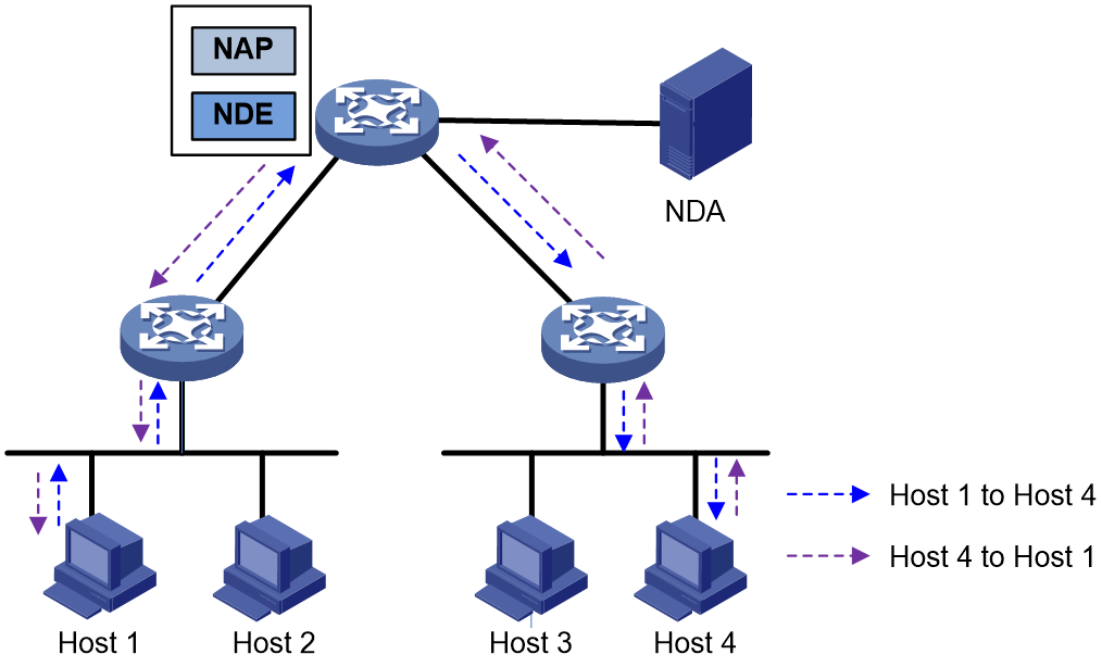

NetAnalysis is a network traffic monitoring and analysis technology that performs in-depth analysis of service flows to obtain performance statistics about the service flows, such as packet loss rate and latency. NetAnalysis can send the analysis results to a NetAnalysis processor for analysis and display, which helps you monitor the network operation status and locate network faults.
NetAnalysis architecture
A typical NetAnalysis system consists of the following elements:
· NetAnalysis data exporter (NDE)—Replicates service flows to a NetAnalysis processor.
· NetAnalysis processor (NAP)—Processes and analyzes service flows and outputs the results to a NetAnalysis data analyzer.
· NetAnalysis data analyzer (NDA)—Provides a Web interface for obtaining, displaying, and analyzing service flow data.
Typically, an NDE and an NAP are collocated on a device. As shown in Figure 1, when a service flow and its return traffic are forwarded along the same path, all devices on the path obtain bidirectional traffic of the service flow. You can configure NetAnalysis on these devices to analyze the flow to obtain performance statistics such as packet loss rate and latency.

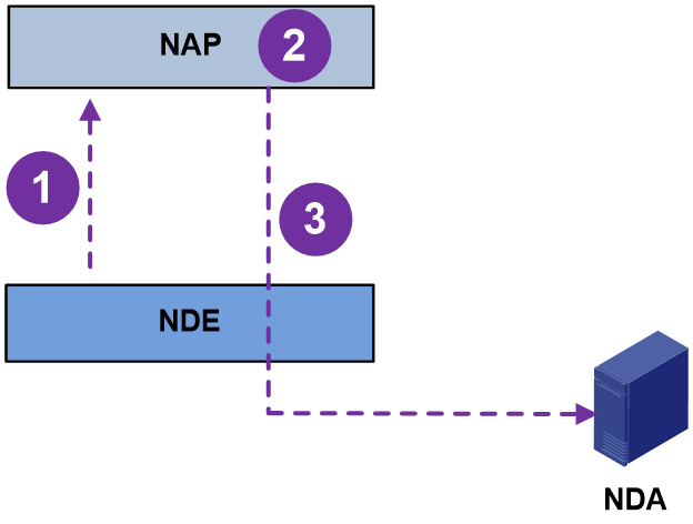

As shown in Figure 2, NetAnalysis works as follows:
1. The NDE uses ACLs to match the service flows monitored by NetAnalysis and replicates the service flows to the NAP.
2. The NAP creates a flow table for each received service flow to analyze it if the service flow satisfies certain requirements. The NAP drops a service flow if the service flow does not meet those requirements or the NAP is overloaded.
3. The NAP encapsulates the analysis results into packets destined for the NDA, looks up the routing table for a matching route, and sends the packets to the NDA for analysis and display.

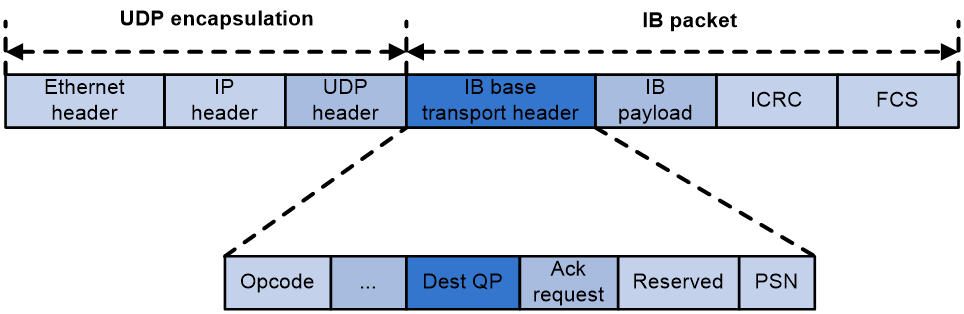

RoCEv2 is a network layer protocol that enables Layer 3 communication between broadcast domains. RoCEv2 encapsulates packets based on the UDP encapsulation. Figure 3 shows the format of an RoCEv2 packet.
An RoCEv2 packet contains the following fields:
· Ethernet header—Includes the source and destination MAC addresses.
· IP header—Includes the source and destination IP addresses.
· UDP header—Includes the source and destination port numbers. The destination port number is fixed at 4791.
· InfiniBand base transport header—Includes key fields monitored by NetAnalysis.
· IB payload.
· ICRC and FCS.
The InfiniBand base transport header contains the following fields:
· Opcode—RoCEv2 packet type indicating the operation mode. Available values for this field include the following:
¡ ConnectMsg—The packet is used for setting up an RoCEv2 connection. The connection is called a communication management (CM) connection. Devices in an RoCEv2 network transmit data packets through CM connections.
¡ Send—The packet is sent to the remote end without specifying where the receiver stores data.
¡ Write—The packet carries the address, key, and length of data to be written to the remote end.
¡ Read—The packet carries the address, key, and length of data to be read from the remote end. RoCEv2 packets of the Send, Write, and Read types are analyzed during throughput analysis.
¡ ACK—The packet is a response message returned by the receiver. Based on the ACK extended transport header unique to RoCEv2 ACK packets, an ACK packet can be one of the following types:
- Common ACK packet indicating that data is received successfully.
- NAK packet that indicates packet loss.
· Dest QP—Destination QP that identifies an RoCEv2 flow. This field is similar to the destination port number. It is a key value used by NetAnalysis to create an RoCEv2 flow table.
· PSN—Sequence number of the RoCEv2 packet. Packet loss is determined by checking whether the PSNs of packets are consecutive. If packet loss occurs, the receiver returns an NAK packet.

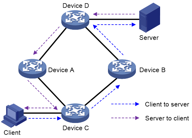

CM connection setup
RDMA sets up CM connections based on RoCE packets or TCP packets with custom fields. NetAnalysis can analyze the RoCE packets and TCP packets used for CM connection setup. The analysis process does not differ much between the packet types. The following information uses RoCE packet-based CM connection setup as an example.
Figure 4 shows the process of CM connection setup.
Figure 4 CM connection setup process
During CM connection setup, the server and the client send the following RoCEv2 ConnectMsg packets:
· Connect Request—Sent by the client to the server to request RoCEv2 connection setup.
· Connect Reply—Returned by the server to the client. After receiving this packet, the client determines that an RoCEv2 connection has been set up with the server.
· ReadyToUse—Sent by the client to the server. After receiving this packet, the server determines that the CM connection is set up successfully.

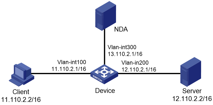

As shown in Figure 5, NetAnalysis can use either of the following modes for RoCEv2 traffic analysis when multiple paths exist between an RoCEv2 client and an RoCEv2 server:
· Bidirectional mode—NetAnalysis monitors bidirectional traffic sent between the server and the client. Based on the 4-tuple information in CM connection setup packets, NetAnalysis can collect RoCEv2 traffic statistics based on sessions and provide the session-specific RTT and lost packet count.
· Unidirectional mode—NetAnalysis monitors the traffic sent from the client to the server to obtain the 3-tuple information used for creating RoCEv2 flow entries. In this mode, NetAnalysis collects RoCEv2 traffic statistics based on flows and provides only packet throughput information.
As a best practice to ensure correct RoCEv2 traffic analysis, configure the mode of RoCEv2 traffic analysis as follows:
· Enable bidirectional mode on the devices attached to the server and the client (Device C and Device D).
· Enable unidirectional mode on the intermediate devices (Device A and Device B).

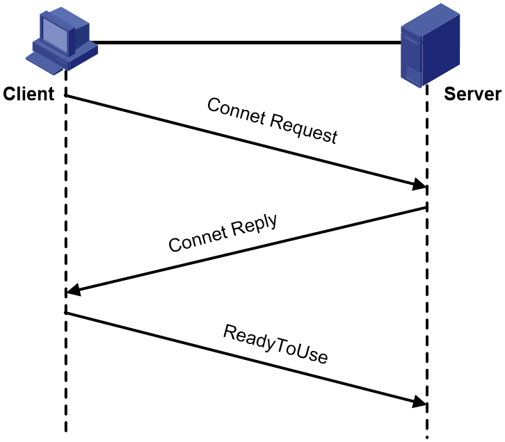

As shown in Figure 6, configure NetAnalysis on the device to analyze the bidirectional RoCEv2 traffic sent between the server and the client and output the RoCEv2 traffic statistics to the NDA.
1. Assign an IP address to each interface, as shown in Figure 6. (Details not shown.)
2. Configure NetAnalysis to analyze RoCEv2 traffic:
# Enable bidirectional RoCEv2 traffic analysis.
<Device> system-view
[Device] netanalysis rocev2 mode bidir
# Enable global RoCEv2 traffic statistics collection.
[Device] netanalysis rocev2 statistics global
# Display configuration and status of the RoCEv2 cache after the device has been operating for a period of time.
[Device] display netanalysis rocev2 cache
