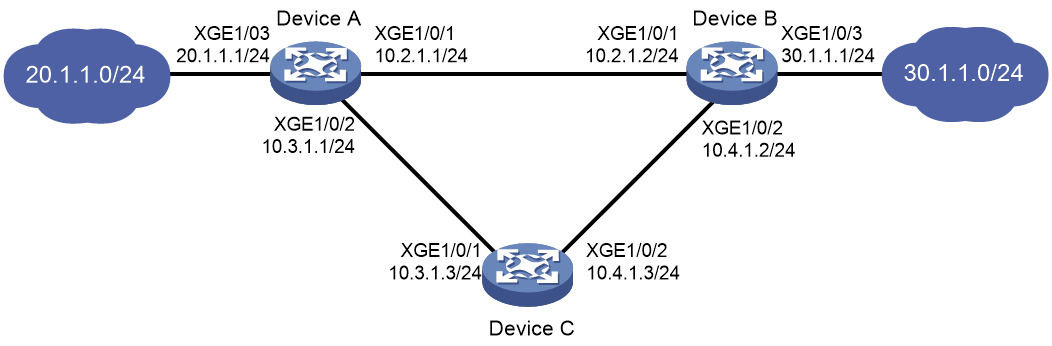

Collaboration application example
The following is an example of collaboration between NQA, Track, and static routing.
Configure a static route with next hop 192.168.0.88 on the device. If the next hop is reachable, the static route is valid. If the next hop becomes unreachable, the static route is invalid. For this purpose, configure NQA-Track-static routing collaboration as follows:
1.     Create an NQA operation to monitor the accessibility of IP address 192.168.0.88.
2.     Create a track entry and associate it with the NQA operation.
¡     When next hop 192.168.0.88 is reachable, NQA sends the result to the Track module. The Track module sets the track entry to Positive state.
¡     When the next hop becomes unreachable, NQA sends the result to the Track module. The Track module sets the track entry to Negative state.
3.     Associate the track entry with the static route.
¡     When the track entry is in Positive state, the static routing module considers the static route to be valid.
¡     When the track entry is in Negative state, the static routing module considers the static route to be invalid.

Track configuration examples
Example: Configuring VRRP-Track-NQA collaboration
As shown in Figure 2:
·     Host A requires access to Host B. The default gateway of Host A is 10.1.1.10/24.
·     Switch A and Switch B belong to VRRP group 1. The virtual IP address of VRRP group 1 is 10.1.1.10.
Configure VRRP-Track-NQA collaboration to monitor the uplink on the master and meet the following requirements:
·     When Switch A operates correctly, Switch A forwards packets from Host A to Host B.
·     When NQA detects a fault on the uplink of Switch A, Switch B forwards packets from Host A to Host B.
Figure 2 Network diagram
1.     Create VLANs and assign ports to them. Configure the IP address of each VLAN interface, as shown in Figure 2. (Details not shown.)
2.     Configure an NQA operation on Switch A:
# Create an NQA operation with administrator name admin and operation tag test.
<SwitchA> system-view
[SwitchA] nqa entry admin test
# Specify the ICMP echo operation type.
[SwitchA-nqa-admin-test] type icmp-echo
# Specify 10.1.2.2 as the destination address of ICMP echo requests.
[SwitchA-nqa-admin-test-icmp-echo] destination ip 10.1.2.2
# Configure the ICMP echo operation to repeat every 100 milliseconds.
[SwitchA-nqa-admin-test-icmp-echo] frequency 100
# Configure reaction entry 1, specifying that five consecutive probe failures trigger the Track module.
[SwitchA-nqa-admin-test-icmp-echo] reaction 1 checked-element probe-fail threshold-type consecutive 5 action-type trigger-only
[SwitchA-nqa-admin-test-icmp-echo] quit

Example: Configuring a control-mode BFD session for a VRRP backup to monitor the master
As shown in Figure 4:
·     Switch A and Switch B belong to VRRP group 1. The virtual IP address of VRRP group 1 is 192.168.0.10.
·     The default gateway of the hosts in the LAN is 192.168.0.10.
Configure VRRP-Track-BFD (control mode) collaboration to monitor the master on the backup and meet the following requirements:
·     When Switch A operates correctly, the hosts in the LAN access the Internet through Switch A.
·     When Switch A fails, the backup (Switch B) can detect the state change of the master through the control-mode BFD session and become the new master. The hosts in the LAN access the Internet through Switch B.
Figure 4 Network diagram

Example: Configuring static routing-Track-BFD (echo mode) collaboration
As shown in Figure 8:
·     Switch A is the default gateway of the hosts in network 20.1.1.0/24.
·     Switch B is the default gateway of the hosts in network 30.1.1.0/24.
·     Hosts in the two networks communicate with each other through static routes.
To ensure network availability, configure route backup and static routing-Track-BFD (echo mode) collaboration on Switch A and Switch B as follows:
·     On Switch A, assign a higher priority to the static route to 30.1.1.0/24 with next hop Switch B. This route is the master route. The static route to 30.1.1.0/24 with next hop Switch C acts as the backup route. When the master route is unavailable, the echo-mode BFD session can quickly detect the route failure to make the backup route take effect.
·     On Switch B, assign a higher priority to the static route to 20.1.1.0/24 with next hop Switch A. This route is the master route. The static route to 20.1.1.0/24 with next hop Switch C acts as the backup route. When the master route is unavailable, the echo-mode BFD session can quickly detect the route failure to make the backup route take effect.
Figure 8 Network diagram
1.     Create VLANs and assign ports to them. Configure the IP address of each VLAN interface, as shown in Figure 8. (Details not shown.)
2.     Configure Switch A:
# Configure a static route to 30.1.1.0/24 with next hop 10.2.1.2 and the default priority (60). Associate this static route with track entry 1.
[SwitchA] ip route-static 30.1.1.0 24 10.2.1.2 track 1
# Configure a static route to 30.1.1.0/24 with next hop 10.3.1.3 and priority 80.
[SwitchA] ip route-static 30.1.1.0 24 10.3.1.3 preference 80
# Specify 10.10.10.10 as the source address of BFD echo packets.
[SwitchA] bfd echo-source-ip 10.10.10.10
# Configure track entry 1, and associate it with the echo-mode BFD session to verify the connectivity between Switch A and Switch B.
[SwitchA] track 1 bfd echo interface vlan-interface 2 remote ip 10.2.1.2 local ip 10.2.1.1
[SwitchA-track-1] quit
3.     Configure Switch B:
# Configure a static route to 20.1.1.0/24 with next hop 10.2.1.1 and the default priority (60). Associate this static route with track entry 1.
<SwitchB> system-view
[SwitchB] ip route-static 20.1.1.0 24 10.2.1.1 track 1
# Configure a static route to 20.1.1.0/24 with next hop 10.4.1.3 and priority 80.
[SwitchB] ip route-static 20.1.1.0 24 10.4.1.3 preference 80
# Specify 1.1.1.1 as the source address of BFD echo packets.
[SwitchB] bfd echo-source-ip 1.1.1.1
# Configure track entry 1, and associate it with the echo-mode BFD session to verify the connectivity between Switch B and Switch A.
[SwitchB] track 1 bfd echo interface vlan-interface 2 remote ip 10.2.1.1 local ip 10.2.1.2
[SwitchB-track-1] quit
4.     Configure Switch C:
# Configure a static route to 30.1.1.0/24 with next hop 10.4.1.2.
<SwitchC> system-view
[SwitchC] ip route-static 30.1.1.0 24 10.4.1.2
# Configure a static route to 20.1.1.0/24 with next hop 10.3.1.1.
[SwitchC] ip route-static 20.1.1.0 24 10.3.1.1

Example: Configuring static routing-Track-BFD (control mode) collaboration
As shown in Figure 9:
To ensure network availability, configure route backup and static routing-Track-BFD (control mode) collaboration on Switch A and Switch B as follows:
·     On Switch A, assign a higher priority to the static route to 30.1.1.0/24 with next hop Switch B. This route is the master route. The static route to 30.1.1.0/24 with next hop Switch C acts as the backup route. When the master route is unavailable, the control-mode BFD session can quickly detect the route failure to make the backup route take effect.
·     On Switch B, assign a higher priority to the static route to 20.1.1.0/24 with next hop Switch A. This route is the master route. The static route to 20.1.1.0/24 with next hop Switch C acts as the backup route. When the master route is unavailable, the control-mode BFD session can quickly detect the route failure to make the backup route take effect.
Figure 9 Network diagram
1.     Create VLANs and assign ports to them. Configure the IP address of each VLAN interface, as shown in Figure 9. (Details not shown.)
# Configure track entry 1, and associate it with the control-mode BFD session to verify the connectivity between Switch A and Switch B.
[SwitchA] track 1 bfd ctrl interface vlan-interface 2 remote ip 10.2.1.2 local ip 10.2.1.1
# Configure track entry 1, and associate it with the control-mode BFD session to verify the connectivity between Switch B and Switch A.
[SwitchB] track 1 bfd ctrl interface vlan-interface 2 remote ip 10.2.1.1 local ip 10.2.1.2

Example: Configuring static routing-Track-LLDP collaboration
Network requirements
As shown in Figure 12:
·     Device A is the default gateway of the hosts in network 20.1.1.0/24.
·     Device B is the default gateway of the hosts in network 30.1.1.0/24.
To ensure network availability, configure route backup and static routing-Track-LLDP collaboration on Device A and Device B as follows:
·     On Device A, assign a higher priority to the static route to 30.1.1.0/24 with next hop Device B. This route is the master route. The static route to 30.1.1.0/24 with next hop Device C acts as the backup route. When the master route is unavailable, the backup route takes effect. Device A forwards packets destined for 30.1.1.0/24 to Device C.
·     On Device B, assign a higher priority to the static route to 20.1.1.0/24 with next hop Device A. This route is the master route. The static route to 20.1.1.0/24 with next hop Device C acts as the backup route. When the master route is unavailable, the backup route takes effect. Device B forwards packets destined for 20.1.1.0/24 to Device C.
Figure 12 Network diagram
1.     Configure the IP address of each interface, as shown in Figure 12. (Details not shown.)
2.     Configure Device A:
# Configure a static route to 30.1.1.0/24 with next hop 10.1.1.2 and the default priority (60). Associate this static route with track entry 1.
<DeviceA> system-view
[DeviceA] ip route-static 30.1.1.0 24 10.2.1.2 track 1
[DeviceA] ip route-static 30.1.1.0 24 10.3.1.3 preference 80
# Enable LLDP globally.
[DeviceA] lldp global enable
# Enable LLDP on Ten-GigabitEthernet 1/0/1. (This step is optional because LLDP is enabled on the port by default.)
[DeviceA] interface ten-gigabitethernet 1/0/1
[DeviceA-Ten-GigabitEthernet1/0/1] lldp enable
# Configure track entry 1 and associate it with the availability of the neighbor for LLDP interface Gigabitethernet 1/0/1.
[DeviceA] track 1 lldp neighbor interface ten-gigabitethernet 1/0/1
[DeviceA-track-1] quit
3.     Configure Device B:
<DeviceB> system-view
[DeviceB] ip route-static 20.1.1.0 24 10.2.1.1 track 1
[DeviceB] ip route-static 20.1.1.0 24 10.4.1.3 preference 80
[DeviceB] lldp global enable
[DeviceB] interface ten-gigabitethernet 1/0/1
[DeviceB-Ten-GigabitEthernet1/0/1] lldp enable
# Configure track entry 1 and associate it with the availability of the neighbor for LLDP interface Ten-GigabitEthernet 1/0/1.
[DeviceB] track 1 lldp neighbor interface ten-gigabitethernet 1/0/1
[DeviceB-track-1] quit
4.     Configure Device C:
<DeviceC> system-view
[DeviceC] ip route-static 30.1.1.0 24 10.4.1.2
[DeviceC] ip route-static 20.1.1.0 24 10.3.1.1
# Display track entry information on Device A.
[DeviceA] display track all
Track ID: 1
  State: Positive
  Duration: 0 days 0 hours 0 minutes 32 seconds
  Tracked object type: LLDP
  Notification delay: Positive 0, Negative 0 (in seconds)
  Tracked object:
    LLDP interface: Ten-GigabitEthernet1/0/1
The output shows that the status of track entry 1 is Positive, indicating that the neighbor of LLDP interface Ten-GigabitEthernet 1/0/1 is available. The master route takes effect.
# Display the routing table of Device A.
[DeviceA] display ip routing-table
Destinations : 9        Routes : 9
10.2.1.0/24         Direct 0    0            10.2.1.1        XGE1/0/1
10.2.1.1/32         Direct 0    0            127.0.0.1       InLoop0
10.3.1.0/24         Direct 0    0            10.3.1.1        XGE1/0/2
10.3.1.1/32         Direct 0    0            127.0.0.1       InLoop0
20.1.1.0/24         Direct 0    0            20.1.1.1        XGE1/0/3
20.1.1.1/32         Direct 0    0            127.0.0.1       InLoop0
30.1.1.0/24         Static 60   0            10.2.1.2        XGE1/0/1
127.0.0.0/8         Direct 0    0            127.0.0.1       InLoop0
127.0.0.1/32        Direct 0    0            127.0.0.1       InLoop0
The output shows that Device A forwards packets to 30.1.1.0/24 through Device B.
