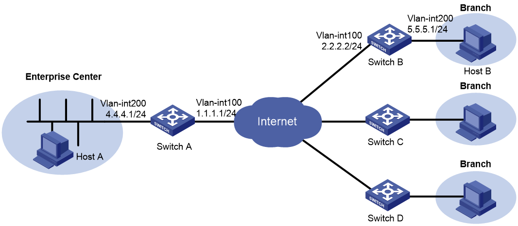

Mirror image ACLs
To make sure SAs can be set up and the traffic protected by IPsec can be processed correctly between two IPsec peers, create mirror image ACLs on the IPsec peers. As shown in Figure 4, ACL rules on Device B are mirror images of the rules on Device A. In this way, SAs can be created successfully for the traffic between Host A and Host C and for the traffic between Network 1 and Network 2.
Figure 4 Mirror image ACLs
If the ACL rules on IPsec peers do not form mirror images of each other, SAs can be set up only when both of the following requirements are met:
·     The range specified by an ACL rule on one peer is covered by its counterpart ACL rule on the other peer. As shown in Figure 5, the range specified by the ACL rule configured on Device A is covered by its counterpart on Device B.
·     The peer with the narrower rule initiates SA negotiation. If a wider ACL rule is used by the SA initiator, the negotiation request might be rejected because the matching traffic is beyond the scope of the responder. As shown in Figure 5, the SA negotiation initiated by Host A to Host C is accepted but the SA negotiations from Host C to Host A, from Host C to Host B, and from Host D to Host A are rejected.
Figure 5 Non-mirror image ACLs

Example: Configuring IPsec RRI
As shown in Figure 9, branches access the enterprise center through an IPsec VPN.
Configure the IPsec VPN as follows:
·     Configure an IPsec tunnel between Switch A and each branch gateway (Switch B, Switch C, and Switch D) to protect traffic between subnets 4.4.4.0/24 and 5.5.5.0/24.
·     Configure the tunnels to use security protocol ESP, encryption algorithm DES, and authentication algorithm SHA1-HMAC-96. Use IKE for IPsec SA negotiation.
·     Configure IKE proposal to use the preshared key authentication method, encryption algorithm 3DES, and authentication algorithm HMAC-SHA1.
·     Configure IPsec RRI on Switch A to automatically create static routes to the branches based on the established IPsec SAs.
Figure 9 Network diagram
1.     Assign IPv4 addresses to the interfaces on the switches according to Figure 9. (Details not shown.)

1.     Verify that IPsec RRI can automatically create a static route from Switch A to Switch B:
# Initiate a connection from subnet 5.5.5.0/24 to subnet 4.4.4.0/24. IKE negotiation is triggered to establish IPsec SAs between Switch A and Switch B. (Details not shown.)
# Verify that IPsec SAs are established on Switch A.

# Verify that IPsec RRI has created a static route to reach Switch B.
[SwitchA] display ip routing-table verbose
2.     Verify that Switch A can automatically create static routes to Switch C and Switch D in the same way that you verify the IPsec RRI feature by using Switch A and Switch B. (Details not shown.)

# Initiate a connection between Switch A and Switch B to trigger IKE negotiation. After IPsec SAs are successfully negotiated by IKE, the traffic between the two switches is IPsec-protected.
Example: Configuring an IKE-based IPsec tunnel for IPv4 packets
As shown in Figure 14, establish an IPsec tunnel between Switch A and Switch B to protect data flows between the switches. Configure the IPsec tunnel as follows:
·     Specify the encapsulation mode as tunnel, the security protocol as ESP, the encryption algorithm as AES-CBC-192, and the authentication algorithm as HMAC-SHA1.
·     Set up SAs through IKE negotiation.
Figure 14 Network diagram

This feature applies to scenarios where the headquarters and branches communicate through virtual tunnels. It enables exchanges of IP address request and set messages between the IPsec gateway at a branch and the IPsec gateway at the headquarters.
Table 2 Parameter descriptions
Parameter
Description
request
Enables the IPsec gateway at a branch to submit IP address request messages to the IPsec gateway at the headquarters.
set accept
Enables the IPsec gateway at a branch to accept the IP addresses pushed by the IPsec gateway at the headquarters.
set send
Enables the IPsec gateway at the headquarters to push IP addresses to IPsec gateways at branches.
