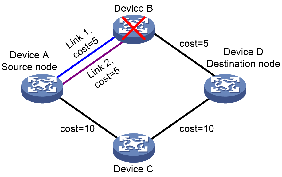

On a network, IPv4 and IPv6 topologies must be consistent so that both IPv6 IS-IS and IPv4 IS-IS can use the SPF algorithm to perform route calculation. If they are different, routers supporting both IPv4 and IPv6 might send IPv6 packets to routers that do not support IPv6, resulting in packet loss.
To resolve this issue, configure IPv6 IS-IS MTR to perform route calculation separately in IPv4 and IPv6 topologies.
Figure 7 Network diagram
As shown in Figure 7, the numbers refer to the link costs. Router A, Router B, and Router D support both IPv4 and IPv6. Router C supports only IPv4 and cannot forward IPv6 packets.
Enable IPv6 IS-IS MTR on Router A, Router B, Router C, and Router D to make them perform route calculation separately in IPv4 and IPv6 topologies. With this configuration, Router A does not forward IPv6 packets destined to Router D through Router B, avoiding packet loss.
As a best practice to avoid route calculation failures, configure this feature when both IPv4 and IPv6 topologies exist in the network.

Setting the LSDB overload bit
By setting the overload bit in sent LSPs, an IS-IS device informs other devices of failures that make it unable to select routes and forward packets. The device is then excluded from the SPF calculation by other devices except its direct routes.
When an IS-IS device cannot record the complete LSDB, for example, because of memory insufficiency, it will calculate routes incorrectly. To locate the faulty device, you can temporarily isolate the suspects from the IS-IS network by setting the overload bit.
As shown in Figure 12, the path from Device A to the IP network should be Device A > Device D > Device E > IP network. After you set the overload bit in the LSPs sent by Device D, the path from Device A to the IP network becomes Device A > Device B > Device C > Device E > IP network. If the packets from Device A are destined for Device D's directly-connected networks, the forwarding path does not change.
Figure 12 Overload bit
When both IPv4 and IPv6 topologies exist, the following rules apply to the set-overload command and the multi-topology command:
·     If the set-overload command is executed in IS-IS view and the multi-topology command is not executed, the set-overload command takes effect on both IPv4 IS-IS and IPv6 IS-IS.
·     If the following conditions exist, the set-overload command does not take effect on IPv6 IS-IS after it is executed in IS-IS IPv6 unicast address family view:

Configuring IS-IS isolation
Isolation is a method used for network device maintenance. It gracefully removes a device from the packet forwarding path for maintenance and gracefully adds the device to the network after maintenance.
To reduce impact on traffic forwarding, you can isolate a device before upgrading it. IS-IS isolation works as follows:
1.     After IS-IS isolation is enabled for a device, IS-IS sets the overload bit in the LSPs advertised by the device and sets the link cost to the maximum value.
2.     Each neighbor of the device reselects an optimal route based on the LSPs and stops forwarding traffic to the device. The device is fully isolated from the network and you can upgrade the device.
3.     After the maintenance, disable IS-IS isolation on the device to gracefully add it back to the network by clearing its overload bit and restoring its link cost.
2.     Enter IS-IS view.
isis [ process-id ]
3.     Configure IS-IS isolation.
a.     Enable IS-IS isolation to gracefully remove the device from the network.
isolate enable
b.     Disable IS-IS isolation to gracefully add the device to the network.
undo isolate enable
By default, IS-IS isolation is disabled.

IS-IS ECMP-shared FRR
In ECMP scenarios, IS-IS supports using the LFA algorithm to calculating a shared backup next hop for multiple ECMP primary paths. All ECMP routes has the same backup next hop.
As shown in Figure 14, traffic is forwarded from source node Device A to destination node Device D, and is load shared between Link 1 and Link 2.
·     Without ECMP-shared FRR enabled, the LFA algorithm does not calculate a backup next hop for Link 1 or Link 2. When Device B fails, Link 1 and Link 2 become unavailable, and traffic is interrupted before route reconvergence is completed.
·     With ECMP-shared FRR enabled, the LFA algorithm calculates a shared backup next hop for Link 1 and Link 2. When Device B fails, traffic is switched to backup next hop Device C. This avoids traffic interruption.
Figure 14 IS-IS ECMP-shared FRR

IS-IS configuration examples
Example: Configuring basic IS-IS
As shown in Figure 16, Switch A, Switch B, Switch C, and Switch D reside in an IS-IS AS.
Switch A and B are Level-1 switches, Switch D is a Level-2 switch, and Switch C is a Level-1-2 switch. Switch A, Switch B, and Switch C are in Area 10, and Switch D is in Area 20.
Figure 16 Network diagram

Example: Configuring IS-IS authentication
As shown in Figure 19, Switch A, Switch B, Switch C, and Switch D reside in the same IS-IS routing domain. Run IS-IS among them.
Switch A, Switch B, and Switch C belong to Area 10, and Switch D belongs to Area 20.
·     Configure neighbor relationship authentication between neighbors.
·     Configure area authentication in Area 10 to prevent untrusted routes from entering into the area.
·     Configure routing domain authentication on Switch C and Switch D to prevent untrusted routes from entering the routing domain.
Figure 19 Network diagram
1.     Configure IP addresses for interfaces. (Details not shown.)
2.     Configure basic IS-IS:
# Configure Switch A.
<SwitchA> system-view
[SwitchA] isis 1
[SwitchA-isis-1] network-entity 10.0000.0000.0001.00
[SwitchA-isis-1] quit
[SwitchA-Vlan-interface100] isis enable 1
# Configure Switch B.
<SwitchB> system-view
[SwitchB] isis 1
[SwitchB-isis-1] network-entity 10.0000.0000.0002.00
[SwitchB-isis-1] quit
[SwitchB] interface vlan-interface 200
[SwitchB-Vlan-interface200] isis enable 1
[SwitchB-Vlan-interface200] quit
# Configure Switch C.
<SwitchC> system-view
[SwitchC] isis 1
[SwitchC-isis-1] network-entity 10.0000.0000.0003.00
[SwitchC-isis-1] quit
[SwitchC] interface vlan-interface 200
[SwitchC-Vlan-interface200] isis enable 1
[SwitchC-Vlan-interface200] quit
[SwitchC] interface vlan-interface 300
[SwitchC-Vlan-interface300] isis enable 1
[SwitchC-Vlan-interface300] quit
# Configure Switch D.
<SwitchD> system-view
[SwitchD] isis 1
[SwitchD-isis-1] network-entity 20.0000.0000.0001.00
[SwitchD-isis-1] quit
[SwitchD] interface vlan-interface 300
[SwitchD-Vlan-interface300] isis enable 1
[SwitchD-Vlan-interface300] quit
3.     Configure neighbor relationship authentication between neighbors:
# Set the authentication mode to MD5 and set the plaintext key to eRq on VLAN-interface 100 of Switch A and on VLAN-interface 100 of Switch C.
[SwitchA-Vlan-interface100] isis authentication-mode md5 plain eRg
[SwitchC] interface vlan-interface 100
[SwitchC-Vlan-interface100] isis authentication-mode md5 plain eRg
[SwitchC-Vlan-interface100] quit
# Set the authentication mode to MD5 and set the plaintext key to t5Hr on VLAN-interface 200 of Switch B and on VLAN-interface 200 of Switch C.
[SwitchB-Vlan-interface200] isis authentication-mode md5 plain t5Hr
[SwitchC-Vlan-interface200] isis authentication-mode md5 plain t5Hr
# Set the authentication mode to MD5 and set the plaintext key to hSec on VLAN-interface 300 of Switch D and on VLAN-interface 300 of Switch C.
[SwitchC-Vlan-interface300] isis authentication-mode md5 plain hSec
[SwitchD-Vlan-interface300] isis authentication-mode md5 plain hSec
4.     Set the area authentication mode to MD5 and set the plaintext key to 10Sec on Switch A, Switch B, and Switch C.
[SwitchA] isis 1
[SwitchA-isis-1] area-authentication-mode md5 plain 10Sec
[SwitchB] isis 1
[SwitchB-isis-1] area-authentication-mode md5 plain 10Sec
[SwitchC] isis 1
[SwitchC-isis-1] area-authentication-mode md5 plain 10Sec
5.     Set routing domain authentication mode to MD5 and set the plaintext key to 1020Sec on Switch C and Switch D.
[SwitchC] isis 1
[SwitchC-isis-1] domain-authentication-mode md5 plain 1020Sec
[SwitchD] isis 1
[SwitchD-isis-1] domain-authentication-mode md5 plain 1020Sec
Example: Configuring IS-IS GR
As shown in Figure 20, Switch A, Switch B, and Switch C belong to the same IS-IS routing domain.
Figure 20 Network diagram
1.     Configure IP addresses and subnet masks for interfaces. (Details not shown.)
2.     Configure IS-IS on the switches to make sure Switch A, Switch B, and Switch C can communicate with each other at layer 3 and dynamic route update can be implemented among them with IS-IS. (Details not shown.)
3.     Enable IS-IS GR on Switch A.

Example: Configuring BFD for IS-IS
·     As shown in Figure 21, run IS-IS on Switch A, Switch B and Switch C so that they can reach each other at the network layer.
·     After the link over which Switch A and Switch B communicate through the Layer-2 switch fails, BFD can quickly detect the failure and notify IS-IS of the failure. Switch A and Switch B then communicate through Switch C.
Figure 21 Network diagram
Table 4 Interface and IP address assignment
Device
Interface
IP address
Device
Interface
IP address
Switch A
Vlan-int10
10.1.0.102/24
Switch B
Vlan-int10
10.1.0.100/24
Vlan-int11
11.1.1.1/24
Vlan-int13
13.1.1.1/24
Loop0
121.1.1.1/32
Loop0
120.1.1.1/32
Switch C
Vlan-int11
11.1.1.2/24
Vlan-int13
13.1.1.2/24

3.     Configure BFD functions:
# Enable BFD and configure BFD parameters on Switch A.
[SwitchA] bfd session init-mode passive
[SwitchA-Vlan-interface10] isis bfd enable
[SwitchA-Vlan-interface10] bfd min-receive-interval 500
[SwitchA-Vlan-interface10] bfd min-transmit-interval 500
[SwitchA-Vlan-interface10] bfd detect-multiplier 7
[SwitchA-Vlan-interface10] quit
# Enable BFD and configure BFD parameters on Switch B.
[SwitchB] bfd session init-mode active
[SwitchB] interface vlan-interface 10
[SwitchB-Vlan-interface10] isis bfd enable
[SwitchB-Vlan-interface10] bfd min-receive-interval 500
[SwitchB-Vlan-interface10] bfd min-transmit-interval 500
[SwitchB-Vlan-interface10] bfd detect-multiplier 8
[SwitchB-Vlan-interface10] quit
# Display the BFD session information on Switch A.
[SwitchA] display bfd session
 Total sessions: 1     Up sessions: 1     Init mode: Active
 IPv4 session working in control packet mode:
 LD/RD            SourceAddr      DestAddr        State  Holdtime    Interface
 3/1              192.168.0.102   192.168.0.100   Up     1700ms      Vlan10

The output shows that Switch A and Switch B communicate through VLAN-interface 10. Then the link over VLAN-interface 10 fails.

The output shows that Switch A and Switch B communicate through VLAN-interface 11.

Example: Configuring BFD for IPv6 IS-IS
As shown in Figure 25:
·     Configure IPv6 IS-IS on Switch A and Switch B so that they can reach other.
·     Enable BFD on VLAN-interface 10 of Switch A and Switch B.
After the link between Switch B and the Layer 2 switch fails, BFD can quickly detect the failure and notify IPv6 IS-IS of the failure. Then Switch A and Switch B communicate through Switch C.
Figure 25 Network diagram
Table 7 Interface and IP address assignment
Device
Interface
IPv6 address
Device
Interface
IPv6 address
Switch A
Vlan-int10
2001::1/64
Switch B
Vlan-int10
2001::2/64
Vlan-int11
2001:2::1/64
Vlan-int13
2001:3::2/64
Switch C
Vlan-int11
2001:2::2/64
Vlan-int13

Example: Configuring IPv6 IS-IS FRR
As shown in Figure 26, Switch A, Switch B, and Switch C belong to the same IS-IS routing domain. Configure IPv6 IS-IS FRR so that when the Link A fails, traffic can be switched to Link B immediately.
Figure 26 Network diagram
Table 8 Interface and IP address assignment
Device
Interface
IPv6 address
Device
Interface
IPv6 address
Switch A
Vlan-int100
1::1/64
Switch B
Vlan-int101
3::1/64
Vlan-int200
2::1/64
Vlan-int200
2::2/64
Loop0
10::1/128
Loop0
20::1/128
Switch C
Vlan-int100
1::2/64
Vlan-int101
3::2/64
1.     Configure IPv6 addresses for interfaces on the switches and enable IPv6 IS-IS. (Details not shown.)
2.     Configure IPv6 IS-IS on the switches to make sure Switch A, Switch B, and Switch C can communicate with each other at Layer 3. (Details not shown.)
3.     Configure IPv6 IS-IS FRR:
Enable IPv6 IS-IS FRR to calculate a backup next hop through LFA calculation, or designate a backup next hop by using a routing policy.
¡     (Method 1.) Enable IPv6 IS-IS FRR to calculate a backup next hop through LFA calculation:
