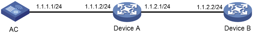

You can use the ping –r command to display the routers through which ICMP echo requests have passed. The test procedure of ping –r is as shown in Figure 1:
1.     The source device (Device A) sends an ICMP echo request to the destination device (Device C) with the RR option empty.
2.     The intermediate device (Device B) adds the IP address of its outbound interface (1.1.2.1) to the RR option of the ICMP echo request, and forwards the packet.
3.     Upon receiving the request, the destination device copies the RR option in the request and adds the IP address of its outbound interface (1.1.2.2) to the RR option. Then the destination device sends an ICMP echo reply.
4.     The intermediate device adds the IP address of its outbound interface (1.1.1.2) to the RR option in the ICMP echo reply, and then forwards the reply.
5.     Upon receiving the reply, the source device adds the IP address of its inbound interface (1.1.1.1) to the RR option. The detailed information of routes from Device A to Device C is formatted as: 1.1.1.1 <-> {1.1.1.2; 1.1.2.1} <-> 1.1.2.2.

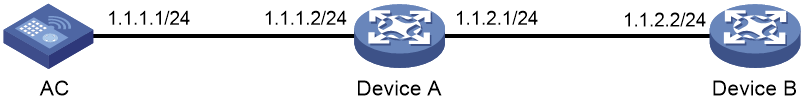

As shown in Figure 2, determine if the AC and Device B can reach each other.
Figure 2 Network diagram

As shown in Figure 4, the AC failed to Telnet to Device B.
Test the network connectivity between the AC and Device B. If they cannot reach each other, locate the failed nodes in the network.
Figure 4 Network diagram
