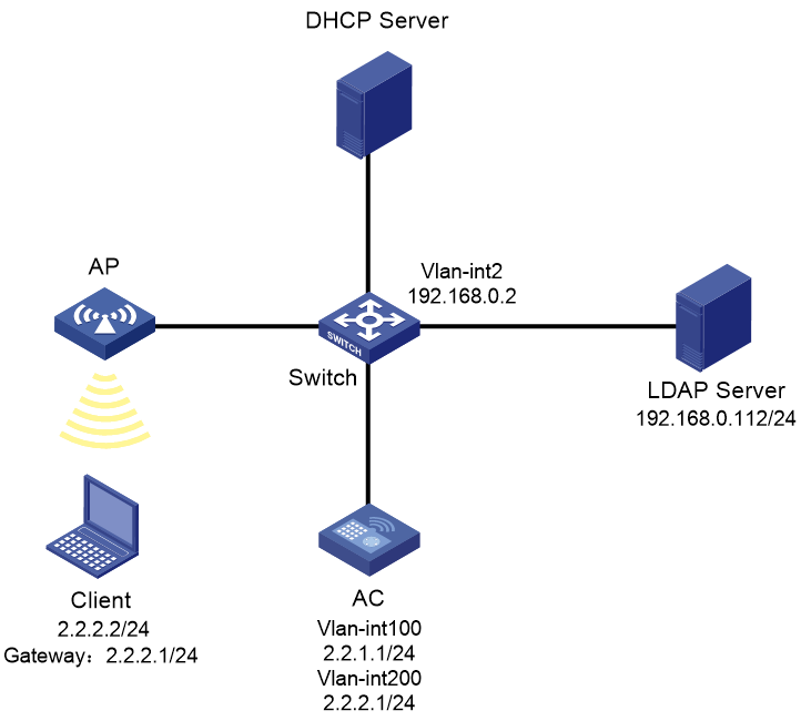

As shown in Figure 1, the AP and the client obtain IP addresses from the DHCP server.
Configuration requirements are as follows:
·     Configure the local portal service on the AC to provide authentication pages for clients.
·     Use the LDAP server to authenticate the clients.
Figure 1 Network diagram
Configure routing to make sure the devices can reach one another.
Use the actual serial ID of an AP to uniquely identify that AP.
Edit the authentication pages, compress them to a .zip file (this example uses abc.zip), and then upload the file to the root directory of the storage medium of the AC. On the AC, you must specify this file as the default authentication page file.
To change the default authentication page file, you must first execute the undo default-logon-page command, and then specify a new default authentication page file.
