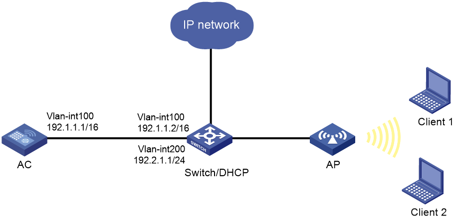

As shown in Figure 1, the switch acts as a DHCP server to assign IP addresses to the AP and the clients. The AP establishes CAPWAP tunnels with the AC in VLAN 100 and clients use VLAN 200 to access the WLAN. Configure local forwarding on the AC to enable the AP to forward client traffic.
Figure 1 Network diagram

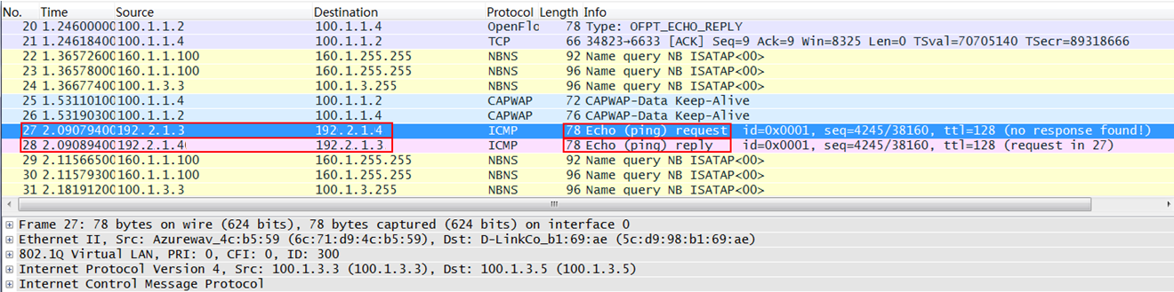

# Ping Client 1 on Client 2 and ping Client 2 on Client 1.
# Capture packets and verify that client traffic is forwarded by the AP.
Figure 2 ICMP packets from clients
