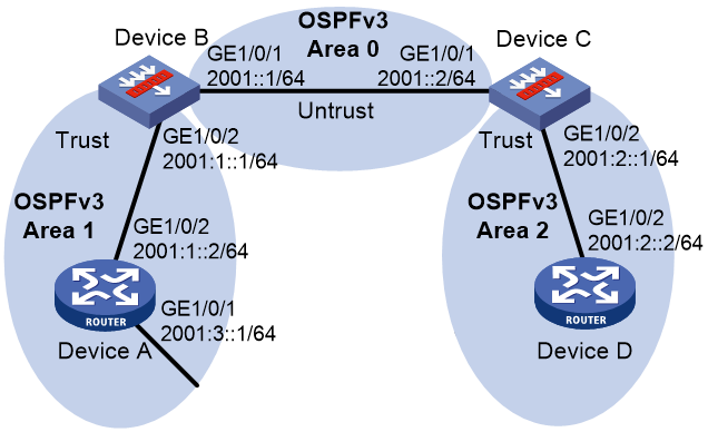

OSPFv3 configuration examples
Example: Configuring OSPFv3 stub area
As shown in Figure 2:
·     Enable OSPFv3 on all devices.
·     Split the AS into three areas.
·     Configure Device B and Device C as ABRs to forward routing information between areas.
·     Configure Area 2 as a stub area to reduce LSAs in the area without affecting route reachability.
Figure 2 Network diagram
# Configure Device B.
1.     Configure IPv6 addresses for interfaces correctly according to Figure 2.

4.     Configure basic OSPFv3 functions:
# On Device A, enable OSPFv3 and specify the device ID as 1.1.1.1.
<DeviceA> system-view
[DeviceA] ospfv3 1
[DeviceA-ospfv3-1] router-id 1.1.1.1
[DeviceA-ospfv3-1] quit

  Interface  : GE1/0/2                   BkInterface: N/A
  Nexthop    : ::
  BkNexthop  : N/A
 *Destination: 2001:3::/64
  Type       : IA                        Area       : 0.0.0.2
  AdvRouter  : 1.1.1.1                   Preference : 10
  NibID      : 0x23000002                Cost       : 4
  Nexthop    : FE80::CCA:73FF:FEA2:206
  BkNexthop  : N/A
 Total: 5
 Intra area: 1         Inter area: 4         ASE: 0         NSSA: 0
# Verify that devices in area 1 can ping devices in area 2, and vice versa.
