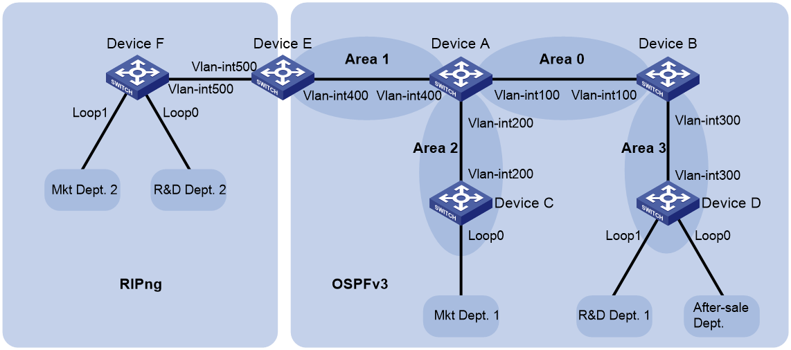

As shown in Figure 1, the devices of an enterprise reside in OSPFv3 and RIPng domains.
Configure route redistribution between OSPFv3 and RIPng to interconnect the devices.
Configure route filtering on Device E, Device C, and Device D to meet the following requirements:
·     The route destined for R&D department 2 is not redistributed to OSPFv3.
·     Marketing department 1 cannot reach R&D department 1.
·     R&D department 1 and the After-sale service department cannot reach Marketing department 2.
Figure 1 Network diagram

When you configure OSPFv3 route filtering, follow these restrictions and guidelines:
·     The filter-policy export command that filters redistributed routes takes effect only on an ASBR.
·     OSPFv3 filters routes calculated using received LSAs. It does not filter LSAs.
·     IP communication is bidirectional. If a router filters out a route destined for Network A, the subnets attached to the router cannot reach Network A, and Network A cannot reach the subnets.
·     When you configure route filtering by referencing an ACL, configure the rule permit source any item following multiple rule deny source items to allow unmatched routes to pass.
·     Specify a Router ID when you configure OSPFv3.

# On Device E, use ACL 2000 to filter routes redistributed from RIPng.
[DeviceE] ospfv3
[DeviceE-ospfv3-1] filter-policy 2000 export ripng 1
[DeviceE-ospfv3-1] quit
# Verify that Device C does not have a route to 12::/64.

# Verify that Marketing department 1 cannot reach R&D department 1.
[DeviceC] ping ipv6 -a 13::1 12::1

# Verify that Device D does not have a route to 15::/64.

# Verify that the After-sale service department cannot reach Marketing department 2.
[DeviceD] ping ipv6 -a 11::1 15::1

# Verify that R&D department 1 cannot reach Marketing department 2.
[DeviceD] ping ipv6 -a 12::1 15::1

The output on Device C and Device D shows that Device E has filtered out the route destined for R&D development 2.
