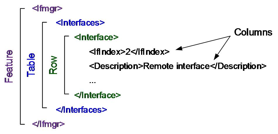

Node, module, table, row, and column
In H3C NETCONF XML AI references, elements are also called nodes. An element might be a module, table, row, or column node.
·     Module—Also called feature. A module defines a hierarchy of related nodes. The element name for a module node is the module name.
·     Table—A table contains rows and columns, with each row representing an object instance and each column containing a parameter for the instance. A table might also contain subtables.
·     Row—Each row represents an object instance in the table.
·     Column—Each column contains a parameter for the instance.
Figure 1 shows the basic concepts in an example NETCONF message.
Figure 1 Basic concepts in a NETCONF message
In this example, the Ifmgr element represents the interface management module (Ifmgr). The Interfaces element is a table node in the Ifmgr module and it contains a table of interfaces. The Interface element is a row node and it contains data about an interface in the interface table. The IfIndex and Description elements are column nodes that contain the interface index and description of the interface.

Filtering data
About data filtering
You can define a filter to filter information when you perform a <get>, <get-bulk>, <get-config>, or <get-bulk-config> operation. Data filtering includes the following types:
·     Table-based filtering—Filters table information.
·     Column-based filtering—Filters information for a single column.
Restrictions and guidelines for data filtering
For table-based filtering to take effect, you must configure table-based filtering before column-based filtering.
Column-based filtering includes full match filtering, regular expression match filtering, and conditional match filtering. Full match filtering has the highest priority and conditional match filtering has the lowest priority. When more than one filtering criterion is specified, the one with the highest priority takes effect.
You can specify an element value in an XML message to implement full match filtering. If multiple element values are provided, the system returns the data that matches all the specified values.
