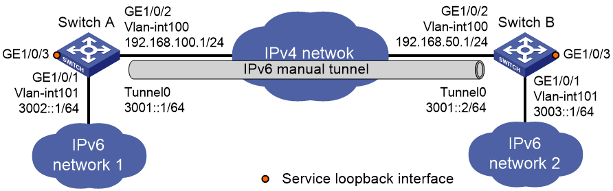

IPv6 over IPv4 tunneling enables isolated IPv6 networks to communicate, as shown in Figure 1.
The devices at both ends of an IPv6 over IPv4 tunnel must support the IPv4/IPv6 dual stack.
Figure 1 IPv6 over IPv4 tunnel
The IPv6 over IPv4 tunnel processes packets by using the following steps:
1.     A host in the IPv6 network sends an IPv6 packet to Device A at the tunnel source.
2.     After Device A receives the IPv6 packet, it processes the packet as follows:
a.     Searches the routing table to identify the outgoing interface for the IPv6 packet.
The outgoing interface is the tunnel interface, so Device A knows that the packet needs to be forwarded through the tunnel.
b.     Adds an IPv4 header to the IPv6 packet and forwards the packet through the physical interface of the tunnel.
In the IPv4 header, the source IPv4 address is the IPv4 address of the tunnel source, and the destination IPv4 address is the IPv4 address of the tunnel destination.
3.     Upon receiving the packet, Device B de-encapsulates the packet.
4.     If the destination address of the IPv6 packet is itself, Device B forwards it to the upper-layer protocol. If it is not, Device B forwards it according to the routing table.

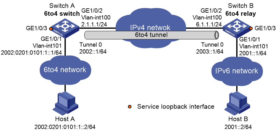

·     6to4 relay
6to4 relay connects a 6to4 network and an IPv6 network that uses an IP prefix other than 2002::/16. A 6to4 relay router is a gateway that forwards packets from a 6to4 network to an IPv6 network.
As shown in Figure 2, 6to4 network Site 1 communicates with IPv6 network Site 3 over a 6to4 tunnel. Configure a static route on the border router (Device A) in the 6to4 network. The next hop address must be the 6to4 address of the 6to4 relay router (Device C). Device A forwards all packets destined for the IPv6 network over the 6to4 tunnel, and Device C then forwards them to the IPv6 network.

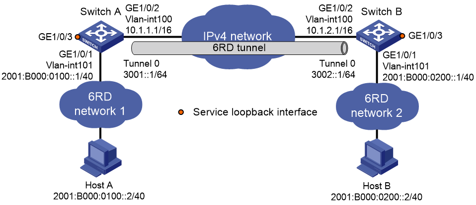

·     Ordinary 6RD tunneling
A 6RD tunnel is a point-to-multipoint automatic tunnel. It is an extension of 6to4 tunneling. The IPv6 prefix of a 6RD network is assigned by the service provider and is not limited to the prefix 2002::/16. 6RD does not require embedding all 32 bits of an IPv4 address in a 6RD address.

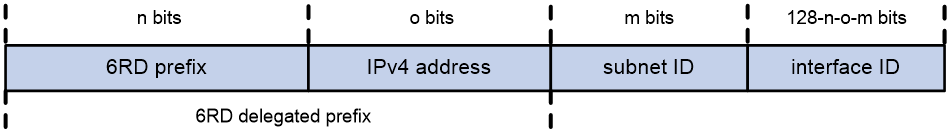

Figure 4 shows the format of 6RD address—an IPv6 address with a 6RD prefix and an embedded IPv4 address.
¡     6RD prefix—IPv6 prefix assigned by the service provider to a 6RD network.
¡     IPv4 address—All or part of the IPv4 tunnel source address in hexadecimal notation. For example, assume that the IPv4 tunnel source address is 1.2.3.4 and both the IPv4 prefix length and suffix length are specified as 8 bits. Then, the prefix of the IPv4 address 1.2.3.4 is 01, the suffix is 04, and the embedded IPv4 address is 0203.
¡     6RD delegated prefix—The 6RD prefix and the embedded IPv4 address together form a 6RD delegated prefix. It uniquely identifies a 6RD network (an IPv6 network where all hosts use 6RD addresses).
¡     Subnet ID—Identifies a subnet in the 6RD network.
¡     Interface ID—The subnet ID and the interface ID together identify a host in the 6RD network.
The device automatically identifies the tunnel destination IPv4 address according to the IPv4 address embedded in the 6RD address, the 6RD prefix, and the IPv4 prefix and suffix.
Figure 4 6RD address format

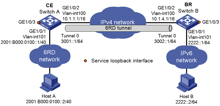

·     6RD relay
6 RD relay connects a 6RD network and an IPv6 network that uses a prefix other than a 6RD delegated prefix. A 6RD border relay (BR) router is a gateway that forwards packets from a 6RD network to an IPv6 network. The border router connected to the 6RD network is called 6RD CE.
As shown in Figure 5, for the 6RD network site 1 to communicate with the IPv6 network site 3 over a 6RD tunnel, you must configure 6RD relay. Configure a static route on the border router (Device A) in the 6RD network. The next hop address must be the 6RD address of the 6RD BR router (Device C). Device A forwards all packets destined for the IPv6 network over the 6RD tunnel, and Device C then forwards them to the IPv6 network.

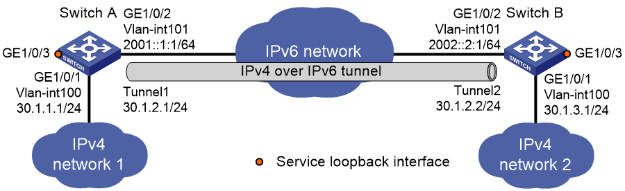

IPv4 over IPv6 tunneling adds an IPv6 header to IPv4 packets so that the IPv4 packets can pass an IPv6 network through a tunnel to realize interworking between isolated IPv4 networks.
Figure 6 IPv4 over IPv6 tunnel
Figure 6 shows the encapsulation and de-encapsulation processes.
·     Encapsulation:
a.     Upon receiving an IPv4 packet, Device A delivers it to the IPv4 protocol stack.
b.     The IPv4 protocol stack uses the destination address of the packet to determine the egress interface. If the egress interface is the tunnel interface, the IPv4 protocol stack delivers the packet to the tunnel interface.
c.     The tunnel interface adds an IPv6 header to the original IPv4 packet and delivers the packet to the IPv6 protocol stack.
d.     The IPv6 protocol stack uses the destination IPv6 address of the packet to look up the routing table, and then sends it out.
·     De-encapsulation:
a.     Upon receiving the IPv6 packet from the attached IPv6 network, Device B delivers the packet to the IPv6 protocol stack to examine the protocol type encapsulated in the data portion of the packet.
b.     If the protocol type is IPv4, the IPv6 protocol stack delivers the packet to the tunneling module.
c.     The tunneling module removes the IPv6 header and delivers the remaining IPv4 packet to the IPv4 protocol stack.
d.     The IPv4 protocol stack forwards the IPv4 packet.

Example: Configuring an IPv6 over IPv4 manual tunnel
As shown in Figure 7, configure an IPv6 over IPv4 tunnel between Switch A and Switch B so the two IPv6 networks can reach each other over the IPv4 network. Because the tunnel destination IPv4 address cannot be automatically obtained from the destination IPv6 addresses, configure an IPv6 over IPv4 manual tunnel.
Figure 7 Network diagram
Make sure Switch A and Switch B have the corresponding VLAN interfaces created and can reach each other through IPv4.

# Use the display ipv6 interface command to display tunnel interface status on Switch A and Switch B. Verify that the interface tunnel 0 is up. (Details not shown.)
# Verify that Switch B and Switch A can ping the IPv6 address of VLAN-interface 101 of each other. This example uses Switch A.
[SwitchA] ping ipv6 3003::1
Ping6(56 data bytes) 3001::1 --> 3003::1, press CTRL_C to break
56 bytes from 3003::1, icmp_seq=0 hlim=64 time=45.000 ms
56 bytes from 3003::1, icmp_seq=1 hlim=64 time=10.000 ms
56 bytes from 3003::1, icmp_seq=2 hlim=64 time=4.000 ms
56 bytes from 3003::1, icmp_seq=3 hlim=64 time=10.000 ms
56 bytes from 3003::1, icmp_seq=4 hlim=64 time=11.000 ms
--- Ping6 statistics for 3003::1 ---
round-trip min/avg/max/std-dev = 4.000/16.000/45.000/14.711 ms

Example: Configuring a 6to4 tunnel
As shown in Figure 9, configure a 6to4 tunnel between 6to4 switches Switch A and Switch B so the two hosts can reach each other over the IPv4 network.
Figure 9 Network diagram
Analysis
To enable communication between 6to4 networks, configure 6to4 addresses for 6to4 switches and hosts in the 6to4 networks.
·     The IPv4 address of VLAN-interface 100 on Switch A is 2.1.1.1/24, and the corresponding 6to4 prefix is 2002:0201:0101::/48. Host A must use this prefix.
·     The IPv4 address of VLAN-interface 100 on Switch B is 5.1.1.1/24, and the corresponding 6to4 prefix is 2002:0501:0101::/48. Host B must use this prefix.

Example: Configuring 6to4 relay
As shown in Figure 10, Switch A is a 6to4 switch, and 6to4 addresses are used on the connected IPv6 network. Switch B acts as a 6to4 relay switch and is connected to the IPv6 network (2001::/16). Configure a 6to4 tunnel between Switch A and Switch B to make Host A and Host B reachable to each other.
The configuration on a 6to4 relay switch is similar to that on a 6to4 switch. To enable communication between the 6to4 network and the IPv6 network, configure a route destined for the IPv6 network on the 6to4 switch. The IPv4 address of VLAN-interface 100 on the relay switch is 6.1.1.1/24 and its corresponding 6to4 prefix is 2002:0601:0101::/48. The next hop of the static route must be an address using this prefix.
Figure 10 Network diagram
1.     Configure Switch A:
# Add GigabitEthernet 1/0/2 (the physical interface of the tunnel) to VLAN 100.
<SwitchA> system-view
[SwitchA] vlan 100
[SwitchA-vlan100] port gigabitethernet 1/0/2
[SwitchA-vlan100] quit
# Specify an IPv4 address for VLAN-interface 100.
[SwitchA-Vlan-interface100] ip address 2.1.1.1 255.255.255.0
# Add GigabitEthernet 1/0/1 to VLAN 101.
[SwitchA] vlan 101
[SwitchA-vlan101] port gigabitethernet 1/0/1
[SwitchA-vlan101] quit
# Specify a 6to4 address for VLAN-interface 101.
[SwitchA] interface vlan-interface 101
[SwitchA-Vlan-interface101] ipv6 address 2002:0201:0101:1::1/64
[SwitchA-Vlan-interface101] quit
# Create service loopback group 1, and specify its service type as tunnel.
[SwitchA] service-loopback group 1 type tunnel
# Assign GigabitEthernet 1/0/3 to service loopback group 1.
[SwitchA] interface gigabitethernet 1/0/3
[SwitchA-GigabitEthernet1/0/3] port service-loopback group 1
[SwitchA-GigabitEthernet1/0/3] quit
# Create 6to4 tunnel interface Tunnel 0.
[SwitchA] interface tunnel 0 mode ipv6-ipv4 6to4
# Specify an IPv6 address for the tunnel interface.
[SwitchA-Tunnel0] ipv6 address 2002::1/64
# Specify the source interface as VLAN-interface 100 for the tunnel interface.
[SwitchA-Tunnel0] source vlan-interface 100
[SwitchA-Tunnel0] quit
# Configure a static route destined for the 6to4 relay switch.
[SwitchA] ipv6 route-static 2002:0601:0101:: 64 tunnel 0
# Configure a default route to reach the IPv6 network, which specifies the 6to4 address of the 6to4 relay switch as the next hop.
[SwitchA] ipv6 route-static :: 0 2002:0601:0101::1
2.     Configure Switch B:
<SwitchB> system-view
[SwitchB] vlan 100
[SwitchB-vlan100] port gigabitethernet 1/0/2
[SwitchB-vlan100] quit
[SwitchB-Vlan-interface100] ip address 6.1.1.1 255.255.255.0
[SwitchB] vlan 101
[SwitchB-vlan101] port gigabitethernet 1/0/1
[SwitchB-vlan101] quit
# Specify an IPv6 address for VLAN-interface 101.
[SwitchB] interface vlan-interface 101
[SwitchB-Vlan-interface101] ipv6 address 2001::1/16
[SwitchB-Vlan-interface101] quit
[SwitchB] service-loopback group 1 type tunnel
[SwitchB] interface gigabitethernet 1/0/3
[SwitchB-GigabitEthernet1/0/3] port service-loopback group 1
[SwitchB-GigabitEthernet1/0/3] quit
[SwitchB] interface tunnel 0 mode ipv6-ipv4 6to4
[SwitchB-Tunnel0] ipv6 address 2003::1/64
# Specify VLAN-interface 100 as the source interface of the tunnel interface.
[SwitchB-Tunnel0] source vlan-interface 100
[SwitchB-Tunnel0] quit
# Configure a static route destined for 2002::/16 through the tunnel interface.
[SwitchB] ipv6 route-static 2002:: 16 tunnel 0
# Verify that Host A and Host B can ping each other.
D:\>ping6 -s 2002:201:101:1::2 2001::2
Pinging 2001::2
from 2002:201:101:1::2 with 32 bytes of data:
Reply from 2001::2: bytes=32 time=13ms
Reply from 2001::2: bytes=32 time=1ms
Reply from 2001::2: bytes=32 time<1ms
Ping statistics for 2001::2:
    Minimum = 0ms, Maximum = 13ms, Average = 3ms

Example: Configuring a 6RD tunnel
As shown in Figure 12, Host A and Host B are in different 6RD networks. Configure a 6RD tunnel between Switch A and Switch B so Host A and Host B can reach each other over the IPv4 network.
Figure 12 Network diagram
Analysis
To enable communication between 6RD networks, you must perform the following tasks in addition to the 6RD tunnel configuration:
·     On Switch A and Switch B, configure the 6RD prefix as 2001:B000::/32, the IPv4 prefix length as 16, and the IPv4 suffix length as 8.
·     Configure 6RD addresses for the switches and hosts.
¡     On Switch A, the tunnel source IPv4 address is 10.1.1.1/16, the IPv4 address of VLAN-interface 100. Calculated based on this IPv4 address, the 6RD prefix, and the IPv4 prefix and suffix lengths, the 6RD delegated prefix for 6RD network 1 is 2001:B000:100::/40. The 6RD addresses of Switch A and Host A must use this prefix.
¡     On Switch B, the tunnel source IPv4 address is 10.1.2.1/16, the IPv4 address of VLAN-interface 100. Calculated based on this IPv4 address, the 6RD prefix, and the IPv4 prefix and suffix lengths, the 6RD delegated prefix for 6RD network 2 is 2001:B000:200::/40. The 6RD addresses of Switch B and Host B must use this prefix.
[SwitchA] vlan 100
[SwitchA-Vlan-interface100] ip address 10.1.1.1 16
[SwitchA] vlan 101
# Specify a 6RD address for VLAN-interface 101.
[SwitchA-Vlan-interface101] ipv6 address 2001:b000:0100::1/40
# Create 6RD tunnel interface Tunnel 0.
[SwitchA] interface tunnel 0 mode ipv6-ipv4 6rd
[SwitchA-Tunnel0] ipv6 address 3001::1/64
# Configure the 6RD prefix for the tunnel interface.
[SwitchA-Tunnel0] tunnel 6rd prefix 2001:b000::/32
# Specify a prefix length and a suffix length for the tunnel interface.
[SwitchA-Tunnel0] tunnel 6rd ipv4 prefix-len 16 suffix-len 8
# Configure a static route destined for 2001:B000::/32 through the tunnel interface.
[SwitchA] ipv6 route-static 2001:b000:: 32 tunnel 0
[SwitchB] vlan 100
[SwitchB-Vlan-interface100] ip address 10.1.2.1 16
[SwitchB] vlan 101
[SwitchB-Vlan-interface101] ipv6 address 2001:b000:0200::1/40
[SwitchB] interface tunnel 0 mode ipv6-ipv4 6rd
[SwitchB-Tunnel0] ipv6 address 3002::1/64
[SwitchB-Tunnel0] tunnel 6rd prefix 2001:b000::/32
[SwitchB-Tunnel0] tunnel 6rd ipv4 prefix-len 16 suffix-len 8
[SwitchB] ipv6 route-static 2001:b000:: 32 tunnel 0
D:\>ping6 -s 2001:b000:0100::2 2001:b000:0200::2
Pinging 2001:B000:0200::2
from 2001:B000:0100::2 with 32 bytes of data:
Reply from 2001:B000:0200::2: bytes=32 time=13ms
Reply from 2001:B000:0200::2: bytes=32 time=1ms
Reply from 2001:B000:0200::2: bytes=32 time<1ms
Ping statistics for 2001:B000:0200::2:
Example: Configuring 6RD relay
As shown in Figure 13, Host A is in a 6RD network connected to Switch A (a 6RD CE). Host B is in a common IPv6 network connected to Switch B (a 6RD BR switch). Configure a 6RD tunnel between Switch A and Switch B to make Host A and Host B reachable to each other.
Figure 13 Network diagram
Analysis
To enable communication between the 6RD network and the IPv6 network, you must perform the following tasks in addition to the 6RD tunnel configuration:
·     Configure 6RD addresses for Switch A and Host A in the 6RD network.
·     On Switch A, you must configure a static route to the IPv6 network. The next hop address of the route is a 6RD address of Switch B.
On Switch B, the tunnel source IPv4 address is 10.1.4.1/16, the IPv4 address of VLAN-interface 100. Calculated based on this IPv4 address, the 6RD prefix, and the IPv4 prefix and suffix lengths, the 6RD delegated prefix is 2001:B000:0400::/40. The next hop address of the static route can be any address using this prefix.
[SwitchA] vlan 100
[SwitchA] vlan 101
# Specify the BR address on the tunnel interface.
[SwitchA-Tunnel0] tunnel 6rd br 10.1.4.1
# Configure a default route to reach the IPv6 network, which specifies the next hop as the 6RD address of Switch B.
[SwitchA] ipv6 route-static :: 0 2002:0601:0400::1
[SwitchB] vlan 100
[SwitchB-Vlan-interface100] ip address 10.1.4.1 16
[SwitchB] vlan 101
[SwitchB-Vlan-interface101] ipv6 address 2222::1/64
D:\>ping6 -s 2001:b000:0100::2 2222::2
Pinging 2001::2
Reply from 2222::2: bytes=32 time=13ms
Reply from 2222::2: bytes=32 time=1ms
Reply from 2222::2: bytes=32 time<1ms
Ping statistics for 2222::2:

Example: Configuring an IPv4 over IPv6 manual tunnel
As shown in Figure 14, configure an IPv4 over IPv6 tunnel between Switch A and Switch B so the two networks can reach each other over the IPv6 network.
Figure 14 Network diagram
Make sure Switch A and Switch B have the corresponding VLAN interfaces created and can reach each other through IPv6.
# Add GigabitEthernet 1/0/1 to VLAN 100.
[SwitchA] vlan 100
[SwitchA-vlan100] port gigabitethernet 1/0/1
[SwitchA-Vlan-interface100] ip address 30.1.1.1 255.255.255.0
# Add GigabitEthernet 1/0/2 (the physical interface of the tunnel) to VLAN 101.
[SwitchA] vlan 101
[SwitchA-vlan101] port gigabitethernet 1/0/2
[SwitchA-Vlan-interface101] ipv6 address 2001::1:1 64
# Create IPv4 over IPv6 tunnel interface Tunnel 1.
[SwitchA] interface tunnel 1 mode ipv4-ipv6
# Specify an IPv4 address for the tunnel interface.
[SwitchA-Tunnel1] ip address 30.1.2.1 255.255.255.0
# Specify the IP address of VLAN-interface 101 as the source address for the tunnel interface.
[SwitchA-Tunnel1] source 2001::1:1
# Specify the IP address of VLAN-interface 101 on Switch B as the destination address for the tunnel interface.
[SwitchA-Tunnel1] destination 2002::2:1
[SwitchA-Tunnel1] quit
# Configure a static route destined for IPv4 network 2 through the tunnel interface.
[SwitchA] ip route-static 30.1.3.0 255.255.255.0 tunnel 1
[SwitchB] vlan 100
[SwitchB-vlan100] port gigabitethernet 1/0/1
[SwitchB-Vlan-interface100] ip address 30.1.3.1 255.255.255.0
[SwitchB] vlan 101
[SwitchB-vlan101] port gigabitethernet 1/0/2
[SwitchB-Vlan-interface101] ipv6 address 2002::2:1 64
# Create IPv4 over IPv6 tunnel interface Tunnel 2.
[SwitchB] interface tunnel 2 mode ipv4-ipv6
[SwitchB-Tunnel2] ip address 30.1.2.2 255.255.255.0
# Specify the IP address of VLAN-interface 101 as the source address for the tunnel interface (IP address of VLAN-interface 101).
[SwitchB-Tunnel2] source 2002::2:1
# Specify the IP address of VLAN-interface 101 on Switch A as the destination address for the tunnel interface.
[SwitchB-Tunnel2] destination 2001::1:1
[SwitchB-Tunnel2] quit
# Configure a static route destined for IPv4 network 1 through the tunnel interface.
[SwitchB] ip route-static 30.1.1.0 255.255.255.0 tunnel 2
# Use the display interface tunnel command to display the status of the tunnel interfaces on Switch A and Switch B. Verify that the tunnel interfaces are up. (Details not shown.)
# Verify that Switch A and Switch B can ping the IPv4 address of the peer interface. This example uses Switch A.
[SwitchA] ping -a 30.1.1.1 30.1.3.1
Ping 30.1.3.1 (30.1.3.1) from 30.1.1.1: 56 data bytes, press CTRL_C to break
56 bytes from 30.1.3.1: icmp_seq=0 ttl=255 time=3.000 ms
56 bytes from 30.1.3.1: icmp_seq=1 ttl=255 time=1.000 ms
56 bytes from 30.1.3.1: icmp_seq=2 ttl=255 time=0.000 ms
56 bytes from 30.1.3.1: icmp_seq=3 ttl=255 time=1.000 ms
56 bytes from 30.1.3.1: icmp_seq=4 ttl=255 time=1.000 ms
--- Ping statistics for 30.1.3.1 ---
round-trip min/avg/max/std-dev = 0.000/1.200/3.000/0.980 ms
