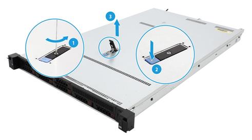

5.     Remove the access panel, as shown in Figure 1.
a.     (Optional.) If the access panel is locked, use a Phillips screwdriver to loosen the screw on the locking lever, as shown by callout 1.
b.     Press the release button to release the locking lever, and then lift up the locking lever as shown by callout 2. The access panel slides towards the rear of the server automatically.
c.     Lift the access panel away from the server, as shown by callout 3.
Figure 1 Removing the access panel

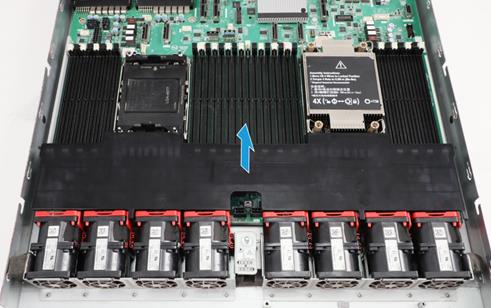

6.     Remove the chassis air baffle. As shown in Figure 2, lift the air baffle up to remove it from the chassis.
Figure 2 Removing the chassis air baffle

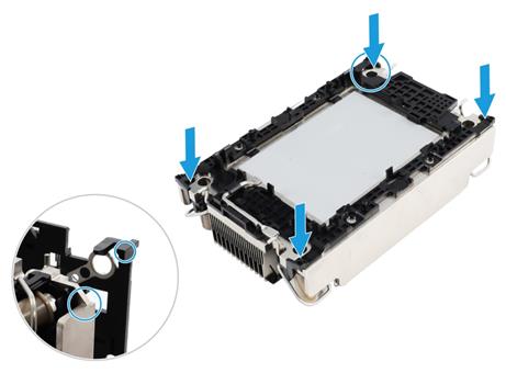

2.     Install the retaining bracket onto the heatsink.
a.     As shown in Figure 4, align the alignment triangle on the retaining bracket with the cut-off corner of the heatsink.
b.     Lower the bracket vertically down on the heatsink until the four corners of the bracket click into the four corners of the heatsink.
To ensure that the processor can be installed onto the retaining bracket, select the corresponding retaining bracket according to the processor model.

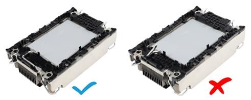

For the processor to be installed correctly, make sure the ejector lever on the retaining bracket is closed as shown in Figure 5.
Figure 4 Installing the processor onto the heatsink
Figure 5 Ejector lever status on the retaining bracket

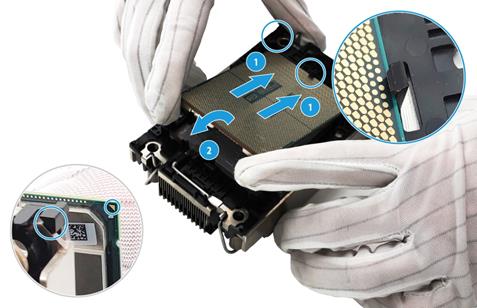

3.     Install the processor onto the retaining bracket.
CAUTION
CAUTION:
To avoid damage to a processor, always hold the processor by the edges. Never touch the gold contacts on the processor bottom.
a.     Tilt the processor, align the small triangle on the processor with the alignment triangle in the retaining bracket, and insert one edge of the processor into the retaining bracket. Place two thumbs against the heatsink, press the other end of the processor, and lower the processor.
Figure 6 Installing the processor onto the retaining bracket

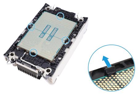

b.     Open the clips on the retaining bracket until the processor fits snugly onto the retaining bracket.
Figure 7 Locking the processor

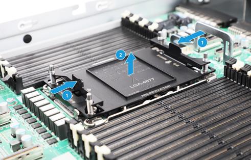

4.     Remove the processor socket cover.
CAUTION
CAUTION:
·     Be careful not to touch the pins on the processor socket when you wear ESD gloves to remove the processor socket cover.
·     The pins on the processor socket are very fragile. Never touch the pins. Any damage to them might require system board replacement.
·     Keep the pins on the processor socket clean. Make sure the socket is free from dust and any other debris.
As shown in Figure 8, hold the cover by the tabs at both sides, and lift the cover straight up to remove it from the socket. Keep the cover secure for future use.
Figure 8 Removing the processor socket cover

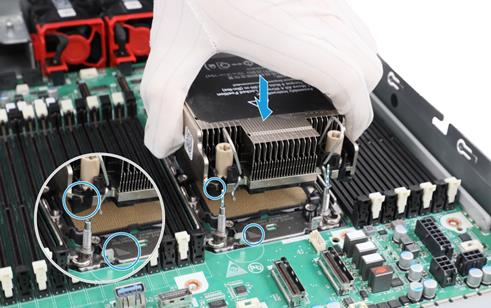

5.     Install the heatsink onto the server.
a.     Align the alignment triangle on the retaining bracket with the cut-off corner of the processor socket and the pin holes in the heatsink with the guide pins on the processor socket. Lower down the heatsink on the processor socket. See Figure 9.
Figure 9 Attaching the heatsink to the processor socket

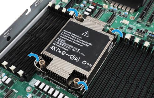

b.     Press down the heatsink clips at the four corners to lock the heatsink in place.
Figure 10 Locking the heatsink

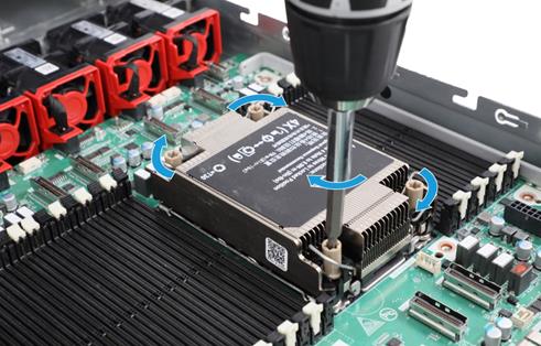

c.     Use a T30 Torx screwdriver to fasten the four captive screws on the heatsink.
CAUTION
CAUTION:
As a best practice, use a torque of 0.9 N·m (8 in-lbs) to avoid poor contact of the processor or damage to the pins on the processor socket.
Figure 11 Fastening the captive screws

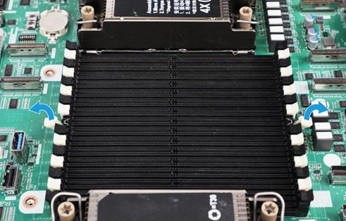

1.     Open the retaining clips of the DIMM slot.
Figure 12 Opening the retaining clips of the DIMM slot

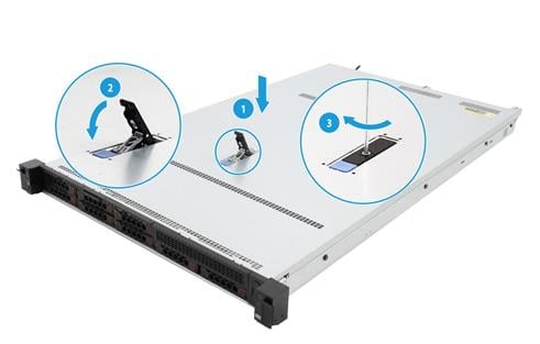

2.     Install the access panel.
a.     Place the access panel on top of the server chassis, with the guide pin in the chassis aligned with the pin hole in the locking lever area.
b.     Close the locking lever. The access panel will automatically slide toward the server front to secure itself into place.
c.     (Optional.) Lock the locking lever. Use a Phillips screwdriver to turn the screw on the lever 90 degree clockwise.
Figure 15 Installing the access panel
