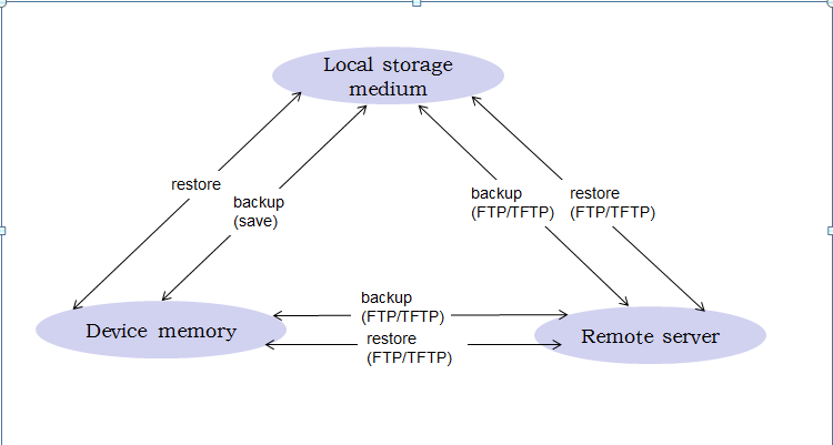

About this MIB
Use this MIB to manage the device configuration. For example, access this MIB to save, back up, or restore the configuration. This MIB also contains notifications about configuration changes.
The following figure shows the relationship among the device memory, local storage medium, and remote server in configuration backup and restoration:
