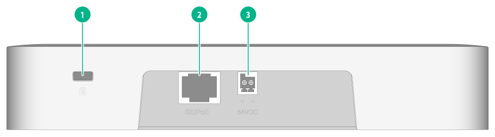

Figure 1 Ports on the AP (1)
(1) Security slot
(2) GE/PoE port
(3) Power port

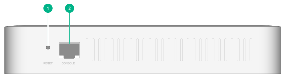

Figure 2 Ports on the AP (2)
(1) Reset button
(2) Console port
