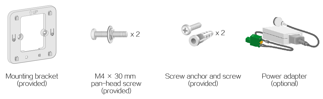

Installation accessories
Figure 1 Accessories provided with the AP

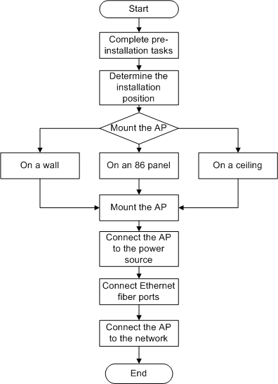

Installation flowchart
Figure 3 Installation flowchart

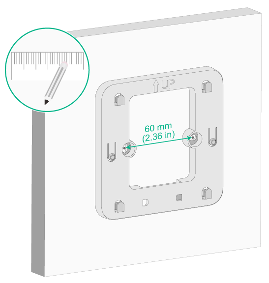

Mounting the AP on a wall
1.     Place the mounting bracket against the wall and mark the installation holes on the wall.
Figure 5 Marking the installation holes on the wall

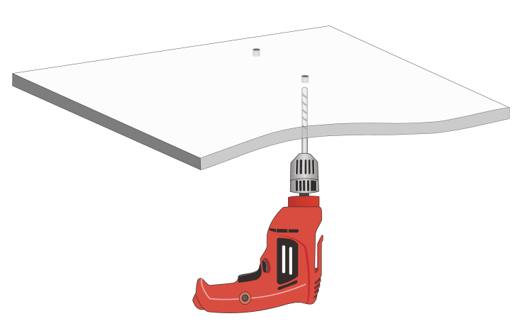

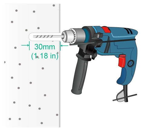

2.     Drill two holes with a diameter of 6 mm (0.24 in) and a depth of 30 mm (1.18 in) at the marked locations, as shown in Figure 6.
Figure 6 Drilling holes in the wall

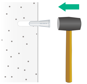

3.     Use a rubber hammer to tap a screw anchor into each hole until it is all flush with the wall surface, as shown in Figure 7.
Figure 7 Hammering the screw anchor into the wall

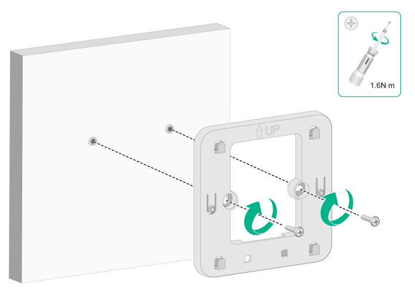

4.     Insert the screws through the installation holes in the mounting bracket into the holes in the wall. Fasten the screws to secure the mounting bracket to the wall, as shown in Figure 8.
Figure 8 Attaching the mounting bracket to the wall

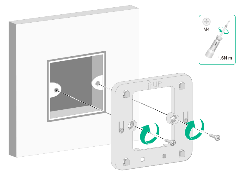

1.     Use the provided M4 × 30 mm pan-head screws to attach the mounting bracket to the Junction box.
Figure 10 Attaching the mounting bracket to the Junction box

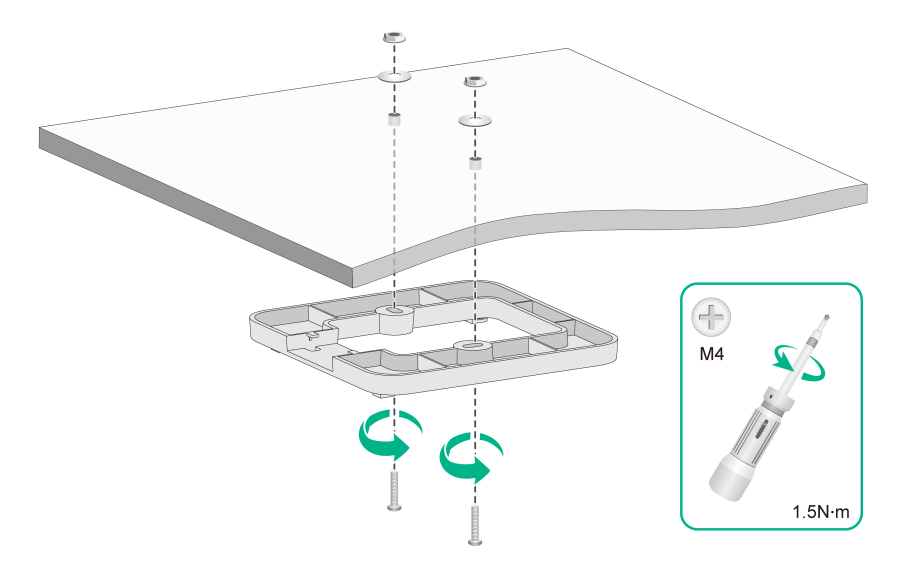

Mounting the AP on a ceiling
CAUTION
CAUTION:
The ceiling for installing the AP must be less than 18 mm (0.71 in) in thickness, and can bear a load of 5 kg (11.02 lb). If you must install the AP on a ceiling not strong enough, use boards to reinforce the ceiling.
To mount the AP on a ceiling:
1.     Remove the ceiling tile.
2.     Place the mounting bracket against the ceiling tile and mark the installation holes on the ceiling tile. Drill two holes with a diameter of 6 mm (0.24 in) at the marked positions, as shown in Figure 11.
Figure 11 Drilling holes in the ceiling tile
3.     Thread the M4 × 30 mm pan-head screws through the installation holes in the mounting bracket and into the holes in the ceiling tile. Fasten washers and nuts at the other side of the ceiling to secure the mounting bracket to the ceiling, as shown in Figure 12.
Figure 12 Attaching the mounting bracket to the ceiling

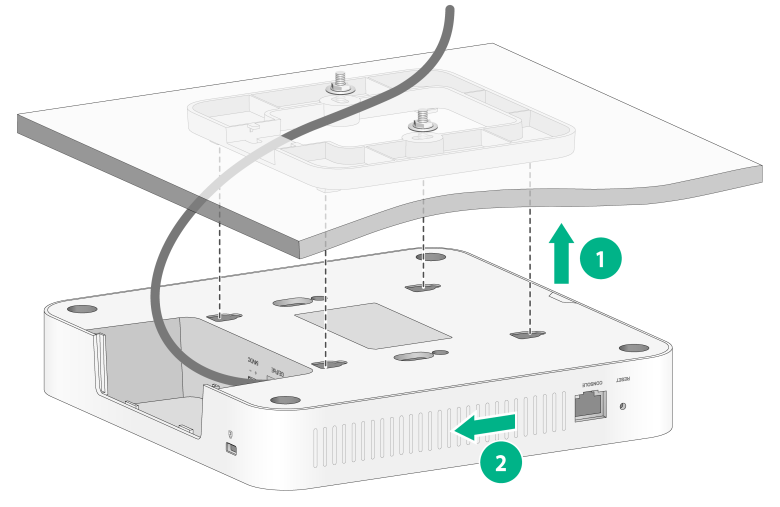

4.     Connect an Ethernet cable to the GE/PoE port on the AP. Then position the four keyhole slots in the AP rear on the pegs of the mounting bracket and slide the AP until it sits securely on the pegs.
Figure 13 Attaching the AP to the mounting bracket

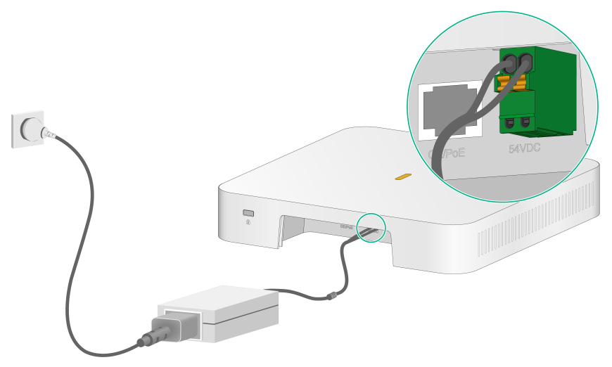

Connecting a local power source
Connecting a local power source by using a power adapter
You can use an AC/DC power adapter to connect the AP to a local power source. No power adapter is provided with the AP. Order as required. Table 2 describes the power adapter specifications.
Table 2 Power adapter specifications
Item
Specification
Input
100 VAC to 240 VAC
Output
54 V @ 0.74 A
Output power
40 W
Figure 14 Using a power adapter to connect the AP to a local power source

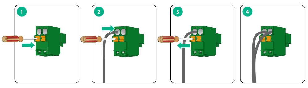

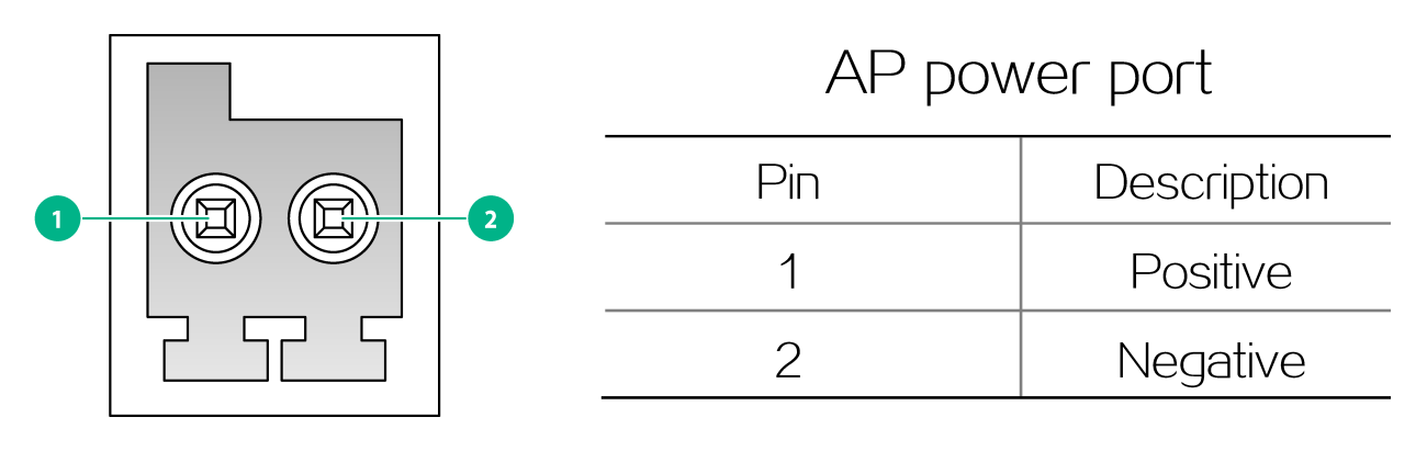

Connecting a DC remote power
No terminal block is provided with the AP. Order as required.
As a best practice, should use 20AWG copper wire.
The input voltage range for the AP is 40 VDC to 55 VDC.
To connect a local DC power source:
1.     Insert a flat-head screwdriver straight into a square-shaped hole in the terminal block.
This will open the round-shaped hole above the square-shaped hole.
2.     Hold the screwdriver and insert one wire into the round-shaped hole in the terminal block.
Identify the positive and negative feed positions. The wiring sequence is positive to positive and negative to negative.
3.     Take out the flat-head screwdriver from the square-shaped hole.
The round-shaped hole will close, and the wire will be secured in place.
4.     Repeat the procedure to attach the other wire into the terminal block.
Figure 15 Connecting a local DC power source
Figure 16 Cross sectional area of the AP power port and electrode connection method

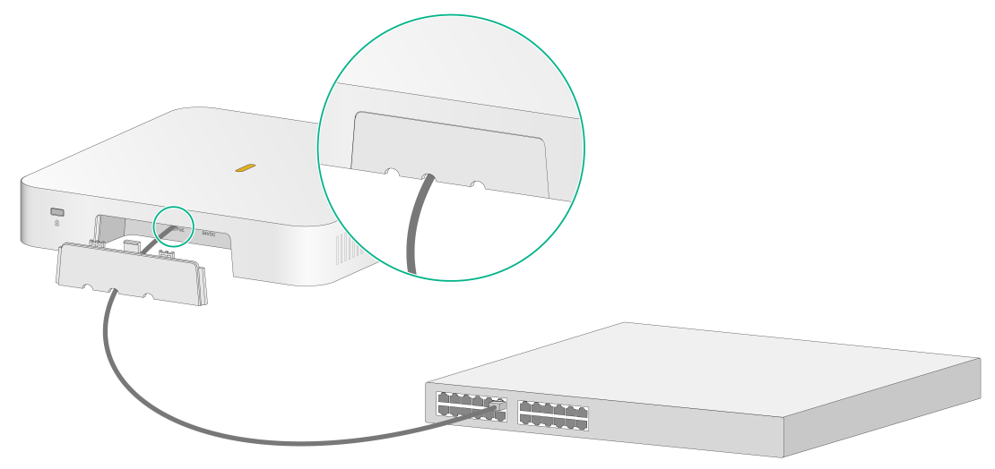

Connecting a PoE power source
To power the AP through PoE, use an Ethernet cable to connect an Ethernet port on a PoE switch to the GE/PoE port on the AP. Attach the cable cover to the AP securely after connecting all cables.
Figure 17 Connecting the AP to a PoE power source

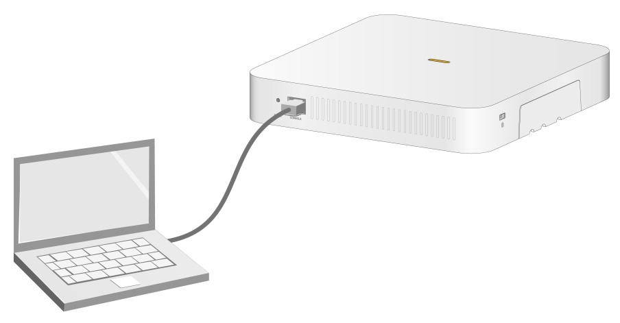

Accessing the AP
When the AP operates in cloud mode, you can access and configure the AP from the console port, Web interface, or through Telnet. Accessing the AP from the Web interface or through Telnet requires the IP address of the AP.
Logging in to the AP from the console port
Prepare the following items for accessing the device from the console port:
·     An 8-core console cable, with a crimped RJ-45 connector at one end, and a DB-9 connector at the other end.
·     A configuration terminal. It can be a standard character terminal with an RS-232 port, or a PC.
Connecting the AP to a configuration terminal from the console port
CAUTION
CAUTION:
·     To connect a PC to the AP, first connect the PC end. To disconnect a PC from the AP, first disconnect the AP end.
·     If the PC does not have an RS-232 port but a USB port, use a USB-to-RS-232 converter to connect the USB port to the console cable and install the driver on the PC.
To connect the AP to a configuration terminal from the console port:
1.     Connect the DB-9 connector of the console cable to the serial port on the configuration terminal, for example, a PC.
2.     Connect the RJ-45 connector of the console cable to the console port on the AP.
Figure 18 Connecting the AP to a PC from the console port
