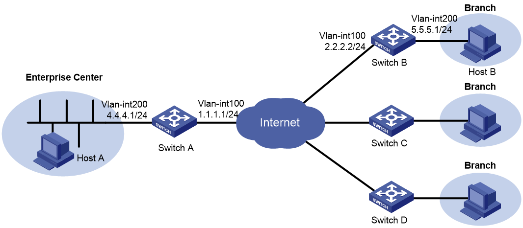

IPsec RRI
IPsec Reverse Route Injection (RRI) enables an IPsec tunnel gateway to automatically add and delete static routes destined for the protected private networks. It automatically adds the static routes when the IPsec SAs are established and deletes the static routes when the IPsec SAs are deleted. This greatly reduces the static route configuration work load on the gateway and increases the scalability of the IPsec VPN.
IPsec RRI is applicable to gateways that must provide many IPsec tunnels (for example, a headquarters gateway).
As shown in Figure 4, the traffic between the enterprise center and the branches are protected by IPsec. The gateway at the enterprise center is configured with static routes to route traffic to the IPsec-protected interfaces. It is difficult to add or modify static routes on the gateway at the enterprise center if the IPsec VPN has a large number of branches or if the network structure changes.
Figure 4 IPsec VPN
After you can enable IPsec RRI on the gateway, the gateway automatically adds a static route to the routing table each time an IPsec tunnel is established. The destination IP address is the protected private network, and the next hop is the remote IP address of the IPsec tunnel. Traffic destined for the peer end is routed to the IPsec tunnel interface and thereby protected by IPsec.
You can advertise the static routes created by IPsec RRI in the internal network, and the internal network device can use them to forward traffic in the IPsec VPN.
You can set preferences for the static routes created by IPsec RRI to implement flexible route management. For example, you can set the same preference for multiple routes to the same destination to implement load sharing, or you can set different preferences to implement route backup.

Example: Configuring IPsec RRI
As shown in Figure 9, branches access the enterprise center through an IPsec VPN.
Configure the IPsec VPN as follows:
·     Configure an IPsec tunnel between Switch A and each branch gateway (Switch B, Switch C, and Switch D) to protect traffic between subnets 4.4.4.0/24 and 5.5.5.0/24.
·     Configure the tunnels to use security protocol ESP, encryption algorithm DES, and authentication algorithm SHA1-HMAC-96. Use IKE for IPsec SA negotiation.
·     Configure IKE proposal to use the preshared key authentication method, encryption algorithm 3DES, and authentication algorithm HMAC-SHA1.
·     Configure IPsec RRI on Switch A to automatically create static routes to the branches based on the established IPsec SAs.
Figure 9 Network diagram
1.     Assign IPv4 addresses to the interfaces on the switches according to Figure 9. (Details not shown.)

[SwitchB-ipsec-transform-set-tran1] quit
# Configure IPv4 advanced ACL 3000 to identify traffic from subnet 5.5.5.0/24 to subnet 4.4.4.0/24.
[SwitchB] acl advanced 3000
[SwitchB-acl-ipv4-adv-3000] rule permit ip source 5.5.5.0 0.0.0.255 destination 4.4.4.0 0.0.0.255
[SwitchB-acl-ipv4-adv-3000] quit
# Create and configure the IKE profile named profile1.
[SwitchB] ike profile profile1
[SwitchB-ike-profile-profile1] keychain key1
[SwitchB-ike-profile-profile1] match remote identity address 1.1.1.1 255.255.255.0
[SwitchB-ike-profile-profile1] quit
# Create an IKE-based IPsec policy entry named map1 and configure the following settings for the policy entry:
¡     Set the sequence number to 10.
¡     Specify transform set tran1 and ACL 3000.
¡     Specify the remote IP address for the tunnel as 1.1.1.1.
¡     Specify IKE profile profile1.
[SwitchB] ipsec policy map1 10 isakmp
[SwitchB-ipsec-policy-isakmp-map1-10] transform-set tran1
[SwitchB-ipsec-policy-isakmp-map1-10] security acl 3000
[SwitchB-ipsec-policy-isakmp-map1-10] remote-address 1.1.1.1
[SwitchB-ipsec-policy-isakmp-map1-10] ike-profile profile1
[SwitchB-ipsec-policy-isakmp-map1-10] quit
# Create an IKE proposal named 1, and specify 3DES as the encryption algorithm, HMAC-SHA1 as the authentication algorithm, and pre-share as the authentication method.
[SwitchB] ike proposal 1
[SwitchB-ike-proposal-1] encryption-algorithm 3des-cbc
[SwitchB-ike-proposal-1] authentication-algorithm sha
[SwitchB-ike-proposal-1] authentication-method pre-share
[SwitchB-ike-proposal-1] quit
# Create an IKE keychain named key1 and specify 123 in plain text as the preshared key to be used with the remote peer at 1.1.1.1.
[SwitchB] ike keychain key1
[SwitchB-ike-keychain-key1] pre-shared-key address 1.1.1.1 key simple 123
[SwitchB-ike-keychain-key1] quit
# Apply IPsec policy map1 to VLAN-interface 100.
[SwitchB-Vlan-interface100] ipsec apply policy map1
Make sure Switch B has a route to the peer private network, with the outgoing interface as VLAN-interface 100.
4.     Configure Switch C and Switch D in the same way Switch B is configured.
1.     Verify that IPsec RRI can automatically create a static route from Switch A to Switch B:
# Initiate a connection from subnet 5.5.5.0/24 to subnet 4.4.4.0/24. IKE negotiation is triggered to establish IPsec SAs between Switch A and Switch B. (Details not shown.)
# Verify that IPsec SAs are established on Switch A.
[SwitchA] display ipsec sa
Interface: Vlan-interface100
  IPsec policy: map1
  Sequence number: 10
  Mode: Template
    Tunnel id: 0
    Encapsulation mode: tunnel
    Perfect Forward Secrecy:
    Inside VPN:
    Extended Sequence Numbers enable: N
    Traffic Flow Confidentiality enable: N
    Path MTU: 1463
    Tunnel:
        local  address: 1.1.1.1
        remote address: 2.2.2.2
    Flow:
        sour addr: 4.4.4.0/255.255.255.0  port: 0  protocol: ip
        dest addr: 5.5.5.0/255.255.255.0  port: 0  protocol: ip
    [Inbound ESP SAs]
      SPI: 1014286405 (0x3c74c845)
      Connection ID: 90194313219
      Transform set: ESP-ENCRYPT-DES-CBC ESP-AUTH-SHA1
      SA duration (kilobytes/sec): 1843200/3600
      SA remaining duration (kilobytes/sec): 1843199/3590
      Max received sequence-number: 4
      Anti-replay check enable: Y
      Anti-replay window size: 64
      UDP encapsulation used for NAT traversal: N
      Status: Active
    [Outbound ESP SAs]
      SPI: 4011716027 (0xef1dedbb)
      Connection ID: 64424509441
      Max sent sequence-number: 4
      Status: Active
# Verify that IPsec RRI has created a static route to reach Switch B.

Example: Configuring main-mode IKE with preshared key authentication
As shown in Figure 13, configure an IKE-based IPsec tunnel between Switch A and Switch B to secure the communication between the switches.
·     Configure the two switches to use the default IKE proposal for the IKE negotiation.
·     Configure the two switches to use the preshared key authentication method for the IKE negotiation.
Figure 13 Network diagram

This feature applies to scenarios where the headquarters and branches communicate through virtual tunnels. It enables exchanges of IP address request and set messages between the IPsec gateway at a branch and the IPsec gateway at the headquarters.
Table 2 Parameter descriptions
Parameter
Description
request
Enables the IPsec gateway at a branch to submit IP address request messages to the IPsec gateway at the headquarters.
set accept
Enables the IPsec gateway at a branch to accept the IP addresses pushed by the IPsec gateway at the headquarters.
set send
Enables the IPsec gateway at the headquarters to push IP addresses to IPsec gateways at branches.
