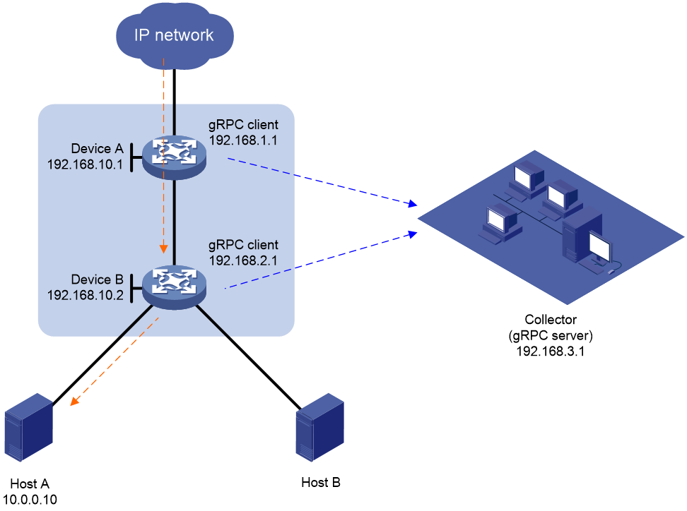

Example: Configuring MOD to send packets through gRPC
As shown in Figure 2, Host A and Host B access the external network through Device A and Device B. Some packets from the external network are missing on Host A. Configure MOD on the access device and aggregation device to identify whether packets are dropped during the forwarding process on the two devices.
Figure 2 Network diagram
Configure IP addresses for devices, and make sure they can reach each other at Layer 3.

# Configure MOD to use gRPC to send packets to the collector.
[DeviceA-telemetry-mod] transport-protocol grpc
# Configure MOD to monitor all packet drop reasons.
[DeviceA-telemetry-mod] reason-list all
[DeviceA-telemetry-mod] quit
c.     Configure gRPC:
# Enable the gRPC service.
[DeviceA] grpc enable
# Create a sensor group named test, and add sensor path telemetryftrace/Genevent.
[DeviceA] telemetry
[DeviceA-telemetry] sensor-group test
[DeviceA-telemetry-sensor-group-test] sensor path telemetryftrace/Genevent
[DeviceA-telemetry-sensor-group-test] quit
# Create a destination group named collector1. Specify a collector that uses IPv4 address 192.168.3.1 and port number 50050.
[DeviceA-telemetry] destination-group collector1
[DeviceA-telemetry-destination-group-collector1] ipv4-address 192.168.3.1 port 50050
[DeviceA-telemetry-destination-group-collector1] quit
# Configure a subscription named A to bind sensor group test with destination group collector1.
[DeviceA-telemetry] subscription A
[DeviceA-telemetry-subscription-A] sensor-group test
[DeviceA-telemetry-subscription-A] destination-group collector1
[DeviceA-telemetry-subscription-A] quit
[DeviceA-telemetry] quit
2.     Configure Device B.
Configure Device B in the same way Device A is configured except the device ID for MOD.

2.     Verify the configuration on Device B.
The configuration on Device B is the same as the configuration on Device A except the device ID for MOD. (Details not shown.)
3.     Verify the configuration on the collector.
When a packet destined for IP address 10.0.0.10 is dropped during the forwarding process on Device A and Device B, the collector (gRPC server) can receive the packet drop reason and the characteristics of the dropped packet from the devices (gRPC clients).
