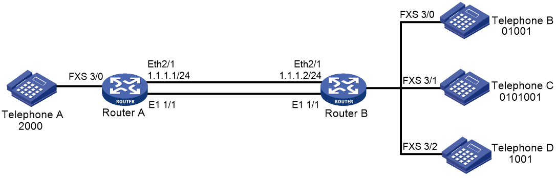

Example: Configuring caller control
As shown in Figure 1, configure caller control to permit only the number 1000 to call the number 2000.
Figure 1 Network diagram
You can configure caller control either on the calling side or on the called side.
·     Configure caller control on the calling side.
# Enter dial program view.
<RouterA> system-view
[RouterA] voice-setup
[RouterA-voice] dial-program
# Configure VoIP entity 2000 to permit only the calling number 1000 to call the number 2000.
[RouterA-voice-dial] entity 2000 voip
[RouterA-voice-dial-entity2000] match-template 2000
[RouterA-voice-dial-entity2000] address sip ip 1.1.1.2
[RouterA-voice-dial-entity2000] caller-permit 1000$
·     Configure caller control on the called side.
<RouterB> system-view
[RouterB] voice-setup
[RouterB-voice] dial-program
# Configure POTS entity 2000 to permit only the calling number 1000 to call the number 2000.
[RouterB-voice-dial] entity 2000 pots
[RouterB-voice-dial-entity2000] match-template 2000
[RouterB-voice-dial-entity2000] caller-permit 1000$
[RouterB-voice-dial-entity2000] line 2/1/1

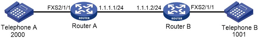

Example: Configuring a number match mode
As shown in Figure 2, configure number match modes for calls from Telephone A to Telephones B and C.
Figure 2 Network diagram
Configuring shortest match
1.     Configure Router A:
# Configure POTS entity 1000.
[RouterA-voice-dial] entity 1000 pots
[RouterA-voice-dial-entity1000] match-template 10001234$
[RouterA-voice-dial-entity1000] line 2/1/1
[RouterA-voice-dial-entity1000] quit
# Configure VoIP entity 2000 and VoIP entity 2001.
[RouterA-voice-dial] entity2000 voip
[RouterA-voice-dial-entity2000] match-template 20001234$
[RouterA-voice-dial-entity2000] address ip 1.1.1.2
[RouterA-voice-dial-entity2000] quit
[RouterA-voice-dial] entity2001 voip
[RouterA-voice-dial-entity2001] match-template 200012341234$
[RouterA-voice-dial-entity2001] address ip 1.1.1.2
[RouterA-voice-dial-entity2001] quit
2.     Configure Router B:
# Configure POTS entity 2000 and POTS entity 2001.
[RouterB-voice-dial-entity2000] match-template 20001234$
[RouterB-voice-dial-entity2000] quit
[RouterB-voice-dial] entity2001 pots
[RouterB-voice-dial-entity2001] match-template 200012341234$
[RouterB-voice-dial-entity2001] line 2/1/2
After you dial number 20001234 at Telephone A, the number matches VoIP entity 2000 and Telephone B rings because the device uses shortest match mode by default.
Configuring longest match
# Configure the longest match mode on Router A.
[RouterA-voice-dial] number-match longest
After you dial number 20001234 at Telephone A and waits for a period of time, the number matches VoIP entity 2000 and Telephone B rings. If you dial 1234 during the waiting period (the dialed number is 200012341234), the number matches VoIP entity 2001 and Telephone C rings.
Configuring a terminator
# Configure the terminator # on Router A.
[RouterA-voice-dial] terminator #
After you dial 20001234# at Telephone A, the number immediately matches VoIP entity 2000 and Telephone B rings.

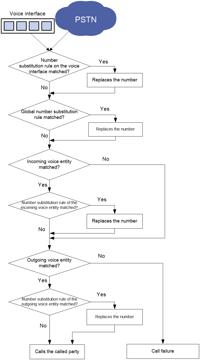

Number substitution on the calling router
As shown Figure 3, the calling router performs number substitution for a number as follows:
1.     The router receives a call on a voice interface.
2.     The router matches the calling or called number of the call against different types of number substitution rules in the following order:
a.     Rules on the voice entity.
b.     Global rules.
c.     Rules on the incoming voice entity (if the number matches one).
d.     Rules on the outgoing voice entity (if the number matches one).
If a match is found for a rule type, the router replaces the number, and matches the new number against the next rule type. If no match is found for a rule type, the router keeps matching the number against the next rule type. This matching process continues until all rule types are matched. For each rule type, the router performs only one number substitution.
3.     The router places the call to the called party.
Figure 3 Flow chart for number substitution on the calling router

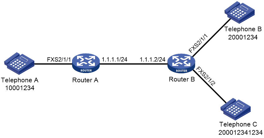

Number substitution on the called router
As shown Figure 4, the called router performs number substitution for a number as follows:
1.     The router receives a call.
2.     The router matches the called number against different types of number substitution rules in the following order:
a.     Global rules.
b.     Rules on the incoming voice entity (if the number matches one).
c.     Rules on the outgoing voice entity (if the number matches one).
If a match is found for a rule type, the router replaces the number, and matches the new number against the next rule type. If no match is found for a rule type, the router keeps matching the number against the next rule type. The matching process continues until all rule types are matched. For each type, the router performs only one number substitution.
3.     The router calls the called number if the called party is on a local voice interface, or initiates a call to the PSTN if the called party is in the PSTN.
Figure 4 Flow chart for number substitution on the called router

Example: Configuring number substitution
Configure global number substitution, voice entity number substitution, and voice interface number substitution to replace the called numbers.
Figure 5 Network diagram
Configuring global number substitution
# Create number substitution rule list 1 and add a rule to the list.
[RouterA-voice-dial] number-substitute 1
[RouterA-voice-dial-substitute1] rule 0 ^010....$ ....
[RouterA-voice-dial-substitute1] quit
# Configure the destination address as 1.1.1.2 and the called number as 1001 for VoIP entity 1001.
[RouterA-voice-dial] entity 1001 voip
[RouterA-voice-dial-entity1001] address sip ip 1.1.1.2
[RouterA-voice-dial-entity1001] match-template 1001
[RouterA-voice-dial-entity1001] quit
# Apply number substitution rule list 1 to the called number of outgoing calls.
[RouterA-voice-dial] substitute outgoing-call called 1
When you use Telephone A to call number 0101001, Router A replaces 0101001 with 1001 and sends the call to the destination address 1.1.1.2. Then Telephone B rings.
Configuring voice entity number substitution
# Configure the destination address as 1.1.1.2 and the called number as 0101001 for VoIP entity 1001.
[RouterA-voice-dial-entity1001] match-template 0101001
# Apply number substitution rule list 1 to the called number on VoIP entity 1001.
[RouterA-voice-dial-entity1001] substitute called 1
When you use Telephone A to call number 0101001, VoIP entity 1001 replaces 0101001 with 1001 and sends the call to the destination address 1.1.1.2. Then Telephone B rings.
Configuring voice interface number substitution
[RouterA-voice-dial] quit
[RouterA-voice] quit
# Apply number substitution rule list 1 to the called number on FXS interface 2/1/1.
[RouterA] subscriber-line 2/1/1
[RouterA-voice-line2/1/1] substitute called 1
When you use Telephone A to call number 0101001, FXS interface 2/1/1 replaces 0101001 with 1001 and sends the call to the destination address 1.1.1.2. Then Telephone B rings.

Example: Configuring the number sending mode
As shown in Figure 6, Router A and Router B connect to each other through an IP link and an E1 link. The telephones at two sides call each other through the E1 link. Configure number sending modes to achieve different call policies.
Figure 6 Network diagram
# Configure a timeslot set using R2 signaling for controller E1 2/4/1.
[RouterA] controller e1 2/4/1
[RouterA-E1 2/4/1] timeslot-set 0 timeslot-list 1-31 signal r2
[RouterA-E1 2/4/1] quit
# Configure a match template to match 010….$ for POTS entity 1001 and bind line 2/4/1:0 to the entity.
[RouterA-voice-dial] entity 1001 pots
[RouterA-voice-dial-entity1001] match-template 010....$
[RouterA-voice-dial-entity1001] line 2/4/1:0
# Configure a local number 2000 for POTS entity 2000, and bind line 2/1/1 to the entity.
[RouterA-voice-dial] entity 2000 pots
[RouterA-voice-dial-entity2000] line 2/1/1
[RouterB] controller e1 2/4/1
[RouterB-E1 2/4/1] timeslot-set 0 timeslot-list 1-31 signal r2
[RouterB-E1 2/4/1] quit
# Configure a local number 01001 for POTS entity 1002, and bind line  2/1/1 to the entity.
[RouterB-voice-dial] entity 1002 pots
[RouterB-voice-dial-entity1002] match-template 01001
[RouterB-voice-dial-entity1002] line 2/1/1
[RouterB-voice-dial-entity1002] quit
# Configure a local number 0101001 for POTS entity 0101001, and bind line 2/1/2 to the entity.
[RouterB-voice-dial] entity 0101001 pots
[RouterB-voice-dial-entity101001] match-template 0101001
[RouterB-voice-dial-entity101001] line 2/1/2
[RouterB-voice-dial-entity101001] quit
# Configure a local number 1001 for POTS entity 1001, and bind line 2/1/3 to the entity.
[RouterB-voice-dial] entity 1001 pots
[RouterB-voice-dial-entity1001] match-template 1001
[RouterB-voice-dial-entity1001] line 2/1/3
[RouterB-voice-dial-entity1001] quit
3.     Configuring number sending modes on Router A:
¡     Configure Router A to send the five least significant digits of a called number.
[RouterA-voice-dial-entity1001] send-number 5
If you use Telephone A to call 0101001, Router A sends the called number 01001, which are the five least significant digits. Then Telephone B rings.
¡     Configure Router A to send all the digits of a called number.
[RouterA-voice-dial-entity1001] send-number all
If you use Telephone A to call 0101001, Router A sends the complete called number 0101001. Then Telephone C rings.
¡     Configure Router A to send a truncated called number.
[RouterA-voice-dial-entity1001] send-number truncate
If you use Telephone A to call 0101001, Router A sends the called number 1001, which match the dots in "010….$". Then Telephone D rings.
As shown in Figure 7, configure number substitution on the routers so departments in different areas can call each other by using the area code of the destination area plus a four-digit local number.
For example, to use phone 1688 of the F department in area B to call phone 6788 of the M department in area A, dial the number 0103366. The sequence 3366 is the number of the M department in area B.
On phone 6788, the calling number 1688 is displayed as 0211234, which is the area code of area A plus the number of the F department in area A.
Figure 7 Network diagram
The following provides the number substitution configuration only for calls from area B to area A.
1.     Configure Router B:
# Create number substitution rule list 21101 and add rules to the list.
[RouterB-voice-dial] number-substitute 21101
[RouterB-voice-dial-substitute21101] rule 1 ^0101688$ 0001
[RouterB-voice-dial-substitute21101] rule 2 ^0103366$ 0002
[RouterB-voice-dial-substitute21101] rule 3 ^0102323$ 0003
[RouterB-voice-dial-substitute21101] quit
# Create number substitution rule list 21102 and add rules to the list.
[RouterB-voice-dial] number-substitute 21102
[RouterB-voice-dial-substitute21102] rule 1 ^1688$ 0210001
[RouterB-voice-dial-substitute21102] rule 2 ^3366$ 0210002
[RouterB-voice-dial-substitute21102] rule 3 ^2323$ 0210003
[RouterB-voice-dial-substitute21102] quit
# Configure the match template 010.... to match called numbers, and set the destination IP address as 1.1.1.1 for VoIP entity 10.
[RouterB-voice-dial] entity 10 voip
[RouterB-voice-dial-entity10] match-template 010....
[RouterB-voice-dial-entity10] address sip ip 1.1.1.1
# Apply the number substitution rule list 21101 to called numbers on VoIP entity 10. This will change the called numbers 0101688, 0103366, and 0102323 into 0001, 0002, and 0003 respectively.
[RouterB-voice-dial-entity10] substitute called 21101
# Apply the number substitution rule list 21102 to calling numbers on VoIP entity 10. This will change the calling numbers 1688, 3366, and 2323 into 0210001, 0210002, and 0210003 respectively.
[RouterB-voice-dial-entity10] substitute calling 21102
2.     Configure Router A:
# Create number substitution rule list 101 and add rules to the list.
[RouterA-voice-dial] number-substitute 101
[RouterA-voice-dial-substitute101] rule 1 ^0001$ 1234
[RouterA-voice-dial-substitute101] rule 2 ^0002$ 6788
[RouterA-voice-dial-substitute101] rule 3 ^0003$ 6565
[RouterA-voice-dial-substitute101] quit
# Create number substitution rule list 102 and add rules to the list.
[RouterA-voice-dial] number-substitute 102
[RouterA-voice-dial-substitute102] dot-match left-right
[RouterA-voice-dial-substitute102] rule 1 ^...0001$ ...1234
[RouterA-voice-dial-substitute102] rule 2 ^...0002$ ...6788
[RouterA-voice-dial-substitute102] rule 3 ^...0003$ ...6565
[RouterA-voice-dial-substitute102] quit
# Apply the number substitution rule list 101 to the called numbers of incoming calls. This will change the called numbers 0001, 0002, and 0003 into 1234, 6788, and 6565 respectively.
[RouterA-voice-dial] substitute incoming-call called 101
# Apply the number substitution rule list 102 to the calling numbers of incoming calls. This will change the called numbers 0210001, 0210002, and 0210003 into 0211234, 0216788, and 0216565 respectively.
[RouterA-voice-dial] substitute incoming-call calling 102
# Configure the match template …. for POTS entity 1010, bind line 2/1/1 to the entity, and configure the entity to send all the digits of a called number.
[RouterA-voice-dial] entity 1010 pots
[RouterA-voice-dial-entity1010] match-template ....
[RouterA-voice-dial-entity1010] line 2/1/1
[RouterA-voice-dial-entity1010] send-number all
# Use phone 1688 to dial the number 0103366 to verify that phone 6788 rings and the displayed calling number is 0211234.
During the calling process, Router B changes the calling number 1688 into 0210001 and changes the called number 0103366 into 0002. Then Router A changes 0210001 into 0211234 and changes 0002 into 6788.

This example does not provide SIP server and digital voice interface configurations. For information about configuring SIP servers and digital voice interfaces, see "Configuring SIP" and "Configuring voice interfaces."
# Configure subscriber group 1 that matches calling numbers starting with 1100 and configure subscriber group 2 that matches calling numbers starting with 1200.
[RouterA-voice-dial] subscriber-group 1
[RouterA-voice-dial-group1] match-template 1100..
[RouterA-voice-dial-group1] quit
[RouterA-voice-dial] subscriber-group 2
[RouterA-voice-dial-group2] match-template 1200..
[RouterA-voice-dial-group2] quit
# Configure VoIP entity 2000 to use the SIP proxy server to find call destination addresses and to match called numbers in area B.
[RouterA-voice-dial-entity2000] address sip proxy
[RouterA-voice-dial-entity2000] match-template 2...
# Configure VoIP entity 3000 to use the SIP proxy server to find call destination addresses and to match called numbers in area C.
[RouterA-voice-dial] entity 3000 voip
[RouterA-voice-dial-entity3000] address sip proxy
[RouterA-voice-dial-entity3000] match-template 3...
[RouterA-voice-dial-entity3000] quit
# Configure a caller group to permit subscriber groups 1 and 2 on POTS entity 2100 so the phone numbers starting with 1100 or 1200 in area A can call the phone numbers in area B.
[RouterA-voice-dial] entity 2100 pots
[RouterA-voice-dial-entity2100] line 2/0:15
[RouterA-voice-dial-entity2100] send-number all
[RouterA-voice-dial-entity2100] match-template 2...
[RouterA-voice-dial-entity2100] caller-group permit 1
[RouterA-voice-dial-entity2100] caller-group permit 2
[RouterA-voice-dial-entity2100] quit
# Configure a caller group to permit subscriber group 2 on POTS entity 3100 so the phone numbers starting with 1200 in area A can call the phone numbers in area C.
[RouterA-voice-dial] entity 3100 pots
[RouterA-voice-dial-entity3100] line 2/0:15
[RouterA-voice-dial-entity3100] send-number all
[RouterA-voice-dial-entity3100] match-template 3...
[RouterA-voice-dial-entity3100] caller-group permit 2
# Configure POTS entity 2100 to match local numbers and bind line 2/1/1:15 to the entity.
[RouterA-voice-dial-entity2100] line 2/1/1:15
[RouterA-voice-dial-entity2100] match-template 1.....
[RouterB-voice-dial] entity 2100 pots
[RouterB-voice-dial-entity2100] line 2/1/1:15
[RouterB-voice-dial-entity2100] send-number all
[RouterB-voice-dial-entity2100] match-template 2...
3.     Configure Router C:
# Configure POTS entity 3100 to match local numbers and bind line 2/1/1:15 to the entity.
<RouterC> system-view
[RouterC] voice-setup
[RouterC-voice] dial-program
[RouterC-voice-dial] entity 3100 pots
[RouterC-voice-dial-entity3100] line 2/1/1:15
[RouterC-voice-dial-entity3100] send-number all
[RouterC-voice-dial-entity3100] match-template 3...
# Place calls to verify that the phone numbers starting with 1100 in area A can only call the phone numbers in area B.
# Place calls to verify that the phone numbers starting with 1200 in area A can call the phone numbers both in area B and area C.
Example: Setting the maximum number of calls
As shown in Figure 9, set the maximum number of calls placed from Router A and Router B to Router C.
Figure 9 Network diagram
# Configure the called number template as 010…. for VoIP entity 2000, and configure the destination IP address as 1.1.1.3.
[RouterA-voice-dial-entity2000] match-template 010....
[RouterA-voice-dial-entity2000] address sip ip 1.1.1.3
# Configure the local number as 1000 for POTS entity 1000, and bind FXS interface line 2/1/1 to the POTS entity.
# Configure the local number as 1001 for POTS entity 1001, and bind FXS interface line 1/1 to the POTS entity.
[RouterA-voice-dial-entity1001] line 1/1
# Configure the maximum number of calls allowed by VoIP entity 2000 as 2.
[RouterA-voice-dial-entity2000] max-conn 2
# Configure the called number template as 010…. for VoIP entity 1000, and configure the destination IP address as 1.1.1.3.
[RouterB-voice-dial] entity 1000 voip
[RouterB-voice-dial-entity1000] match-template 010....
[RouterB-voice-dial-entity1000] address sip ip 1.1.1.3
[RouterB-voice-dial-entity1000] quit
# Configure the local number as 2000 for POTS entity 2000, and bind FXS interface line 2/1/1 to the POTS entity.
# Configure the local number as 2001 for POTS entity 2001, and bind FXS interface line 1/1 to the POTS entity.
[RouterB-voice-dial] entity 2001 pots
[RouterB-voice-dial-entity2001] match-template 2001
[RouterB-voice-dial-entity2001] line 1/1
[RouterB-voice-dial-entity2001] quit
# Configure the maximum number of calls allowed by VoIP entity 1000 as 2.
[RouterB-voice-dial-entity1000] max-conn 2
# Configure the local number template as 010…. for POTS entity 1000, bind FXO interface line 5/0 to the POTS entity, and configure the number sending mode as all.
[RouterC-voice-dial] entity 1000 pots
[RouterC-voice-dial-entity1000] match-template 010....
[RouterC-voice-dial-entity1000] line 5/0
[RouterC-voice-dial-entity1000] send-number all
[RouterC-voice-dial-entity1000] quit
# Configure the local number template as 010…. for POTS entity 1001, bind FXO interface line 5/1 to the POTS entity, and configure the number sending mode as all.
[RouterC-voice-dial] entity 1001 pots
[RouterC-voice-dial-entity1001] match-template 010....
[RouterC-voice-dial-entity1001] line 5/1
[RouterC-voice-dial-entity1001] send-number all
[RouterC-voice-dial-entity1001] quit
# Configure the local number template as 010…. for POTS entity 1002, bind FXO interface line 5/2 to the POTS entity, and configure the number sending mode as all.
[RouterC-voice-dial] entity 1002 pots
[RouterC-voice-dial-entity1002] match-template 010....
[RouterC-voice-dial-entity1002] line 5/2
[RouterC-voice-dial-entity1002] send-number all
[RouterC-voice-dial-entity1002] quit
# Configure the local number template as 010…. for POTS entity 1003, bind FXO interface line 5/3 to the POTS entity, and configure the number sending mode as all.
[RouterC-voice-dial] entity 1003 pots
[RouterC-voice-dial-entity1003] match-template 010....
[RouterC-voice-dial-entity1003] line 5/3
[RouterC-voice-dial-entity1003] send-number all
# Initiate the maximum number of concurrent calls, for example, from 1000 and 1001. (Details not shown.)
# Initiate a call while the above calls are present to verify that the call is rejected. (Details not shown.)
