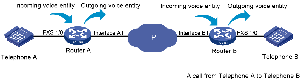

Voice entities identify the originators and the terminators of calls, what protocols used to process the calls, and which routes used to forward the calls.
Types of voice entities
Voice entities include POTS entities, VoIP entities, and IVR entities. You can configure voice entities based on the types of connected devices.
Figure 1 Voice entities
·     POTS entity—A POTS entity connects to a local telephone or a PSTN network. When connecting to a local telephone, a POTS entity maintains local number information. When connecting to a PSTN network, a POTS entity maintains call destination information.
·     VoIP entity—Connects to the IP side. A VoIP entity uses SIP to make VoIP calls. VoIP entities include the following categories:
¡     Dynamic and static VoIP entities.
¡     Incoming and outgoing VoIP entities.
A static incoming VoIP entity maintains the called information such as called number and call destination. Other types of VoIP entities are used in SRST. For more information, see "Configuring SRST."
·     IVR entity—Sets a customizable IVR system. For more information about IVR entities, see "Configuring customizable IVR."
