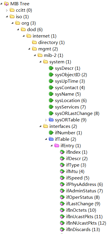

MIB modules and MIB files
A MIB is a collection of information organized hierarchically in a tree structure. Each node in a MIB is a managed object uniquely identified by an object identifier (OID). An OID is a dotted numeric string that uniquely identifies the path from the root node to a leaf node.
Collections of related objects are defined in MIB modules. Typically, each MIB module has a MIB file. You can run a MIB compiler to compile the MIB files of the managed device into a visualized MIB tree for the ease of management, as shown in Figure 1.
Figure 1 MIB tree after compilation

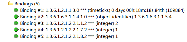

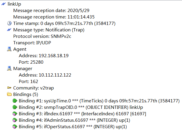

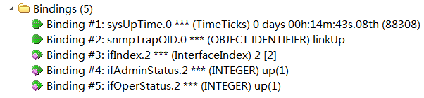

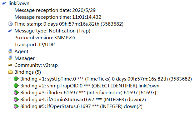

For example, Figure 2 shows the variable binding list in an SNMPv2 linkUp notification.
Figure 2 Variable binding list in an SNMPv2 linkUp notification
In this variable binding list, two are mandatory variable bindings and three are notification-specific bindings.
·     The mandatory variable bindings contain the following object instances:
¡     sysUpTime.0—Contains the time when the notification was generated. In this example, its value is 88308.
¡     snmpTrapOID.0—Contains the name or OID of the notification object. In this example, the notification object is linkUp.
·     The notification-specific bindings contain the following object instances:
¡     ifIndex.2—Index of the interface on which the event occurred. In this example, the interface index is 2. In addition, ifIndex is also the index for the linkUp notification object.
¡     ifAdminStatus.2—The administrative state of the interface. In this example, the index of the interface on which the event occurred is 2. The value for the administrative state of the interface is 1.
¡     ifOperStatus.2—Status of the operation on the interface on which the event occurred. In this example, the interface index is 2. The value for the operation status is 1.
The variable binding list in Figure 2 is in a user-friendly view presented by the network management software after OID translation and numeration value conversion. Figure 3 shows the binding list without OID translation and numeration value conversion. With most network management software offerings, you can choose between the two views as needed.

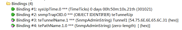

Obtaining information about indexes in variable bindings
A notification-specific variable might be an object instance identified by one index or multiple indexes. The index values are appended to the end of the object name. To obtain information about the indexes for an object instance, use the object name in the binding as the keyword to search the MIB document for the object table. Then, you can find indexing information for that table.
For example, Figure 4 shows the variable biding list in a teTunnelUp notification.
Figure 4 Variable binding list in a teTunnelUp notification
The teTunnelUp notification in this example contains the following notification-specific variable bindings:
·     teTunnelName.1—Name of the tunnel on which the event occurred. In this example, the tunnel is identified by a value of index 1. Its tunnel name is Tunnel1.
·     tePathName.1.0—The administrative status of the TE path on which the event occurred. The TE path is identified by two indexes. One index has a value of 1 and the other index has a value of 0. The value for the administrative status is a zero-length string.
To obtain information about the index or indexes of a variable, look up teTunnelName and tePathName in the document. You can then find tabular objects teTunnelTable and tePathTable, respectively. The index information is right below the tabular object name.

Because the table index for teTunnelTable is teTunnelIndex, the index value .1 in teTunnelName.1 represents the tunnel index with a value of 1.

Because the table indexes of tePathTable are teTunnelIndex and tePathIndex, the index values .1 and .0 in ePathName.1.0 represent the teTunnelIndex and tePathIndex instances with a value of 1 and 0, respectively.
