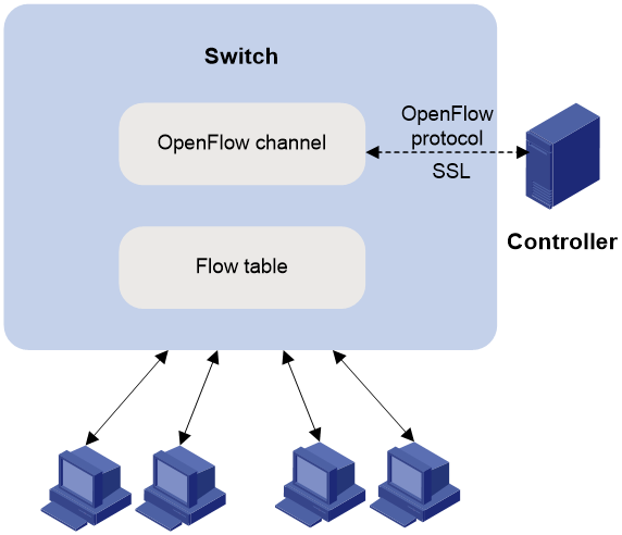

OpenFlow is the communications interface defined between the control and forwarding layers of a Software-Defined Networking architecture. With OpenFlow, you can perform centralized data forwarding management for physical and virtual devices through controllers.
OpenFlow network components
OpenFlow separates the data forwarding and routing decision functions. It keeps the flow-based forwarding function and employs a separate controller to make routing decisions. An OpenFlow switch communicates with the controller through an OpenFlow channel. An OpenFlow channel can be encrypted by using TLS or run directly over TCP. An OpenFlow switch exchanges control messages with the controller through an OpenFlow channel to perform the following operations:
·     Receive flow table entries or data from the controller.
·     Report information to the controller.
Unless otherwise stated, a switch refers to an OpenFlow switch throughout this document.
Figure 1 OpenFlow network diagram

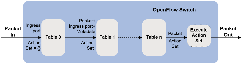

OpenFlow pipeline
The OpenFlow pipeline processing defines how packets interact with flow tables contained by a switch.
The flow tables of an OpenFlow switch are sequentially numbered, starting at 0. The packet is first matched with flow entries of the first flow table, which is flow table 0. A flow entry can only direct a packet to a flow table number that is greater than its own flow table number.
When a packet matches a flow entry, the OpenFlow switch updates the action set for the packet and passes the packet to the next flow table. In the last flow table, the OpenFlow switch executes all actions to modify packet contents and specify the output port for packet forwarding. If the instruction set of a flow table contains an action list, the OpenFlow switch immediately executes the actions for a copy of the packet in this table.
Figure 3 OpenFlow forwarding workflow

The OpenFlow channel is the interface that connects each OpenFlow switch to a controller. The controller uses the OpenFlow channel to exchange control messages with the switch to perform the following operations:
·     Configure and manage the switch.
·     Receive events from the switch.
·     Send packets out the switch.
The OpenFlow channel is usually encrypted by using TLS. Also, an OpenFlow channel can be run directly over TCP.
The OpenFlow protocol supports the following message types: controller-to-switch, asynchronous, and symmetric. Each message type has its own subtypes.

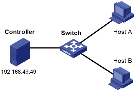

Example: Configuring OpenFlow in VLAN mode
As shown in Figure 7, an OpenFlow switch communicates with the controller. Perform the following tasks on the OpenFlow switch:
·     Create OpenFlow instance 1, associate VLANs 4092 and 4094 with the OpenFlow instance, and activate the OpenFlow instance.
·     Configure the IP address for controller 1 to have the controller manage the OpenFlow switch.
Figure 7 Network diagram
IMPORTANT
IMPORTANT:
By default, interfaces on the device are disabled (in ADM or Administratively Down state). To have an interface operate, you must use the undo shutdown command to enable that interface.
# Create VLANs 4092 and 4094.
<Switch> system-view
[Switch] vlan 4092
[Switch-vlan4092] quit
[Switch] vlan 4094
[Switch-vlan4094] quit
# Create OpenFlow instance 1 and associate VLANs with it.
[Switch] openflow instance 1
[Switch-of-inst-1] classification vlan 4092 mask 4093
# Specify controller 1 for OpenFlow instance 1 and activate the instance.
[Switch-of-inst-1] controller 1 address ip 192.168.49.49
[Switch-of-inst-1] active instance
[Switch-of-inst-1] quit
# View detailed information about the OpenFlow instance.
[Switch] display openflow instance 1
Instance 1 information:
Configuration information:
 Description   : --
 Active status : Active
 Inactive configuration:
  None
 Active configuration:
  Classification VLAN, total VLANs(2)
   4092, 4094
  In-band management VLAN, total VLANs(0)
   Empty VLAN
  Connect mode: Multiple
  Mac-address learning: Enabled
  Flow table:
   Table ID(type): 0(Extensibility), count: 0
  Flow-entry max-limit: 65535
  Datapath ID: 0x0064001122000101
  Default table-miss: Permit
  Forbidden port: VLAN interface
  Qinq Network: Disabled
  TCP connection backup: Enabled
Port information:
 FortyGigE1/0/3
Active channel information:
 Controller 1 IP address: 192.168.49.49 port: 6633
