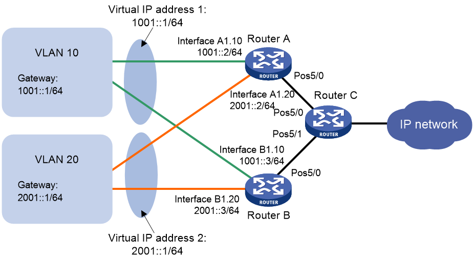

Specifying an IPv6 VRRP control VLAN
As shown in Figure 10, ambiguous VLAN termination is configured for VLAN 10 and VLAN 20 on the Layer 3 Ethernet subinterfaces on routers. To allow the master to regularly send IPv6 VRRP advertisements in multicast to the backups, enable the VLAN termination-enabled subinterfaces to transmit broadcast packets and multicast packets. Then, the master can send IPv6 VRRP advertisements within all VLANs whose VLAN packets are configured to be terminated by the subinterfaces. If ambiguous VLAN termination is configured on the Layer 3 Ethernet subinterfaces for a large range of VLANs, the IPv6 VRRP advertisements might overload the subinterfaces. This adversely affects the performance of the routers.
To resolve this problem, you can disable the VLAN termination-enabled subinterfaces from transmitting broadcast packets and multicast packets and configure an IPv6 VRRP control VLAN. The master sends IPv6 VRRP advertisements only within the control VLAN.
Figure 10 IPv6 VRRP control VLAN
Specify IPv6 VRRP control VLANs according to the VLAN termination type.
·     For ambiguous Dot1q termination, specify one control VLAN by the outermost layer of VLAN tag.
·     For ambiguous QinQ termination, specify two control VLANs by the outermost two layers of VLAN tags.
For more information about VLAN termination, see Layer 2—LAN Switching Configuration Guide.
When IPv6 VRRP is operating in load balancing mode, you cannot specify the IPv6 VRRP control VLAN.

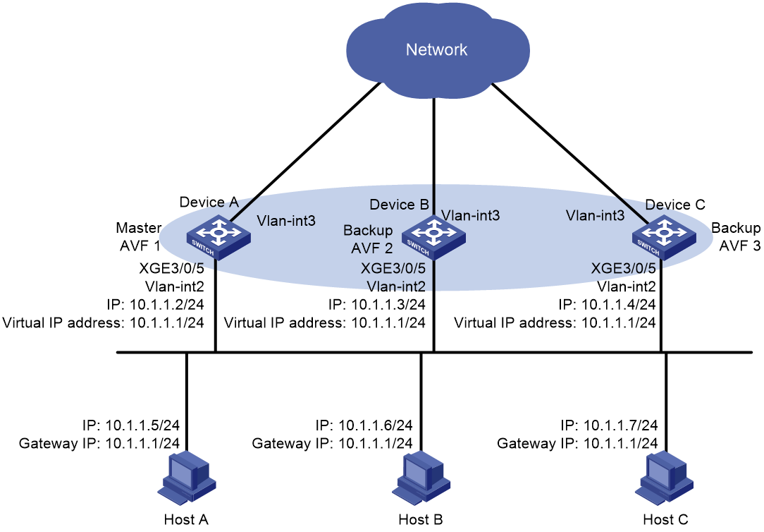

Example: Configuring VRRP load balancing
As shown in Figure 13, Switch A, Switch B, and Switch C form a load-balanced VRRP group. They use the virtual IP address 10.1.1.1/24 to provide gateway service for subnet 10.1.1.0/24.
Configure VFs on Switch A, Switch B, and Switch C to monitor their respective VLAN-interface 3. When the interface on any one of them fails, the weights of the VFs on the problematic switch decrease so another AVF can take over.
Figure 13 Network diagram

# Display detailed information about VRRP group 1 on Switch A.
[SwitchA-Vlan-interface2] display vrrp verbose
IPv4 Virtual Router Information:
 Running Mode      : Load Balance
 Total number of virtual routers : 1
   Interface Vlan-interface2
     VRID             : 1                    Adver Timer  : 100
     Admin Status     : Up                   State        : Master
     Config Pri       : 120                  Running Pri  : 120
     Preempt Mode     : Yes                  Delay Time   : 5000
     Auth Type        : Not supported
     Version          : 3
     Virtual IP       : 10.1.1.1
     Member IP List   : 10.1.1.2 (Local, Master)
                        10.1.1.3 (Backup)
                        10.1.1.4 (Backup)
   Forwarder Information: 3 Forwarders 1 Active
     Config Weight  : 255
     Running Weight : 255
    Forwarder 01
     State          : Active
     Virtual MAC    : 000f-e2ff-0011 (Owner)
     Owner ID       : 0000-5e01-1101
     Priority       : 255
     Active         : local
    Forwarder 02
     State          : Listening
     Virtual MAC    : 000f-e2ff-0012 (Learnt)
     Owner ID       : 0000-5e01-1103
     Priority       : 127
     Active         : 10.1.1.3
    Forwarder 03
     State          : Listening
     Virtual MAC    : 000f-e2ff-0013 (Learnt)
     Owner ID       : 0000-5e01-1105
     Priority       : 127
     Active         : 10.1.1.4
   Forwarder Weight Track Information:
     Track Object   : 1          State : Positive   Weight Reduced : 250
# Display detailed information about VRRP group 1 on Switch B.
[SwitchB-Vlan-interface2] display vrrp verbose
     Admin Status     : Up                   State        : Backup
     Config Pri       : 110                  Running Pri  : 110
     Become Master    : 410ms left
     Version          : 3
     Member IP List   : 10.1.1.3 (Local, Backup)
                        10.1.1.2 (Master)
                        10.1.1.4 (Backup)
     Config Weight  : 255
    Forwarder 01
     State          : Listening
     Virtual MAC    : 000f-e2ff-0011 (Learnt)
     Priority       : 127
     Active         : 10.1.1.2
    Forwarder 02
     State          : Active
     Virtual MAC    : 000f-e2ff-0012 (Owner)
     Priority       : 255
     Active         : local
    Forwarder 03
     State          : Listening
     Priority       : 127
     Active         : 10.1.1.4
# Display detailed information about VRRP group 1 on Switch C.

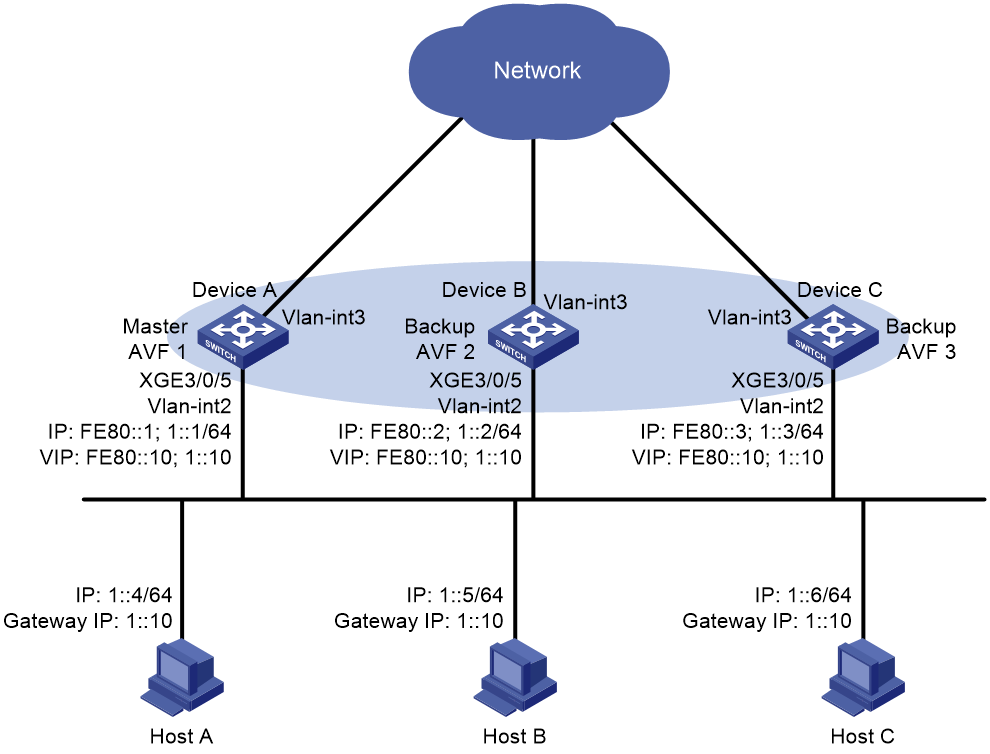

[SwitchC-Vlan-interface2] display vrrp verbose
     Config Pri       : 100                  Running Pri  : 100
     Become Master    : 401ms left
     Version          : 3
     Member IP List   : 10.1.1.4 (Local, Backup)
                        10.1.1.2 (Master)
                        10.1.1.3 (Backup)
     Config Weight  : 255
    Forwarder 01
     State          : Listening
     Priority       : 127
     Active         : 10.1.1.2
    Forwarder 02
     State          : Listening
     Priority       : 127
     Active         : 10.1.1.3
    Forwarder 03
     State          : Active
     Virtual MAC    : 000f-e2ff-0013 (Owner)
     Priority       : 255
     Active         : local
The output shows that Switch A is the master in VRRP group 1, and each of the three switches has one AVF and two LVFs.
# Disconnect the link of VLAN-interface 3 on Switch A, and display detailed information about VRRP group 1 on Switch A.
     Version          : 3
                        10.1.1.3 (Backup)
                        10.1.1.4 (Backup)
   Forwarder Information: 3 Forwarders 0 Active
     Config Weight  : 255
     Running Weight : 5
    Forwarder 01
     State          : Initialize
     Priority       : 0
     Active         : 10.1.1.4
    Forwarder 02
     State          : Initialize
     Priority       : 0
     Active         : 10.1.1.3
    Forwarder 03
     State          : Initialize
     Priority       : 0
     Active         : 10.1.1.4
     Track Object   : 1          State : Negative   Weight Reduced : 250
     Version          : 3
                        10.1.1.2 (Master)
                        10.1.1.3 (Backup)
   Forwarder Information: 3 Forwarders 2 Active
     Config Weight  : 255
    Forwarder 01
     State          : Active
     Virtual MAC    : 000f-e2ff-0011 (Take Over)
     Priority       : 85
     Active         : local
    Forwarder 02
     State          : Listening
     Priority       : 85
     Active         : 10.1.1.3
    Forwarder 03
     State          : Active
     Priority       : 255
     Active         : local
The output shows that when VLAN-interface 3 on Switch A fails, the weights of the VFs on Switch A drop below the lower limit of failure. All VFs on Switch A transit to the Initialize state and cannot forward traffic. The VF for MAC address 000f-e2ff-0011 on Switch C becomes the AVF to forward traffic.
# When the timeout timer (about 1800 seconds) expires, display detailed information about VRRP group 1 on Switch C.
     Become Master    : 402ms left
     Version          : 3
                        10.1.1.2 (Master)
                        10.1.1.3 (Backup)
   Forwarder Information: 2 Forwarders 1 Active
     Config Weight  : 255
    Forwarder 02
     State          : Listening
     Priority       : 127
     Active         : 10.1.1.3
    Forwarder 03
     State          : Active
     Priority       : 255
     Active         : local
The output shows that when the timeout timer expires, the VF for virtual MAC address 000f-e2ff-0011 is removed. The VF no longer forwards the packets destined for the MAC address.
# When Switch A fails, display detailed information about VRRP group 1 on Switch B.
     Version          : 3
     Member IP List   : 10.1.1.3 (Local, Master)
                        10.1.1.4 (Backup)
     Config Weight  : 255
    Forwarder 02
     State          : Active
     Priority       : 255
     Active         : local
    Forwarder 03
     State          : Listening
     Priority       : 127
     Active         : 10.1.1.4
The output shows the following information:
·     When Switch A fails, Switch B becomes the master because it has a higher priority than Switch C.
·     The VF for virtual MAC address 000f-e2ff-0011 is removed.
As shown in Figure 16, Switch A, Switch B, and Switch C form a load balanced VRRP group. They use the virtual IPv6 addresses FE80::10 and 1::10 to provide gateway service for subnet 1::/64.
Hosts on subnet 1::/64 learn 1::10 as their default gateway from RA messages sent by the switches.
Configure VFs on Switch A, Switch B, or Switch C to monitor their respective VLAN-interface 3. When the interface on any of them fails, the weights of the VFs on the problematic switch decrease so another AVF can take over.
Figure 16 Network diagram

     Active         : local
# Disconnect the link of VLAN-interface 3 on Switch A and display detailed information about VRRP group 1 on Switch A.
[SwitchA-Vlan-interface2] display vrrp ipv6 verbose
IPv6 Virtual Router Information:
     Virtual IP       : FE80::10
                        1::10
     Member IP List   : FE80::1 (Local, Master)
                        FE80::2 (Backup)
                        FE80::3 (Backup)
     Config Weight  : 255
     Running Weight : 5
    Forwarder 01
     State          : Initialize
     Virtual MAC    : 000f-e2ff-4011 (Owner)
     Priority       : 0
     Active         : FE80::3
    Forwarder 02
     State          : Initialize
     Virtual MAC    : 000f-e2ff-4012 (Learnt)
     Priority       : 0
     Active         : FE80::2
    Forwarder 03
     State          : Initialize
     Virtual MAC    : 000f-e2ff-4013 (Learnt)
     Priority       : 0
     Active         : FE80::3
[SwitchC-Vlan-interface2] display vrrp ipv6 verbose
                        1::10
     Member IP List   : FE80::3 (Local, Backup)
                        FE80::1 (Master)
                        FE80::2 (Backup)
     Config Weight  : 255
    Forwarder 01
     State          : Active
     Virtual MAC    : 000f-e2ff-4011 (Take Over)
     Priority       : 85
     Active         : local
    Forwarder 02
     State          : Listening
     Priority       : 85
     Active         : FE80::2
    Forwarder 03
     State          : Active
     Virtual MAC    : 000f-e2ff-4013 (Owner)
     Priority       : 255
     Active         : local
The output shows that when VLAN-interface 3 on Switch A fails, the weights of the VFs on Switch A drop below the lower limit of failure. All VFs on Switch A transit to the Initialize state and cannot forward traffic. The VF for MAC address 000f-e2ff-4011 on Switch C becomes the AVF to forward traffic.
     Become Master    : 400ms left
                        1::10
                        FE80::1 (Master)
                        FE80::2 (Backup)
     Config Weight  : 255
    Forwarder 02
     State          : Listening
     Priority       : 127
     Active         : FE80::2
    Forwarder 03
     State          : Active
     Priority       : 255
     Active         : local
The output shows that when the timeout timer expires, the VF for virtual MAC address 000f-e2ff-4011 is removed. The VF no longer forwards the packets destined for the MAC address.
[SwitchB-Vlan-interface2] display vrrp ipv6 verbose
                        1::10
     Member IP List   : FE80::2 (Local, Master)
                        FE80::3 (Backup)
     Config Weight  : 255
    Forwarder 02
     State          : Active
     Virtual MAC    : 000f-e2ff-4012 (Owner)
     Priority       : 255
     Active         : local
    Forwarder 03
     State          : Listening
     Priority       : 127
     Active         : FE80::3
·     The VF for virtual MAC address 000f-e2ff-4011 is removed.
