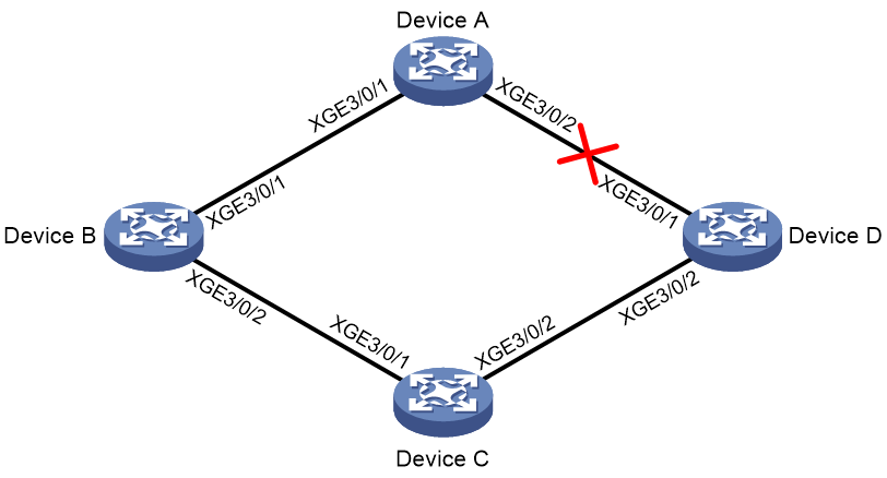

As shown in Figure 2:
·     Device C is a Smart Link device, and Device A, Device B, and Device D are associated devices. Traffic of VLANs 1 through 30 on Device C is dual-uplinked to Device A through a smart link group.
·     Implement dual uplink backup on Device C. When the link between Device A and Device B (or Device D) fails, Device C can detect the link fault. It then performs uplink switchover in the smart link group.
For more information about Smart Link, see "Configuring Smart Link."
Figure 2 Network diagram
1.     Configure Device C:
# Create VLANs 1 through 30.
<DeviceC> system-view
[DeviceC] vlan 1 to 30
# Map these VLANs to MSTI 1.
[DeviceC] stp region-configuration
[DeviceC-mst-region] instance 1 vlan 1 to 30
# Activate MST region configuration.
[DeviceC-mst-region] active region-configuration
[DeviceC-mst-region] quit
# Shut down Ten-GigabitEthernet 3/0/1.
[DeviceC] interface ten-gigabitethernet 3/0/1
[DeviceC-Ten-GigabitEthernet3/0/1] shutdown
# Disable the spanning tree feature on the interface.
[DeviceC-Ten-GigabitEthernet3/0/1] undo stp enable
# Configure the interface as a trunk port.
[DeviceC-Ten-GigabitEthernet3/0/1] port link-type trunk
# Assign the interface to VLANs 1 through 30.
[DeviceC-Ten-GigabitEthernet3/0/1] port trunk permit vlan 1 to 30
[DeviceC-Ten-GigabitEthernet3/0/1] quit
# Configure Ten-GigabitEthernet 3/0/2 in the same way Ten-GigabitEthernet 3/0/1 is configured.
[DeviceC] interface ten-gigabitethernet 3/0/2
[DeviceC-Ten-GigabitEthernet3/0/2] shutdown
[DeviceC-Ten-GigabitEthernet3/0/2] undo stp enable
[DeviceC-Ten-GigabitEthernet3/0/2] port link-type trunk
[DeviceC-Ten-GigabitEthernet3/0/2] port trunk permit vlan 1 to 30
[DeviceC-Ten-GigabitEthernet3/0/2] quit
# Create smart link group 1, and configure all the VLANs mapped to MSTI 1 as the protected VLANs for smart link group 1.
[DeviceC] smart-link group 1
[DeviceC-smlk-group1] protected-vlan reference-instance 1
# Configure Ten-GigabitEthernet 3/0/1 as the primary port and Ten-GigabitEthernet 3/0/2 as the secondary port for smart link group 1.
[DeviceC-smlk-group1] port ten-gigabitethernet 3/0/1 primary
[DeviceC-smlk-group1] port ten-gigabitethernet 3/0/2 secondary
# Enable the smart link group to transmit flush messages.
[DeviceC-smlk-group1] flush enable
[DeviceC-smlk-group1] quit
# Bring up Ten-GigabitEthernet 3/0/1 and Ten-GigabitEthernet 3/0/2.
[DeviceC-Ten-GigabitEthernet3/0/1] undo shutdown
[DeviceC-Ten-GigabitEthernet3/0/2] undo shutdown

# When Ten-GigabitEthernet 3/0/2 on Device A goes down because of a link fault, verify information about monitor link group 1 on Device B.
[DeviceB] display monitor-link group 1
Monitor link group 1 information:
  Group status     : UP
  Downlink up delay: 0(s)
  Last up time     : 16:38:26 2012/4/21
  Last down time   : 16:37:20 2012/4/21
  Up port threshold: 1
  Member                    Role       Status
  XGE3/0/1                   UPLINK     UP
  XGE3/0/2                   DOWNLINK   UP
# Verify information about monitor link group 1 on Device D.
[DeviceD] display monitor-link group 1
  Group status     : DOWN
  Last up time     : 16:37:20 2012/4/21
  Last down time   : 16:38:26 2012/4/21
  Member                    Role       Status
  XGE3/0/1                   UPLINK     DOWN
  XGE3/0/2                   DOWNLINK   DOWN (Monitor Link)
