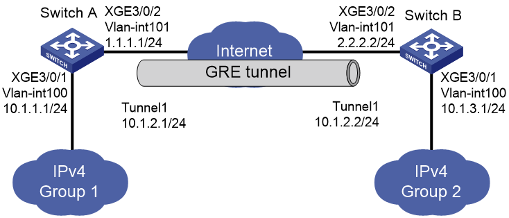

Example: Configuring an IPv4 over IPv4 GRE tunnel
As shown in Figure 7, Group 1 and Group 2 are two private IPv4 networks. The two networks both use private network addresses and belong to the same VPN. Establish a GRE tunnel between Switch A and Switch B to interconnect the two private IPv4 networks Group 1 and Group 2.
Figure 7 Network diagram
Before performing the following configuration, configure an IP address for each interface, and make sure Switch A and Switch B can reach each other.
1.     Configure Switch A:
# Create a tunnel interface Tunnel 1, and specify the tunnel mode as GRE/IPv4.
[SwitchA] interface tunnel 1 mode gre
# Configure an IP address for the tunnel interface.
[SwitchA-Tunnel1] ip address 10.1.2.1 255.255.255.0
# Configure the source address of tunnel interface as the IP address of VLAN-interface 101 on Switch A.
[SwitchA-Tunnel1] source 1.1.1.1
# Configure the destination address of the tunnel interface as the IP address of VLAN-interface 101 on Switch B.
[SwitchA-Tunnel1] destination 2.2.2.2
[SwitchA-Tunnel1] quit
# Configure a static route from Switch A through the tunnel interface to Group 2.
[SwitchA] ip route-static 10.1.3.0 255.255.255.0 tunnel 1

Example: Configuring an IPv4 over IPv6 GRE tunnel
As shown in Figure 8, two IPv4 subnets Group 1 and Group 2 are connected to an IPv6 network. Create a GRE/IPv6 tunnel between Switch A and Switch B, so the two IPv4 subnets can communicate with each other through the GRE tunnel over the IPv6 network.
Figure 8 Network diagram
# Create a tunnel interface Tunnel 0, and specify the tunnel mode as GRE/ IPv6.
[SwitchA] interface tunnel 0 mode gre ipv6
[SwitchA-Tunnel0] ip address 10.1.2.1 255.255.255.0
# Configure the source address of the tunnel interface as the IPv6 address of VLAN-interface 101 on Switch A.
[SwitchA-Tunnel0] source 2003::1:1
# Configure the destination address of the tunnel interface as the IPv6 address of VLAN-interface 101 on Switch B.
[SwitchA-Tunnel0] destination 2001::2:1
[SwitchA-Tunnel0] quit
[SwitchA] ip route-static 10.1.3.0 255.255.255.0 tunnel 0
2.     Configure Switch B:
# Create a tunnel interface Tunnel 0, and specify the tunnel mode as GRE/IPv6.
[SwitchB] interface tunnel 0 mode gre ipv6
[SwitchB-Tunnel0] ip address 10.1.2.2 255.255.255.0
# Configure the source address of tunnel interface as the IPv6 address of VLAN-interface 101 on Switch B.
[SwitchB-Tunnel0] source 2001::2:1
# Configure the destination address of the tunnel interface as the IPv6 address of VLAN-interface 101 on Switch A.
[SwitchB-Tunnel0] destination 2003::1:1
[SwitchB-Tunnel0] quit
# Configure a static route from Switch B through the tunnel interface to Group 1.
[SwitchB] ip route-static 10.1.1.0 255.255.255.0 tunnel 0

Figure 9 Network diagram
Hosts at both ends of a GRE tunnel cannot ping each other
Symptom
The interfaces at both ends of the tunnel are configured correctly and can ping each other, but Host A and Host B cannot ping each other.
Solution
To resolve the issue:
1.     Execute the display ip routing-table command on Device A and Device C to view whether Device A has a route over tunnel 0 to 10.2.0.0/16 and whether Device C has a route over ‍‍tunnel 0 to 10.1.0.0/16.
2.     If such a route does not exist, execute the ip route-static command in system view to add the route. Take Device A as an example:
[DeviceA] ip route-static 10.2.0.0 255.255.0.0 tunnel 0
3.     If the issue persists, contact H3C Support.
