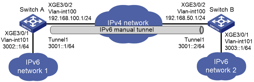

Tunnel modes
IPv6 over IPv4 tunnels include manually configured tunnels and automatic tunnels, depending on how the IPv4 address of the tunnel destination is obtained.
·     Manually configured tunnel—The destination IPv4 address of the tunnel cannot be automatically obtained from the destination IPv6 address of an IPv6 packet at the tunnel source. It must be manually configured.

IPv6 over IPv4 manual tunneling
An IPv6 over IPv4 manual tunnel is a point-to-point link. To establish a manual tunnel, you must manually configure the source and destination addresses of the tunnel at both ends of the tunnel.
Manual tunneling provides the following solutions:
·     Connects isolated IPv6 networks over an IPv4 network.
·     Connects an IPv6 network and an IPv4/IPv6 dual-stack host over an IPv4 network.

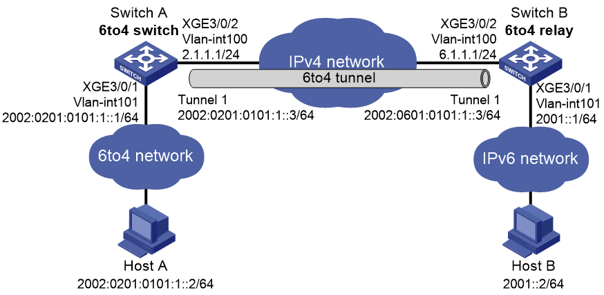

·     6to4 relay
6to4 relay connects a 6to4 network and an IPv6 network that uses an IP prefix other than 2002::/16. A 6to4 relay router is a gateway that forwards packets from a 6to4 network to an IPv6 network.
As shown in Figure 2, 6to4 network Site 1 communicates with IPv6 network Site 3 over a 6to4 tunnel. Configure a static route on the border router (Device A) in the 6to4 network. The next hop address must be the 6to4 address of the 6to4 relay router (Device C). Device A forwards all packets destined for the IPv6 network over the 6to4 tunnel, and Device C then forwards them to the IPv6 network.
Figure 2 Principle of 6to4 tunneling and 6to4 relay

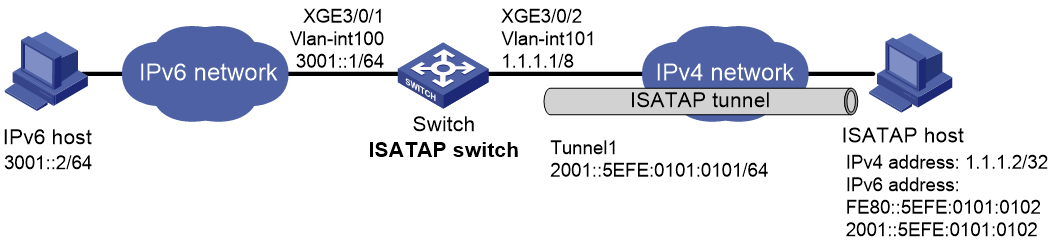

ISATAP tunneling
An ISATAP tunnel is a point-to-multipoint automatic tunnel. It provides a solution to connect an IPv6 host and an IPv6 network over an IPv4 network.
The destination address of an ISATAP tunnel is an ISATAP address. The address format is prefix:0:5EFE:abcd:efgh/64.
·     The 64-bit prefix is a valid IPv6 unicast address prefix.
·     The abcd:efgh/64 segments represent a 32-bit IPv4 address in hexadecimal notation, which identifies the tunnel destination but does not require global uniqueness.
ISATAP tunnels are mainly used for communication between IPv6 routers or between an IPv6 host and an IPv6 router over an IPv4 network.
Figure 3 Principle of ISATAP tunneling

# Configure a static route destined for the 6to4 relay switch.
[SwitchA] ipv6 route-static 2002:0601:0101:: 64 tunnel 0
# Configure a default route to reach the IPv6 network, which specifies the 6to4 address of the 6to4 relay switch as the next hop.
[SwitchA] ipv6 route-static :: 0 2002:0601:0101::1
2.     Configure Switch B:
# Add Ten-GigabitEthernet 3/0/2 (the physical interface of the tunnel) to VLAN 100.
<SwitchB> system-view
[SwitchB] vlan 100
[SwitchB-vlan100] port ten-gigabitethernet 3/0/2
[SwitchB-vlan100] quit
# Specify an IPv4 address for VLAN-interface 100.
[SwitchB-Vlan-interface100] ip address 6.1.1.1 255.255.255.0
# Add Ten-GigabitEthernet 3/0/1 to VLAN 101.
[SwitchB] vlan 101
[SwitchB-vlan101] port ten-gigabitethernet 3/0/1
[SwitchB-vlan101] quit
# Specify an IPv6 address for VLAN-interface 101.
[SwitchB] interface vlan-interface 101
[SwitchB-Vlan-interface101] ipv6 address 2001::1/16
[SwitchB-Vlan-interface101] quit
# Create 6to4 tunnel interface Tunnel 0.
[SwitchB] interface tunnel 0 mode ipv6-ipv4 6to4
# Specify an IPv6 address for the tunnel interface.
[SwitchB-Tunnel0] ipv6 address 2002:0601:0101:1::3/64
# Specify VLAN-interface 100 as the source interface of the tunnel interface.
[SwitchB-Tunnel0] source vlan-interface 100
[SwitchB-Tunnel0] quit
# Configure a static route destined for 2002::/16 through the tunnel interface.
[SwitchB] ipv6 route-static 2002:: 16 tunnel 0
# Verify that Host A and Host B can ping each other.
D:\>ping6 -s 2002:201:101:1::2 2001::2
Pinging 2001::2
from 2002:201:101:1::2 with 32 bytes of data:
Reply from 2001::2: bytes=32 time=13ms
Reply from 2001::2: bytes=32 time=1ms
Reply from 2001::2: bytes=32 time<1ms
Ping statistics for 2001::2:
    Minimum = 0ms, Maximum = 13ms, Average = 3ms

Example: Configuring an ISATAP tunnel
As shown in Figure 7, configure an ISATAP tunnel between the switch and the ISATAP host so the ISATAP host in the IPv4 network can access the IPv6 network.
Figure 7 Network diagram
1.     Configure the switch:
# Add Ten-GigabitEthernet 3/0/1 to VLAN 100.
<Switch> system-view
[Switch] vlan 100
[Switch-vlan100] port ten-gigabitethernet 3/0/1
[Switch-vlan100] quit
# Specify an IPv6 address for VLAN-interface 100.
[Switch-Vlan-interface100] ipv6 address 3001::1/64
# Add Ten-GigabitEthernet 3/0/2 (the physical interface of the tunnel) to VLAN 101.
[Switch] vlan 101
[Switch-vlan101] port ten-gigabitethernet 3/0/2
[Switch-vlan101] quit
# Specify an IPv4 address for VLAN-interface 101.
[Switch] interface vlan-interface 101
[Switch-Vlan-interface101] ip address 1.1.1.1 255.0.0.0
[Switch-Vlan-interface101] quit
# Create ISATAP tunnel interface Tunnel 0.
[Switch] interface tunnel 0 mode ipv6-ipv4 isatap
# Specify an EUI-64 IPv6 address for the tunnel interface.
[Switch-Tunnel0] ipv6 address 2001:: 64 eui-64
# Specify VLAN-interface 101 as the source interface of the tunnel interface.
[Switch-Tunnel0] source vlan-interface 101
# Disable RA suppression so that the ISATAP host can acquire information such as the address prefix from the RA message advertised by the ISATAP switch.
[Switch-Tunnel0] undo ipv6 nd ra halt
[Switch-Tunnel0] quit
2.     Configure the ISATAP host:
Configurations on the ISATAP host vary by operating system. The following configuration is performed on Windows 7.
# Specify an IPv4 address for the ISATAP switch.
C:\>netsh interface ipv6 isatap set router 1.1.1.1
3.     On the IPv6 host, configure a route to the ISATAP switch.
C:\>netsh interface ipv6 set route 2001::/64 5 3001::1
# Verify that the ISATAP host can ping the IPv6 host.
C:\>ping 3001::2
Pinging 3001::2 with 32 bytes of data:
Reply from 3001::2: time=1ms
Ping statistics for 3001::2:

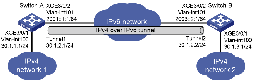

IPv4 over IPv6 tunneling
About IPv4 over IPv6 tunneling
Implementation
IPv4 over IPv6 tunneling adds an IPv6 header to IPv4 packets so that the IPv4 packets can pass an IPv6 network through a tunnel to realize interworking between isolated IPv4 networks.
Figure 10 IPv4 over IPv6 tunnel
Figure 10 shows the encapsulation and de-encapsulation processes.
·     Encapsulation:
a.     Upon receiving an IPv4 packet, Device A delivers it to the IPv4 protocol stack.
b.     The IPv4 protocol stack uses the destination address of the packet to determine the egress interface. If the egress interface is the tunnel interface, the IPv4 protocol stack delivers the packet to the tunnel interface.
c.     The tunnel interface adds an IPv6 header to the original IPv4 packet and delivers the packet to the IPv6 protocol stack.
d.     The IPv6 protocol stack uses the destination IPv6 address of the packet to look up the routing table, and then sends it out.
·     De-encapsulation:
a.     Upon receiving the IPv6 packet from the attached IPv6 network, Device B delivers the packet to the IPv6 protocol stack to examine the protocol type encapsulated in the data portion of the packet.
b.     If the protocol type is IPv4, the IPv6 protocol stack delivers the packet to the tunneling module.
c.     The tunneling module removes the IPv6 header and delivers the remaining IPv4 packet to the IPv4 protocol stack.
d.     The IPv4 protocol stack forwards the IPv4 packet.

Example: Configuring an IPv4 over IPv6 manual tunnel
As shown in Figure 11, configure an IPv4 over IPv6 manual tunnel between Switch A and Switch B so the two networks can reach each other over the IPv6 network.
Figure 11 Network diagram
Make sure Switch A and Switch B have the corresponding VLAN interfaces created and can reach each other through IPv6.
