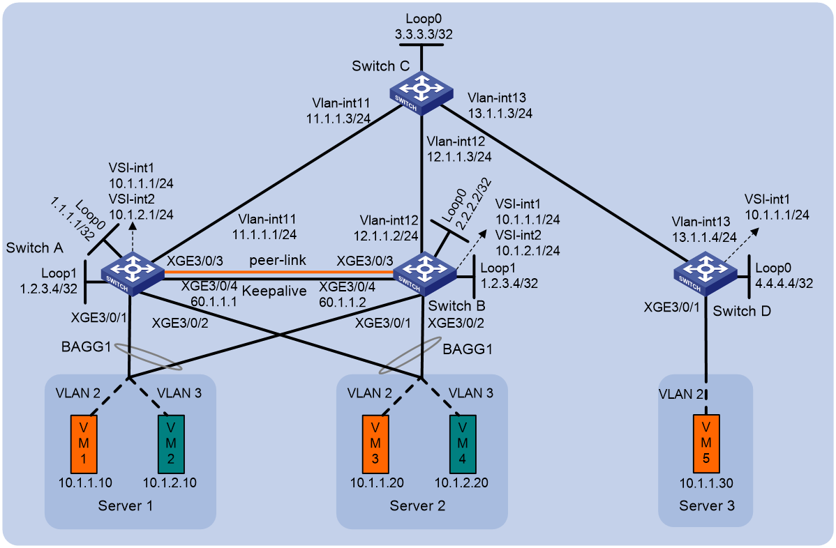

Example: Configuring M-LAG using a direct peer link on EVPN VTEPs
As shown in Figure 1, perform the following tasks to make sure the VMs can communicate with one another:
·     Configure VXLAN 10 on Switch A, Switch B, and Switch D.
·     Configure M-LAG on Switch A and Switch B to virtualize them into one VTEP. Configure a direct peer link between the switches.
·     Configure Switch C as a route reflector (RR).
Figure 1 Network diagram
Analysis
To make sure the overlay network has connectivity, configure a routing protocol on the switches to advertise routes for reaching their interfaces, including the loopback interfaces. In this example, OSPF is used.
To conserve resources, configure Switch C to reflect routes for Switch A, Switch B, and Switch D.

Configuring routed (Layer 3) interfaces
# Configure the Layer 3 interfaces on Switch A.
<SwitchA> system-view
[SwitchA] interface loopback 0
[SwitchA-Loopback0] ip address 1.1.1.1 32
[SwitchA-Loopback0] quit
[SwitchA] interface loopback 1
[SwitchA-Loopback1] ip address 1.2.3.4 32
[SwitchA-Loopback1] quit
[SwitchA] vlan 11
[SwitchA-vlan11] port ten-gigabitethernet 3/0/5
[SwitchA-vlan11] quit
[SwitchA] interface vlan-interface 11
[SwitchA-Vlan-interface11] ip address 11.1.1.1 24
[SwitchA-Vlan-interface11] quit
[SwitchA] interface ten-gigabitethernet 3/0/4
[SwitchA-Ten-GigabitEthernet3/0/4] port link-mode route
[SwitchA-Ten-GigabitEthernet3/0/4] ip address 60.1.1.1 24
[SwitchA-Ten-GigabitEthernet3/0/4] quit
# Configure the Layer 3 interfaces on other switches. (Details not shown.)

Configuring M-LAG
Configuring Switch A
# Specify the virtual VTEP address as 1.2.3.4.
[SwitchA] evpn m-lag group 1.2.3.4
# Configure M-LAG system parameters.
[SwitchA] m-lag system-mac 0001-0001-0001
[SwitchA] m-lag system-number 1
[SwitchA] m-lag system-priority 10
[SwitchA] m-lag restore-delay 180
[SwitchA] m-lag keepalive ip destination 60.1.1.2 source 60.1.1.1
# Create Layer 2 dynamic aggregate interface Bridge-Aggregation 3.
[SwitchA] interface bridge-aggregation 3
[SwitchA-Bridge-Aggregation3] link-aggregation mode dynamic
[SwitchA-Bridge-Aggregation3] quit
# Assign Ten-GigabitEthernet 3/0/3 to aggregation group 3.
[SwitchA] interface ten-gigabitethernet 3/0/3
[SwitchA-Ten-GigabitEthernet3/0/3] port link-aggregation group 3
[SwitchA-Ten-GigabitEthernet3/0/3] quit
# Specify Bridge-Aggregation 3 as the peer-link interface.
[SwitchA-Bridge-Aggregation3] port m-lag peer-link 1
[SwitchA-Bridge-Aggregation3] undo mac-address static source-check enable
# Set up Layer 3 connectivity between Switch A and Switch B.
[SwitchA] vlan 100
[SwitchA-vlan100] quit
[SwitchA] interface Vlan-interface 100
[SwitchA-Vlan-interface100] ip address 100.1.1.1 255.255.255.0
[SwitchA-Vlan-interface100] ospf 1 area 0.0.0.0
# Disable the static source check feature and spanning tree on Ten-GigabitEthernet 3/0/5.
[SwitchA] interface ten-gigabitethernet 3/0/5
[SwitchA-Ten-GigabitEthernet3/0/5] undo mac-address static source-check enable
[SwitchA-Ten-GigabitEthernet3/0/5] undo stp enable
[SwitchA-Ten-GigabitEthernet3/0/5] quit
# Create Layer 2 dynamic aggregate interface Bridge-Aggregation 4.
[SwitchA] interface bridge-aggregation 4
[SwitchA-Bridge-Aggregation4] link-aggregation mode dynamic
[SwitchA-Bridge-Aggregation4] quit
# Assign Ten-GigabitEthernet 3/0/1 to aggregation group 4.
[SwitchA] interface ten-gigabitethernet 3/0/1
[SwitchA-Ten-GigabitEthernet3/0/1] port link-aggregation group 4
[SwitchA-Ten-GigabitEthernet3/0/1] quit
# Assign Bridge-Aggregation 4 to M-LAG group 4.
[SwitchA-Bridge-Aggregation4] port m-lag group 4
# Create Layer 2 dynamic aggregate interface Bridge-Aggregation 5.
[SwitchA] interface bridge-aggregation 5
[SwitchA-Bridge-Aggregation5] link-aggregation mode dynamic
[SwitchA-Bridge-Aggregation5] quit
# Assign Ten-GigabitEthernet 3/0/2 to aggregation group 5.
[SwitchA] interface ten-gigabitethernet 3/0/2
[SwitchA-Ten-GigabitEthernet3/0/2] port link-aggregation group 5
[SwitchA-Ten-GigabitEthernet3/0/2] quit
# Assign Bridge-Aggregation 5 to M-LAG group 5.
[SwitchA-Bridge-Aggregation5] port m-lag group 5
# Exclude all interfaces used by EVPN from the shutdown action by M-LAG MAD.
[SwitchA] m-lag mad exclude interface loopback 0
[SwitchA] m-lag mad exclude interface ten-gigabitethernet 3/0/4
[SwitchA] m-lag mad exclude interface ten-gigabitethernet 3/0/5
[SwitchA] m-lag mad exclude interface vlan-interface 11

[SwitchB] m-lag mad exclude interface ten-gigabitethernet 3/0/5
[SwitchA] m-lag mad exclude interface vlan-interface 12

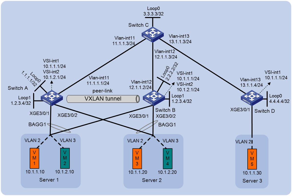

Example: Configuring M-LAG using a tunnel peer link on EVPN VTEPs
As shown in Figure 2, perform the following tasks to make sure the VMs can communicate with one another:
·     Configure M-LAG on Switch A and Switch B to virtualize them into one VTEP. Manually set up a tunnel peer link between the switches.
·     Create a monitor link group on Switch A and Switch B. Configure the transport-facing interfaces of Switch A and Switch B as uplink interfaces for the monitor link group, and member interfaces of M-LAG interfaces as downlink interfaces.
·     Configure Switch C as an RR.
Figure 2 Network diagram

Example: Configuring M-LAG using a direct peer link on EVPN gateways
As shown in Figure 3, perform the following tasks to make sure the VMs can communicate with one another:
·     Configure VXLAN 10 on Switch A, Switch B, and Switch D, and configure VXLAN 20 on Switch A and Switch B.
·     Configure Switch A, Switch B, and Switch D as distributed EVPN gateways to provide Layer 3 forwarding service for VMs.
Figure 3 Network diagram
Analysis
To make sure the overlay network has connectivity,, configure a routing protocol on these switches to advertise routes for reaching their interfaces, including the loopback interfaces. In this example, OSPF is used.
Hardware
Software version
S12500G-AF
Release 8053P05 and later
S12500CR
S10500X-G
Release 7753P05 and later
S7500X-G
Procedures
Configuring Layer 3 interfaces
[SwitchA] vlan 11
# On VM 1, VM 3, and VM 5, specify 10.1.1.1 as the gateway address. On VM 2 and VM 4, specify 10.1.2.1 as the gateway address. (Details not shown.)

Example: Configuring M-LAG using a tunnel peer link on EVPN gateways
As shown in Figure 4, perform the following tasks to make sure the VMs can communicate with one another:
·     Configure VXLAN 10 on Switch A, Switch B, and Switch D, and configure VXLAN 20 on Switch A, and Switch B.
Figure 4 Network diagram

Configuring M-LAG
[SwitchA] m-lag system-mac 0001-0002-0003
# Create a tunnel to Switch B and set the ToS of tunneled packets to 100.
[SwitchA] interface tunnel 1 mode vxlan
[SwitchA-Tunnel1] source 1.1.1.1
[SwitchA-Tunnel1] destination 2.2.2.2
[SwitchA-Tunnel1] tunnel tos 100
[SwitchA-Tunnel1] quit
# Exclude Tunnel 1 from the shutdown action by M-LAG MAD.
[SwitchA] m-lag mad exclude interface tunnel 1
# Specify Tunnel 1 as the peer-link interface.
[SwitchA-Tunnel1] port m-lag peer-link 1
# Create monitor link group 1 and assign uplink and downlink interfaces to it.
[SwitchA] monitor-link group 1
[SwitchA-mtlk-group1] port ten-gigabitethernet 3/0/1 downlink
[SwitchA-mtlk-group1] port ten-gigabitethernet 3/0/2 downlink
[SwitchA-mtlk-group1] port ten-gigabitethernet 3/0/4 uplink
[SwitchA-mtlk-group1] quit
[SwitchA] m-lag mad exclude interface loopback0
[SwitchA] m-lag mad exclude interface ten-gigabitethernet3/0/5
[SwitchA] m-lag mad exclude interface vsi-interface 1
[SwitchA] m-lag mad exclude interface vsi-interface 2
Configuring Switch B
[SwitchB] evpn m-lag group 1.2.3.4
[SwitchB] m-lag system-mac 0001-0002-0003
[SwitchB] m-lag system-number 2
[SwitchB] m-lag system-priority 10
[SwitchB] m-lag restore-delay 180
# Create a tunnel to Switch A, and set the ToS of tunneled packets to 100.
[SwitchB] interface tunnel 1 mode vxlan
[SwitchB-Tunnel1] source 2.2.2.2
[SwitchB-Tunnel1] destination 1.1.1.1
[SwitchB-Tunnel1] tunnel tos 100
[SwitchB-Tunnel1] quit
[SwitchB] m-lag mad exclude interface tunnel 1
[SwitchB-Tunnel1] port m-lag peer-link 1
[SwitchB] interface ten-gigabitethernet 3/0/5
[SwitchB-Ten-GigabitEthernet3/0/5] undo mac-address static source-check enable
[SwitchB-Ten-GigabitEthernet3/0/5] undo stp enable
[SwitchB-Ten-GigabitEthernet3/0/5] quit
[SwitchB] interface bridge-aggregation 4
[SwitchB-Bridge-Aggregation4] link-aggregation mode dynamic
[SwitchB-Bridge-Aggregation4] quit
[SwitchB] interface ten-gigabitethernet 3/0/1
[SwitchB-Ten-GigabitEthernet3/0/1] port link-aggregation group 4
[SwitchB-Ten-GigabitEthernet3/0/1] quit
[SwitchB-Bridge-Aggregation4] port m-lag group 4
[SwitchB] interface bridge-aggregation 5
[SwitchB-Bridge-Aggregation5] link-aggregation mode dynamic
[SwitchB-Bridge-Aggregation5] quit
[SwitchB] interface ten-gigabitethernet 3/0/2
[SwitchB-Ten-GigabitEthernet3/0/2] port link-aggregation group 5
[SwitchB-Ten-GigabitEthernet3/0/2] quit
[SwitchB-Bridge-Aggregation5] port m-lag group 5
[SwitchB] monitor-link group 1
[SwitchB-mtlk-group1] port ten-gigabitethernet 3/0/1 downlink
[SwitchB-mtlk-group1] port ten-gigabitethernet 3/0/2 downlink
[SwitchB-mtlk-group1] port ten-gigabitethernet 3/0/4 uplink
[SwitchB-mtlk-group1] quit
[SwitchB] m-lag mad exclude interface loopback0
[SwitchB] m-lag mad exclude interface ten-gigabitethernet3/0/5
[SwitchB] m-lag mad exclude interface vsi-interface 1
[SwitchB] m-lag mad exclude interface vsi-interface 2
[SwitchB] m-lag mad exclude interface vlan-interface 12
Configuring BGP to advertise BGP EVPN routes
# Configure BGP to advertise BGP EVPN routes.
[SwitchA] bgp 200
[SwitchA-bgp-default] peer 3.3.3.3 as-number 200
[SwitchA-bgp-default] peer 3.3.3.3 connect-interface loopback 0
[SwitchA-bgp-default] address-family l2vpn evpn
[SwitchA-bgp-default-evpn] peer 3.3.3.3 enable
[SwitchA-bgp-default-evpn] quit
[SwitchA-bgp-default] quit
[SwitchB] bgp 200
[SwitchB-bgp-default] peer 3.3.3.3 as-number 200
[SwitchB-bgp-default] peer 3.3.3.3 connect-interface loopback 0
[SwitchB-bgp-default] address-family l2vpn evpn
[SwitchB-bgp-default-evpn] peer 3.3.3.3 enable
[SwitchB-bgp-default-evpn] quit
[SwitchB-bgp-default] quit
Configuring Switch C
# Configure BGP to advertise BGP EVPN routes and configure the switch as an RR.
[SwitchC] bgp 200
[SwitchC-bgp-default] group evpn
[SwitchC-bgp-default] peer 1.1.1.1 group evpn
[SwitchC-bgp-default] peer 2.2.2.2 group evpn
[SwitchC-bgp-default] peer 4.4.4.4 group evpn
[SwitchC-bgp-default] peer evpn as-number 200
[SwitchC-bgp-default] peer evpn connect-interface loopback 0
[SwitchC-bgp-default] address-family l2vpn evpn
[SwitchC-bgp-default-evpn] peer evpn enable
[SwitchC-bgp-default-evpn] undo policy vpn-target
[SwitchC-bgp-default-evpn] peer evpn reflect-client
[SwitchC-bgp-default-evpn] quit
[SwitchC-bgp-default] quit
Configuring Switch D
[SwitchD] bgp 200
[SwitchD-bgp-default] peer 3.3.3.3 as-number 200
[SwitchD-bgp-default] peer 3.3.3.3 connect-interface loopback 0
[SwitchD-bgp-default] address-family l2vpn evpn
[SwitchD-bgp-default-evpn] peer 3.3.3.3 enable
[SwitchD-bgp-default-evpn] quit
[SwitchD-bgp-default] quit
Mapping Ethernet service instances to VSIs
# On Bridge-Aggregation 4, create Ethernet service instance 1000 to match VLAN 2.
[SwitchA-Bridge-Aggregation4] port link-type trunk
[SwitchA-Bridge-Aggregation4] port trunk permit vlan 2
[SwitchA-Bridge-Aggregation4] service-instance 1000
[SwitchA-Bridge-Aggregation4-srv1000] encapsulation s-vid 2
# Map Ethernet service instance 1000 to VSI vpna.
[SwitchA-Bridge-Aggregation4-srv1000] xconnect vsi vpna
[SwitchA-Bridge-Aggregation4-srv1000] quit
# On Bridge-Aggregation 5, create Ethernet service instance 1000 to match VLAN 3.
[SwitchA-Bridge-Aggregation5] port link-type trunk
[SwitchA-Bridge-Aggregation5] port trunk permit vlan 3
[SwitchA-Bridge-Aggregation5] service-instance 1000
[SwitchA-Bridge-Aggregation5-srv1000] encapsulation s-vid 3
# Map Ethernet service instance 1000 to VSI vpnb.
[SwitchA-Bridge-Aggregation5-srv1000] xconnect vsi vpnb
[SwitchA-Bridge-Aggregation5-srv1000] quit
[SwitchB-Bridge-Aggregation4] port link-type trunk
[SwitchB-Bridge-Aggregation4] port trunk permit vlan 2
[SwitchB-Bridge-Aggregation4] service-instance 1000
[SwitchB-Bridge-Aggregation4-srv1000] encapsulation s-vid 2
[SwitchB-Bridge-Aggregation4-srv1000] xconnect vsi vpna
[SwitchB-Bridge-Aggregation4-srv1000] quit
[SwitchB-Bridge-Aggregation5] port link-type trunk
[SwitchB-Bridge-Aggregation5] port trunk permit vlan 3
[SwitchB-Bridge-Aggregation5] service-instance 1000
[SwitchB-Bridge-Aggregation5-srv1000] encapsulation s-vid 3
[SwitchB-Bridge-Aggregation5-srv1000] xconnect vsi vpnb
[SwitchB-Bridge-Aggregation5-srv1000] quit
# On Ten-GigabitEthernet 3/0/1, create Ethernet service instance 1000 to match VLAN 2.
[SwitchD] interface ten-gigabitethernet 3/0/1
[SwitchD-Ten-GigabitEthernet3/0/1] port link-type trunk
[SwitchD-Ten-GigabitEthernet3/0/1] port trunk permit vlan 2
[SwitchD-Ten-GigabitEthernet3/0/1] service-instance 1000
[SwitchD-Ten-GigabitEthernet3/0/1-srv1000] encapsulation s-vid 2
[SwitchD-Ten-GigabitEthernet3/0/1-srv1000] xconnect vsi vpna
[SwitchD-Ten-GigabitEthernet3/0/1-srv1000] quit
Verifying the configuration on an M-LAG member device
The verification procedure uses Switch A as an example.
# Verify that Switch A has BGP EVPN routes.
[Switch A]display bgp l2vpn evpn
 BGP local router ID is 1.2.3.4
 Status codes: * - valid, > - best, d - dampened, h - history
               s - suppressed, S - stale, i - internal, e - external
               a - additional-path
       Origin: i - IGP, e - EGP, ? - incomplete
 Total number of routes from all PEs: 3
 Route distinguisher: 1:1(vpna)
 Total number of routes: 2
     Network            NextHop         MED        LocPrf     PrefVal Path/Ogn
* >  [5][0][24][10.1.1.0]/80
                        1.1.1.1         0          100        32768   i
* >  [5][0][24][10.1.2.0]/80
 Route distinguisher: 1:10
 Total number of routes: 4
* >  [3][0][32][1.1.1.1]/80
* >  [3][0][32][1.2.3.4]/80
                        1.2.3.4         0          100        32768   i
* >i [3][0][32][2.2.2.2]/80
                        2.2.2.2         0          100        0       i
* >i [3][0][32][4.4.4.4]/80
                        4.4.4.4         0          100        0       i
 Route distinguisher: 1:20
 Total number of routes: 3

# Verify that the peer link Tunnel 1 is up, and Tunnel 0 to Switch D uses the virtual VTEP address as the source address.
[SwitchA] display interface tunnel
Tunnel0
Current state: UP
Line protocol state: UP
Description: Tunnel0 Interface
Bandwidth: 64 kbps
Maximum transmission unit: 1464
Internet protocol processing: Disabled
Last clearing of counters: Never
Tunnel source 1.2.3.4, destination 4.4.4.4
Tunnel protocol/transport UDP_VXLAN/IP
Last 300 seconds input rate: 0 bytes/sec, 0 bits/sec, 0 packets/sec
Last 300 seconds output rate: 0 bytes/sec, 0 bits/sec, 0 packets/sec
Input: 0 packets, 0 bytes, 0 drops
Output: 0 packets, 0 bytes, 0 drops
Tunnel1
Current state: UP
Description: Tunnel1 Interface
Bandwidth: 64 kbps
Tunnel source 1.1.1.1, destination 2.2.2.2
Last 300 seconds input rate: 149 bytes/sec, 1192 bits/sec, 1 packets/sec
Last 300 seconds output rate: 379 bytes/sec, 3032 bits/sec, 3 packets/sec
Input: 398 packets, 46446 bytes, 0 drops
Output: 3597 packets, 363591 bytes, 0 drops
# Verify that the VXLAN tunnels have been assigned to VXLAN 10 and VXLAN 20.
[SwitchA] display l2vpn vsi verbose
VSI Name: Auto_L3VNI1000_3
  VSI Index               : 1
  VSI State               : Down
  MTU                     : 1500
  Bandwidth               : -
  Broadcast Restrain      : -
  Multicast Restrain      : -
  Unknown Unicast Restrain: -
  MAC Learning            : Enabled
  MAC Table Limit         : -
  MAC Learning rate       : -
  Drop Unknown            : -
  Flooding                : Enabled
  Statistics              : Disabled
  Gateway Interface       : VSI-interface 3
  VXLAN ID                : 1000
VSI Name: vpna
  VSI Index               : 0
  VSI State               : Up
  MTU                     : 1500
  Bandwidth               : -
  MAC Table Limit         : -
  Drop Unknown            : -
  Flooding                : Enabled
  Gateway Interface       : VSI-interface 1
  VXLAN ID                : 10
  Tunnels:
    Tunnel Name          Link ID    State    Type        Flood proxy
    Tunnel0              0x5000000  UP       Auto        Disabled
    Tunnel1              0x5000001  UP       Manual      Disabled
  ACs:
    AC                               Link ID  State       Type
    BAGG4 srv1000                    0        Up          Manual
VSI Name: vpnb
  VSI Index               : 2
  VSI State               : Up
  MTU                     : 1500
  Bandwidth               : -
  MAC Table Limit         : -
  Drop Unknown            : -
  Flooding                : Enabled
  Gateway Interface       : VSI-interface 2
  VXLAN ID                : 20
  Tunnels:
  ACs:
    BAGG5 srv1000                    0        Up          Manual
Verifying the network connectivity of the VMs
