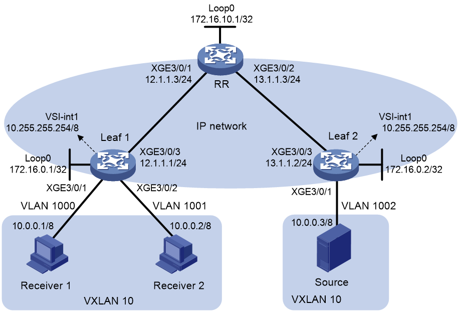

Example: Configuring Layer 2 EVPN multicast
As shown in Figure 1, configure Layer 2 EVPN multicast as follows:
·     Configure Leaf 1 and Leaf 2 as distributed EVPN gateways. Assign the multicast receivers attached to Leaf 1 and the multicast source attached to Leaf 2 to VXLAN 10.
·     Configure Leaf 1, Leaf 2, and the RR to set up BGP EVPN peer relationships in AS 65000 of the overlay network. Configure the RR to reflect BGP EVPN routes between Leaf 1 and Leaf 2.
·     Configure OSPF on Leaf 1, Leaf 2, and the RR for them to have Layer 3 connectivity on the underlay network.
Figure 1 Network diagram
Analysis
To enable Layer 2 multicast forwarding in the EVPN network, perform the following tasks:
·     Enable IGMP snooping on the leaf devices for them to snoop the IGMP membership reports sent by the multicast receivers.
·     For the leaf devices to create Layer 2 multicast forwarding entries, configure the leaf devices to advertise multicast group join requests through selective multicast Ethernet tag (SMET) routes.

Configuring Leaf 1
Assigning IP addresses and configuring unicast routing
# Assign IP addresses to loopback interfaces and Ten-GigabitEthernet 3/0/3.
<Sysname> system-view
[Sysname] sysname Leaf1
[Leaf1] interface loopback 0
[Leaf1-LoopBack0] ip address 172.16.0.1 255.255.255.255
[Leaf1-LoopBack0] quit
[Leaf1] interface ten-gigabitethernet 3/0/3
[Leaf1-Ten-GigabitEthernet3/0/3] port link-mode route
[Leaf1-Ten-GigabitEthernet3/0/3] ip address 12.1.1.1 24
[Leaf1-Ten-GigabitEthernet3/0/3] quit
# Configure OSPF for the devices to communicate at Layer 3 over the underlay network.
[Leaf1] router id 172.16.0.1
[Leaf1] ospf
[Leaf1-ospf-1] area 0
[Leaf1-ospf-1-area-0.0.0.0] network 172.16.0.1 0.0.0.0
[Leaf1-ospf-1-area-0.0.0.0] network 12.1.1.1 0.0.0.255
[Leaf1-ospf-1-area-0.0.0.0] quit
[Leaf1-ospf-1] quit
Configuring a VPN instance
# Create VPN instance vpn1 and configure an RD and route targets for it.
[Leaf1] ip vpn-instance vpn1
[Leaf1-vpn-instance-vpn1] route-distinguisher 1:1
[Leaf1-vpn-instance-vpn1] address-family ipv4
[Leaf1-vpn-ipv4-vpn1] vpn-target 2:2 import-extcommunity
[Leaf1-vpn-ipv4-vpn1] vpn-target 2:2 export-extcommunity
[Leaf1-vpn-ipv4-vpn1] quit
[Leaf1-vpn-instance-vpn1] address-family evpn
[Leaf1-vpn-evpn-vpn1] vpn-target 1:1 import-extcommunity
[Leaf1-vpn-evpn-vpn1] vpn-target 1:1 export-extcommunity
[Leaf1-vpn-evpn-vpn1] quit
[Leaf1-vpn-instance-vpn1] quit
Configuring a VSI interface
# Configure VSI interface 1.
[Leaf1] interface vsi-interface 1
[Leaf1-Vsi-interface1] ip binding vpn-instance vpn1
[Leaf1-Vsi-interface1] ip address 10.255.255.254 255.0.0.0
[Leaf1-Vsi-interface1] mac-address 0000-0001-0001
[Leaf1-Vsi-interface1] distributed-gateway local
[Leaf1-Vsi-interface1] quit
Configuring an EVPN instance
# Enable L2VPN.
[Leaf1] l2vpn enable
# Disable remote MAC address learning and remote ARP learning.
[Leaf1] vxlan tunnel mac-learning disable
[Leaf1] vxlan tunnel arp-learning disable
# Create VXLAN 10 on VSI vsi1, and specify VSI interface 1 as the gateway for the VXLAN.
[Leaf1] vsi vsi1
[Leaf1-vsi-vsi1] gateway vsi-interface 1
[Leaf1-vsi-vsi1] statistics enable
[Leaf1-vsi-vsi1] arp suppression enable
[Leaf1-vsi-vsi1] vxlan 10
[Leaf1-vsi-vsi1-vxlan-10] quit
# Configure an EVPN instance using VXLAN encapsulation, and configure an RD and route targets for it.
[Leaf1-vsi-vsi1] evpn encapsulation vxlan
[Leaf1-vsi-vsi1-evpn-vxlan] route-distinguisher auto
[Leaf1-vsi-vsi1-evpn-vxlan] vpn-target auto export-extcommunity
[Leaf1-vsi-vsi1-evpn-vxlan] vpn-target auto import-extcommunity
[Leaf1-vsi-vsi1-evpn-vxlan] quit
[Leaf1-vsi-vsi1] quit
Assigning L3 VXLAN IDs
# Assign a L3 VXLAN ID to VSI interface 2.
[Leaf1] interface vsi-interface 2
[Leaf1-Vsi-interface2] ip binding vpn-instance vpn1
[Leaf1-Vsi-interface2] l3-vni 10000
[Leaf1-Vsi-interface2] quit
Configuring BGP EVPN route advertisement
# Configure Leaf 1 to establish a BGP EVPN peer relationship with the RR.
[Leaf1] bgp 65000
[Leaf1-bgp-default] peer 172.16.10.1 as-number 65000
[Leaf1-bgp-default] peer 172.16.10.1 connect-interface loopback 0
[Leaf1-bgp-default] peer 172.16.10.1 password simple overlay
[Leaf1-bgp-default] address-family l2vpn evpn
[Leaf1-bgp-default-evpn] peer 172.16.10.1 enable
[Leaf1-bgp-default-evpn] quit
[Leaf1-bgp-default] quit
Mapping ACs to the VSI
# On Ten-GigabitEthernet 3/0/1, create Ethernet service instance 1 and map it to VSI vsi1.
[Leaf1] interface ten-gigabitethernet 3/0/1
[Leaf1-Ten-GigabitEthernet3/0/1] port link-mode bridge
[Leaf1-Ten-GigabitEthernet3/0/1] port link-type trunk
[Leaf1-Ten-GigabitEthernet3/0/1] undo port trunk permit vlan 1
[Leaf1-Ten-GigabitEthernet3/0/1] port trunk permit vlan 1000
[Leaf1-Ten-GigabitEthernet3/0/1] service-instance 1
[Leaf1-Ten-GigabitEthernet3/0/1-srv1] encapsulation s-vid 1000
[Leaf1-Ten-GigabitEthernet3/0/1-srv1] statistics enable
[Leaf1-Ten-GigabitEthernet3/0/1-srv1] xconnect vsi vsi1
[Leaf1-Ten-GigabitEthernet3/0/1-srv1] quit
[Leaf1-Ten-GigabitEthernet3/0/1] quit
# On Ten-GigabitEthernet 3/0/2, create Ethernet service instance 1 and map it to VSI vsi1.
[Leaf1] interface ten-gigabitethernet 3/0/2
[Leaf1-Ten-GigabitEthernet3/0/2] port link-mode bridge
[Leaf1-Ten-GigabitEthernet3/0/2] port link-type trunk
[Leaf1-Ten-GigabitEthernet3/0/2] undo port trunk permit vlan 1
[Leaf1-Ten-GigabitEthernet3/0/2] port trunk permit vlan 1001
[Leaf1-Ten-GigabitEthernet3/0/2] service-instance 1
[Leaf1-Ten-GigabitEthernet3/0/2-srv1] encapsulation s-vid 1001
[Leaf1-Ten-GigabitEthernet3/0/2-srv1] statistics enable
[Leaf1-Ten-GigabitEthernet3/0/2-srv1] xconnect vsi vsi1
[Leaf1-Ten-GigabitEthernet3/0/2-srv1] quit
[Leaf1-Ten-GigabitEthernet3/0/2] quit
Configuring IGMP snooping
# Enable IGMP snooping globally.
[Leaf1] igmp-snooping
[Leaf1-igmp-snooping] global-enable
[Leaf1-igmp-snooping] quit
# Configure IGMP snooping for VSI vsi1.
[Leaf1] vsi vsi1
[Leaf1-vsi-vsi1] igmp-snooping enable
[Leaf1-vsi-vsi1] igmp-snooping drop-unknown
[Leaf1-vsi-vsi1] igmp-snooping proxy enable
# Configure Leaf 2 as an IGMP querier.
[Leaf1-vsi-vsi1] igmp-snooping querier

[Leaf2-Vsi-interface10000] l3-vni 10000
[Leaf2-Vsi-interface10000] quit
# Configure Leaf 2 to establish a BGP EVPN peer relationship with the RR.
[Leaf2] bgp 65000
[Leaf2-bgp-default] peer 172.16.10.1 as-number 65000
[Leaf2-bgp-default] peer 172.16.10.1 connect-interface loopback 0
[Leaf2-bgp-default] peer 172.16.10.1 password simple overlay
[Leaf2-bgp-default] address-family l2vpn evpn
[Leaf2-bgp-default-evpn] peer 172.16.10.1 enable
[Leaf2-bgp-default-evpn] quit
[Leaf2-bgp-default] quit
[Leaf2] interface ten-gigabitethernet 3/0/1
[Leaf2-Ten-GigabitEthernet3/0/1] port link-mode bridge
[Leaf2-Ten-GigabitEthernet3/0/1] port link-type trunk
[Leaf2-Ten-GigabitEthernet3/0/1] undo port trunk permit vlan 1
[Leaf2-Ten-GigabitEthernet3/0/1] port trunk permit vlan 1002
[Leaf2-Ten-GigabitEthernet3/0/1] storm-constrain control shutdown
[Leaf2-Ten-GigabitEthernet3/0/1] service-instance 1
[Leaf2-Ten-GigabitEthernet3/0/1-srv1] encapsulation s-vid 1002
[Leaf2-Ten-GigabitEthernet3/0/1-srv1] statistics enable
[Leaf2-Ten-GigabitEthernet3/0/1-srv1] xconnect vsi vsi1
[Leaf2-Ten-GigabitEthernet3/0/1-srv1] quit
[Leaf2-Ten-GigabitEthernet3/0/1] quit
[Leaf2] vsi vsi1
[Leaf2-vsi-vsi1] igmp-snooping enable
[Leaf2-vsi-vsi1] igmp-snooping drop-unknown
[Leaf2-vsi-vsi1] igmp-snooping proxy enable
[Leaf2-vsi-vsi1] igmp-snooping querier
[Leaf2-vsi-vsi1] quit

Verifying IGMP snooping and SMET routes
# Verify that IGMP snooping is enabled on a per-VSI basis on the leaf devices.
[Leaf1] display igmp-snooping vsi vsi1
IGMP snooping information: VSI vsi1
 IGMP snooping: Enabled
 Forwarding mode: IP
 Drop-unknown: Enabled
 Version: 2
 Host-aging-time: 260s
 Router-aging-time: 260s
 Max-response-time: 10s
 Last-member-query-interval: 1s
 Querier: Enabled (IP:10.255.255.254, Expires: 00:01:39)
 Querier-election: Disabled
 Query-interval: 125s
 General-query source IP: 10.255.255.254
 Special-query source IP: 10.255.255.254
 Report source IP: 10.255.255.254
 Leave source IP: 10.255.255.254
 Proxy: Enabled
 IPP: -(Link ID: 0xffff)
# Verify that Leaf 1 has a dynamic IGMP snooping group entry for multicast group (0.0.0.0, 225.0.0.1).
[Leaf1] display igmp-snooping group
Total 1 entries.
VSI vsi1: Total 1 entries.
    Host ports (1 in total):
      XGE3/0/1 (Link ID 0)                        (00:03:42)
# Verify that Leaf 1 has created an SMET route.
[Leaf1] display evpn route smet
VSI name: vsi1
  Source address :
  Group address  : 225.0.0.1
  Local version  : v2
  ACs   :
    AC                               Link ID    Flags
    XGE3/0/1 srv1                    0          Local
# Verify that Leaf 2 has received the SMET route created by Leaf 1.
[Leaf2] display evpn route smet
VSI name: vsi1
  Source address :
  Local version  : -
  Peers :
    Nexthop          Tunnel name     Link ID    Remote version
    172.16.0.1       Tunnel0         0x5000000  v2
[Leaf2] display igmp-snooping evpn-group
Total 1 entries.
      Tun0 (VXLAN ID 10)
