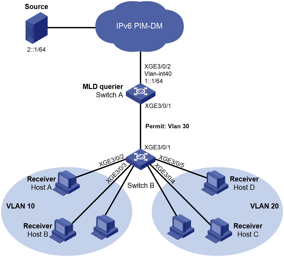

Example: Configuring sub-VLAN-based IPv6 multicast VLANs
As shown in Figure 1:
·     VLAN 10 and VLAN 20 are Department 1 and Department 2, respectively.
·     VLAN-interface 10 and VLAN-interface 20 on Layer 3 device Switch A are the gateways of VLAN 10 and VLAN 20, respectively.
·     MLDv1 runs in VLAN 10 on Switch A, and MLDv1 snooping runs in VLAN 10 on Layer 2 device Switch B.
·     The source sends IPv6 multicast data to IPv6 multicast group FF1E::101.
·     Host A and Host B in VLAN 10 join IPv6 multicast group FF1E::101. They can receive the IPv6 multicast data that the source sends to the group.
Figure 1 Network diagram
Now, Host C and Host D in VLAN 20 also join the group to receive the IPv6 multicast data, as shown in Figure 2. You can enable MLDv1 for VLAN 20 on Switch A and MLDv1 snooping for VLAN 20 on Switch B. In this way, Host C and Host D can receive the data addressed to the group. However, this occupies a large amount of bandwidth and increases the burden on Switch A.

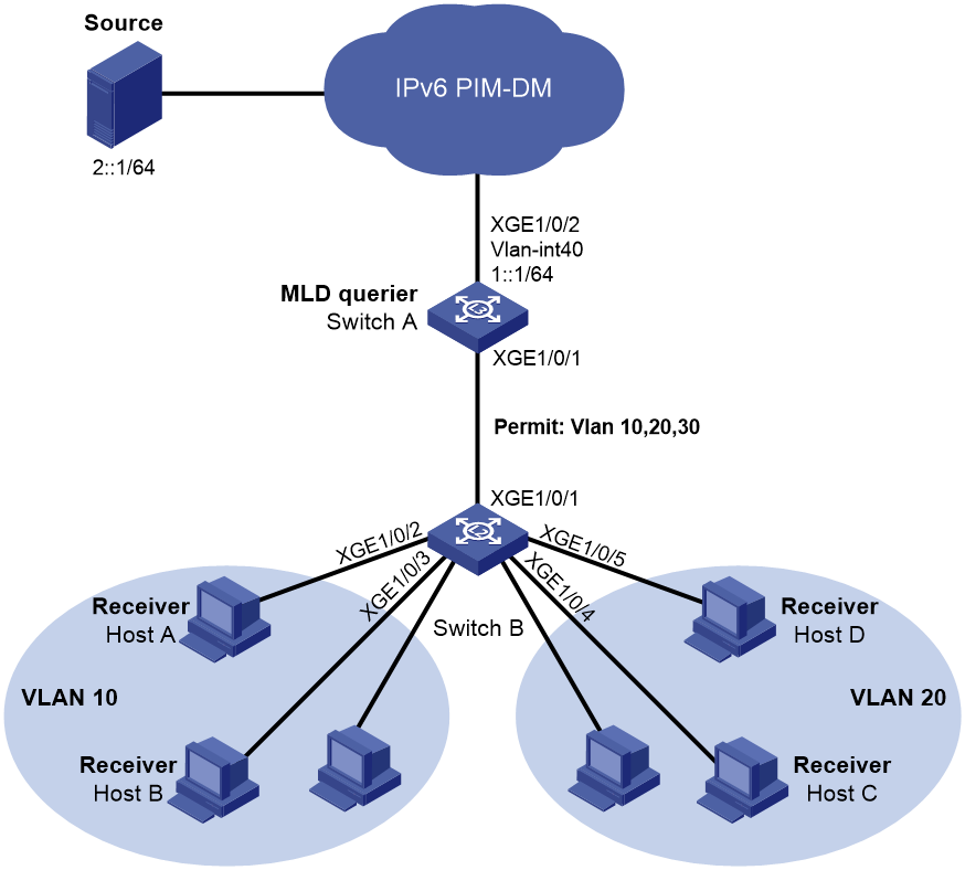

To avoid the problems, you can configure a sub-VLAN-based IPv6 multicast VLAN on Switch B.
Figure 2 Network diagram
Analysis
To meet the network requirements, you must perform the following tasks:
·     Create VLAN 30 on Switch A and Switch B, and assign Ten-GigabitEthernet 3/0/1 on them to VLAN 30 as tagged VLAN members.
·     Create VLAN-interface 30 on Switch A, and enable MLD on the interface.
·     Enable MLD snooping for VLAN 10 through VLAN 30 on Switch B.
·     Configure VLAN 30 on Switch B as an IPv6 multicast VLAN, and assign VLAN 10 and VLAN 20 to IPv6 multicast VLAN 30 as sub-VLANs.
