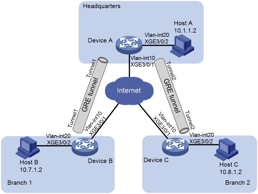

As shown in Figure 1, Device A is the gateway of the headquarters. Device B and Device C are the gateways of Branch 1 and Branch 2, respectively. The gateways have obtained public IP addresses from an ISP and can communicate with one another. Configure GRE with OSPF to meet the following requirements:
·     The headquarters and the branches communicate with one another through the GRE tunnels established between the headquarters and the branches.
·     The gateways learn the routes reaching the destination networks through the tunnel interfaces.
Figure 1 Network diagram

Procedures
Before configuring GRE and OSPF, configure an IPv4 routing protocol on the gateways so that they can reach one another. (Details not shown.)
