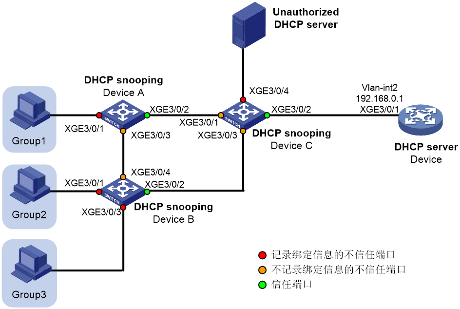

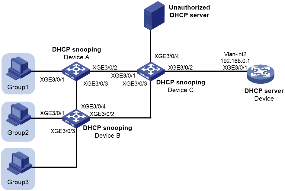

As shown in Figure 1, three groups of hosts are connected to the DHCP server through the DHCP snooping devices. Configure DHCP snooping and DHCP server to meet the following requirements:
·     Hosts in each group obtain IP addresses from the address range assigned to the group. Assign address ranges to the groups as follows:
¡     Address range 192.168.0.2 to 192.168.0.39 for Group 1.
¡     Address range 192.168.0.40 to 192.168.0.99 for Group 2.
¡     Address range 192.168.0.100 to 192.168.0.200 for Group 3.
·     The hosts can obtain IP addresses only from the authorized DHCP server.
·     The hosts cannot access the network through IP addresses that are manually configured.
Figure 1 Network diagram

·     To make sure the hosts obtain addresses only from the authorized DHCP server, configure ports facing the server as trusted and other ports as untrusted, as shown in Figure 2.

Figure 2 Trusted and untrusted ports

# Verify that the hosts in each group can obtain IP addresses from the address range assigned to the group. This example uses a host in Group 2 to verify the configuration.
C:\Documents and Settings\Administrator>ipconfig
Windows IP Configuration
Ethernet adapter bb:
   Connection-specific DNS Suffix  . :
   IP Address. . . . . . . . . . . . : 192.168.0.44
   Subnet Mask . . . . . . . . . . . : 255.255.255.0
   Default Gateway . . . . . . . . . :
# Manually assign IP address 192.168.0.66 to a host in Group 2, and verify that it cannot access the external network. (Details not shown.)
