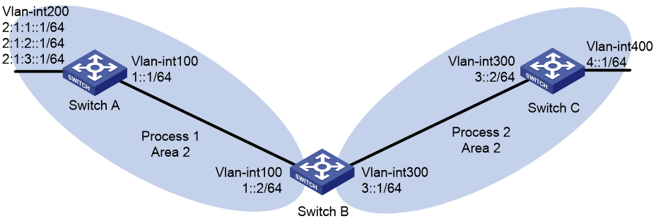

Enabling OSPFv3
To enable an OSPFv3 process on a router:
1.     Enable the OSPFv3 process globally.
2.     Assign the OSPFv3 process a router ID.
3.     Enable the OSPFv3 process on related interfaces.
An OSPFv3 process ID has only local significance. Process 1 on a router can exchange packets with process 2 on another router.
OSPFv3 requires you to manually specify a router ID for each router in an AS. Make sure all assigned router IDs in the AS are unique.
Restrictions and guideline
If a router runs multiple OSPFv3 processes, you must specify a unique router ID for each process.
2.     Enable an OSPFv3 process and enter its view.
ospfv3 [ process-id | vpn-instance vpn-instance-name ] *
By default, no OSPFv3 processes are enabled.
3.     Specify a router ID.
router-id router-id
By default, no router ID is configured.
4.     (Optional.) Configure a description for the OSPFv3 process.
description text
By default, no description is configured for an OSPFv3 process.
To identify and manage different OSPFv3 processes, configure a unique description for each process.
5.     Return to system view.
6.     Enter interface view.
7.     Enable an OSPFv3 process on the interface.
ospfv3 process-id area area-id [ instance instance-id ]

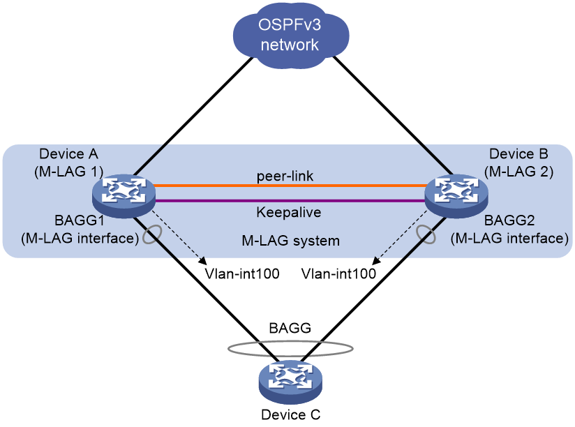

When a customer-side device accesses the OSPFv3 network through both M-LAG member devices in an M-LAG system, the M-LAG member devices provide Layer 3 gateway services. The gateway interfaces (such as VLAN or VSI interfaces) on different M-LAG member devices might generate the same link-local address because they have the same IP address and MAC address. In this case, the M-LAG member devices cannot establish OSPFv3 neighbor relationships with the customer-side device.
To resolve this issue, configure the gateway interfaces to use M-LAG virtual IPv6 addresses for OSPFv3 neighbor relationship establishment. The M-LAG virtual IPv6 address configured for a gateway interface must be a link-local address because OSPFv3 uses link-local addresses for OSPFv3 neighbor relationship establishment. For more information about M-LAG, see M-LAG configuration in Layer 2—LAN Switching Configuration Guide.
As shown in Figure 1, Device C accesses the OSPFv3 network through the M-LAG system that consists of Device A and Device B. Device A and Device B provide Layer 3 gateway services. The gateway interface VLAN-interface 100 on Device A and the gateway interface VLAN-interface 100 on Device B have the same IP address and the same MAC address. To ensure that both Device A and Device B can establish an OSPFv3 neighbor relationship with Device C, configure different M-LAG virtual IPv6 addresses for the VLAN interfaces on Device A and Device B.
Figure 1 OSPFv3 neighbor relationship establishment on an M-LAG network

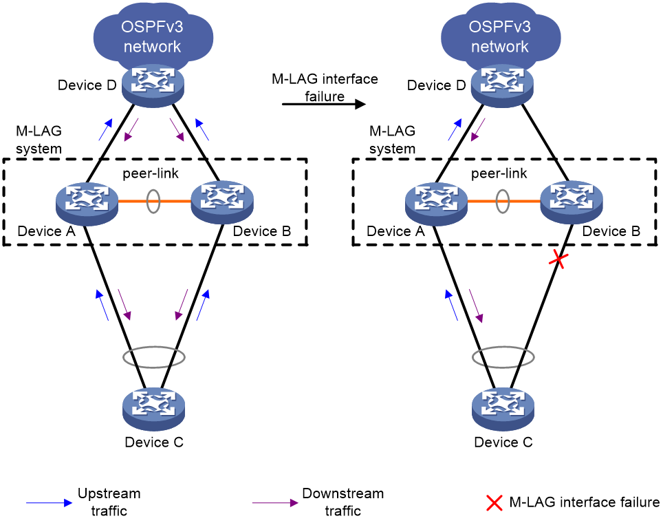

When a customer side device is dual-homed to an OSPFv3 network through M-LAG, you can configure this feature to prevent the traffic from detouring through the peer link. As shown in Figure 2, customer-side device Device C is dual-homed to the OSPFv3 network through an M-LAG system formed by Device A and Device B. Device A and Device B share the traffic load between Device D and Device C. When the M-LAG interface that connects Device B to Device C fails, the upstream traffic and downstream traffic are forwarded as follows:
·     Device C detects the M-LAG interface failure, and traffic from Device C to Device D is switched from path Device C->Device B->Device D to path Device C->Device A->Device D.
·     Device D cannot detect the M-LAG interface failure and still forwards traffic through Device B. Because the link between Device B and Device C fails, traffic from Device D to Device C is switched from path Device D->Device B->Device C to path Device D->Device B->Device A->Device C.
Figure 2 Traffic forwarding path after M-LAG interface failure

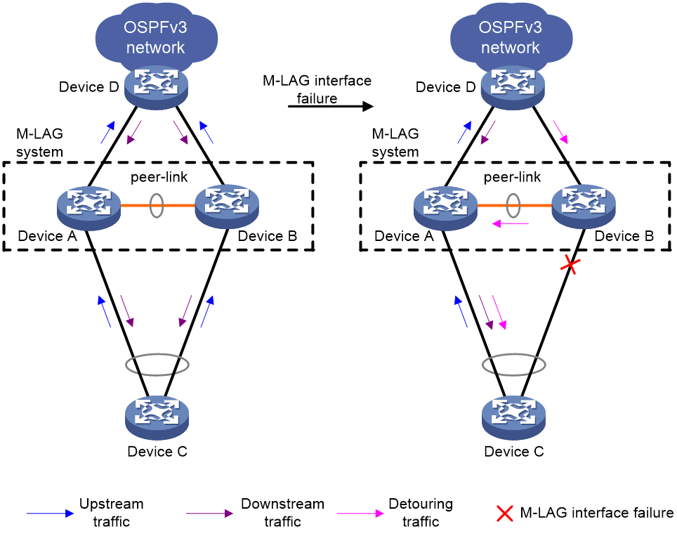

To prevent the downstream traffic from detouring through the peer link, perform the following tasks on Device B:
1.     Execute the track interface command to create a track entry and associate it with the link state of the M-LAG interface. For more information about the track interface command, see track commands in High Availability Command Reference.
2.     Execute the ospfv3 track adjust-cost command to associate the gateway interface with the track entry.
Then, Device B adjusts the cost of the gateway interface based on the state of the associated track entry:
·     When the M-LAG interface fails, the track entry state becomes negative, and OSPFv3 increases the cost of the gateway interface. Then, traffic from Device D to Device C is switched to path Device D->Device A->Device C.
·     When the M-LAG interface restores, the track entry state becomes positive, and OSPFv3 restores the cost of the gateway interface to the original value. Then, traffic from Device D to Device C is switched back to path Device D->Device B->Device C.
Figure 3 Traffic forwarding path after associating OSPFv3 with Track

Example: Configuring OSPFv3 route redistribution
As shown in Figure 8:
·     Switch A, Switch B, and Switch C are in Area 2.
·     OSPFv3 process 1 and OSPFv3 process 2 run on Switch B. Switch B communicates with Switch A and Switch C through OSPFv3 process 1 and OSPFv3 process 2.

Example: Configuring OSPFv3 route summarization
As shown in Figure 9:
·     OSPFv3 process 1 and OSPFv3 process 2 run on Switch B. Switch B communicates with Switch A and Switch C through OSPFv3 process 1 and OSPFv3 process 2, respectively.
·     On Switch A, configure IPv6 addresses 2:1:1::1/64, 2:1:2::1/64, and 2:1:3::1/64 for VLAN-interface 200.
·     On Switch B, configure OSPFv3 process 2 to redistribute direct routes and the routes from OSPFv3 process 1. Switch C can then learn the routes destined for 2::/64, 2:1:1::/64, 2:1:2::/64, and 2:1:3::/64.
·     On Switch B, configure route summarization to advertise only summary route 2::/16 to Switch C.
Figure 9 Network diagram
1.     Configure IPv6 addresses for interfaces. (Details not shown.)
2.     Configure OSPFv3:

3.     Configure OSPFv3 route redistribution:
# Configure OSPFv3 process 2 to redistribute direct routes and the routes from OSPFv3 process 1 on Switch B.
[SwitchB] ospfv3 2
[SwitchB-ospfv3-2] import-route ospfv3 1
[SwitchB-ospfv3-2] import-route direct
[SwitchB-ospfv3-2] quit

4.     Configure ASBR route summarization:
# On Switch B, configure OSPFv3 process 2 to advertise a single route 2::/16.
[SwitchB] ospfv3 2
[SwitchB-ospfv3-2] asbr-summary 2:: 16
