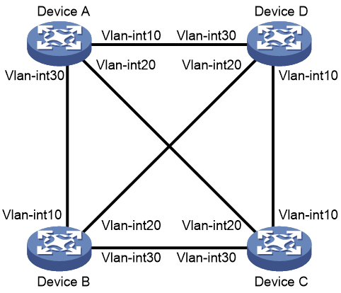

As shown in Figure 4, the same level routers on a network, including non-DIS routers, establish adjacency with each other.
Figure 4 DIS in the IS-IS broadcast network
The DIS creates and updates pseudonodes, and generates LSPs for the pseudonodes, to describe all routers on the network.
A pseudonode represents a virtual node on the broadcast network. It is not a real router. In IS-IS, it is identified by the system ID of the DIS and a 1-byte Circuit ID (a non-zero value).
Using pseudonodes simplifies network topology and can reduce the amount of resources consumed by SPF.
On an IS-IS broadcast network, all routers establish adjacency relationships, but they synchronize their LSDBs through the DIS.

Configuring IPv6 IS-IS MTR
On a network, IPv4 and IPv6 topologies must be consistent so that both IPv6 IS-IS and IPv4 IS-IS can use the SPF algorithm to perform route calculation. If they are different, routers supporting both IPv4 and IPv6 might send IPv6 packets to routers that do not support IPv6, resulting in packet loss.
To resolve this issue, configure IPv6 IS-IS MTR to perform route calculation separately in IPv4 and IPv6 topologies.
Figure 7 Network diagram
As shown in Figure 7, the numbers refer to the link costs. Router A, Router B, and Router D support both IPv4 and IPv6. Router C supports only IPv4 and cannot forward IPv6 packets.
Enable IPv6 IS-IS MTR on Router A, Router B, Router C, and Router D to make them perform route calculation separately in IPv4 and IPv6 topologies. With this configuration, Router A does not forward IPv6 packets destined to Router D through Router B, avoiding packet loss.
As a best practice to avoid route calculation failures, configure this feature when both IPv4 and IPv6 topologies exist in the network.

Limiting LSP flooding
On a fully meshed network, many P2P links exist. As shown in Figure 8, Devices A, B, C and D run IS-IS. When Device A generates an LSP, it floods the LSP out of VLAN-interface 10, VLAN-interface 20, and VLAN-interface 30. After Device D receives the LSP from VLAN-interface 30, it floods it out of VLAN-interface 10 and VLAN-interface 20 to Device B and Device C. However, Device B and Device C have already received the LSP from Device A. Repeated LSP flooding consumes extra bandwidth.
Figure 8 Network diagram of a fully meshed network
To avoid this problem, you can add interfaces to a mesh group or block some interfaces.
·     An interface in a mesh group floods a received LSP only to interfaces not in the mesh group.
·     A blocked interface sends LSPs only after receiving LSP requests.
Before you configure this task, you must consider redundancy for interfaces in case LSP packets cannot be flooded because of link failures.

A link or router failure on a path can cause packet loss. IS-IS LFA FRR enables fast rerouting to minimize the failover time.
Figure 9 Network diagram for IS-IS LFA FRR
In Figure 9, after you enable LFA FRR on Router B, IS-IS automatically calculates or designates a backup next hop when a link failure is detected. In this way, packets are directed to the backup next hop to reduce traffic recovery time. Meanwhile, IS-IS calculates the shortest path based on the new network topology, and forwards packets over the path after network convergence.
You can assign a backup next hop for IS-IS FRR through the following ways:
·     Enable IS-IS LFA FRR to calculate a backup next hop through LFA calculation.
·     Designate a backup next hop with a routing policy for routes matching specific criteria.
The LFA calculation of FRR and that of TE are mutually exclusive.

Example: Configuring DIS election
As shown in Figure 12, Switches A, B, C, and D reside in IS-IS area 10 on a broadcast network (Ethernet). Switch A and Switch B are Level-1-2 switches, Switch C is a Level-1 switch, and Switch D is a Level-2 switch.
Change the DIS priority of Switch A to make it elected as the Level-1-2 DIS router.
Figure 12 Network diagram

Example: Configuring IS-IS authentication
As shown in Figure 14, Switch A, Switch B, Switch C, and Switch D reside in the same IS-IS routing domain. Run IS-IS among them.
Switch A, Switch B, and Switch C belong to Area 10, and Switch D belongs to Area 20.
·     Configure neighbor relationship authentication between neighbors.
·     Configure area authentication in Area 10 to prevent untrusted routes from entering into the area.
·     Configure routing domain authentication on Switch C and Switch D to prevent untrusted routes from entering the routing domain.
Figure 14 Network diagram
1.     Configure IP addresses for interfaces. (Details not shown.)

Example: Configuring BFD for IS-IS
·     As shown in Figure 17, run IS-IS on Switch A, Switch B and Switch C so that they can reach each other at the network layer.
·     After the link over which Switch A and Switch B communicate through the Layer-2 switch fails, BFD can quickly detect the failure and notify IS-IS of the failure. Switch A and Switch B then communicate through Switch C.
Figure 17 Network diagram
Table 4 Interface and IP address assignment
Device
Interface
IP address
Device
Interface
IP address
Switch A
Vlan-int10
10.1.0.102/24
Switch B
Vlan-int10
10.1.0.100/24
Vlan-int11
11.1.1.1/24
Vlan-int13
13.1.1.1/24
Loop0
121.1.1.1/32
Loop0
120.1.1.1/32
Switch C
Vlan-int11
11.1.1.2/24
Vlan-int13
13.1.1.2/24

3.     Configure BFD functions:
# Enable BFD and configure BFD parameters on Switch A.
[SwitchA-Vlan-interface10] isis bfd enable
[SwitchA-Vlan-interface10] bfd min-control-interval 500
[SwitchA-Vlan-interface10] bfd detect-multiplier 7
# Enable BFD and configure BFD parameters on Switch B.
[SwitchB] interface vlan-interface 10
[SwitchB-Vlan-interface10] isis bfd enable
[SwitchB-Vlan-interface10] bfd min-control-interval 500
[SwitchB-Vlan-interface10] bfd detect-multiplier 8
[SwitchB-Vlan-interface10] quit
# Display the BFD session information on Switch A.
[SwitchA] display bfd session
 Total Session Num: 1     Up Session Num: 1     Init Mode: Active
 IPv4 session working in control packet mode:
 LD/RD          SourceAddr      DestAddr        State    Holdtime    Interface
 3/1            192.168.0.102   192.168.0.100   Up       1700ms      Vlan10
# Display routes destined for 120.1.1.1/32 on Switch A.
[SwitchA] display ip routing-table 120.1.1.1 verbose
Summary count : 1
Destination: 120.1.1.1/32
   Protocol: IS_L1
 Process ID: 1
  SubProtID: 0x1                    Age: 04h20m37s
       Cost: 10              Preference: 10
      IpPre: N/A             QosLocalID: N/A
        Tag: 0                    State: Active Adv
  OrigTblID: 0x0                OrigVrf: default-vrf
    TableID: 0x2                 OrigAs: 0
      NibID: 0x26000002          LastAs: 0
     AttrID: 0xffffffff        Neighbor: 0.0.0.0
      Flags: 0x1008c        OrigNextHop: 192.168.0.100
      Label: NULL           RealNextHop: 192.168.0.100
    BkLabel: NULL             BkNextHop: N/A
    SRLabel: NULL             BkSRLabel: NULL
   SIDIndex: NULL               InLabel: NULL
  Tunnel ID: Invalid          Interface: Vlan-interface10
BkTunnel ID: Invalid        BkInterface: N/A
   FtnIndex: 0x0           TrafficIndex: N/A
  Connector: N/A                 PathID: 0x0
   LinkCost: 0               MicroSegID: 0
RealFIRType: Normal           RealThres: 0
The output shows that Switch A and Switch B communicate through VLAN-interface 10. Then the link over VLAN-interface 10 fails.

IPv6 IS-IS configuration examples
Example: Configuring IPv6 IS-IS basics
As shown in Figure 20, Switch A, Switch B, Switch C, and Switch D, all enabled with IPv6, reside in the same AS. Configure IPv6 IS-IS on the switches so that they can reach each other.
Switch A and Switch B are Level-1 switches, Switch D is a Level-2 switch, and Switch C is a Level-1-2 switch.
Figure 20 Network diagram
1.     Configure IPv6 addresses for interfaces. (Details not shown.)
2.     Configure IPv6 IS-IS:

Example: Configuring BFD for IPv6 IS-IS
As shown in Figure 21:
·     Configure IPv6 IS-IS on Switch A and Switch B so that they can reach other.
·     Enable BFD on VLAN-interface 10 of Switch A and Switch B.
After the link between Switch B and the Layer 2 switch fails, BFD can quickly detect the failure and notify IPv6 IS-IS of the failure. Then Switch A and Switch B communicate through Switch C.
Figure 21 Network diagram
Table 7 Interface and IP address assignment
# Configure Switch A.
