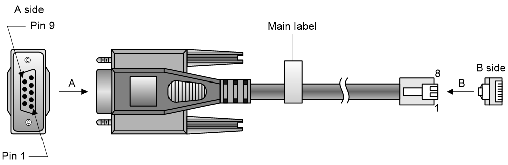

04042967
DB9-to-RJ45 console cable
1, optional
All switch models

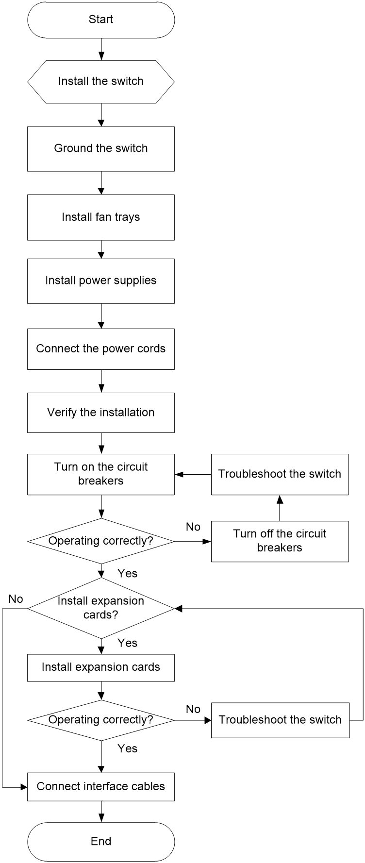

Figure2-1 Hardware installation flow

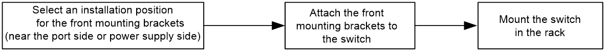

Installation procedure at a glance
Figure2-2 Procedure for installing the switch in a 19-inch rack by using front mounting brackets

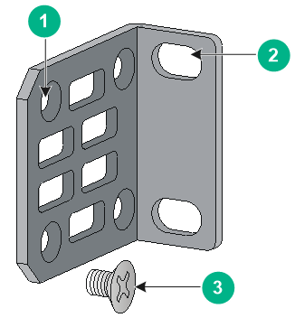

Figure2-4 Front mounting bracket
(1) Screw hole for attaching the bracket to the switch
(2) Screw hole for attaching the bracket to the rack
(3) M4 screw

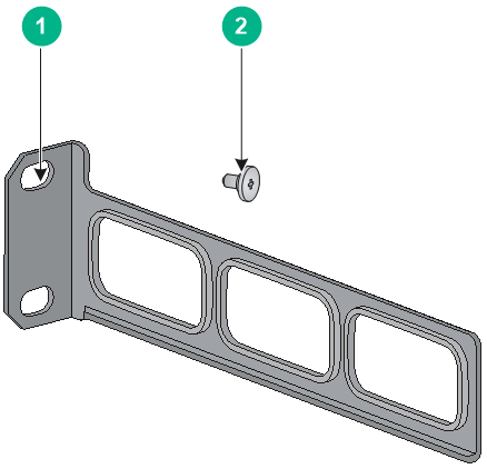

Figure2-5 Rear mounting bracket and shoulder screw
(1) Screw hole for attaching the bracket to the rack
(2) Shoulder screw

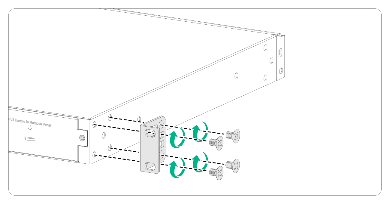

Rack-mounting the switch by using only front mounting brackets
All switch models except the S6520X-54HC-UPWR-EI support rack mounting by using only front mounting brackets.
Attaching the front mounting brackets to the switch
The switch has one mounting position near the network ports and the other mounting position near the power supplies for the front mounting brackets. Select one position as needed.
To attach the front mounting brackets to the chassis:
1.     Place the wide flange of the mounting bracket against the chassis side panel. Align the mounting bracket installation holes with the screw holes in the chassis.
¡     To install the mounting brackets at the port-side mounting position, see Figure2-6.
¡     To install the mounting brackets at the power supply-side mounting position, see Figure2-7.
2.     Fasten the M4 screws to secure the mounting bracket to the switch.
3.     Attach the front mounting bracket to the other side of the chassis in the same way.
Figure2-6 Attaching the front mounting brackets to the port-side mounting position (S6520X-30HF-EI switch as an example)
Figure2-7 Attaching the front mounting brackets to the power supply-side mounting position (S6520X-30HF-EI switch as an example)

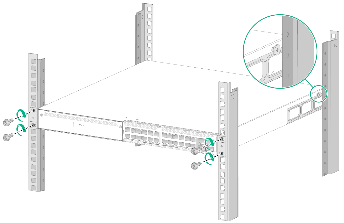

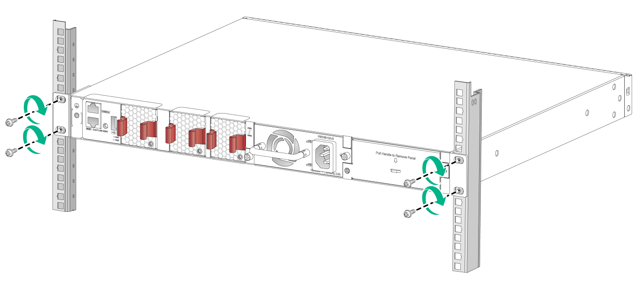

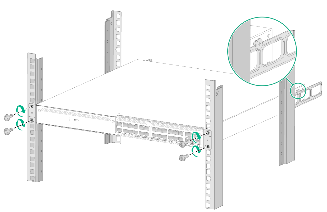

Mounting the switch in the rack
This task requires two people.

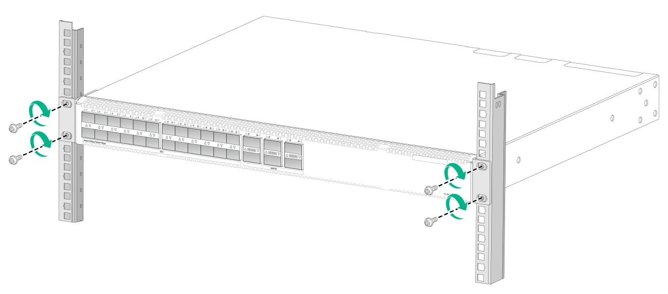

To mount the switch in the rack:
1.     Wear an ESD wrist strap and make sure it makes good skin contact and is reliably grounded.
2.     Verify that the front mounting brackets have been securely attached to the switch chassis. See "Attaching the front mounting brackets to the switch."
3.     Attach cage nuts to the front rack posts.
4.     One person supports the bottom of the switch, and moves the switch to an appropriate position based on the installation positions of the front mounting brackets.
5.     Another person uses M6 screws and cage nuts to attach the mounting brackets to the rack and verifies that the brackets are level and secure.
Figure2-8 Mounting the switch in the rack (port-side mounting position for the front mounting brackets, S6520X-30HF-EI switch as an example)
Figure2-9 Mounting the switch in the rack (power supply-side mounting position for the front mounting brackets, S6520X-30HF-EI switch as an example)

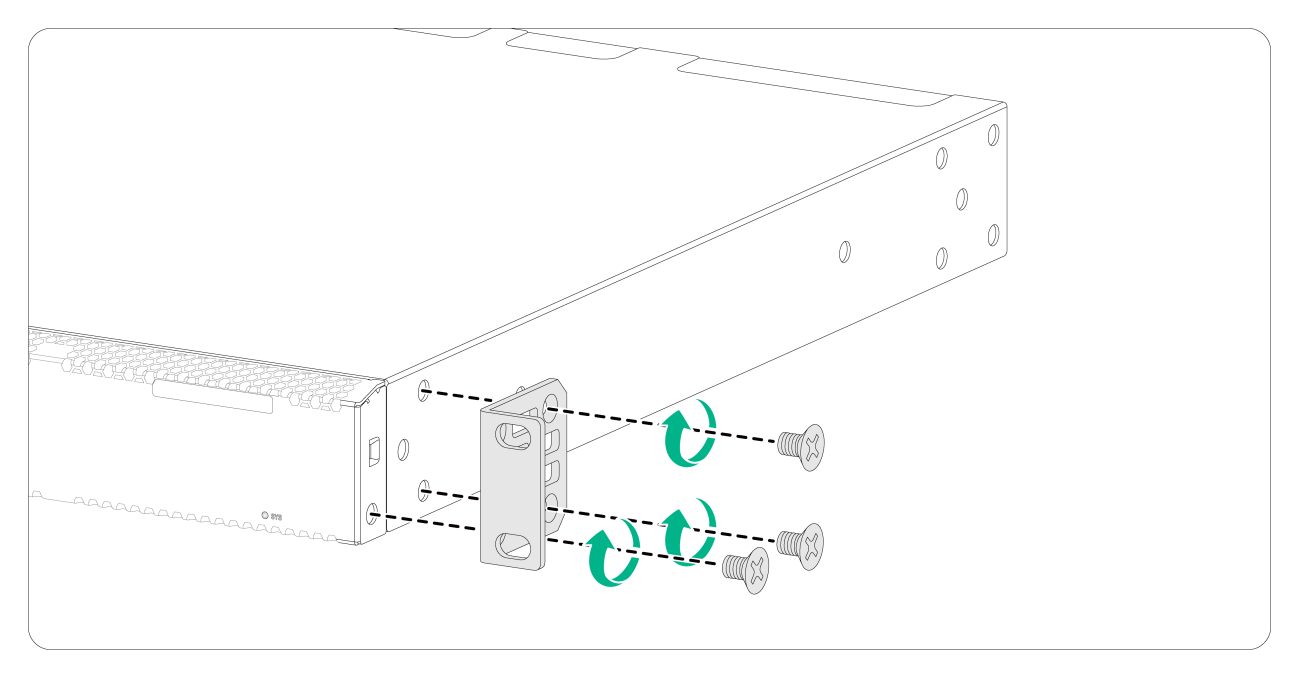

Rack-mounting the switch by using front and rear mounting brackets

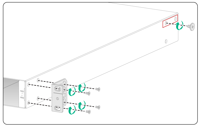

Attaching the front mounting brackets and shoulder screws to the switch
The switch provides two installation positions on its side for the front mounting brackets. One is near the power supply side and one is near the port side. The following procedure attaches the front mounting brackets to the installation position near the power supply side. The port-side mounting is similar.
To attach the front mounting brackets and shoulder screws to the switch:
1.     Wear an ESD wrist strap. Make sure the strap makes good skin contact and is reliably grounded.
2.     Align the round holes in the wide flange of one front mounting bracket with the screw holes in the chassis. See Figure2-10.
3.     Use M4 screws (supplied with the switch) to attach the mounting bracket to the chassis.
4.     Repeat the preceding two steps to attach the other mounting bracket to the chassis.
5.     Unpack the shoulder screws and attach them to the chassis.
Two installation positions as red-marked in Figure2-10 are available for shoulder screws. Select one as required.
Figure2-10 Attaching the front mounting brackets and shoulder screws to the chassis

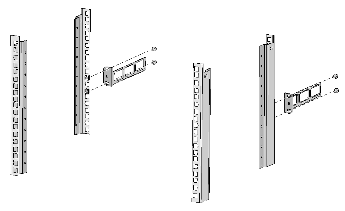

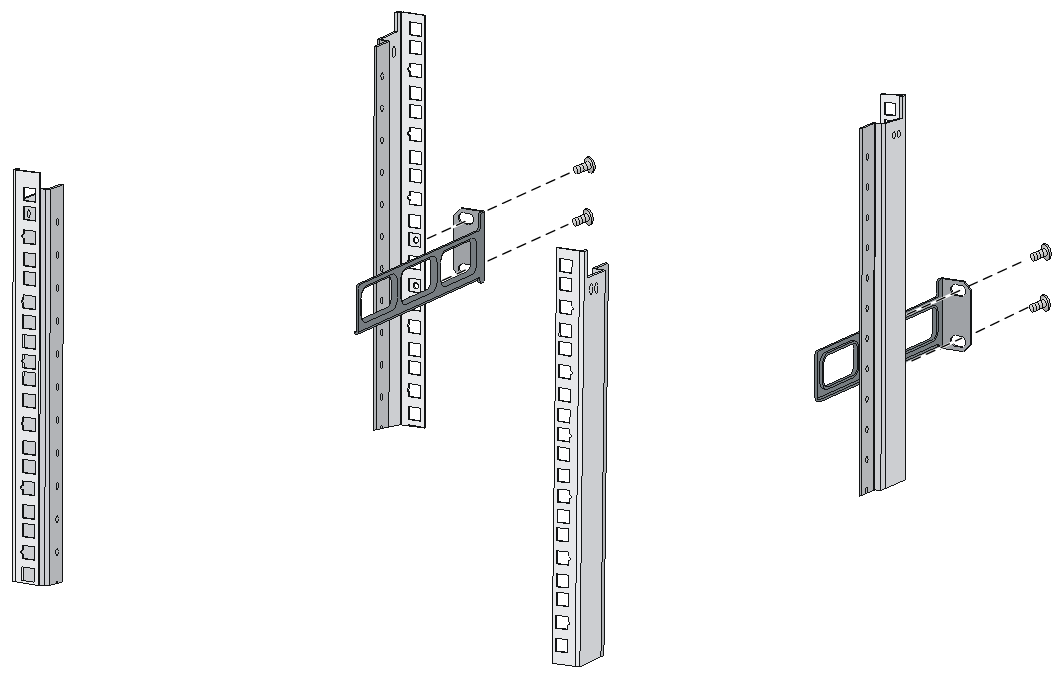

Attaching the rear mounting brackets to the rack
1.     Determine the switch installation position in the rack.
2.     Install cage nuts (user-supplied) in the rear rack posts. Make sure the corresponding cage nuts on the left and right rear rack posts are at the same height.
3.     Orient the rear mounting brackets with the wide flange inside or outside the rack as required.
4.     Use M6 screws (user-supplied) to attach the rear mounting brackets to the rear posts, as shown in Figure2-11.
Do not fully tighten the M6 screws before mounting the switch in the rack.
Figure2-11 Attaching the rear mounting brackets to the rack with the wide flange inside the rack
Figure2-12 Attaching the rear mounting brackets to the rack with the wide flange outside the rack
2.     Make sure the front mounting brackets and shoulder screws are securely attached to the two sides of the switch.
3.     Attach cage nuts (user-supplied) to the front rack posts. Make sure the corresponding cage nuts on the left and right front rack posts are at the same height.
4.     One person supports the chassis bottom with one hand, holds the front part of the chassis with the other, and pushes the chassis into the rack gently. Make sure the shoulder screws rest firmly on the upper edge of the rear mounting brackets. See Figure2-13 and Figure2-14.
5.     The other person attaches the front mounting brackets with M6 screws (user-supplied) to the front rack posts. Make sure the switch is installed securely in the rack. See Figure2-13 and Figure2-14.
Figure2-13 Mounting the switch in the rack (with the wide flange of the rear mounting brackets inside the rack)
Figure2-14 Mounting the switch in the rack (with the wide flange of the rear mounting brackets outside the rack)

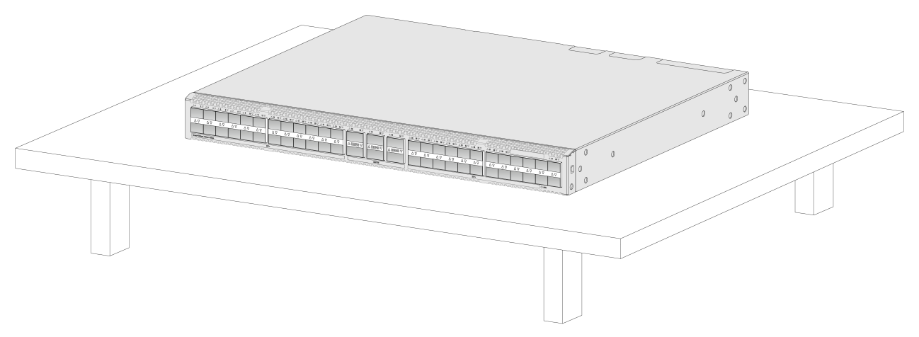

Mounting the switch on a workbench
IMPORTANT
IMPORTANT:
·     Reserve a minimum clearance of 10 cm (3.9 in) around the chassis for heat dissipation.
·     Do not place heavy objects on the switch.
To mount the switch on a workbench:
1.     Verify that the workbench is sturdy and reliably grounded.
2.     Place the switch with bottom up, and clean the round holes in the chassis bottom with dry cloth.

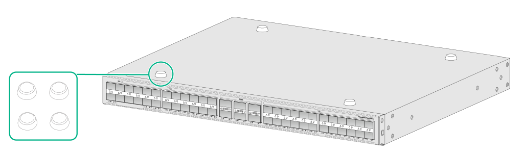

3.     Attach the rubber feet to the four round holes in the chassis bottom.
4.     Place the switch with upside up on the workbench.
Figure2-15 Mounting the switch on a workbench (1) (S6520X-54HF-EI switch as an example)
Figure2-16 Mounting the switch on a workbench (2) (S6520X-54HF-EI switch as an example)

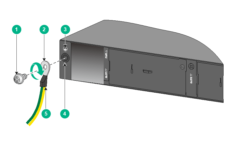

If a grounding strip is available at the installation site, use the grounding cable provided with the switch to connect the switch to the grounding strip.
Connecting the grounding cable to the chassis
1.     Remove the grounding screw from the grounding hole in the chassis.
2.     Use the grounding screw to attach the ring terminal of the grounding cable to the grounding screw hole. Fasten the screw.
IMPORTANT
IMPORTANT:
Orient the grounding cable as shown in Figure2-17 so that you can easily install or remove the removable components.
Figure2-17 Connecting the grounding cable to the chassis
(1) Grounding screw
(2) Ring terminal
(3) Grounding sign
(4) Grounding hole
(5) Grounding cable

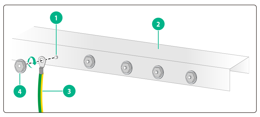

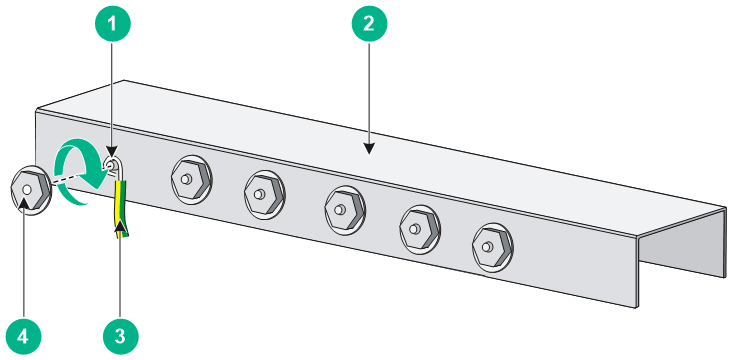

Connecting the grounding cable to a grounding strip
Use either of the following methods to connect the grounding cable to a grounding strip in the equipment room:
·     Method 1
a.     Use needle-nose pliers to bend the bare metal part to the shape as shown in Figure2-18. Make sure the bended part can securely attached to the grounding post on the grounding strip.
b.     Attach the bended part of the grounding cable to the grounding post and use the hex nut to fasten the bended part to the post.
Figure2-18 Connecting the grounding cable to a grounding strip
(1) Grounding post
(2) Grounding strip
(3) Grounding cable
(4) Hex nut
·     Method 2
If the grounding cable has a ring terminal, use the ring terminal to connect the grounding cable to a grounding strip:
a.     Remove the hex nut from a ground post on the grounding strip.
b.     Attach the ring terminal to the grounding post and use the hex nut to secure the ring terminal to the grounding post.
Figure2-19 Connecting the grounding cable to a grounding strip
(1) Grounding post
(2) Grounding strip
(3) Grounding cable
(4) Hex nut
Grounding the switch with a grounding conductor buried in the earth ground
If the installation site does not have grounding strips, but earth ground is available, hammer a 2.5 m (8.20 ft) or longer angle iron or steel tube into the earth ground to act as a grounding conductor. Make sure a minimum of 0.7 m (2.30 ft) is left between the top of the grounding conductor and the ground. In cold areas, bury the grounding conductor below the frozen soil layer. In areas with thin soil or rocky gravel, determine the depth for burying the grounding conductor based on the actual condition.
If zinc-coated steel is used, the following dimensions requirements must be met:
·     Angle iron—A minimum of 50 × 50 × 5 mm (1.97 × 1.97 × 0.20 in).
·     Steel tube—A minimum of 3.5 mm (0.14 in) in thickness.
·     Flat steel—A minimum of 40 × 4 mm (1.57 × 0.16 in).
·     Round steel—A minimum of 10 mm (0.39 in).
Weld the yellow-green grounding cable to the angel iron or steel tube and treat the joint for corrosion protection.
Figure2-20 Grounding the switch by burying the grounding conductor into the earth ground
(1) Grounding screw
(2) Chassis rear panel
(3) Grounding cable
(4) Earth
(5) Welding point
(6) Grounding conductor

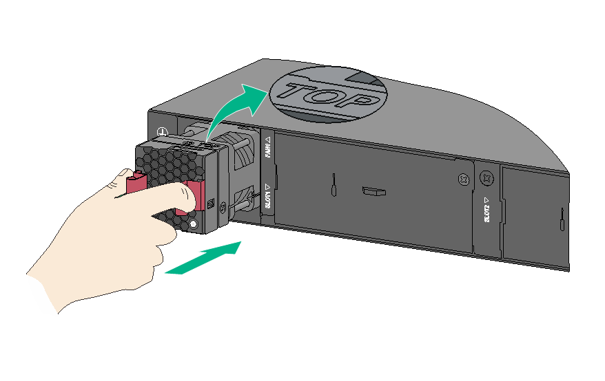

Installing a fan tray
2.     Unpack the fan tray and verify that the fan tray model is as required.
3.     Orient the fan tray with the TOP mark facing up.
4.     Align the fan tray with the fan tray slot. Holding the fan tray handles, slide the fan tray into the slot along the guide rails. Make sure the fan tray is fully seated in the slot and has a firm contact with the backplane.
To prevent damage to the fan tray or the connectors in the chassis, insert the fan tray gently. If you encounter a hard resistance while inserting the fan tray, pull out the fan tray and insert it again.
Figure2-21 Installing a fan tray

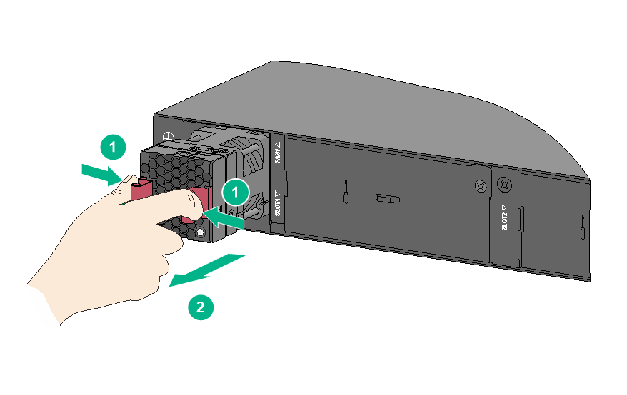

Removing a fan tray
WARNING
WARNING!
·     To avoid bodily injury, disturbing the dynamic balance of the fan tray, and causing loud noises, do not touch the rotation axis, or any bare wires, fan blades, or terminals on the fan tray.
·     Do not place the fan tray in a moist place. Prevent liquid from entering the fan tray.
·     Fan trays with faulty internal wiring and conductors require maintenance from maintenance engineers. Do not disassemble the faulty fan trays.
To remove a fan tray:
2.     Holding the fan tray handles, pull the fan tray slowly out of the slot along the guide rails.
3.     Put the removed fan tray in an antistatic bag.
Figure2-22 Removing a fan tray
Installing and removing a power supply
The switch provides two power supply slots. It comes with power supply slot PWR1 empty and power supply slot PWR2 installed with a filler panel. You can install one or two power supplies for the switch as required. For the power supplies available for the switch and their specifications, see hardware information and specifications for the switch series.
WARNING
WARNING!
·     To avoid bodily injury or switch damage, strictly follow the procedures in Figure2-23 and Figure2-24 to install and remove a power supply.
·     You must provide a circuit breaker for each power supply.
Figure2-23 Installation procedure
Figure2-24 Removal procedure

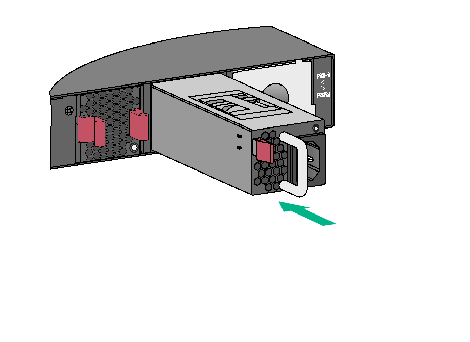

Installing a PSR250-12A, PSR250-12A1, PSR450-12D, PSR1600-54A-B, PSR920-54A-B, or PSR600-54A-B power supply
The installation procedure is the same for the PSR250-12A, PSR250-12A1, PSR450-12D, PSR1600-54A-B, PSR920-54A-B, and PSR600-54A-B power supplies. The following procedure installs a PSR250-12A1 power supply.
To install a PSR250-12A1 power supply:

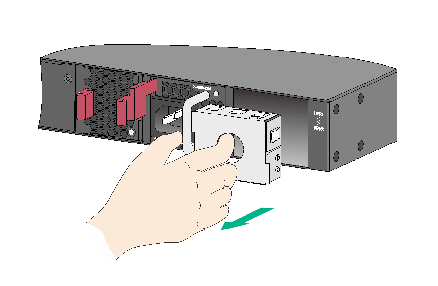

2.     Remove the filler panel, if any, from the target power supply slot.
Put your forefinger into the hole in the filler panel and then pull the filler panel out of the slot gently.
Keep the removed filler panel secure for future use.
Figure2-25 Removing the filler panel from the target power supply slot
3.     Unpack the power supply. Make sure the power supply model is as required.
Keep the packaging box and packaging bag for the power supply secure for future use.
4.     Correctly orient the power supply. Make sure the lettering on the power supply is upward.
5.     Align the power supply with the power supply slot. Grasping the handle of the power supply with one hand and supporting its bottom with the other, slide the power supply slowly into the slot along the guide rails until the latch of the power supply clicks into the slot.
To prevent damage to the power supply or the connectors on the backplane, insert the power supply gently. If you encounter a hard resistance when inserting the power supply, pull out the power supply and insert it again.
Figure2-26 Installing a power supply

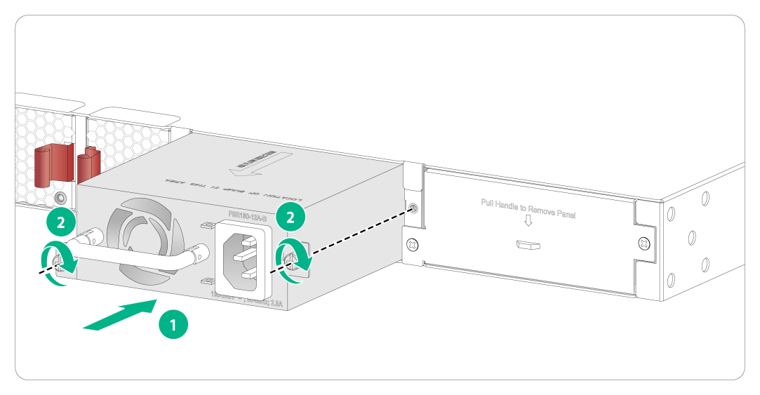

To install a PSR180-12A-B power supply:

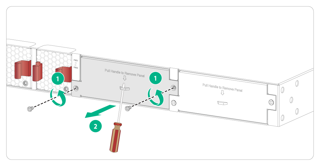

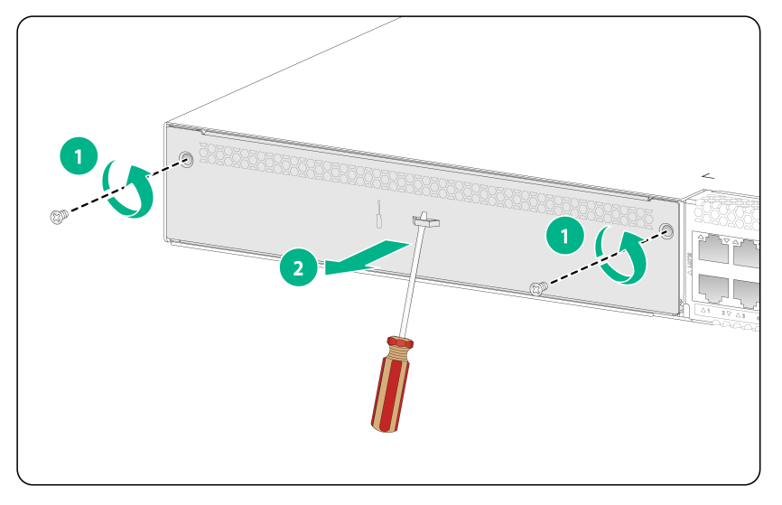

2.     Remove the filler panel from the target power supply slot as follows:
a.     Remove the screws from the filler panel.
b.     Use a flathead screwdriver to remove the filler panel.
Figure2-27 Removing the filler panel
3.     Unpack the power supply and verify that the power supply model is correct.
4.     Correctly orient the power supply with the power supply slot (use the letters on the power supply faceplate for orientation), grasp the handle of the power supply with one hand and support its bottom with the other, and slide the power supply slowly along the guide rails into the slot (see callout 1 in Figure2-28).
5.     Fasten the captive screws on the power supply with a Phillips screwdriver to secure the power supply in the chassis (see callout 2 in Figure2-28). If the captive screw cannot be tightly fastened, verify the installation of the power supply.
As a best practice, use a torque of 5 kgf-cm (0.49 Nm) to fasten the captive screws.
6.     Install the filler panel over the empty power supply slot to prevent dust and ensure good ventilation if you install only one power supply.
Figure2-28 Installing a power supply

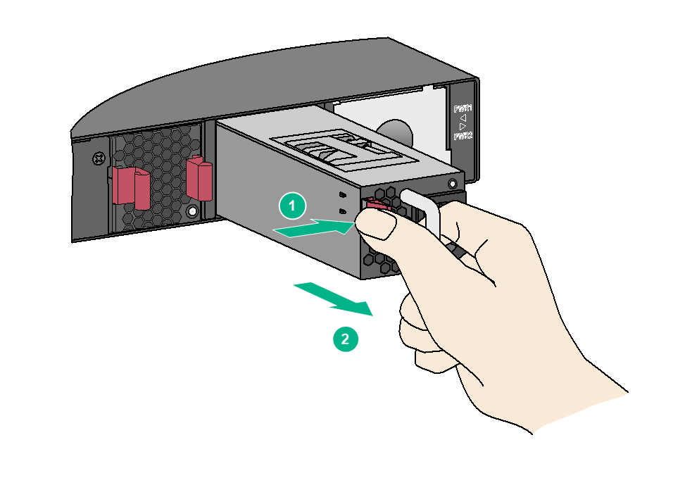

To remove a PSR250-12A1 power supply:
2.     Disconnect the power cord.
3.     Press the latch on the power supply towards the handle side, and pull the power supply part way out of the slot along the guide rails.
4.     Grasping the handle of the power supply with one hand and supporting module bottom with the other, pull the power supply slowly out of the slot along the guide rails.
5.     Place the removed power supply on an anti-static mat or put it into its packaging bag.
6.     If you are not to install a new power supply in the slot, install a filler panel in the slot to prevent dust and ensure good ventilation.
Figure2-29 Removing a power supply

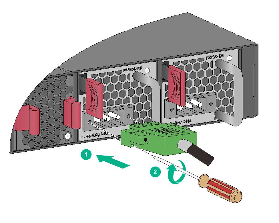

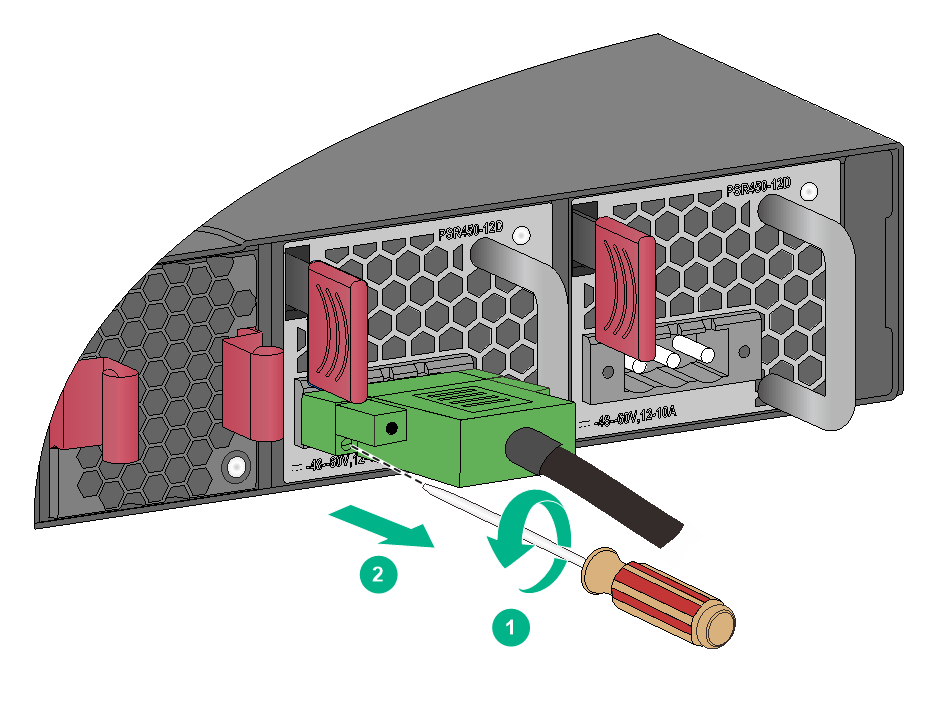

Removing a PSR450-12D power supply
2.     Remove the power cord from the power supply. As shown in Table3-3, use a flathead screwdriver to loosen the two screws on the power cord connector and then pull the connector out.
3.     Holding the power supply handle with one hand and using your thumb to press the latch on the power supply rightwards, pull the power supply part way out of the slot. Supporting the power supply bottom with the other, pull the power supply slowly out of the slot.
Figure2-30 Removing the power cord from a PSR450-12D power supply
(1) Use a flathead screwdriver to loosen the two screws on the power cord connector
(2) Pull the power cord connector out

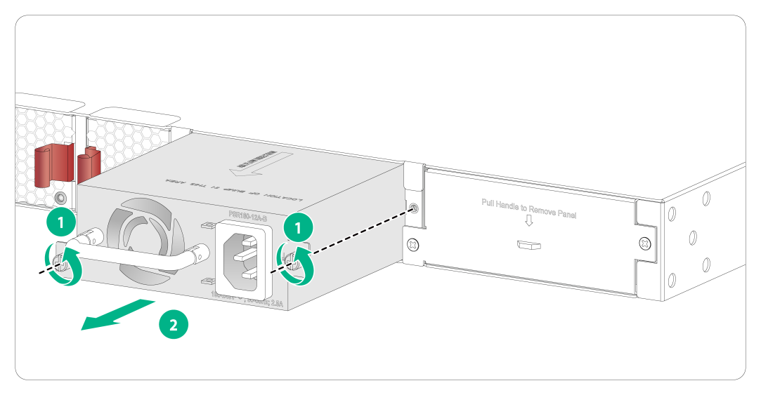

3.     Loosen the captive screws on the power supply with a Phillips screwdriver until they are completely disengaged.
4.     Grasp the handle of the power supply with one hand and pull it out a little, support the bottom with the other hand, and pull the power supply slowly along the guide rails out of the slot.
Put away the removed power supply in an antistatic bag or the power supply package bag for future use.
Figure2-31 Removing a power supply

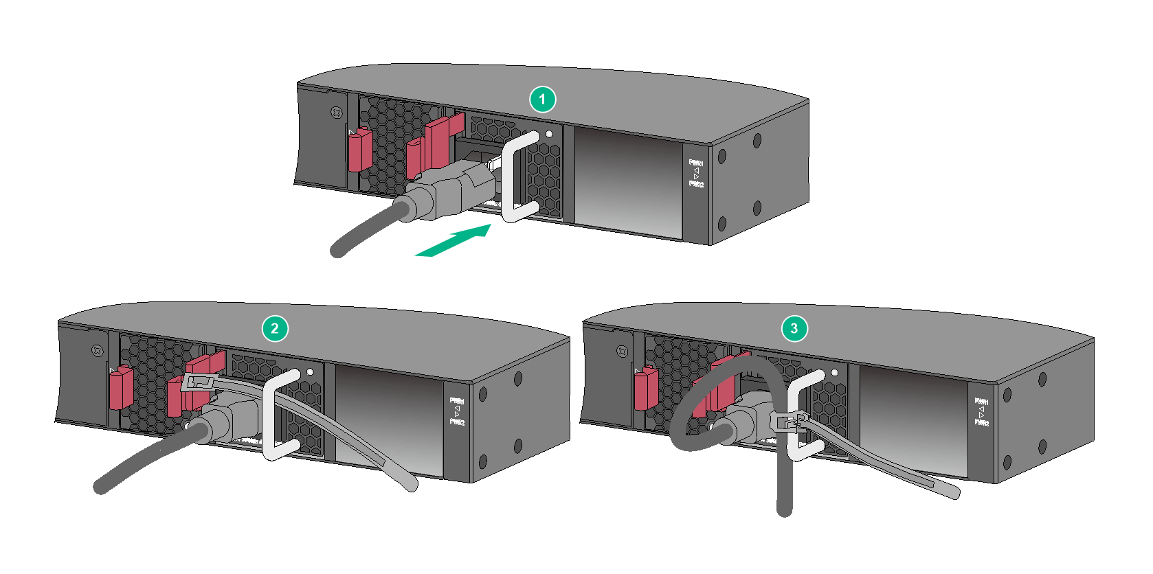

To connect the power cord for a PSR250-12A1 power supply:
2.     Plug the female connector of the power cord into the power receptacle on the power supply, as shown by callout 1 in Figure2-32.
3.     Use a cable tie to secure the power cord to the handle of the power supply, as shown by callout 2 and callout 3 in Figure2-32.
4.     Connect the other end of the power cord to an AC power source or a high-voltage DC power source.
Figure2-32 Connecting the power cord for a PSR250-12A1 power supply

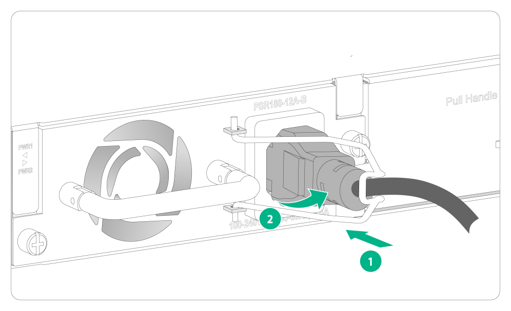

Connecting the power cord for a PSR180-12A-F or PSR180-12A-B power supply

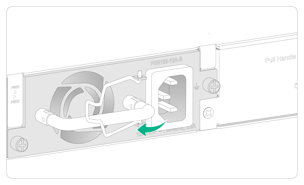

The power cord connection procedure is similar for the PSR180-12A-F and PSR180-12A-B power supplies. The following procedure connects the power cord for a PSR180-12A-B power supply.
To connect the power cord for a PSR180-12A-B power supply:
2.     Attach the power cord retainer clip (supplied with the power supply) into the two holes next to the AC-input power receptacle on the power supply, and pull the retainer clip leftwards (see Figure2-33).
3.     Connect the female connector of the AC power cord supplied with the power supply to the power receptacle (see callout 1 in Figure2-34).
4.     Pull the retainer clip rightwards to secure the connector to the AC-input power receptacle (see callout 2 in Figure2-34).
5.     Connect the other end of the power cord to an AC power source.
Figure2-33 Connecting a power cord (1)
Figure2-34 Connecting a power cord (2)
Connecting the DC power cord for a PSR450-12D power supply
1.     Correctly orient the DC power cord connector and insert it into the DC power input receptacle on the power supply, as shown by callout 1 in Figure2-35.
If you orient the DC power cord connector upside down, you cannot insert it into the DC power input receptacle.
2.     Use a flathead screwdriver to fasten the two screws on the power cord connector to secure the connector in place, as shown by callout 2 in Figure2-35.
3.     Connect the other end of the DC power cord to an external DC power supply system.
Figure2-35 Connecting the DC power cord for a PSR450-12D power supply

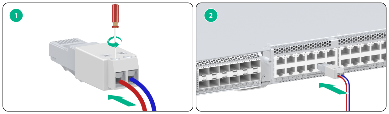

Connecting a hybrid copper-fiber cable
1.     Use a utility knife to peel off an appropriate length of the black outer sheath from the main cable, exposing the inside four cables, of which the two yellow ones are optical fibers, and the red and blue ones are conductive copper wires.
2.     Connect the two conductive copper wires to the network port connector provided with the switch, with the red wire connected to terminal A, and the blue wire connected to terminal B, as shown by callout 1 in Figure2-36.
3.     Connect the network connector to a copper port on the switch, as shown by callout 2 in Figure2-36.
4.     Fusion splice the optical fibers to the pigtail with LC connectors.
5.     Connect the LC connectors to a fiber port on the switch, as shown by callout 2 in Figure2-37.
Figure2-36 Connecting conductive copper wires

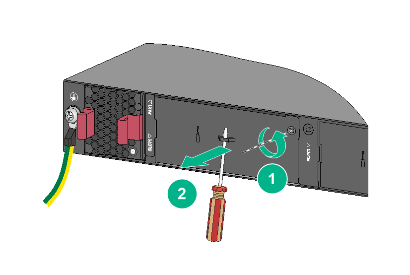

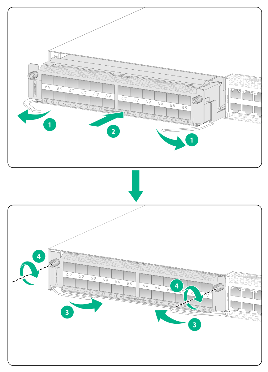

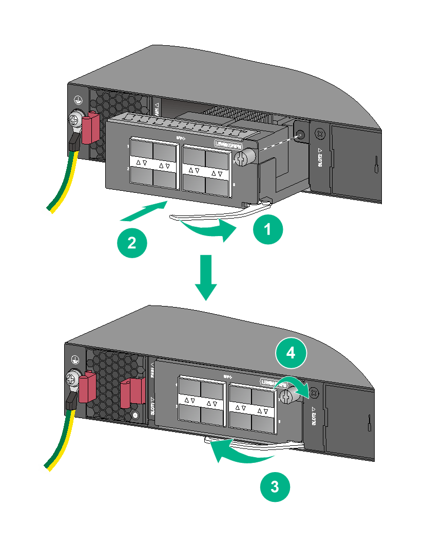

Installing an expansion card
To install an expansion card:
2.     Use a Phillips screwdriver to remove the screw on the filler panel in the target expansion slot. Then remove the filler panel.
Keep the filler panel secure for future use.
For interface modules other than the LSWM124SFPP and LSWM124MUPWR, use method 1 to remove the filler panel.
For the LSWM124SFPP and LSWM124MUPWR interface modules, use method 2 to remove the filler panel.
Figure2-38 Removing the filler panel from the target expansion slot (method 1)
Figure2-39 Removing the filler panel from the target expansion slot (method 2)
3.     Unpack the expansion card.
4.     (Optional.) If the expansion card has one ejector lever, perform the following steps to install it:
a.     Fully open the ejector lever, as shown by callout 1 in Figure2-40.
b.     Gently push the expansion card into the slot along the guide rails until the expansion card has good contact with the chassis. See callout 2 in Figure2-40.
c.     Close the ejector lever, as shown by callout 3 in Figure2-40.
d.     Use a Phillips screwdriver to fasten the captive screw on the expansion card to secure the card in the slot. See callout 4 in Figure2-40.
Figure2-40 Installing an expansion card with one ejector lever
5.     (Optional.) If the expansion card has two ejector levers, perform the following steps to install it:
a.     Rotate outwards the left and right ejector levers of the card, as shown by callout 1 in Figure2-41.
b.     Gently push the expansion card into the slot along the guide rails until the expansion card has good contact with the chassis, as shown by callout 2 in Figure2-41.
c.     Rotate inwards the left and right ejector levers, as shown by callout 3 in Figure2-41.
d.     Use a Phillips screwdriver to fasten the captive screws on the expansion card, as shown by callout 4 in Figure2-41.
Figure2-41 Installing an expansion card with two ejector levers (LSWM124SFPP)

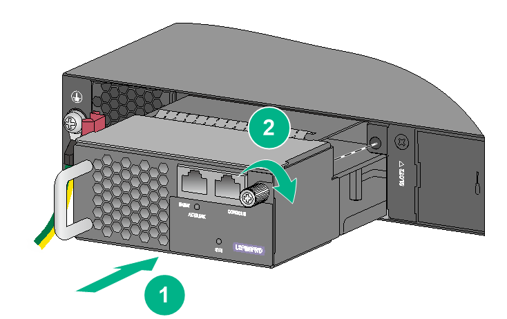

6.     (Optional.) If the expansion card does not have an ejector lever, perform the following steps to install it:
a.     Gently push the expansion card into the slot along the guide rails until the expansion card has good contact with the chassis. See callout 1 in Figure2-42.
b.     Use a Phillips screwdriver to fasten the captive screw on the expansion card to secure the card in the slot. See callout 2 in Figure2-42.
Figure2-42 Installing an expansion card without an ejector lever (LSPM6FWD)
An LSPM6FWD firewall card including its handle adds 75 mm (2.95 in) to the chassis depth.
Removing an expansion card
2.     Use a Phillips screwdriver to remove the captive screw on the expansion card.
3.     Fully open the ejector lever.
Skip this step for an expansion card that does not have an ejector lever.
4.     Gently pull the expansion card out of the slot along the guide rails.
5.     If you are not to install a new expansion card, install a filler panel in the slot to prevent dust and ensure good ventilation in the switch.

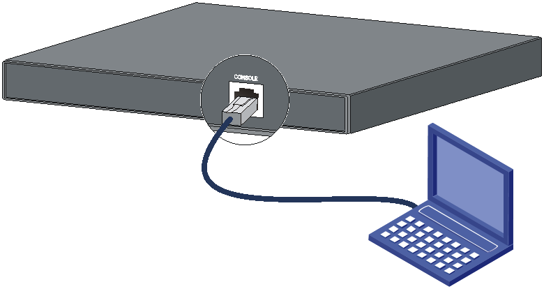

Connecting the switch to a configuration terminal
The S6520X-30QC-EI, S6520X-54QC-EI, S6520X-30HC-EI, S6520X-54HC-EI, S6520X-30QC-HI, S6520X-54QC-HI, S6520X-30HC-HI, and S6520X-54HC-HI switches each provide a serial console port and a micro USB console port for connecting to a configuration terminal. If you connect configuration terminals to both ports, only the micro USB console port is effective.
The S6520X-30HF-EI, S6520X-54HF-EI, S6520X-30HF-HI, S6520X-54HF-HI, and S6520X-54HC-UPWR-EI switches each provide only a serial console for connecting to a configuration terminal.
In Figure3-1, the switch is connected to a configuration terminal (PC as an example) from the serial console port.
Figure3-1 Connecting the switch to a configuration terminal

A DB9-to-RJ45 console cable is an 8-core shielded cable, with a crimped RJ-45 connector at one end for connecting to the serial console port of the switch, and a DB-9 female connector at the other end for connecting to the serial port on the console terminal.
Figure3-2 DB9-to-RJ45 console cable

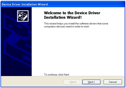

4.     Click Next on the welcome page of the driver installation wizard.
Figure3-3 Driver installation wizard

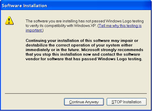

3.     Click the following link, or copy it to the address bar on the browser to log in to download and install the USB console driver on the configuration terminal.
http://www.h3c.com/en/home/USB_Console/

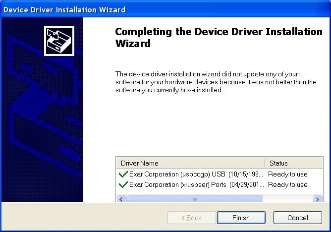

4.     Select a driver program according to the operating system you use:
¡     XR21V1410_XR21B1411_Windows_Ver1840_x86_Installer.EXE—32-bit operating system.
¡     XR21V1410_XR21B1411_Windows_Ver1840_x64_Installer.EXE—64-bit operating system.
5.     Click Next on the installation wizard.
Figure3-5 Device Driver Installation Wizard
6.     Click Continue Anyway if the following dialog box appears.
Figure3-6 Software Installation
7.     Click Finish.
Figure3-7 Completing the device driver installation wizard

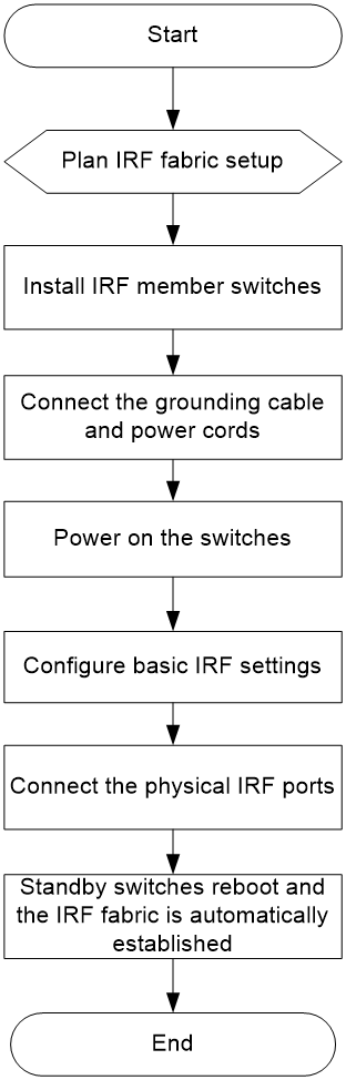

IRF fabric setup flowchart
Figure4-1 IRF fabric setup flowchart
To set up an IRF fabric:
Step
Description
1.     Plan IRF fabric setup
Plan the installation site and IRF fabric setup parameters:
·     Planning IRF fabric size and the installation site
·     Identifying the master switch and planning IRF member IDs
·     Planning IRF topology and connections
·     Identifying physical IRF ports on the member switches
·     Planning the cabling scheme
2.     Install IRF member switches
See "Installing the switch in a 19-inch rack" or "Mounting the switch on a workbench."
3.     Connect grounding cables and power cords
See "Grounding the switch" and "Connecting the power cord."
4.     Power on the switches
N/A
5.     Configure basic IRF settings
See the virtual technologies configuration guide in the configuration guides for the switch series.
6.     Connect the physical IRF ports
Connect physical IRF ports on switches.
All switches except the master switch automatically reboot, and the IRF fabric is established.

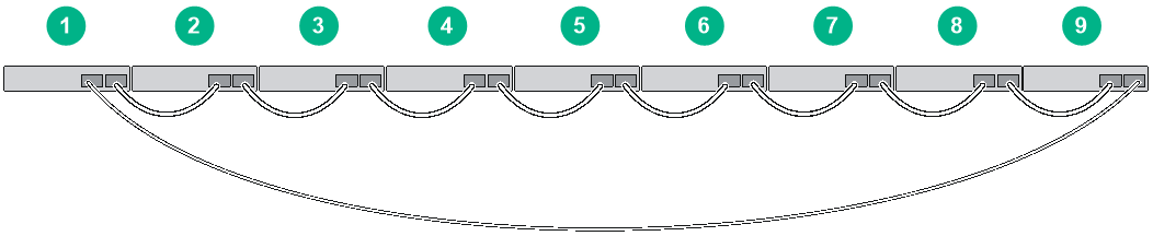

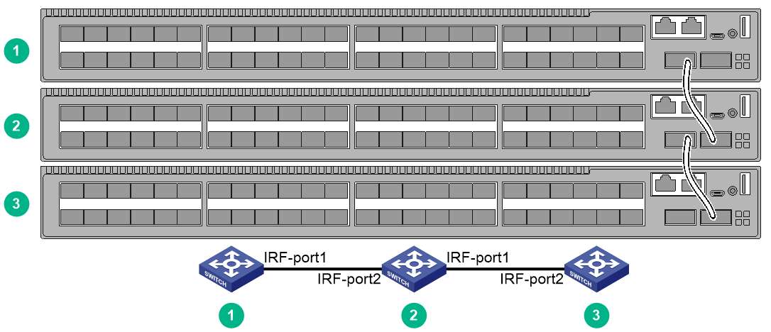

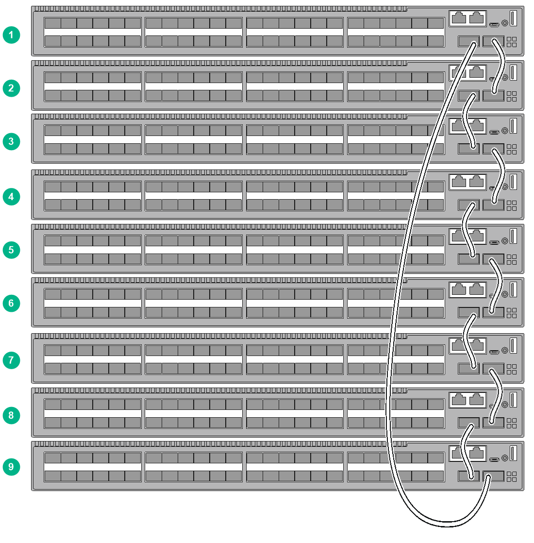

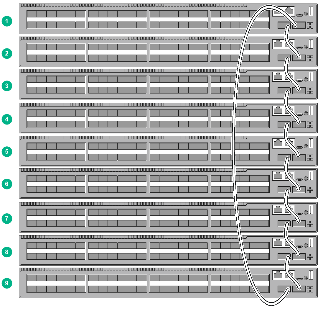

You can create an IRF fabric in daisy chain topology or more reliable ring topology. In ring topology, the failure of one IRF link does not cause the IRF fabric to split as in daisy chain topology. Instead, the IRF fabric changes to a daisy chain topology without interrupting network services.
You connect the IRF member switches through IRF ports, the logical interfaces for the connections between IRF member switches. Each IRF member switch has two IRF ports: IRF-port 1 and IRF-port 2. To use an IRF port, you must bind a minimum of one physical port to it.
When connecting two neighboring IRF member switches, you must connect the physical ports of IRF-port 1 on one switch to the physical ports of IRF-port 2 on the other switch.
The switch can provide 5G/10GE/25G/40GE/100GE IRF connections. See Table4-1 for the available IRF physical ports. You can bind several IRF physical ports to an IRF port for increased bandwidth and availability.
Figure4-2 and Figure4-3 show the topologies of an IRF fabric made up of three S6520X-54QC-EI switches. The IRF port connections in the two figures are for illustration only, and more connection methods are available.
Figure4-2 IRF fabric in daisy chain topology
Figure4-3 IRF fabric in ring topology

Connecting the IRF member switches in one rack
Connect the IRF member switches (9 switches in this example) in a rack as shown in Figure4-4. The switches in the ring topology (see Figure4-5) are in the same order as connected in the rack.
Figure4-4 Connecting the switches in one rack
Figure4-5 IRF fabric topology
Connecting the IRF member switches in a ToR solution
You can install IRF member switches in different racks side by side to deploy a top of rack (ToR) solution.
Figure4-6 ToR cabling
Configuring basic IRF settings
After you install the IRF member switches, power on the switches, and log in to each IRF member switch (see the fundamentals configuration guide in the configuration guides for the switch series) to configure their member IDs, member priorities, and IRF port bindings.
Follow these guidelines when you configure the switches:
·     Assign the master switch higher member priority than any other switch.
·     Bind physical ports to IRF port 1 on one switch and to IRF port 2 on the other switch. You perform IRF port binding before or after connecting IRF physical ports depending on the software release.
·     To bind the ports on an interface module to an IRF port, you must install the interface module first.
·     Execute the display irf configuration command to verify the basic IRF settings.
For more information about configuring basic IRF settings, see the virtual technologies configuration guide in the configuration guides for the switch series.
Connecting the physical IRF ports
Use twisted pair/SFP+/QSFP+/SFP28/QSFP28 cables or SFP+/QSFP+/SFP28/QSFP28 transceiver modules and fibers to connect the IRF member switches as planned.
Wear an ESD wrist strap when you connect twisted pair/SFP+/QSFP+/SFP28/QSFP28 cables or SFP+/QSFP+/SFP28/QSFP28 transceiver modules and fibers. For how to connect them, see H3C Transceiver Modules and Network Cables Installation Guide.

Fan tray failure
WARNING
WARNING!
·     If both fan trays fail during switch operation, replace them within 2 minutes.
·     If one fan tray fails, perform either of the following tasks:
¡     If the ambient temperature is not higher than 27°C (80.6°F), replace the fan tray within 24 hours and make sure the failed fan tray remains in position before the replacement.
¡     If the ambient temperature is higher than 27°C (80.6°F), replace the fan tray immediately.
The switch uses removable fan trays. If a fan tray fails, see "Installing and removing a fan tray" to replace the fan tray.
Configuration terminal display issues
If the configuration environment setup is correct, the configuration terminal displays booting information when the switch is powered on. If the setup is incorrect, the configuration terminal displays nothing or garbled text.
No display
Symptom
The configuration terminal does not have display when the switch is powered on.
Solution
To resolve the issue:
1.     Verify that the power supply is supplying power to the switch correctly.
2.     Verify that the console cable is correctly connected.
3.     Verify that the console cable does not have any issues and the terminal settings are correct.
4.     If the issue persists, contact H3C Support.
Garbled display
Symptom
The display on the configuration terminal is garbled.
Solution
1.     Verify that the following settings are configured for the terminal:
¡     Baud rate—9,600.
¡     Data bits—8.
¡     Stop bits—1.
¡     ParityNone.
¡     Flow control—None.
2.     If the issue persists, contact H3C Support.
