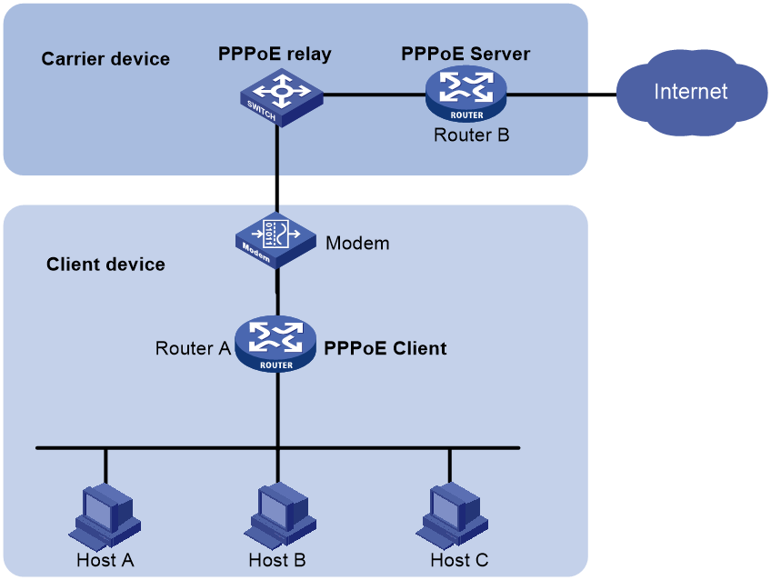

PPPoE network structures are classified into router-initiated and host-initiated network structures depending on the starting point of the PPPoE session.
Router-initiated network structure
As shown in Figure 1, the PPPoE session is established between routers (Router A and Router B). All hosts share one PPPoE session for data transmission without being installed with PPPoE client software. This network structure is typically used by enterprises.
Figure 1 Router-initiated network structure

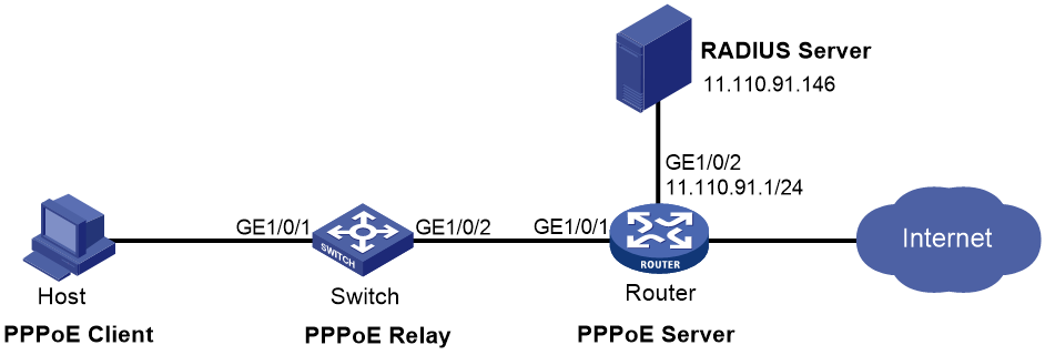

Host-initiated network structure
As shown in Figure 2, a PPPoE session is established between each host (PPPoE client) and the carrier router (PPPoE server). The service provider assigns an account to each host for billing and control. The host must be installed with PPPoE client software.
Figure 2 Host-initiated network structure

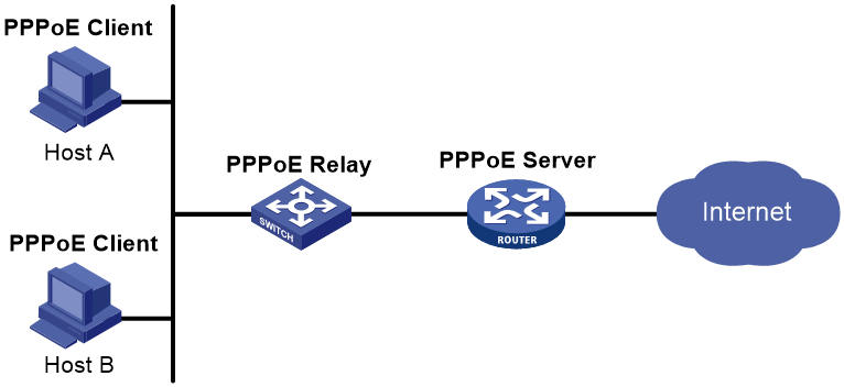

Example: Configuring PPPoE relay
The host uses the PPPoE access method to connect to the router through the switch. The switch acts as the PPPoE relay. The router acts as the PPPoE server and assigns IPv4 addresses to the PPPoE client through a PPP address pool.
Figure 4 Network diagram
1.     Configure the switch as the PPPoE relay:
# Enable the PPPoE relay function.
<Switch> system-view
[Switch] pppoe-relay enable
# Configure the server-facing interface GigabitEthernet 1/0/2 as a PPPoE relay trusted port.
[Switch] interface GigabitEthernet 1/0/2
[Switch-GigabitEthernet1/0/2] pppoe-relay trust

a.     Configure the authentication and accounting passwords as expert.
b.     Add a PPPoE user with username user1 and password 123456.
For more information, see the user manual for the RADIUS server.
Install the PPPoE client software and configure the username and password (user1 and pass1 in this example) on the hosts. Then, the hosts can use PPPoE to access the Internet through the router.
