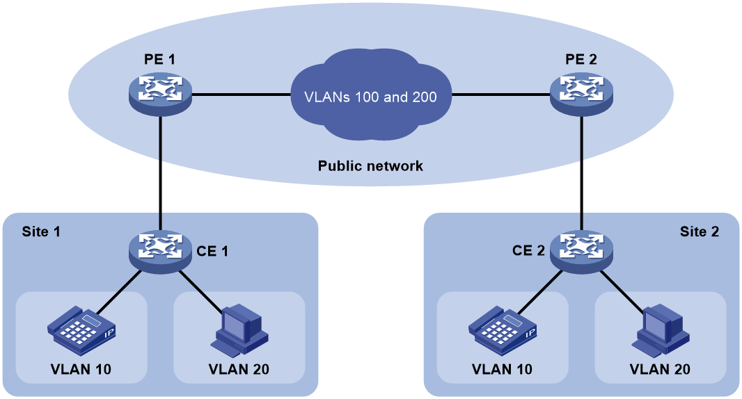

One-to-two VLAN mapping
As shown in Figure 2, one-to-two VLAN mapping is used to transmit different types of CVLAN packets with different SVLAN tags over the service provider network.
Figure 2 Application scenario of one-to-two VLAN mapping
As shown in Figure 2, users of Site 1 and Site 2 are in VLAN 10 and VLAN 20. The service provider assigns VLAN 100 and VLAN 200 to the customer network. When packets from Site 1 arrive at PE 1, PE 1 adds an SVLAN tag to the packets based on the packet type.
One-to-two VLAN mapping enables the customer to plan CVLANs without conflicting with SVLANs. The service provider can distinguish traffic of the customer network with different SVLANs, and apply transmission policies to the customer traffic.

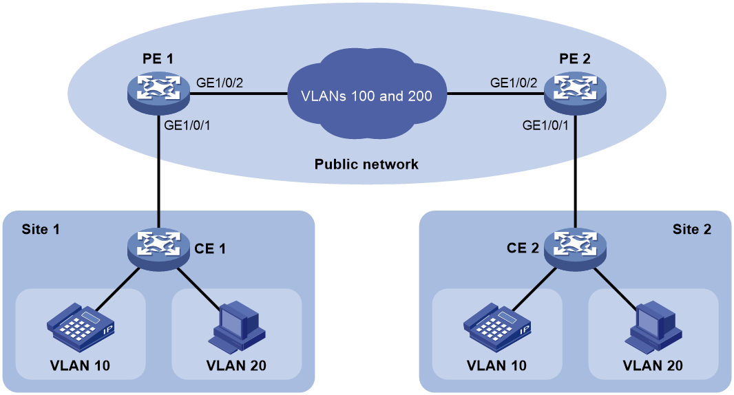

·     Configuring one-to-two VLAN mapping
Configure one-to-two VLAN mapping on PE 1 and PE 4, as shown in Figure 2, through which traffic from customer networks enters the service provider networks.
About one-to-two VLAN mapping
Configure one-to-two VLAN mapping on the customer-side ports of edge devices from which customer traffic enters SP networks, for example, on PEs 1 and 4 in Figure 2. One-to-two VLAN mapping enables the edge devices to add an SVLAN tag to each incoming packet.
Only one SVLAN tag can be added to packets from the same CVLAN. To add different SVLAN tags to different CVLAN packets on a port, set the port link type to hybrid and configure multiple one-to-two VLAN mappings.
The MTU of an interface is 1500 bytes by default. After a VLAN tag is added to a packet, the packet length is added by 4 bytes. As a best practice, set the MTU to a minimum of 1504 bytes for ports on the forwarding path of the packet in the service provider network.

Example: Configuring one-to-two VLAN mapping
As shown in Figure 9, Site 1 and Site 2 of a company use VLAN 10 and VLAN 20 to transmit VoIP and PC traffic, respectively. The service provider assigns VLAN 100 and VLAN 200 to the customer network.
Configure one-to-two VLAN mappings to enable the service provider network to transmit VoIP and PC traffic with SVLAN 100 and SVLAN 200, respectively.
Figure 9 Network diagram
1.     Configure PE 1:
# Create VLANs 10, 20, 100, and 200.
<PE1> system-view
[PE1] vlan 10
[PE1-vlan10] quit
[PE1] vlan 20
[PE1-vlan20] quit
[PE1] vlan 100
[PE1-vlan100] quit
[PE1] vlan 200
[PE1-vlan200] quit
# Configure a one-to-two VLAN mapping on the customer-side port (GigabitEthernet 1/0/1) to add SVLAN tag 100 to packets from CVLAN 10.
[PE1] interface gigabitethernet 1/0/1
[PE1-GigabitEthernet1/0/1] vlan mapping nest single 10 nested-vlan 100
# Configure a one-to-two VLAN mapping on GigabitEthernet 1/0/1 to add SVLAN tag 200 to packets from CVLAN 20.
[PE1-GigabitEthernet1/0/1] vlan mapping nest single 20 nested-vlan 200
# Configure GigabitEthernet 1/0/1 as a hybrid port.
[PE1-GigabitEthernet1/0/1] port link-type hybrid
# Assign GigabitEthernet 1/0/1 to VLANs 100 and 200 as an untagged member.
[PE1-GigabitEthernet1/0/1] port hybrid vlan 100 200 untagged
[PE1-GigabitEthernet1/0/1] quit
# Configure the network-side port (GigabitEthernet 1/0/2) as a trunk port, and assign the port to VLANs 100 and 200.
[PE1] interface gigabitethernet 1/0/2
[PE1-GigabitEthernet1/0/2] port link-type trunk
[PE1-GigabitEthernet1/0/2] port trunk permit vlan 100 200
[PE1-GigabitEthernet1/0/2] quit
2.     Configure PE 2 in the same way PE 1 is configured. (Details not shown.)
# Verify VLAN mapping information on PE 1.
[PE1] display vlan mapping
Interface GigabitEthernet1/0/1:
  Outer VLAN    Inner VLAN    Translated Outer VLAN    Translated Inner VLAN
  10             N/A           100                      10
  20             N/A           200                      20
# Verify VLAN mapping information on PE 2.
[PE2] display vlan mapping
Interface GigabitEthernet1/0/2:
  10             N/A           100                      10
  20             N/A           200                      20
