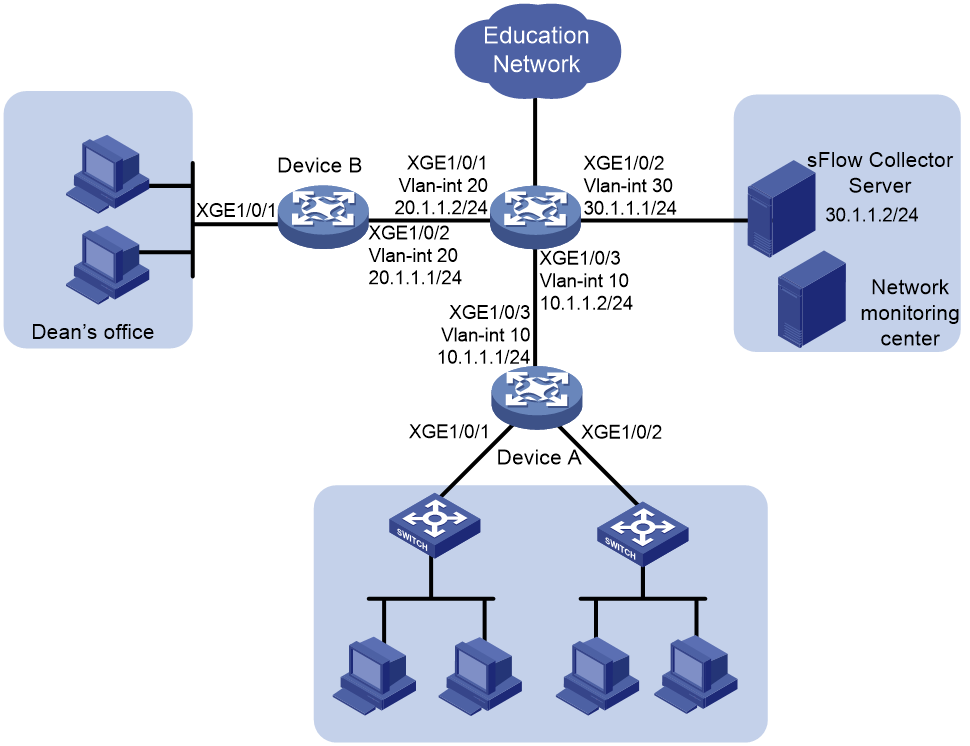

Example: Configuring sFlow
As shown in Figure 1, perform the following tasks:
· Configure flow sampling to sample packets on Device A and Device B.
· Configure counter sampling to periodically collect the counter information on Device A and Device B.
Analysis
To obtain interface counter information and packet information, you must configure both flow sampling and counter sampling.
