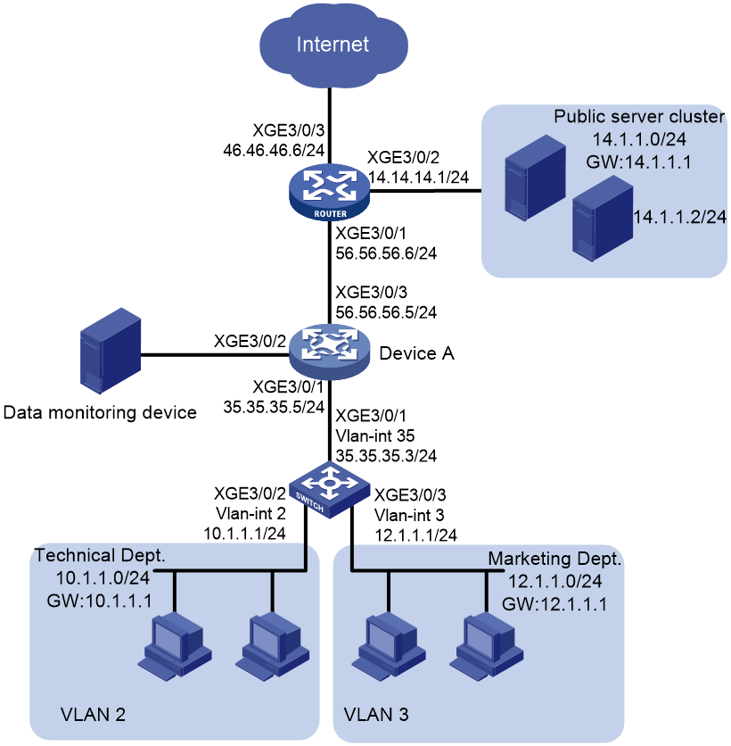

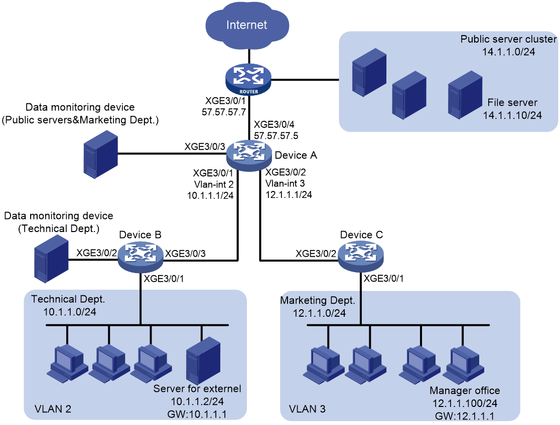

As shown in Figure 1, configure local port mirroring to monitor the Internet traffic and bidirectional traffic of the Marketing department and the Technical department.
Figure 1 Network diagram

# Assign IP address 10.1.1.1 to Ten-GigabitEthernet 3/0/1.
<DeviceA> system-view
[DeviceA] interface ten-gigabitethernet 3/0/1
[DeviceA-Ten-GigabitEthernet3/0/1] port link-mode route
[DeviceA-Ten-GigabitEthernet3/0/1] ip address 10.1.1.1 24
[DeviceA-Ten-GigabitEthernet3/0/1] quit
# Assign IP addresses to Ten-GigabitEthernet 3/0/2 and Ten-GigabitEthernet 3/0/4 in the same way 10.1.1.1 is assigned to Ten-GigabitEthernet 3/0/1. (Details not shown.)
# Create local mirroring group 1.
[DeviceA] mirroring-group 1 local
# Configure Ten-GigabitEthernet 3/0/1 and Ten-GigabitEthernet 3/0/2 as the source ports of the mirroring group.
[DeviceA] mirroring-group 1 mirroring-port ten-gigabitethernet 3/0/1 ten-gigabitethernet 3/0/2 inbound
# Configure Ten-GigabitEthernet 3/0/3 as the monitor port of the mirroring group.
[DeviceA] mirroring-group 1 monitor-port ten-gigabitethernet 3/0/3
# Disable the spanning tree feature on Ten-GigabitEthernet 3/0/3.
[DeviceA] interface ten-gigabitethernet 3/0/3
[DeviceA-Ten-GigabitEthernet3/0/3] undo stp enable
[DeviceA-Ten-GigabitEthernet3/0/3] quit
1.     Display information about mirroring group 1 on Device A.
[DeviceA] display mirroring-group 1
Mirroring group 1:
    Type: Local
    Status: Active
    Mirroring port:
        Ten-GigabitEthernet3/0/1  Inbound
        Ten-GigabitEthernet3/0/2  Inbound
    Monitor port: Ten-GigabitEthernet3/0/3

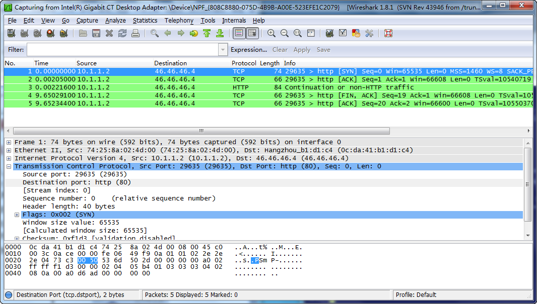

2.     Use Wireshark for packet analysis:
# Ping 56.56.56.6 from a Technical department host (10.1.1.2). (Details not shown.)
# Use Wireshark on the data monitoring device to capture the ping packets.
Figure 2 Ping packet analysis in Wireshark
The analysis shows that the data monitoring device can monitor the packets sent from the Technical department.

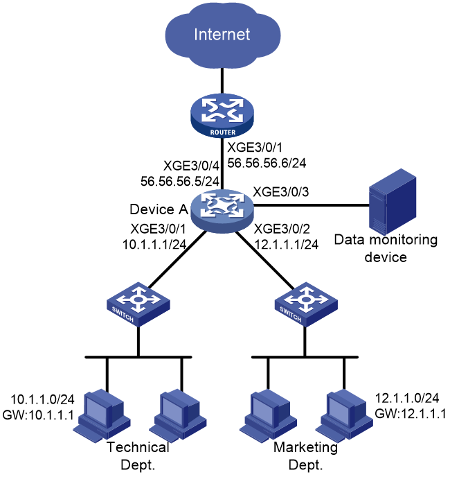

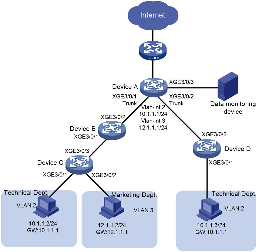

As shown in Figure 3, configure Layer 2 remote port mirroring to monitor the outgoing traffic from the Technical department.
Figure 3 Network diagram
Analysis
To ensure correct forwarding of mirrored packets, assign the ports that connect intermediate devices to the source and destination devices to the remote probe VLAN.

Configuring Device A (the destination device)
# Create VLANs 2 and 3.
[DeviceA] vlan 2 to 3
# Create VLAN-interface 2 and assign an IP address to it.
[DeviceA] interface vlan-interface 2
[DeviceA-Vlan-interface2] ip address 10.1.1.1 24
[DeviceA-Vlan-interface2] quit
# Create VLAN-interface 3 and assign an IP address to it.
[DeviceA] interface vlan-interface 3
[DeviceA-Vlan-interface3] ip address 12.1.1.1 24
[DeviceA-Vlan-interface3] quit
# Configure Ten-GigabitEthernet 3/0/1 as a trunk port, and assign the port to VLANs 2, 3, and 5.
[DeviceA-Ten-GigabitEthernet3/0/1] port link-type trunk
[DeviceA-Ten-GigabitEthernet3/0/1] port trunk permit vlan 2 3 5
# Configure Ten-GigabitEthernet 3/0/2 as a trunk port, and assign the port to VLANs 2 and 5.
[DeviceA] interface ten-gigabitethernet 3/0/2
[DeviceA-Ten-GigabitEthernet3/0/2] port link-type trunk
[DeviceA-Ten-GigabitEthernet3/0/2] port trunk permit vlan 2 5
[DeviceA-Ten-GigabitEthernet3/0/2] quit
# Create a remote destination group.
[DeviceA] mirroring-group 1 remote-destination
# Create VLAN 5.
[DeviceA] vlan 5
[DeviceA-vlan5] quit
# Configure VLAN 5 as the remote probe VLAN of the remote destination group.
[DeviceA] mirroring-group 1 remote-probe vlan 5
# Configure Ten-GigabitEthernet 3/0/3 as the monitor port of the remote destination group.
# Configure Ten-GigabitEthernet 3/0/3 as an access port, and assign the port to the remote probe VLAN.
[DeviceA-Ten-GigabitEthernet3/0/3] port access vlan 5
Configuring Device B (the intermediate device)
<DeviceB> system-view
[DeviceB] vlan 2 to 3
# Create VLAN 5.
[DeviceB] vlan 5
[DeviceB-vlan5] quit
[DeviceB] interface ten-gigabitethernet 3/0/1
[DeviceB-Ten-GigabitEthernet3/0/1] port link-type trunk
[DeviceB-Ten-GigabitEthernet3/0/1] port trunk permit vlan 2 3 5
[DeviceB-Ten-GigabitEthernet3/0/1] quit
# Configure Ten-GigabitEthernet 3/0/2 as a trunk port, and assign the port to VLANs 2, 3, and 5.
[DeviceB] interface ten-gigabitethernet 3/0/2
[DeviceB-Ten-GigabitEthernet3/0/2] port link-type trunk
[DeviceB-Ten-GigabitEthernet3/0/2] port trunk permit vlan 2 3 5
[DeviceB-Ten-GigabitEthernet3/0/2] quit
Configuring Device C (the source device)
<DeviceC> system-view
[DeviceC] vlan 2 to 3
# Assign Ten-GigabitEthernet 3/0/1 to VLAN 2.
[DeviceC] interface ten-gigabitethernet 3/0/1
[DeviceC-Ten-GigabitEthernet3/0/1] port access vlan 2
[DeviceC-Ten-GigabitEthernet3/0/1] quit
# Assign Ten-GigabitEthernet 3/0/2 to VLAN 3.
[DeviceC] interface ten-gigabitethernet 3/0/2
[DeviceC-Ten-GigabitEthernet3/0/2] port access vlan 3
[DeviceC-Ten-GigabitEthernet3/0/2] quit
# Create a remote source group.
[DeviceC] mirroring-group 1 remote-source
# Create VLAN 5.
[DeviceC] vlan 5
[DeviceC-vlan5] quit
# Configure VLAN 5 as the remote probe VLAN for the remote source group.
[DeviceC] mirroring-group 1 remote-probe vlan 5
# Configure Ten-GigabitEthernet 3/0/1 as the source port of the remote source group and the mirroring direction as inbound.
[DeviceC] mirroring-group 1 mirroring-port ten-gigabitethernet 3/0/1 inbound
# Configure Ten-GigabitEthernet 3/0/3 as the egress port of the remote source group.
[DeviceC] mirroring-group 1 monitor-egress ten-gigabitethernet 3/0/3
# Configure Ten-GigabitEthernet 3/0/3 as a trunk port, and assign the port to VLANs 2, 3, and 5.
[DeviceC] interface ten-gigabitethernet 3/0/3
[DeviceC-Ten-GigabitEthernet3/0/3] port link-type trunk
[DeviceC-Ten-GigabitEthernet3/0/3] port trunk permit vlan 2 3 5
[DeviceC-Ten-GigabitEthernet3/0/3] quit

Configuring Device D (the source device)
# Create VLAN 2.
<DeviceD> system-view
[DeviceD] vlan 2
[DeviceD-vlan2] quit
[DeviceD] interface ten-gigabitethernet 3/0/1
[DeviceD-Ten-GigabitEthernet3/0/1] port access vlan 2
[DeviceD-Ten-GigabitEthernet3/0/1] quit
# # Create remote source group 1.
[DeviceD] mirroring-group 1 remote-source
# Create VLAN 5.
[DeviceD] vlan 5
[DeviceD-vlan5] quit
[DeviceD] mirroring-group 1 remote-probe vlan 5
[DeviceD] mirroring-group 1 mirroring-port ten-gigabitethernet 3/0/1 inbound
# Configure Ten-GigabitEthernet 3/0/2 as the egress port of the remote source group.
[DeviceD] mirroring-group 1 monitor-egress ten-gigabitethernet 3/0/2
[DeviceD] interface ten-gigabitethernet 3/0/2
[DeviceD-Ten-GigabitEthernet3/0/2] port link-type trunk
[DeviceD-Ten-GigabitEthernet3/0/2] port trunk permit vlan 2 5
# Disable the spanning tree feature and MAC address learning on the egress port Ten-GigabitEthernet 3/0/2.
[DeviceD-Ten-GigabitEthernet3/0/2] undo stp enable
[DeviceD-Ten-GigabitEthernet3/0/2] undo mac-address mac-learning enable
[DeviceD-Ten-GigabitEthernet3/0/2] quit
1.     Verify mirroring group configurations on devices:
# Display information about mirroring group 1 on Device C.
[DeviceC] display mirroring-group 1
Mirroring group 1:
    Type: Remote source
    Status: Active
    Mirroring port:
    Monitor egress port: Ten-GigabitEthernet3/0/3
        Remote probe VLAN: 5
# Display information about mirroring group 1 on Device A.
Mirroring group 1:
    Type: Remote destination
    Status: Active

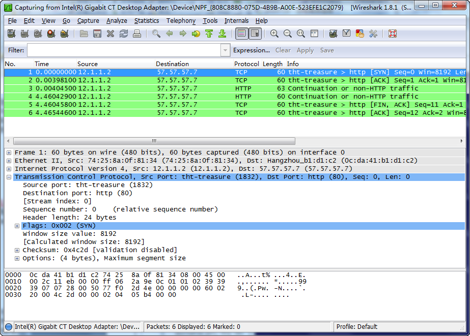

# Ping a Marketing department host (12.1.1.2) from a Technical department host (10.1.1.2). (Details not shown.)
Figure 4 Ping packet analysis in Wireshark
The analysis shows that the data monitoring device can monitor the outgoing traffic from the Technical department.

Example: Configuring local flow mirroring
As shown in Figure 4, configure local flow mirroring to mirror the following traffic:
·     HTTP traffic from the Technical department.
·     Packets that the Marketing department hosts receive from the public server cluster during non-working hours from 18:00 to 08:30 (the next day) on working days.
Figure 5 Network diagram
Analysis
To configure local flow mirroring, you must perform the following tasks on Device A:
·     Define traffic classes and configure match criteria to classify packets to be mirrored.
·     Configure traffic behaviors to mirror the matching packets to the port that connects to the data monitoring device.
# Use a Technical department host (10.1.1.2) to access the IP address 46.46.46.4 and port 80 through Telnet. (Details not shown.)
# Use Wireshark on the data monitoring device to capture the packets.
Figure 6 HTTP traffic analysis in Wireshark
The analysis shows that the data monitoring device can monitor the HTTP traffic from the Technical department.

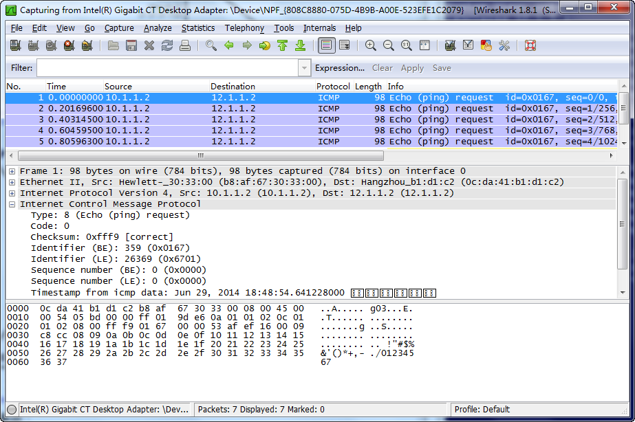

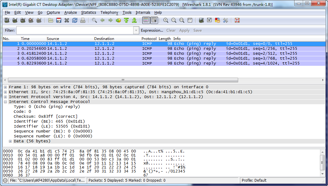

# On a non-working hour of a working day, ping a public server (14.1.1.2) from a Marketing department host (12.1.1.2). (Details not shown.)
Figure 7 Ping packet analysis in Wireshark
The analysis shows that the data monitoring device can monitor the traffic that the public server cluster send to the Marketing department during non-working hours on working days.

Example: Configuring flow mirroring in a flexible way
As shown in Figure 5, configure flow mirroring to monitor the network traffic by using the data monitoring devices as follows:
·     On the data monitoring device connected to Device A:
¡     Monitor the traffic from public servers.
¡     Monitor the traffic from the file server only in the non-working hours (18:00 to 8:30 of the next day) on working days.
¡     Monitor the traffic from the Marketing department to the Internet, except the traffic from the Marketing department manager office to the Internet.
·     On the data monitoring device connected to Device B:
¡     Monitor the traffic from the Technical department hosts and the server for external access.
¡     Monitor the outgoing traffic from the server in non-working hours (18:00 to 8:30 of the next day) on working days.
Figure 8 Network diagram
Analysis
To filter data from a specific source, use one of the following methods:
·     Apply a QoS policy of denying traffic to the outgoing interface of the mirrored data. The data from the specified source is not received by the data monitoring device.
·     Configure a class-behavior association to permit the data from the specified source, and then issue the class-behavior association before the class-behavior association for mirroring. Data from the specified source is not mirrored.
·     Use the packet-filter command on the outgoing interface of the mirrored data. The data from the specified source is not received by the data monitoring device.

Procedures
Configuring Device A to mirror traffic from the public servers
# Use a Marketing department host (12.1.1.2) and the manager's host (12.1.1.100) to access the IP address 57.57.57.7 and port 80 through Telnet. (Details not shown.)
# Use Wireshark on the data monitoring device connected to Device A to capture the packets.
Figure 9 HTTP traffic analysis in Wireshark
The analysis shows that the data monitoring device monitors the traffic only from the Marketing department host (12.1.1.2). The traffic from the manager office is not monitored.
