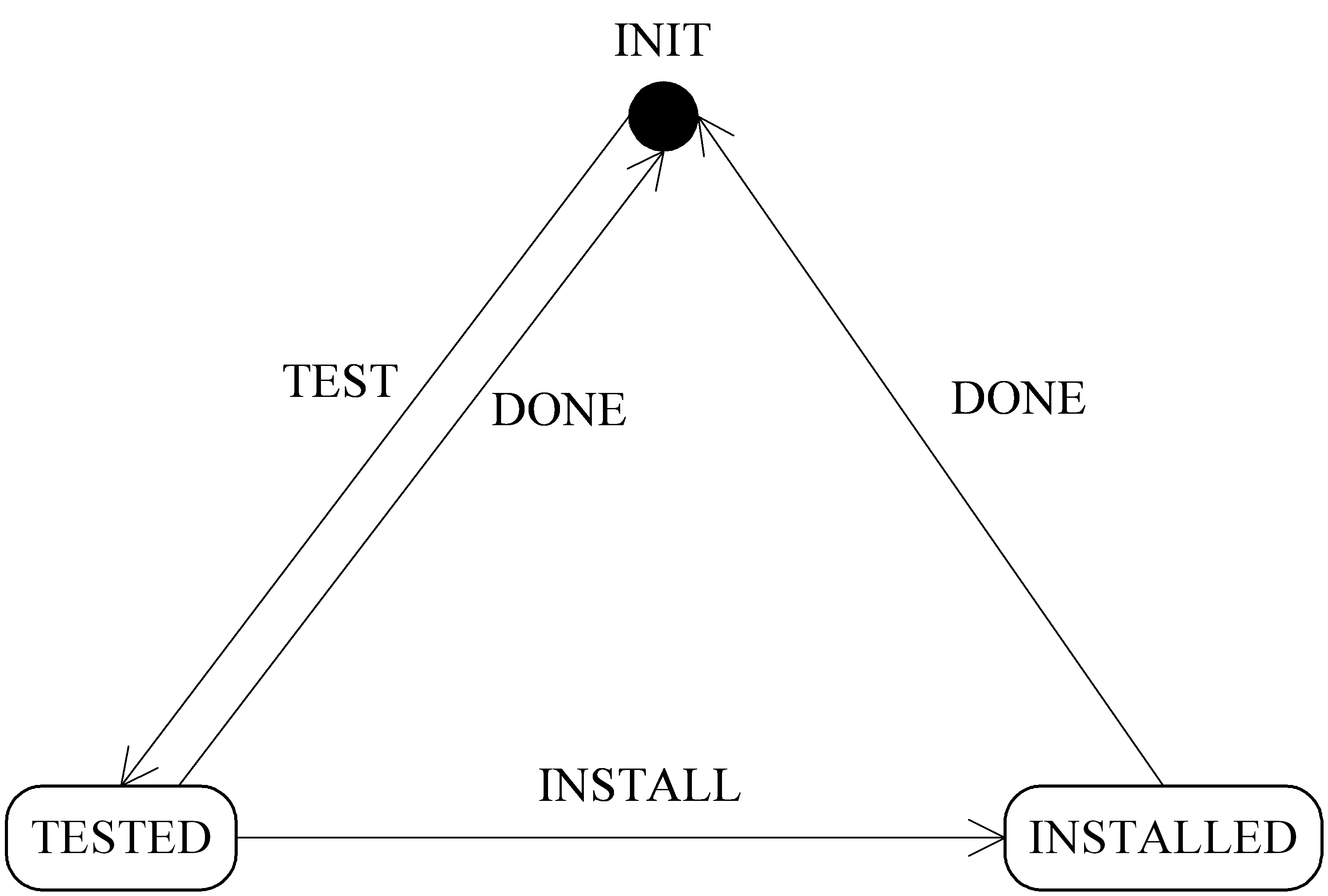

As shown in Figure 1, perform a test operation only in initial state. After you perform the test operation, perform an install operation depending on the test operation result.
You can perform a done operation to change the ISSU state to the initial state after you have performed a test, install or rollback operation. The done operation clears hh3cIssuUpgradeImageTable, restores the FileOverwrite and TrapEnable objects to their default values.
You can perform a rollback whenever you like. However, the operation does not take effect if you have only performed a test operation.
After you issue a rollback instruction, the system moves the current opType, opStatus, opFailedReason, and opTimeCompleted values to their respective LastOp entries if a rollback is allowed.
Five minutes later after an install or rollback operation succeeds, the system copies the current OpType, OpStatus, OpFailedReason, and OpTimeCompleted values to their respective LastOp objects. Another five minutes later, all these Op objects are restored to their default values.
Figure 1 ISSU operations
