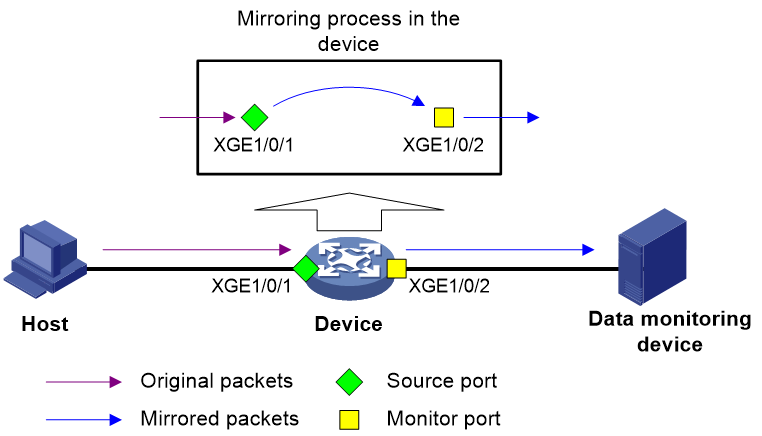

Local port mirroring
In local port mirroring, the following conditions exist:
·     The source device is directly connected to a data monitoring device.
·     The source device acts as the destination device to forward mirrored packets to the data monitoring device.
A local mirroring group is a mirroring group that contains the mirroring sources and the mirroring destination on the same device.
Figure 1 Local port mirroring implementation
As shown in Figure 1, the source port (Ten-GigabitEthernet 1/0/1) and the monitor port (Ten-GigabitEthernet 1/0/2) reside on the same device. Packets received on Ten-GigabitEthernet 1/0/1 are copied to Ten-GigabitEthernet 1/0/2. Ten-GigabitEthernet 1/0/2 then forwards the packets to the data monitoring device for analysis.

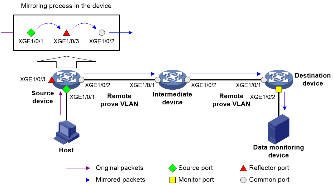

Layer 2 remote port mirroring can be implemented when a reflector port or an egress port is available on the source device. The method to use the reflector port and the method to use the egress port are called reflector port method and egress port method, respectively.
·     Reflector port method—Packets are mirrored as follows:
¡     The source device copies packets received on the mirroring sources to the reflector port.
¡     The reflector port broadcasts the mirrored packets in the remote probe VLAN.
¡     The intermediate devices transmit the mirrored packets to the destination device through the remote probe VLAN.
¡     Upon receiving the mirrored packets, the destination device determines whether the ID of the mirrored packets is the same as the remote probe VLAN ID. If the two VLAN IDs match, the destination device forwards the mirrored packets to the data monitoring device through the monitor port.
Figure 2 Layer 2 remote port mirroring implementation through the reflector port method

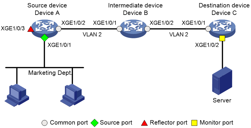

·     Egress port method—Packets are mirrored as follows:
¡     The source device copies packets received on the mirroring sources to the egress port.
¡     The egress port forwards the mirrored packets to the intermediate devices.
¡     The intermediate devices flood the mirrored packets in the remote probe VLAN and transmit the mirrored packets to the destination device.
Figure 3 Layer 2 remote port mirroring implementation through the egress port method

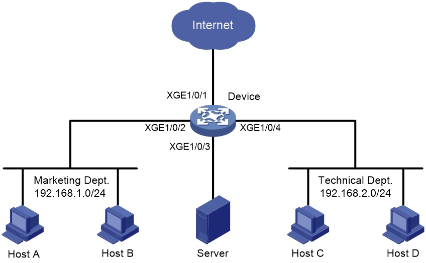

Local port mirroring configuration example
Network requirements
As shown in Figure 4, configure local port mirroring in source port mode to enable the server to monitor the bidirectional traffic of the two departments.
Figure 4 Network diagram
Configuration procedure
# Create local mirroring group 1.
<Device> system-view
[Device] mirroring-group 1 local
# Configure Ten-GigabitEthernet 1/0/1 and Ten-GigabitEthernet 1/0/2 as source ports for local mirroring group 1.
[Device] mirroring-group 1 mirroring-port ten-gigabitethernet 1/0/1 ten-gigabitethernet 1/0/2 both
# Configure Ten-GigabitEthernet 1/0/3 as the monitor port for local mirroring group 1.
[Device] mirroring-group 1 monitor-port ten-gigabitethernet 1/0/3
# Disable the spanning tree feature on the monitor port (Ten-GigabitEthernet 1/0/3).
[Device] interface ten-gigabitethernet 1/0/3
[Device-Ten-GigabitEthernet1/0/3] undo stp enable
[Device-Ten-GigabitEthernet1/0/3] quit
# Verify the mirroring group configuration.
[Device] display mirroring-group all
Mirroring group 1:
    Type: Local
    Status: Active
    Mirroring port:
        Ten-GigabitEthernet1/0/1  Both
        Ten-GigabitEthernet1/0/2  Both
    Monitor port: Ten-GigabitEthernet1/0/3
Layer 2 remote port mirroring configuration example (reflector port)
As shown in Figure 5, configure Layer 2 remote port mirroring to enable the server to monitor the bidirectional traffic of the Marketing Department.
Figure 5 Network diagram
1.     Configure Device C (the destination device):
# Configure Ten-GigabitEthernet 1/0/1 as a trunk port, and assign the port to VLAN 2.
<DeviceC> system-view
[DeviceC] interface ten-gigabitethernet 1/0/1
[DeviceC-Ten-GigabitEthernet1/0/1] port link-type trunk
[DeviceC-Ten-GigabitEthernet1/0/1] port trunk permit vlan 2
[DeviceC-Ten-GigabitEthernet1/0/1] quit
# Create a remote destination group.
[DeviceC] mirroring-group 2 remote-destination
# Create VLAN 2.
[DeviceC] vlan 2
# Disable MAC address learning for VLAN 2.
[DeviceC-vlan2] undo mac-address mac-learning enable
[DeviceC-vlan2] quit
# Configure VLAN 2 as the remote probe VLAN for the mirroring group.
[DeviceC] mirroring-group 2 remote-probe vlan 2
# Configure Ten-GigabitEthernet 1/0/2 as the monitor port for the mirroring group.
[DeviceC] interface ten-gigabitethernet 1/0/2
[DeviceC-Ten-GigabitEthernet1/0/2] mirroring-group 2 monitor-port
# Disable the spanning tree feature on Ten-GigabitEthernet 1/0/2.
[DeviceC-Ten-GigabitEthernet1/0/2] undo stp enable
# Assign Ten-GigabitEthernet 1/0/2 to VLAN 2.
[DeviceC-Ten-GigabitEthernet1/0/2] port access vlan 2
[DeviceC-Ten-GigabitEthernet1/0/2] quit
2.     Configure Device B (the intermediate device):
# Create VLAN 2.
<DeviceB> system-view
[DeviceB] vlan 2
[DeviceB-vlan2] undo mac-address mac-learning enable
[DeviceB-vlan2] quit
[DeviceB] interface ten-gigabitethernet 1/0/1
[DeviceB-Ten-GigabitEthernet1/0/1] port link-type trunk
[DeviceB-Ten-GigabitEthernet1/0/1] port trunk permit vlan 2
[DeviceB-Ten-GigabitEthernet1/0/1] quit
# Configure Ten-GigabitEthernet 1/0/2 as a trunk port, and assign the port to VLAN 2.
[DeviceB] interface ten-gigabitethernet 1/0/2
[DeviceB-Ten-GigabitEthernet1/0/2] port link-type trunk
[DeviceB-Ten-GigabitEthernet1/0/2] port trunk permit vlan 2
[DeviceB-Ten-GigabitEthernet1/0/2] quit
3.     Configure Device A (the source device):
# Create a remote source group.
<DeviceA> system-view
[DeviceA] mirroring-group 1 remote-source
# Create VLAN 2.
[DeviceA] vlan 2
[DeviceA-vlan2] undo mac-address mac-learning enable
[DeviceA-vlan2] quit
[DeviceA] mirroring-group 1 remote-probe vlan 2
# Configure Ten-GigabitEthernet 1/0/1 as a source port for the mirroring group.
[DeviceA] mirroring-group 1 mirroring-port ten-gigabitethernet 1/0/1 both
# Configure Ten-GigabitEthernet 1/0/3 as the reflector port for the mirroring group.
[DeviceA] mirroring-group 1 reflector-port ten-gigabitethernet 1/0/3
This operation may delete all settings made on the interface. Continue? [Y/N]: y
[DeviceA] interface ten-gigabitethernet 1/0/2
[DeviceA-Ten-GigabitEthernet1/0/2] port link-type trunk
[DeviceA-Ten-GigabitEthernet1/0/2] port trunk permit vlan 2
[DeviceA-Ten-GigabitEthernet1/0/2] quit
# Verify the mirroring group configuration on Device C.
[DeviceC] display mirroring-group all
Mirroring group 2:
    Type: Remote destination
    Status: Active
    Monitor port: Ten-GigabitEthernet1/0/2
    Remote probe VLAN: 2
# Verify the mirroring group configuration on Device A.
[DeviceA] display mirroring-group all
Mirroring group 1:
    Type: Remote source
    Status: Active
    Mirroring port:
    Reflector port: Ten-GigabitEthernet1/0/3
Layer 2 remote port mirroring configuration example (with egress port)
On the Layer 2 network shown in Figure 6, configure Layer 2 remote port mirroring to enable the server to monitor the bidirectional traffic of the Marketing Department.
Figure 6 Network diagram
# Create VLAN 2.
[DeviceC] vlan 2
# Assign Ten-GigabitEthernet 1/0/2 to VLAN 2 as an access port.
# Create VLAN 2.
[DeviceB] vlan 2
# Create VLAN 2.
[DeviceA] vlan 2
# Configure VLAN 2 as the remote probe VLAN of the mirroring group.
# Configure Ten-GigabitEthernet 1/0/2 as the egress port for the mirroring group.
[DeviceA] mirroring-group 1 monitor-egress ten-gigabitethernet 1/0/2
# Disable the spanning tree feature on the port.
[DeviceA-Ten-GigabitEthernet1/0/2] undo stp enable
Mirroring group 2:
    Status: Active
Mirroring group 1:
    Type: Remote source
    Status: Active
    Mirroring port:
    Monitor egress port: Ten-GigabitEthernet1/0/2

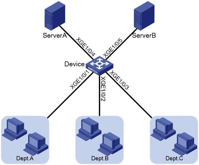

Local port mirroring with multiple monitor ports configuration example
As shown in Figure 7, Dept. A, Dept. B, and Dept. C are connected to the device through Ten-GigabitEthernet 1/0/1, Ten-GigabitEthernet 1/0/2, and Ten-GigabitEthernet 1/0/3, respectively.
Configure port mirroring to enable data monitoring devices Server A and Server B to monitor both the incoming and outgoing traffic of the three departments.
Figure 7 Network diagram
# Create remote source group 1.
[Device] mirroring-group 1 remote-source
# Configure Ten-GigabitEthernet 1/0/1 through Ten-GigabitEthernet 1/0/3 as source ports of remote source group 1.
[Device] mirroring-group 1 mirroring-port ten-gigabitethernet 1/0/1 to ten-gigabitethernet 1/0/3 both
# Configure an unused port (Ten-GigabitEthernet 1/0/6 in this example) as the reflector port of remote source group 1.
[Device] mirroring-group 1 reflector-port ten-gigabitethernet 1/0/6
This operation may delete all settings made on the interface. Continue? [Y/N]:y
# Create VLAN 10 and assign the ports connecting the data monitoring devices to the VLAN.
[Device] vlan 10
[Device-vlan10] port ten-gigabitethernet 1/0/4 to ten-gigabitethernet 1/0/5
[Device-vlan10] quit
# Configure VLAN 10 as the remote probe VLAN of remote source group 1.
[Device] mirroring-group 1 remote-probe vlan 10

IP traffic that the Technical Department sends to the Marketing Department during working hours (8:00 to 18:00) on weekdays.
Figure 8 Network diagram
# Create working hour range work, in which working hours are from 8:00 to 18:00 on weekdays.
[DeviceA] time-range work 8:00 to 18:00 working-day
# Create IPv4 advanced ACL 3000 to allow packets from the Technical Department to access the Internet and the Marketing Department during working hours.
[DeviceA] acl advanced 3000
[DeviceA-acl-ipv4-adv-3000] rule permit tcp source 192.168.2.0 0.0.0.255 destination-port eq www
[DeviceA-acl-ipv4-adv-3000] rule permit ip source 192.168.2.0 0.0.0.255 destination 192.168.1.0 0.0.0.255 time-range work
[DeviceA-acl-ipv4-adv-3000] quit
# Create traffic class tech_c, and configure the match criterion as ACL 3000.
[DeviceA] traffic classifier tech_c
[DeviceA-classifier-tech_c] if-match acl 3000
[DeviceA-classifier-tech_c] quit
# Create traffic behavior tech_b, configure the action of mirroring traffic to Ten-GigabitEthernet 1/0/3.
[DeviceA] traffic behavior tech_b
[DeviceA-behavior-tech_b] mirror-to interface ten-gigabitethernet 1/0/3
[DeviceA-behavior-tech_b] quit
# Create QoS policy tech_p, and associate traffic class tech_c with traffic behavior tech_b in the QoS policy.
[DeviceA] qos policy tech_p
[DeviceA-qospolicy-tech_p] classifier tech_c behavior tech_b
[DeviceA-qospolicy-tech_p] quit
# Apply QoS policy tech_p to the incoming packets of Ten-GigabitEthernet 1/0/4.
[DeviceA] interface ten-gigabitethernet 1/0/4
[DeviceA-Ten-GigabitEthernet1/0/4] qos apply policy tech_p inbound
[DeviceA-Ten-GigabitEthernet1/0/4] quit
# Verify that the server can monitor the following traffic:
All traffic sent by the Technical Department to access the Internet.
IP traffic that the Technical Department sends to the Marketing Department during working hours on weekdays.
(Details not shown.)
