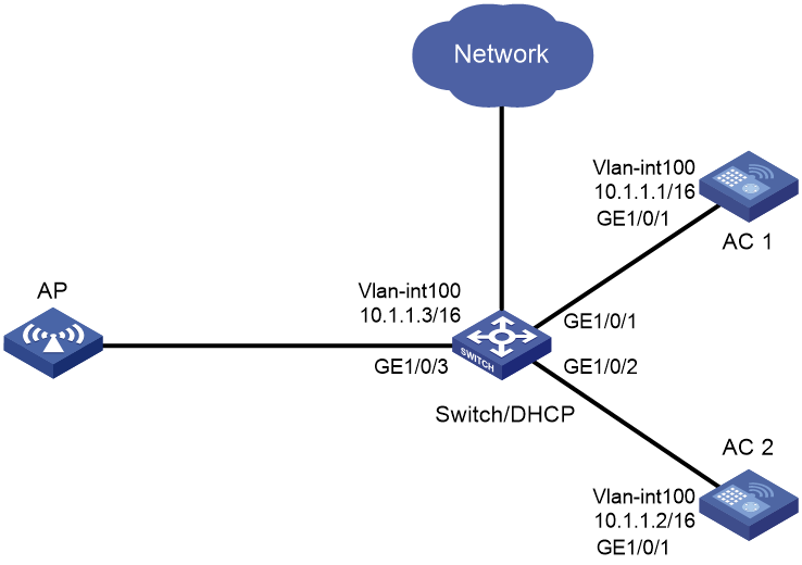

Network requirements
As shown in Figure 1, configure AC 1 as the master AC and AC 2 as the backup AC. When AC 1 fails and AC 2 takes over, the AP can communicate through AC 2. Configure the master CAPWAP tunnel preemption feature on the two ACs so that the AP reconnects to AC 1 when AC 1 recovers.
Enable AP license synchronization on AC 1 and AC 2 for the two ACs to back up licenses for each other.
Figure 1 Network diagram
