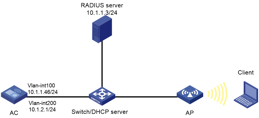

As shown in Figure 1, the switch acts as a DHCP server to assign IP addresses to the AP and the client. The RADIUS server runs on IMC.
Configure the AC, the client, the switch, and the RADIUS server to meet the following requirements:
·     The AC uses the RADIUS server to perform 802.1X authentication for the wireless client.
·     The AC uses the open system authentication for the client at the data link layer. This is the default authentication method.
·     The AC uses the 802.1X AKM mode to secure data transmission between the client and the AP.
·     The cipher suite is CCMP.
Figure 1 Network diagram

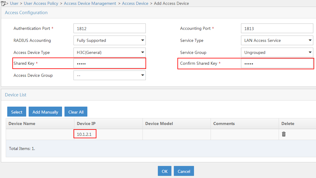

1.     Add the AC to IMC as an access device:
a.     Log in to IMC and click the User tab.
b.     From the navigation tree, select User Access Policy > Access Device Management > Access Device.
c.     Click Add.
The Add Access Device page opens.
d.     In the Access Configuration area, configure the following parameters, as shown in Figure 2:
-     Enter 12345 in the Shared Key and Confirm Shared Key fields.
-     Use the default values for other parameters.
e.     In the Device List area, click Select or Add Manually to add the device at 10.1.2.1 as an access device.
f.     Click OK.
Figure 2 Adding an access device

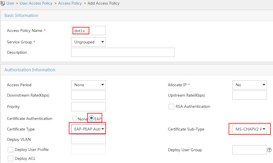

2.     Add an access policy:
a.     Click the User tab.
b.     From the navigation tree, select User Access Policy > Access Policy.
c.     Click Add.
d.     On the Add Access Policy page, configure the following parameters, as shown in Figure 3:
-     Enter dot1x in the Access Policy Name field.
-     Select EAP for the Certificate Authentication field.
-     Select EAP-PEAP Auth from the Certificate Type list, and select MS-CHAPV2 Auth from the Certificate Sub-Type list.
The certificate sub-type on the IMC server must be the same as the identity authentication method configured on the client.
e.     Click OK.
Figure 3 Adding an access policy

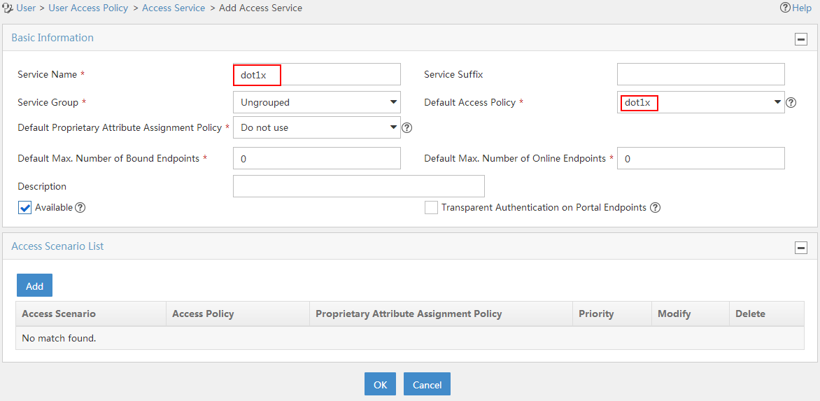

3.     Add an access service:
b.     From the navigation tree, select User Access Policy > Access Service.
c.     Click Add.
d.     On the Add Access Service page, configure the following parameters, as shown in Figure 4:
-     Enter dot1x in the Service Name field.
-     Select dot1x from the Default Access Policy list.
e.     Click OK.
Figure 4 Adding an access service
