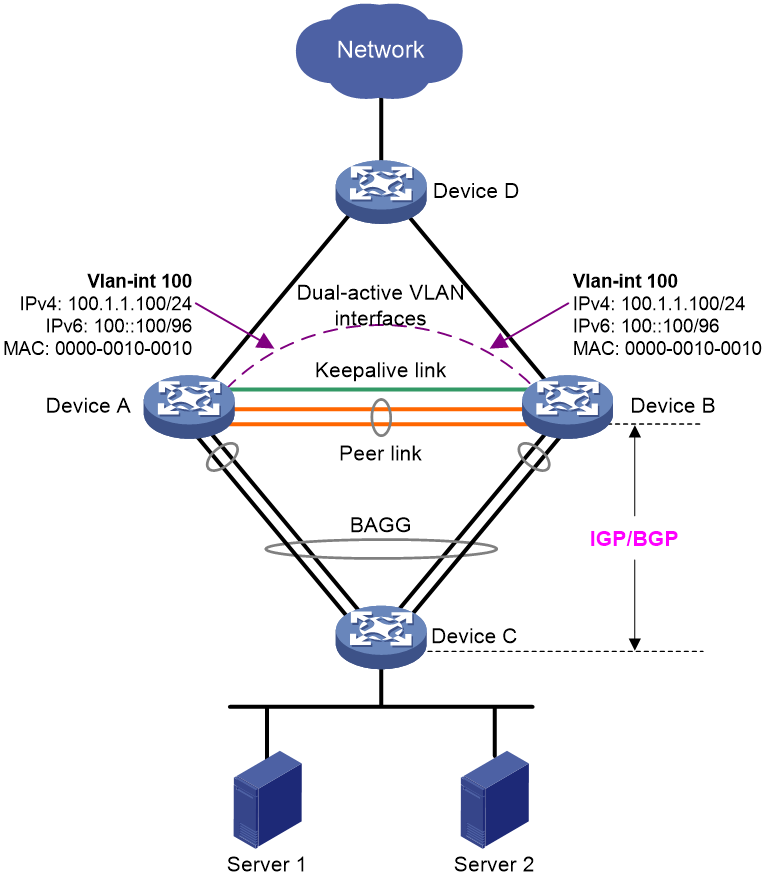

Dual-active gateways on an M-LAG system
When a Layer 3 network is dualhomed to an M-LAG system, each M-LAG member device uses a logical interface as the gateway interface for the Layer 3 network. Both logical interfaces are active to perform Layer 3 forwarding, and they use the same IP address and MAC address. When both links to the M-LAG system are operating correctly, the links load share traffic to balance bandwidth usage. When one of the links fails, the M-LAG system switches the traffic on the failed link to the other link to ensure high availability.
Typically, dual-active gateways are deployed if downstream devices run a dynamic routing protocol to communicate with the M-LAG system. As shown in Figure 4, IGP or BGP runs between Device C and the M-LAG system. To configure dual-active VLAN interfaces, perform the following tasks on Device A and Device B:
1.     Create VLAN interfaces for the same VLAN, VLAN-interface 100 for example, assign the same IPv4, IPv6, and MAC addresses to the VLAN interfaces, and assign the M-LAG interfaces to that VLAN.
2.     Assign different M-LAG VIPs to the VLAN interfaces.
Device A and Device B use their M-LAG VIPs to set up IGP or BGP peer relationships with Device C and with each other.
Figure 4 Layer 3 access to an M-LAG system through dynamic routing protocols

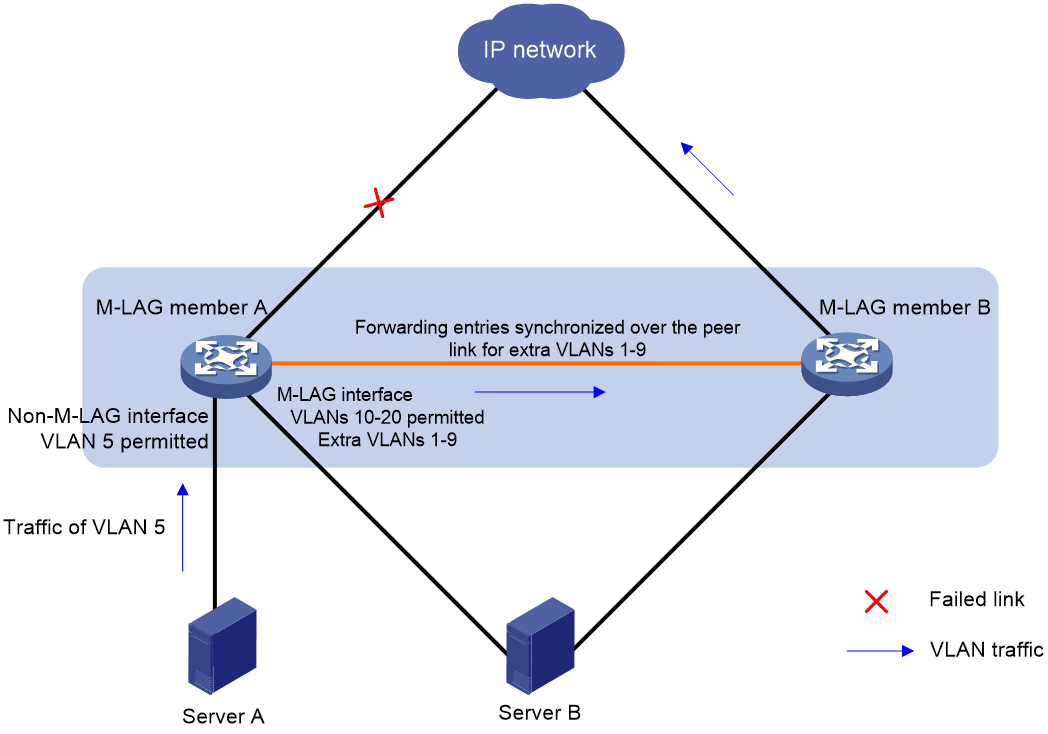

Configuring M-LAG extra VLANs
For VLANs permitted only on non-M-LAG interfaces, the device processes traffic locally and do not synchronize forwarding entries such as MAC and ARP entries with the M-LAG peer device. For the device to synchronize forwarding entries for such VLANs, configure them as extra VLANs. The device will synchronize forwarding entries for the extra VLANs even though they are not permitted on M-LAG interfaces, as shown in Figure 13. When the uplink of one M-LAG member device fails, traffic of the extra VLANs can fail over to the other M-LAG member device through the peer link.
Figure 13 M-LAG extra VLANs
2.     Configure M-LAG extra VLANs.
m-lag extra-vlan vlan-id-list
By default, no M-LAG extra VLANs are configured.

# Create Layer 2 dynamic aggregate interface Bridge-Aggregation 1.
[DeviceA] interface bridge-aggregation 1
[DeviceA-Bridge-Aggregation1] link-aggregation mode dynamic
[DeviceA-Bridge-Aggregation1] quit
# Assign Twenty-FiveGigE 1/0/3 and Twenty-FiveGigE 1/0/4 to aggregation group 1.
[DeviceA] interface twenty-fivegige 1/0/3
[DeviceA-Twenty-FiveGigE1/0/3] port link-aggregation group 1
[DeviceA-Twenty-FiveGigE1/0/3] quit
[DeviceA] interface twenty-fivegige 1/0/4
[DeviceA-Twenty-FiveGigE1/0/4] port link-aggregation group 1
[DeviceA-Twenty-FiveGigE1/0/4] quit
# Configure Bridge-Aggregation 1 as the peer-link interface.
[DeviceA-Bridge-Aggregation1] port m-lag peer-link 1
[DeviceA-Bridge-Aggregation1] undo mac-address static source-check enable
# Create Layer 2 dynamic aggregate interface Bridge-Aggregation 3, and assign it to M-LAG group 1.
[DeviceA] interface bridge-aggregation 3
[DeviceA-Bridge-Aggregation3] link-aggregation mode dynamic
[DeviceA-Bridge-Aggregation3] port m-lag group 1
[DeviceA-Bridge-Aggregation3] quit
# Assign Twenty-FiveGigE 1/0/1 and Twenty-FiveGigE 1/0/2 to aggregation group 3.
[DeviceA] interface twenty-fivegige 1/0/1
[DeviceA-Twenty-FiveGigE1/0/1] port link-aggregation group 3
[DeviceA-Twenty-FiveGigE1/0/1] quit
[DeviceA] interface twenty-fivegige 1/0/2
[DeviceA-Twenty-FiveGigE1/0/2] port link-aggregation group 3
[DeviceA-Twenty-FiveGigE1/0/2] quit
# Create VLAN 102 and VLAN 103.
[DeviceA] vlan 102 103
# Set the link type of Bridge-Aggregation 3 to trunk, and assign it to VLAN 102 and VLAN 103.
[DeviceA-Bridge-Aggregation3] port link-type trunk
[DeviceA-Bridge-Aggregation3] port trunk permit vlan 102 103
# Create VLAN-interface 102 and assign it an IPv4 address and an IPv6 address for the interface to act as an IPv4 and IPv6 gateway.
[DeviceA] interface vlan-interface 102
[DeviceA-Vlan-interface102] ip address 10.102.0.1 255.255.255.0
[DeviceA-Vlan-interface102] ipv6 address 10:102::1 64
# Assign M-LAG virtual IPv4 and IPv6 addresses to VLAN-interface 102 for Device A to establish OSPF and OSPFv3 neighbor relationships with Device D.
[DeviceA-Vlan-interface102] port m-lag virtual-ip 10.102.0.3 24 active
[DeviceA-Vlan-interface102] port m-lag ipv6 virtual-ip 10:102::3 64 active
[DeviceA-Vlan-interface102] port m-lag ipv6 virtual-ip FE80::102:3 link-local
# Assign a MAC address to VLAN-interface 102.
[DeviceA-Vlan-interface102] mac-address 3-3-3
[DeviceA-Vlan-interface102] quit
# Exclude VLAN-interface 102 from the shutdown action by M-LAG MAD.
[DeviceA] m-lag mad exclude interface vlan-interface 102
# Create VLAN-interface 103 and assign it an IPv4 address and an IPv6 address for the interface to act as an IPv4 and IPv6 gateway.
[DeviceA] interface vlan-interface 103
[DeviceA-Vlan-interface103] ip address 10.103.0.1 24
[DeviceA-Vlan-interface103] ipv6 address 10:103::1 64
# Assign M-LAG virtual IPv4 and IPv6 addresses to VLAN-interface 103 for Device A to establish BGP and BGP4+ peer relationships with Device D.
[DeviceA-Vlan-interface103] port m-lag virtual-ip 10.103.0.3 24 active
[DeviceA-Vlan-interface103] port m-lag ipv6 virtual-ip 10:103::3 64 active
[DeviceA-Vlan-interface103] port m-lag ipv6 virtual-ip FE80::103:3 link-local
# Assign a MAC address to VLAN-interface 103.
[DeviceA-Vlan-interface103] mac-address 4-4-4
[DeviceA-Vlan-interface103] quit
# Exclude VLAN-interface 103 from the shutdown action by M-LAG MAD.
[DeviceA] m-lag mad exclude interface vlan-interface 103
# Assign an IPv4 address and an IPv6 address to uplink interface Twenty-FiveGigE 1/0/6.
[DeviceA] interface twenty-fivegige 1/0/6
[DeviceA-Twenty-FiveGigE1/0/6] port link-mode route
[DeviceA-Twenty-FiveGigE1/0/6] ip address 32.1.1.1 24
[DeviceA-Twenty-FiveGigE1/0/6] ipv6 address 32:1::1 64
[DeviceA-Twenty-FiveGigE1/0/6] quit
# Configure OSPF.
[DeviceA] ospf 1 router-id 11.1.1.1
[DeviceA-ospf-1] area 0
[DeviceA-ospf-1-area-0.0.0.0] quit
[DeviceA-ospf-1] quit
[DeviceA-Vlan-interface102] ospf 1 area 0
[DeviceA-Vlan-interface102] ospf peer sub-address enable 10.102.0.3
[DeviceA-Twenty-FiveGigE1/0/6] ospf 1 area 0
# Configure OSPFv3.
[DeviceA] ospfv3 1
[DeviceA-ospfv3-1] router-id 10.1.1.1
[DeviceA-ospfv3-1] area 0
[DeviceA-ospfv3-1-area-0.0.0.0] quit
[DeviceA-ospfv3-1] quit
[DeviceA-Vlan-interface102] ospfv3 1 area 0
[DeviceA-Twenty-FiveGigE1/0/6] ospfv3 1 area 0
# Configure BGP.
[DeviceA] bgp 100
[DeviceA-bgp-default] router-id 12.1.1.1
[DeviceA-bgp-default] peer 32.1.1.2 as-number 100
[DeviceA-bgp-default] peer 10.103.0.2 as-number 100
[DeviceA-bgp-default] peer 10.103.0.2 source-address 10.103.0.3
[DeviceA-bgp-default] address-family ipv4
[DeviceA-bgp-default-ipv4] peer 10.103.0.2 enable
[DeviceA-bgp-default-ipv4] network 10.103.0.0  255.255.255.0
[DeviceA-bgp-default-ipv4] peer 32.1.1.2 enable
[DeviceA-bgp-default-ipv4] network 32.1.1.0 255.255.255.0
[DeviceA-bgp-default-ipv4] quit
# Configure BGP4+.
[DeviceA-bgp-default] peer 32:1::2 as-number 100
[DeviceA-bgp-default] peer 10:103::2 as-number 100
[DeviceA-bgp-default] peer 10:103::2 source-address 10:103::3
[DeviceA-bgp-default] address-family ipv6
[DeviceA-bgp-default-ipv6] peer 10:103::2 enable
[DeviceA-bgp-default-ipv6] network 10:103::2  64
[DeviceA-bgp-default-ipv6] peer 32:1::2 enable
[DeviceA-bgp-default-ipv6] network  32:1::2 64
[DeviceA-bgp-default-ipv6] quit
[DeviceA-bgp-default] quit
2.     Configure Device B:
# Configure M-LAG system settings.
<DeviceB> system-view
[DeviceB] m-lag system-mac 2-2-2
[DeviceB] m-lag system-number 2
[DeviceB] m-lag system-priority 123
# Configure M-LAG keepalive parameters.
[DeviceB] m-lag keepalive ip destination 21.1.1.1 source 21.1.1.2
# Set the link mode of Twenty-FiveGigE 1/0/5 to Layer 3, and assign the interface IPv4 and IPv6 addresses. The IPv4 address will be used as the source IP address of keepalive packets.
[DeviceB] interface twenty-fivegige 1/0/5
[DeviceB-Twenty-FiveGigE1/0/5] port link-mode route
[DeviceB-Twenty-FiveGigE1/0/5] ip address 21.1.1.2 255.255.255.0
[DeviceB-Twenty-FiveGigE1/0/5] ipv6 address 21::2 64
[DeviceB-Twenty-FiveGigE1/0/5] quit
# Exclude the interface used for M-LAG keepalive detection (Twenty-FiveGigE 1/0/5) from the shutdown action by M-LAG MAD.
[DeviceB] m-lag mad exclude interface twenty-fivegige 1/0/5
[DeviceB] interface bridge-aggregation 1
[DeviceB-Bridge-Aggregation1] link-aggregation mode dynamic
[DeviceB-Bridge-Aggregation1] quit
[DeviceB] interface twenty-fivegige 1/0/3
[DeviceB-Twenty-FiveGigE1/0/3] port link-aggregation group 1
[DeviceB-Twenty-FiveGigE1/0/3] quit
[DeviceB] interface twenty-fivegige 1/0/4
[DeviceB-Twenty-FiveGigE1/0/4] port link-aggregation group 1
[DeviceB-Twenty-FiveGigE1/0/4] quit
[DeviceB-Bridge-Aggregation1] port m-lag peer-link 1
[DeviceB-Bridge-Aggregation1] undo mac-address static source-check enable
[DeviceB] interface bridge-aggregation 3
[DeviceB-Bridge-Aggregation3] link-aggregation mode dynamic
[DeviceB-Bridge-Aggregation3] port m-lag group 1
[DeviceB-Bridge-Aggregation3] quit
[DeviceB] interface twenty-fivegige 1/0/1
[DeviceB-Twenty-FiveGigE1/0/1] port link-aggregation group 3
[DeviceB-Twenty-FiveGigE1/0/1] quit
[DeviceB] interface twenty-fivegige 1/0/2
[DeviceB-Twenty-FiveGigE1/0/2] port link-aggregation group 3
[DeviceB-Twenty-FiveGigE1/0/2] quit
[DeviceB] vlan 102 103
[DeviceB-Bridge-Aggregation3] port link-type trunk
[DeviceB-Bridge-Aggregation3] port trunk permit vlan 102 103
[DeviceB] interface vlan-interface 102
[DeviceB-Vlan-interface102] ip address 10.102.0.1 24
[DeviceB-Vlan-interface102] ipv6 address 10:102::1 64
[DeviceB-Vlan-interface102] port m-lag virtual-ip 10.102.0.4 24 active
[DeviceB-Vlan-interface102] port m-lag ipv6 virtual-ip 10:102::4 64 active
[DeviceB-Vlan-interface102] port m-lag ipv6 virtual-ip FE80::102:4 link-local
[DeviceB-Vlan-interface102] mac-address 3-3-3
[DeviceB-Vlan-interface102] quit
[DeviceB] m-lag mad exclude interface vlan-interface 102
[DeviceB] interface vlan-interface 103
[DeviceB-Vlan-interface103] ip address 10.103.0.1 24
[DeviceB-Vlan-interface103] ipv6 address 10:103::1 64
[DeviceB-Vlan-interface103] port m-lag virtual-ip 10.103.0.4 24 active
[DeviceB-Vlan-interface103] port m-lag ipv6 virtual-ip 10:103::4 64 active
[DeviceB-Vlan-interface103] port m-lag ipv6 virtual-ip FE80::103:4 link-local
[DeviceB-Vlan-interface103] mac-address 4-4-4
[DeviceB-Vlan-interface103] quit
[DeviceB] m-lag mad exclude interface vlan-interface 103
[DeviceB] interface twenty-fivegige 1/0/6
[DeviceB-Twenty-FiveGigE1/0/6] port link-mode route
[DeviceB-Twenty-FiveGigE1/0/6] ip address 33.1.1.1 24
[DeviceB-Twenty-FiveGigE1/0/6] ipv6 address 33:1::1 64
[DeviceB-Twenty-FiveGigE1/0/6] quit
# Configure OSPF.
[DeviceB] ospf 1 router-id 11.1.1.2
[DeviceB-ospf-1] area 0
[DeviceB-ospf-1-area-0.0.0.0] quit
[DeviceB-ospf-1] quit
[DeviceB-Vlan-interface102] ospf 1 area 0
[DeviceB-Vlan-interface102] ospf peer sub-address enable 10.102.0.4
[DeviceB-Twenty-FiveGigE1/0/6] ospf 1 area 0
# Configure OSPFv3.
[DeviceB] ospfv3 1
[DeviceB-ospfv3-1] router-id 10.1.1.2
[DeviceB-ospfv3-1] area 0
[DeviceB-ospfv3-1-area-0.0.0.0] quit
[DeviceB-ospfv3-1] quit
[DeviceB-Vlan-interface102] ospfv3 1 area 0
[DeviceB-Twenty-FiveGigE1/0/6] ospfv3 1 area 0
# Configure BGP.
[DeviceB] bgp 100
[DeviceB-bgp-default] router-id 12.1.1.2
[DeviceB-bgp-default] peer 33.1.1.2 as-number 100
[DeviceB-bgp-default] peer 10.103.0.2 as-number 100
[DeviceB-bgp-default] peer 10.103.0.2 source-address 10.103.0.4
[DeviceB-bgp-default] address-family ipv4
[DeviceB-bgp-default-ipv4] peer 10.103.0.2 enable
[DeviceB-bgp-default-ipv4] network 10.103.0.0  255.255.255.0
[DeviceB-bgp-default-ipv4] peer 33.1.1.2 enable
[DeviceB-bgp-default-ipv4] network 33.1.1.0 255.255.255.0
[DeviceB-bgp-default-ipv4] quit
# Configure BGP4+.
[DeviceB-bgp-default] peer 33:1::2 as-number 100
[DeviceB-bgp-default] peer 10:103::2 as-number 100
[DeviceB-bgp-default] peer 10:103::2 source-address 10:103::4
[DeviceB-bgp-default] address-family ipv6
[DeviceB-bgp-default-ipv6] peer 10:103::2 enable
[DeviceB-bgp-default-ipv6] network 10:103::2  64
[DeviceB-bgp-default-ipv6] peer 33:1::2 enable
[DeviceB-bgp-default-ipv6] network  33:1::2 64
[DeviceB-bgp-default-ipv6] quit
[DeviceB-bgp-default] quit
3.     Configure Device C:
# Assign IPv4 and IPv6 addresses to both Twenty-FiveGigE 1/0/1 and Twenty-FiveGigE 1/0/2.
[DeviceC] interface twenty-fivegige 1/0/1
[DeviceC-Twenty-FiveGigE1/0/1] port link-mode route
[DeviceC-Twenty-FiveGigE1/0/1] ip address 32.1.1.2 24
[DeviceC-Twenty-FiveGigE1/0/1] ipv6 address 32:1::2 64
[DeviceC-Twenty-FiveGigE1/0/1] quit
[DeviceC] interface twenty-fivegige 1/0/2
[DeviceC-Twenty-FiveGigE1/0/2] port link-mode route
[DeviceC-Twenty-FiveGigE1/0/2] ip address 33.1.1.2 24
[DeviceC-Twenty-FiveGigE1/0/2] ipv6 address 33:1::2 64
[DeviceC-Twenty-FiveGigE1/0/2] quit
# Configure OSPF.
[DeviceC] ospf 1 router-id 11.1.1.3
[DeviceC-ospf-1] area 0
[DeviceC-ospf-1-area-0.0.0.0] quit
[DeviceC-ospf-1] quit
