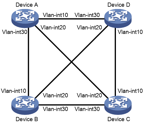

Figure 2 shows one IS-IS network topology. Area 1 is the backbone that comprises a set of Level-2 routers. The other four areas are non-backbone areas connected to the backbone through Level-1-2 routers.
Figure 2 IS-IS topology 1
Figure 3 shows another IS-IS topology. No area is defined as the backbone in this topology. The backbone comprises all contiguous Level-2 and Level-1-2 routers in different areas. The IS-IS backbone does not need to be a specific area.
Figure 3 IS-IS topology 2
Both the Level-1 and Level-2 routers use the SPF algorithm to generate the shortest path tree.

To resolve this issue, configure IPv6 IS-IS MTR to perform route calculation separately in IPv4 and IPv6 topologies.
Figure 7 Network diagram
As shown in Figure 7, the numbers refer to the link costs. Router A, Router B, and Router D support both IPv4 and IPv6. Router C supports only IPv4 and cannot forward IPv6 packets.
Enable IPv6 IS-IS MTR on Router A, Router B, Router C, and Router D to make them perform route calculation separately in IPv4 and IPv6 topologies. With this configuration, Router A does not forward IPv6 packets destined to Router D through Router B, avoiding packet loss.
As a best practice to avoid route calculation failures, configure this feature when both IPv4 and IPv6 topologies exist in the network.

Limiting LSP flooding
On a fully meshed network, many P2P links exist. As shown in Figure 8, Devices A, B, C and D run IS-IS. When Device A generates an LSP, it floods the LSP out of VLAN-interface 10, VLAN-interface 20, and VLAN-interface 30. After Device D receives the LSP from VLAN-interface 30, it floods it out of VLAN-interface 10 and VLAN-interface 20 to Device B and Device C. However, Device B and Device C have already received the LSP from Device A. Repeated LSP flooding consumes extra bandwidth.
Figure 8 Network diagram of a fully meshed network
To avoid this problem, you can add interfaces to a mesh group or block some interfaces.
·     An interface in a mesh group floods a received LSP only to interfaces not in the mesh group.
·     A blocked interface sends LSPs only after receiving LSP requests.
Before you configure this task, you must consider redundancy for interfaces in case LSP packets cannot be flooded because of link failures.

Figure 9 Network diagram for IS-IS LFA FRR
In Figure 9, after you enable LFA FRR on Router B, IS-IS automatically calculates or designates a backup next hop when a link failure is detected. In this way, packets are directed to the backup next hop to reduce traffic recovery time. Meanwhile, IS-IS calculates the shortest path based on the new network topology, and forwards packets over the path after network convergence.
You can assign a backup next hop for IS-IS FRR through the following ways:
·     Enable IS-IS LFA FRR to calculate a backup next hop through LFA calculation.
·     Designate a backup next hop with a routing policy for routes matching specific criteria.
The LFA calculation of FRR and that of TE are mutually exclusive.

As shown in Figure 10, traffic forwarding path Device A->Device D->Device E->Device F has two backup paths. Configure this feature as follows to control backup path selection:
·     To select path Device A->Device C->Device E->Device F that involves Device C, set a higher priority for the node-protection policy than the lowest-cost policy.
·     To select path Device A->Device B->Device E->Device F that has the lowest cost, set a higher priority for the lowest-cost policy than the node-protection policy.
Figure 10 IS-IS FRR backup path selection
If the node-protection policy has a higher priority but the backup path calculation fails, IS-IS uses the lowest-cost policy for further calculation.
If the lowest-cost policy has a higher priority but the backup path calculation fails, IS-IS does not perform further backup path calculation.

The output shows that the routing table of Level-1 switches contains a default route with the next hop as the Level-1-2 switch. The routing table of Level-2 switch contains both routing information of Level-1 and Level-2.
Example: Configuring DIS election
As shown in Figure 12, Switches A, B, C, and D reside in IS-IS area 10 on a broadcast network (Ethernet). Switch A and Switch B are Level-1-2 switches, Switch C is a Level-1 switch, and Switch D is a Level-2 switch.
Change the DIS priority of Switch A to make it elected as the Level-1-2 DIS router.
Figure 12 Network diagram

The output shows that when the default DIS priority is used, Switch C is the DIS for Level-1, and Switch D is the DIS for Level-2. The pseudonodes of Level-1 and Level-2 are 0000.0000.0003.01 and 0000.0000.0004.01.

Example: Configuring IS-IS route redistribution
As shown in Figure 13, Switch A, Switch B, Switch C, and Switch D reside in the same AS. They use IS-IS to interconnect. Switch A and Switch B are Level-1 routers, Switch D is a Level-2 router, and Switch C is a Level-1-2 router.
Redistribute RIP routes into IS-IS on Switch D.
Figure 13 Network diagram
1.     Configure IP addresses for interfaces. (Details not shown.)
2.     Configure basic IS-IS:

Example: Configuring IS-IS authentication
As shown in Figure 14, Switch A, Switch B, Switch C, and Switch D reside in the same IS-IS routing domain. Run IS-IS among them.
Switch A, Switch B, and Switch C belong to Area 10, and Switch D belongs to Area 20.
·     Configure neighbor relationship authentication between neighbors.
·     Configure area authentication in Area 10 to prevent untrusted routes from entering into the area.
·     Configure routing domain authentication on Switch C and Switch D to prevent untrusted routes from entering the routing domain.
Figure 14 Network diagram

Example: Configuring IS-IS GR
As shown in Figure 15, Switch A, Switch B, and Switch C belong to the same IS-IS routing domain.
Figure 15 Network diagram
1.     Configure IP addresses and subnet masks for interfaces. (Details not shown.)
2.     Configure IS-IS on the switches to make sure Switch A, Switch B, and Switch C can communicate with each other at layer 3 and dynamic route update can be implemented among them with IS-IS. (Details not shown.)

Example: Configuring IS-IS NSR
As shown in Figure 16, Switch S, Switch A, and Switch B belong to the same IS-IS routing domain.
·     Run IS-IS on all the switches to interconnect them with each other.
·     Enable IS-IS NSR on Switch S to ensure forwarding continuity between Switch A and Switch B when an active/standby switchover occurs on Switch S.
Figure 16 Network diagram
1.     Configure the IP addresses and subnet masks for interfaces on the switches. (Details not shown.)
2.     Configure IS-IS on the switches to make sure Switch S, Switch A, and Switch B can communicate with each other at Layer 3 and dynamic route update can be implemented among them with IS-IS. (Details not shown.)

Example: Configuring BFD for IS-IS
·     As shown in Figure 17, run IS-IS on Switch A, Switch B and Switch C so that they can reach each other at the network layer.
·     After the link over which Switch A and Switch B communicate through the Layer-2 switch fails, BFD can quickly detect the failure and notify IS-IS of the failure. Switch A and Switch B then communicate through Switch C.
Figure 17 Network diagram
Table 4 Interface and IP address assignment
Device
Interface
IP address
Device
Interface
IP address
Switch A
Vlan-int10
10.1.0.102/24
Switch B
Vlan-int10
10.1.0.100/24
Vlan-int11
11.1.1.1/24
Vlan-int13
13.1.1.1/24
Loop0
121.1.1.1/32
Loop0
120.1.1.1/32
Switch C
Vlan-int11
11.1.1.2/24
Vlan-int13
13.1.1.2/24

Example: Configuring IS-IS FRR
As shown in Figure 18, Switch A, Switch B, and Switch C belong to the same IS-IS routing domain. Configure IS-IS FRR so that when the Link A fails, traffic can be switched to Link B immediately.
Figure 18 Network diagram
Table 5 Interface and IP address assignment
Device
Interface
IP address
Device
Interface
IP address
Switch A
Vlan-int100
12.12.12.1/24
Switch B
Vlan-int101
24.24.24.4/24
Vlan-int200
13.13.13.1/24
Vlan-int200
13.13.13.2/24
Loop0
1.1.1.1/32
Loop0
4.4.4.4/32
Switch C
Vlan-int100
12.12.12.2/24
Vlan-int101
24.24.24.2/24
1.     Configure IP addresses and subnet masks for interfaces on the switches. (Details not shown.)
2.     Configure IS-IS on the switches to make sure Switch A, Switch B, and Switch C can communicate with each other at Layer 3. (Details not shown.)

Example: Configuring IS-IS multi-instance processes
As shown in Figure 19, the IPv4 and IPv6 costs are different on an interface. Configure IS-IS multi-instance processes to isolate the IPv4 and IPv6 network and avoid IPv6 route calculation errors.
Figure 19 Network diagram
Table 6 Interface and IP address assignment

IPv6 IS-IS configuration examples
Example: Configuring IPv6 IS-IS basics
As shown in Figure 20, Switch A, Switch B, Switch C, and Switch D, all enabled with IPv6, reside in the same AS. Configure IPv6 IS-IS on the switches so that they can reach each other.
Switch A and Switch B are Level-1 switches, Switch D is a Level-2 switch, and Switch C is a Level-1-2 switch.
Figure 20 Network diagram
1.     Configure IPv6 addresses for interfaces. (Details not shown.)
2.     Configure IPv6 IS-IS:

Example: Configuring BFD for IPv6 IS-IS
As shown in Figure 21:
·     Configure IPv6 IS-IS on Switch A and Switch B so that they can reach other.
·     Enable BFD on VLAN-interface 10 of Switch A and Switch B.
After the link between Switch B and the Layer 2 switch fails, BFD can quickly detect the failure and notify IPv6 IS-IS of the failure. Then Switch A and Switch B communicate through Switch C.
Figure 21 Network diagram
# Configure Switch A.
<SwitchA> system-view
[SwitchA] isis 1
[SwitchA-isis-1] is-level level-1
[SwitchA-isis-1] network-entity 10.0000.0000.0001.00
[SwitchA-isis-1] address-family ipv6
[SwitchA-isis-1-ipv6] quit
[SwitchA-isis-1] quit
[SwitchA-Vlan-interface10] isis ipv6 enable 1
[SwitchA-Vlan-interface10] quit
[SwitchA] interface vlan-interface 11
[SwitchA-Vlan-interface11] isis ipv6 enable 1
[SwitchA-Vlan-interface11] quit
# Configure Switch B.
<SwitchB> system-view
[SwitchB] isis 1
[SwitchB-isis-1] is-level level-1
[SwitchB-isis-1] network-entity 10.0000.0000.0002.00
[SwitchB-isis-1] address-family ipv6
[SwitchB-isis-1-ipv6] quit
[SwitchB-isis-1] quit
[SwitchB] interface vlan-interface 10
[SwitchB-Vlan-interface10] isis ipv6 enable 1
[SwitchB-Vlan-interface10] quit
[SwitchB] interface vlan-interface 13
[SwitchB-Vlan-interface13] isis ipv6 enable 1
[SwitchB-Vlan-interface13] quit
# Configure Switch C.
<SwitchC> system-view
[SwitchC] isis 1
[SwitchC-isis-1] network-entity 10.0000.0000.0003.00
[SwitchC-isis-1] address-family ipv6
[SwitchC-isis-1-ipv6] quit
[SwitchC-isis-1] quit
[SwitchC] interface vlan-interface 11
[SwitchC-Vlan-interface11] isis ipv6 enable 1
[SwitchC-Vlan-interface11] quit
[SwitchC] interface vlan-interface 13
[SwitchC-Vlan-interface13] isis ipv6 enable 1
[SwitchC-Vlan-interface13] quit
3.     Configure BFD functions:
# Enable BFD and configure BFD parameters on Switch A.
[SwitchA] bfd session init-mode active
[SwitchA-Vlan-interface10] isis ipv6 bfd enable
[SwitchA-Vlan-interface10] bfd min-transmit-interval 500
[SwitchA-Vlan-interface10] bfd min-receive-interval 500
[SwitchA-Vlan-interface10] bfd detect-multiplier 7
# Enable BFD and configure BFD parameters on Switch B.
[SwitchB] bfd session init-mode active
[SwitchB-Vlan-interface10] isis ipv6 bfd enable
[SwitchB-Vlan-interface10] bfd min-transmit-interval 500
[SwitchB-Vlan-interface10] bfd min-receive-interval 500
[SwitchB-Vlan-interface10] bfd detect-multiplier 6
# Display BFD session information on Switch A.
[SwitchA] display bfd session
 Total sessions: 1     Up sessions: 1     Init mode: Active
 IPv6 session working in control packet mode:
          Local discr: 1441                       Remote discr: 1450
            Source IP: FE80::20F:FF:FE00:1202 (link-local address of Vlan-interface10 on Switch A)
       Destination IP: FE80::20F:FF:FE00:1200 (link-local address of Vlan-interface10 on Switch B)
        Session state: Up                            Interface: Vlan10
            Hold time: 2319ms
# Display routes destined for 2001:4::0/64 on Switch A.
[SwitchA] display ipv6 routing-table 2001:4::0 64
Summary count : 1
Destination: 2001:4::/64                                 Protocol  : IS_L1
NextHop    : FE80::20F:FF:FE00:1200                      Preference: 15
Interface  : Vlan10                                      Cost      : 10
The output shows that Switch A and Switch B communicate through VLAN-interface 10. Then the link over VLAN-interface 10 fails.
Summary count : 1
NextHop    : FE80::BAAF:67FF:FE27:DCD0                   Preference: 15
Interface  : Vlan11                                      Cost      : 20
The output shows that Switch A and Switch B communicate through VLAN-interface 11.
