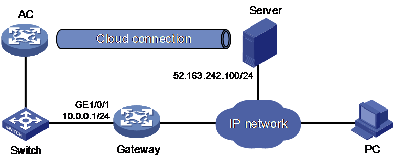

As shown in Figure 2, configure the AC to establish a cloud connection with the cloud server.
Figure 2 Network diagram
1.     Configure IP addresses for interfaces as shown in Figure 2, and configure a routing protocol to make sure the devices can reach each other. (Details not shown.)
2.     Log in to the cloud server to add the serial number of the AC to the server. (Details not shown.)
3.     Configure the domain name of the cloud server as oasiscloud.h3c.com.
<AC> system-view
[AC] cloud-management server domain oasiscloud.h3c.com
The DNS service is provided by the ISP DNS server.
