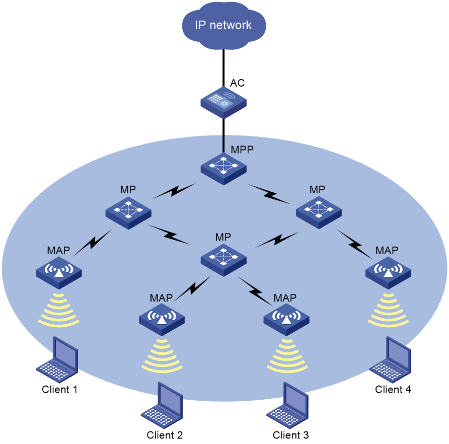

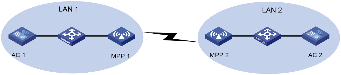

WLAN mesh network
Figure 1 shows a WLAN mesh network.
APs on a WLAN mesh network are mesh points (MPs). MPs play the following roles:
·     Single-purpose MP—Provides only mesh services.
·     Mesh access point (MAP)—Provides both mesh and access services.
·     Mesh portal point (MPP)—Provides a wired connection to a wired network.
Figure 1 WLAN mesh network diagram

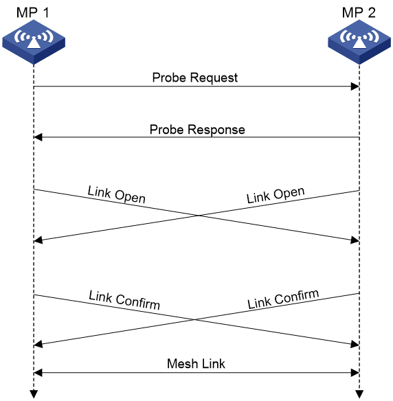

Neighbor discovery and mesh link establishment
MPs must operate at the same radio mode and on the same channel to discover each other. MPs can establish a mesh link after they discover each other and establish a peer relationship.
The following are the available discovery methods:
·     Active scanning—The MP sends Probe Request frames to discover neighbors and establish peer relationships.
·     Passive scanning—The MP listens to Beacon frames to collect information about other MPs. If there are neighbors, the AP sends Probe Request frames to request establishing a peer relationship.
This section uses active scanning to describe the neighbor discovery and mesh link establishment process.
As shown in Figure 2, MPs attempt to establish peer relationships by exchanging their mesh profiles in Probe Request and Probe Response frames.
One MP adds another MP as a mesh peer if the following conditions are met:
·     The MPs' mesh profiles match.
·     The Accepting Peer Links bit in the received request or response is set.
The MP peers attempt to establish a mesh link by sending a Link Open request to each other. The mesh link is established after the MP peers acknowledge the Link Open request received from each other.
Figure 2 Neighbor discovery and mesh link establishment on a WLAN mesh network

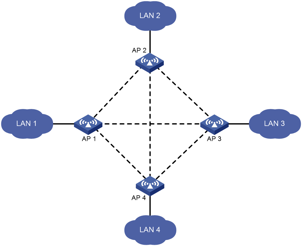

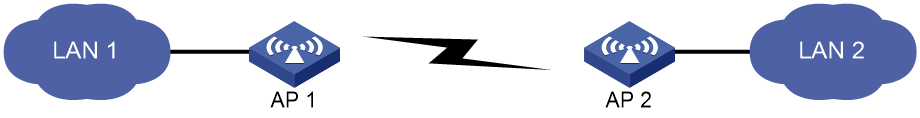

Point-to-point topology
As shown in Figure 3, you can set up a mesh link between two APs to connect two LANs.
Figure 3 WDS point to point topology

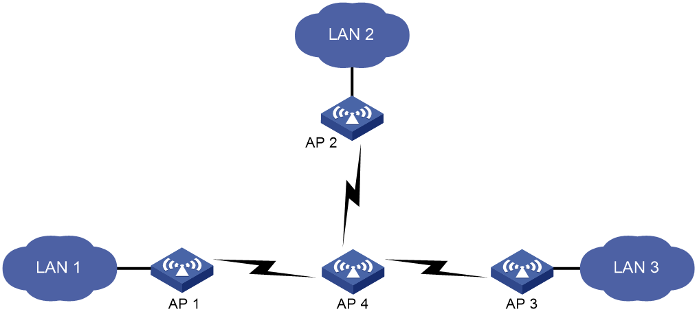

Star topology
As shown in Figure 4, you can set up mesh links between one central AP and multiple leaf APs to connect multiple LANs. In this topology, all data between LANs must traverse the central AP (AP 4 in this example).
Figure 4 Star topology

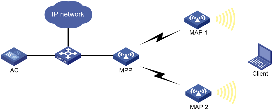

Topology created without administrative intervention
Without administrative intervention, the WDS topology depends on the result of automatic neighbor discovery and mesh link establishment between APs.
Figure 5 Automatic topology setup

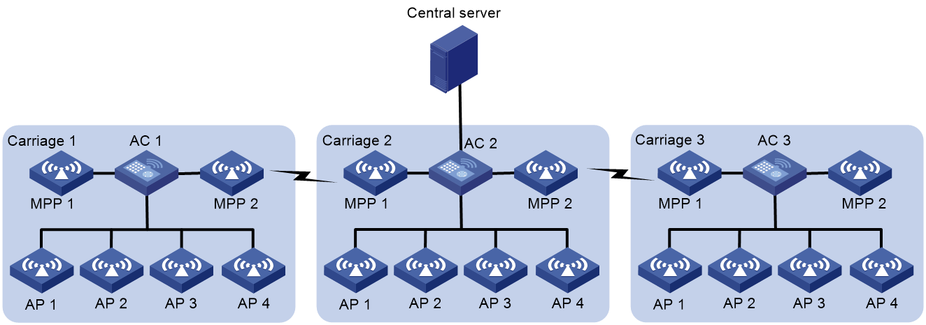

As shown in Figure 6, an AC and multiple APs are deployed in each carriage on a train. All devices are assigned to the same VLAN. Therefore, the two APs at both ends of each carriage can act as MPPs to establish mesh links with the MPPs on the adjacent carriages. Other APs provide WLAN access services. All devices communicate with the outside through the central server deployed in the middle of the train.
In this scenario, IP address conflict might occur because all ACs use the same configuration for easy configuration and maintenance. To address this issue, configure NAT on each AC and configure the mesh interfaces to allow the VLAN for MPP communications. For more information about NAT, see Network Connectivity Configuration Guide.
Figure 6 High-speed railway mesh network

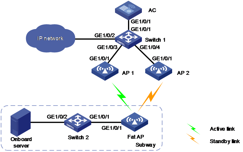

MLSP
MLSP requires cooperation of both ACs and fat APs.
Mobile Link Switch Protocol (MLSP) is designed for subway application to provide stable data transmission through mesh links between onboard and trackside MPs. The onboard MPs are responsible for link selection, maintenance, and switchover.
With MLSP enabled, each onboard MP maintains one active link and multiple standby links at the same time. Only the active link is used for data transmission. An onboard MP keeps switching its active link during train movement to ensure stable data transmission.
In subway applications, signals can be transmitted over the air, in waveguides, or in linking coaxial (LCX) cables. Signals transmitted over the air are called air signal and signals transmitted in waveguides or LCX cables are called waveguide signals. As a best practice to avoid signal interference, deploy waveguides or LCX cables in areas with strong interference.

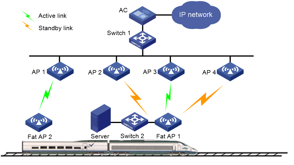

As shown in Figure 7, AP 1 through AP 4 are trackside MPs, and fat AP 1 and fat AP 2 are onboard MPs.
Figure 7 MLSP mesh network diagram
Air signal link switchover
An onboard MP uses a mesh link as a standby link if the RSSI on the link reaches or exceeds the sum of the link establishment threshold and the mesh link hold RSSI. If the MP does not have an active link, it uses the link as the active link.
An onboard MP switches to the optimal standby mesh link when one of the following conditions is met:
·     The link hold timer expires and a standby link has an RSSI higher than the active link for a value that reaches or exceeds the link switchover threshold.
·     The RSSI on the active link is lower than the mesh link hold RSSI.
·     The RSSI on the active link reaches or exceeds the link saturation RSSI.
If no standby link is available, the MP keeps using the active link when the RSSI on the active link is lower than the mesh link hold RSSI. The MP terminates the active link when the active link RSSI reaches or exceeds the link saturation RSSI.
Waveguide signal link switchover
An MP prefers air transmission over waveguide transmission. If an MP detects both air signals and waveguide signals, it transmits signals over the air instead of in a waveguide or LCX cable.
In waveguide transmission, an onboard MP uses a link as a standby link if the link RSSI reaches or exceeds the sum of the link establishment threshold and the waveguide link hold RSSI. If the MP does not have an active link, it uses the link as the active link.
The switchover method for waveguide signal links depends on whether fast waveguide switchover is enabled. If fast waveguide switchover is enabled, an onboard MP switches to a waveguide link once the MP detects the link. If fast waveguide switchover is disabled, an onboard MP switches to the optimal standby waveguide link when one of the following conditions is met:
·     The RSSI on the active link is lower than the waveguide link hold RSSI.
If no standby link is available, the MP keeps using the active link when the RSSI on the active link is lower than the waveguide link hold RSSI. The MP terminates the active link when the active link RSSI reaches or exceeds the link saturation RSSI.

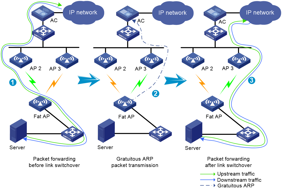

MLSP proxy
This feature enables an onboard MP to proxy an onboard device (typically an onboard server) for fast downlink packet forwarding path change when link switchover occurs.
As shown in Figure 8, an onboard MP uses the MAC address of the proxied device to send gratuitous ARP packets for MAC address table update of trackside MPs. This ensures fast transmission of downlink packets over the new active link after a link switchover.
Figure 8 Fast packet forwarding path change

Example: Configuring WLAN mesh
As shown in Figure 9, establish an 802.11n 5GHz WLAN mesh network to provide network access for the clients. Configure the MP and MAPs to establish mesh links on channel 149.
Figure 9 Network diagram
1.     Configure a mesh profile:
# Create a mesh profile.
<AC> system-view
[AC] wlan mesh-profile 1
# Set the mesh ID to 1.
[AC-wlan-mesh-profile-1] mesh-id 1
# Enable SAE for authentication and key management.
[AC-wlan-mesh-profile-1] akm mode sae
# Configure a preshared key.
[AC-wlan-mesh-profile-1] preshared-key pass-phrase simple 12345678
# Enable the mesh profile.
[AC-wlan-mesh-profile-1] mesh-profile enable
[AC-wlan-mesh-profile-1] quit
2.     Configure a service template.
[AC] wlan service-template service1
[AC-wlan-st-service1] ssid mesh-network
[AC-wlan-st-service1] service-template enable
[AC-wlan-st-service1] quit
3.     Configure settings for the MPP:
# Create an AP template for the MPP. Make sure you select the correct AP model and specify the correct serial ID.
[AC] wlan ap mpp model WA6320
[AC-wlan-ap-mpp] serial-id 219801A28N819CE0002T
# Bind the mesh profile to the MPP's radio 1.
[AC-wlan-ap-mpp] radio 1
[AC-wlan-ap-mpp-radio-1] mesh-profile 1
# Set the radio type of the MPP's radio 1 to 802.11n (5GHz).
[AC-wlan-ap-mpp-radio-1] type dot11an
# Set the working channel of the radio to 149.
[AC-wlan-ap-mpp-radio-1] channel 149
# Enable the radio.
[AC-wlan-ap-mpp-radio-1] radio enable
[AC-wlan-ap-mpp-radio-1] quit
# Disable the MPP from sending neighbor probe requests.
[AC-wlan-ap-mpp] portal-service enable
[AC-wlan-ap-mpp] quit
4.     Configure settings for the MAPs:
# Create an AP template for MAP 1. Make sure you select the correct AP model and specify the correct serial ID.
[AC] wlan ap map1 model WA6320
[AC-wlan-ap-map1] serial-id 219801A28N819CE0002T
# Bind the mesh profile to the MAP's radio 1.
[AC-wlan-ap-map1] radio 1
[AC-wlan-ap-map1-radio-1] mesh-profile 1
# Bind the service template to the MAP's radio 1.
[AC-wlan-ap-map1-radio-1] service-template service1
# Set the radio type of the MAP's radio 1 to 802.11n (5GHz).
[AC-wlan-ap-map1-radio-1] type dot11an
[AC-wlan-ap-map1-radio-1] channel 149
# Add the MAC address of a radio on the MPP to the mesh peer whitelist to avoid loops. MAP 1 can set up a mesh link only with the MPP.
[AC-wlan-ap-map1-radio-1] mesh peer-mac-address 77a2-c25d-e316
# Enable the radio.
[AC-wlan-ap-map1-radio-1] radio enable
[AC-wlan-ap-map1-radio-1] quit
[AC-wlan-ap-map1] quit
# Configure settings for MAP 2 in the same way settings for MAP 1 are configured.
[AC] wlan ap map2 model WA6320
[AC-wlan-ap-map2] serial-id 219801A28N819CE0002T
[AC-wlan-ap-map2] radio 1
[AC-wlan-ap-map2-radio-1] mesh-profile 1
[AC-wlan-ap-map2-radio-1] service-template service1
[AC-wlan-ap-map2-radio-1] type dot11an
[AC-wlan-ap-map2-radio-1] channel 149
[AC-wlan-ap-map2-radio-1] mesh peer-mac-address 77a2-c25d-e316
[AC-wlan-ap-map2-radio-1] radio enable
[AC-wlan-ap-map2-radio-1] quit
[AC-wlan-ap-map2] quit
[AC] quit
# Verify that the MPP and MAPs can establish mesh links.
<AC> display wlan mesh-link ap
AP Name: mpp
 Peer           Local          Status     RSSI Packets(Rx/Tx)
 4a9b-c5bb-e43f 77a2-c25d-e316 Forwarding 22   6058/1900
 a6b5-1c5a-22ff 77a2-c25d-e316 Forwarding 35   5354/1900
AP Name: map1
 77a2-c25d-e316 4a9b-c5bb-e43f Forwarding 22   1900/6058
AP Name: map2
 77a2-c25d-e316 a6b5-1c5a-22ff Forwarding 35   1900/5354
# Verify that the clients have associated with their respective APs.
<AC> display wlan client
Total number of clients: 1
MAC address    Username             AP name               R IP address      VLAN ID
000f-e265-6400 N/A                  mpp                   1 1.1.1.1         300
Example: Configuring VLAN settings for a WLAN mesh network
As shown in Figure 10, both LAN 1 and LAN 2 belong to VLAN 2. Configure MPP 1 and MPP 2 to establish a mesh link on channel 149, and to permit traffic from VLAN 2.
Figure 10 Network diagram
<AC1> system-view
[AC1] wlan mesh-profile 1
[AC1-wlan-mesh-profile-1] mesh-id 1
[AC1-wlan-mesh-profile-1] akm mode sae
[AC1-wlan-mesh-profile-1] preshared-key pass-phrase simple 12345678
[AC1-wlan-mesh-profile-1] mesh-profile enable
[AC1-wlan-mesh-profile-1] quit
[AC1] wlan service-template service1
[AC1-wlan-st-service1] ssid mesh-network
[AC1-wlan-st-service1] service-template enable
[AC1-wlan-st-service1] quit
[AC1] wlan ap mpp1 model WA6320
[AC1-wlan-ap-mpp1] serial-id 219801A28N819CE0002T
# Bind the mesh profile to radio 1 of the MPP.
[AC1-wlan-ap-mpp1] radio 1
[AC1-wlan-ap-mpp1-radio-1] mesh-profile 1
# Set the radio type for radio 1 of the MPP to 802.11n (5GHz).
[AC1-wlan-ap-mpp1-radio-1] type dot11an
[AC1-wlan-ap-mpp1-radio-1] channel 149
# Enable the radio.
[AC1-wlan-ap-mpp1-radio-1] radio enable
[AC1-wlan-ap-mpp1-radio-1] quit
4.     Configure the mesh interface:
# Create mesh interface 1.
[AC1-wlan-ap-mpp1] interface wlan-mesh 1
[AC1-wlan-ap-mpp1-wlan-mesh-1] quit
# Bind the mesh interface to radio 1 of the MPP.
[AC1-wlan-ap-mpp1-radio-1] mesh-interface 1
# Set the link type to trunk.

Example: Configuring MLSP
As shown in Figure 11, trackside MPs (AP 1 and AP 2) are connected to the AC through Switch 1, and the onboard MP (fat AP) is connected to the onboard server through Switch 2. Configure MLSP for the onboard MP to communicate with trackside MPs.
Figure 11 Network diagram
·     If multiple servers exist on the train, and each server must be connected to a different VLAN, configure the following settings:
¡     Create VLANs and VLAN interfaces on Switch 2. The VLAN interfaces are used as the gateways for the servers.
¡     Configure a static route from the IP network to each server.
¡     If onboard devices and devices on the IP network communicate at Layer 3 and onboard MPs are deployed at both ends of the train, OSPF is required for traffic between these devices to be dynamically forwarded by the MP at the front or rear. You must configure the network type as NBMA on VLAN interfaces on Switch 1 and Switch 2, and manually specify the neighbor for the interfaces.
1.     Specify the IP address and gateway of the onboard server as 192.168.20.3 and 192.168.20.2, respectively. (Details not shown.)
2.     Configure the onboard MP:
# Create VLAN 30 and VLAN-interface 30, and specify an IP address for the VLAN interface. This VLAN will be used as the management VLAN.
<FatAP> system-view
[FatAP] vlan 30
[FatAP-vlan30] quit
[FatAP] interface vlan-interface 30
[FatAP-Vlan-interface30] ip address 30.1.1.2 255.255.255.0
[FatAP-Vlan-interface30] quit
# Create VLAN 40. This VLAN will be used as the service VLAN.
[FatAP] vlan 40
[FatAP-vlan40] quit
# Configure GigabitEthernet 1/0/1 that connects the fat AP to Switch 2 as a trunk port, and assign the port to VLANs 30 and 40.
[FatAP] interface gigabitEthernet 1/0/1
[FatAP-GigabitEthernet1/0/1] port link-type trunk
[FatAP-GigabitEthernet1/0/1] port trunk permit vlan 30 40
[FatAP-GigabitEthernet1/0/1] quit
[FatAP] wlan mesh-profile 1
[FatAP-wlan-mesh-profile-1] mesh-id 1
[FatAP-wlan-mesh-profile-1] akm mode sae
[FatAP-wlan-mesh-profile-1] preshared-key pass-phrase simple 12345678
[FatAP-wlan-mesh-profile-1] mesh-profile enable
[FatAP-wlan-mesh-profile-1] quit
# Create mesh policy 1 and enable mesh link initiation.
[FatAP] wlan mesh-policy 1
[FatAP-wlan-mesh-policy-1] link-initiation enable
# Enable MLSP.
[FatAP-wlan-mesh-policy-1] mlsp enable
# Set the mesh link establishment threshold to 3.
[FatAP-wlan-mesh-policy-1] link-establish-threshold 3
# Set the mesh link hold RSSI to 20.
[FatAP-wlan-mesh-policy-1] link-hold-rssi 20
# Set the mesh link saturation RSSI to 100.
[FatAP-wlan-mesh-policy-1] link-saturation-rssi 100
# Set the mesh link hold time to 4000.
[FatAP-wlan-mesh-policy-1] link-hold-time 4000
# Set the mesh link keepalive packet limit for the active link to 5.
[FatAP-wlan-mesh-policy-1] active-link keepalive-count 5
# Set the mesh link switchover threshold to 5.
[FatAP-wlan-mesh-policy-1] link-switch-threshold 5
# Set the probe request interval to 100.
[FatAP-wlan-mesh-policy-1] probe-request-interval 100
# Configure the MP to proxy the gateway for the onboard server. The gateway is VLAN-interface 40 on Switch 2.
[FatAP-wlan-mesh-policy-1] mlsp-proxy mac-address 000f-e201-0101 vlan 40 ip 192.168.20.2
# Configure the MP to proxy the management VLAN interface VLAN-interface 30 on Switch 2.
[FatAP-wlan-mesh-policy-1] mlsp-proxy mac-address 000f-e201-0101 vlan 30 ip 30.1.1.3
[FatAP-wlan-mesh-policy-1] quit
# Bind mesh profile 1 to radio interface WLAN-Radio 1/0/1.
[FatAP] interface wlan-radio 1/0/1
[FatAP-WLAN-Radio1/0/1] mesh-profile 1
# Set the radio mode to 802.11ac (5 GHz).
[FatAP-WLAN-Radio1/0/1] type dot11ac
# Set the working channel to 149.
[FatAP-WLAN-Radio1/0/1] channel 149
# Bind mesh policy 1 to radio interface WLAN-Radio 1/0/1.
[FatAP-WLAN-Radio1/0/1] mesh-policy name 1
# Enable the radio interface.
[FatAP-WLAN-Radio1/0/1] undo shutdown
[FatAP-WLAN-Radio1/0/1] quit
# Create a mesh interface.
[FatAP] interface wlan-mesh 1
# Configure the mesh interface as a trunk port.
[FatAP-WLAN-Mesh1] port link-type trunk
# Assign the port to VLANs 30 and 40, and remove the port from VLAN 1.
[FatAP-WLAN-Mesh1] port trunk permit vlan 30 40
[FatAP-WLAN-Mesh1] undo port trunk permit vlan 1
[FatAP-WLAN-Mesh1] quit
# Bind the mesh interface to WLAN-Radio 1/0/1.
[FatAP-WLAN-Radio1/0/1] mesh-interface 1
# Configure a static route to the IP network.
[FatAP] ip route-static 192.168.10.0 255.255.255.0 30.1.1.1

# Display mesh link information on the onboard MP to verify that mesh links have been established.
<FatAP> display wlan mesh-link
 Peer MAC       RSSI BSSID          Interface         Link state    Online time
 d461-fe59-8620 74   d461-fe59-8380 WLAN-MeshLink129  Active(ac)    00h 02m 27s
 d461-fe59-87d0 49   d461-fe59-8380 WLAN-MeshLink130  Standby(ac)   00h 02m 07s
# Display mesh link information on the onboard MP to verify that an active/standby link switchover has occurred.
 d461-fe59-8620 52   d461-fe59-8380 WLAN-MeshLink129  Standby(ac)   00h 02m 37s
 d461-fe59-87d0 72   d461-fe59-8380 WLAN-MeshLink130  Active(ac)    00h 02m 17s
